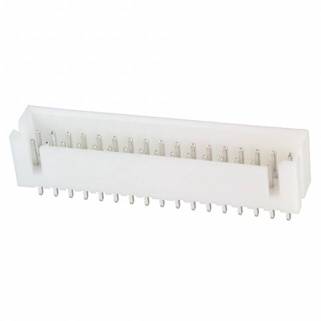

    CONN HEADER VERT 34POS 2.5MM
DF1B-34DP-2.5DSA 数据手册
DF1B Series Nov.1.2021 Copyright 2021 HIROSE ELECTRIC CO., LTD. All Rights Reserved. 2.5mm Pitch Connector for Discrete Wire Connection (UL/CSA Standard Certified Product) Sep. 2020 ③ DF1B Series/2.5mm Pitch Connector for Discrete Wire Connection (UL/CSA Standard Certified Product) Features IDC Contact (24, 26, 28AWG) Crimping Contact (20 to 30AWG) DF1B is a new type of connector in which the IDC contact is inserted into the case. This method enables the following merits: ① By using the IDC contact and crimping contact together, different current capacity cables can be mixed in one case. ② After connection, the contact can be replaced for excellent maintenance. ③ The case protects the insulation displacement area for high reliability. ④ Since the insulation displacement process can be performed only by replacing the applicator of the existing crimping machine, no expensive machinery for insulation displacement is required. Cables with different current capacities can be mixed in one case. 2. Potting Header Available A high profile header is also available for board potting and waterproofing. Potting Resin 6.0 Nov.1.2021 Copyright 2021 HIROSE ELECTRIC CO., LTD. All Rights Reserved. 1. New Insulation Displacement and Crimping Ideas Potting Status 3. Wide Variety Each of the " wire- to- board" and " in- line" types has single and double row variations, and both tin and gold plating are available as standard. ( Refer to the applicable combination diagram on the next page. ) Applications Business equipment including copy machines and printers. 2 DF1B Series/2.5mm Pitch Connector for Discrete Wire Connection (UL/CSA Standard Certified Product) Applicable Combination ●Single Row Type Straight Through Hole Type Socket (Cable Side) Pin Header DF1B-#S-2.5R DF1B(Z)-#P-2.5DSA Right Angle Through Hole Type Pin Header DF1BZ-#P-2.5DS Nov.1.2021 Copyright 2021 HIROSE ELECTRIC CO., LTD. All Rights Reserved. Panel Mount Type In-line Plug (Cable Side) DF1BA-#EP-2.5RC ●Double Row Type Socket (Cable Side) Straight Through Hole Type DF1B-#DS-2.5RC Pin Header DF1BZ-#DP-2.5DSA Right Angle Through Hole Type Pin Header DF1BZ-#DP-2.5DS Panel Mount Type In-line Plug (Cable Side) DF1BA-#DEP-2.5RC ≪In-line/ Positive Lock Type≫ ●Single Row Type Socket (Cable Side) In-line Plug (Cable Side) DF1B-#ES-2.5RC DF1B-#EP-2.5RC ●Double Row Type Socket (Cable Side) In-line Plug (Cable Side) DF1B-#DES-2.5RC DF1B-#DEP-2.5RC 3 DF1B Series/2.5mm Pitch Connector for Discrete Wire Connection (UL/CSA Standard Certified Product) Product Specifications Rated Current (Note 1) Rated Voltage 20-24 AWG 26 AWG 28 AWG 30 AWG Operating Temperature (Note2) -35 ~ +85℃ 3A 2A 1A 0.5A Operating Humidity Range 40 ~ 80% Storage Temperature Range (Note3) -10 ~ +60℃ Storage Humidity Range (Note3) 40 ~ 70% AC/DC 250V UL,CSA Current rating(Note1) UL,CSA Voltage rating 20-22 AWG 24-28 AWG 30 AWG 3A 1A 0.5A AC 30V Nov.1.2021 Copyright 2021 HIROSE ELECTRIC CO., LTD. All Rights Reserved. UL CSA Safety File No. UL: E52653/CSA : LR95109 Note 1 : The rated current varies based on cable size used. The current rating of only the header is 3A. Note 2 : Includes temperature rise caused by current flow. Note 3 : The storage condition refers to long-term storage of the product on the shelf before assembly. The operating temperature and humidity are applicable after assembly when the product is not energized and during transportation. Item Specification Condition Insulation Resistance 1000M Ω Min 500V DC Withstanding voltage No flashover or insulation breakdown. 650V AC per min. Contact Resistance 30m Ω Max 100mA Single Insertion/Extraction Force 0.44N(45gf) Min., 4.4N(450gf) Max. Measure at the square steel pin of 0.635 ± 0.002mm Vibration No electrical discontinuity of 1μ s or more Frequency : 10 to 55Hz, single amplitude of 0.75mm 2 hours in each of the 3 directions. Humidity (Steady State) Contact resistance:30m Ω Max. Insulation resistance:1000M Ω Min. 96 hours at temperature of 40 ± 2℃ and humidity of 90% to 95% Temperature Cycle Contact resistance:30m Ω Max. Insulation resistance:1000M Ω Min. (-55℃ : 30 minutes → 5 to 35℃ : 10 minutes  85℃ : 30 minutes → 5 to 35℃ : 10 minutes) 5 cycles Mating Durability Contact resistance:30m Ω Max. Tin plating : 30 cycles Gold plating : 50 cycles Resistance to Soldering Heat No deformation of components affecting performance. Flow : 260℃ for 5 seconds Manual soldering : 300℃ for 3 seconds 4 DF1B Series/2.5mm Pitch Connector for Discrete Wire Connection (UL/CSA Standard Certified Product) Materials / Finish Product Part Finish Remarks Socket Insulator Polyamide White IDC Contact for Socket Contact Phosphor Copper Tin Plated or Gold Plated - Crimping Contact for Socket Contact Phosphor Copper Tin Plated or Gold Plated - Insulator Polyamide White Contact Brass Tin Plated or Gold Plated In-line Plug Insulator Polyamide White IDC Contact for In-line Plug Contact Phosphor Copper Tin Plated or Gold Plated - Crimping Contact for In-line Plug Contact Phosphor Copper Tin Plated or Gold Plated - Pin Header Nov.1.2021 Copyright 2021 HIROSE ELECTRIC CO., LTD. All Rights Reserved. Material UL94V-0 UL94V-0 UL94V-0 Product Number Structure Refer to the chart below when determining the product specifications from the product number. Please select from the product numbers listed in this catalog when placing orders. ■ Connector DF1B # - # S - 2.5 RC ❶ ❷ ❸ ❹ ❺ ❻ Series Name DF1B ❹ Connector Type S : Single Row Socket DS : Double Row Socket P : Single Row Pin Header DP : Double Row Pin Header ES : Single Row In-line Socket DES : Double Row In-line Socket EP : Single Row In-line Plug DEP : Double Row In-line Plug ❷ Style Symbol Blank : Standard type A : In-line Plug (Simple Lock Type) D : Pin Header (Potting Type) Z : Pin Header (Standard Type, Tin Plated) ❺ Contact Pitch 2.5mm ❸ Number of Pos. Single Row : 2 to 16, 18, 20 Double Row : 4 to 30, 34, 40 ❻ Contact Type RC : IDC/Crimping Socket (Note) DSA : Straight Through Hole DS : Right Angle Through Hole ❶ ■ Socket IDC Contact DF1B - R 24 F A ❶ ❷ ❸ ❹ ❶ Connection Type R : IDC ❸ Packaging Type Blank : Bag F : Reel ❷ Applicable Cable Size 24 : 24 AWG 26 : 26 AWG 28 : 28 AWG ❹ Plating Type Blank : Tin Plated A : Gold Plated 5 DF1B Series/2.5mm Pitch Connector for Discrete Wire Connection (UL/CSA Standard Certified Product) ■ Plug IDC Contact DF1B - 24 P R F ❶ ❷ ❸ ❹ ❶ Applicable Cable Size 24 : 24 AWG 26 : 26 AWG 28 : 28 AWG ❸ Connection Type R : IDC ❷ Connector Type P : Plug ❹ Packaging Type Blank : Bag F : Reel Nov.1.2021 Copyright 2021 HIROSE ELECTRIC CO., LTD. All Rights Reserved. ■ Crimping Contact DF1B - 2428 SCF A ❶ ❶ ❷ ❷ ❸ Applicable Cable Size 2022 : 20 to 22 AWG 2428 : 24 to 28 AWG 30 : 30 AWG Packaging Type SCF : Socket Contact/Reel SC : Socket Contact/Bag PCF : Plug Contact/Reel PC : Plug Contact/Bag ❸ Plating Type Blank : Tin Plated A : Gold Plated B : Gold Plated (Note) Note : Socket contacts have an "A" at the end of the product name. Plug contacts have a "B" at the end of the product name. The product numbers of gold plated plug contacts for 24 to 28 AWG cable are DF1-PD2428SCFB(Reel) and DF1-PD2428SCB(Bag). 6 DF1B Series/2.5mm Pitch Connector for Discrete Wire Connection (UL/CSA Standard Certified Product) Single Row Socket A B 1.6 P=2.5 1.9 A Note Nov.1.2021 Copyright 2021 HIROSE ELECTRIC CO., LTD. All Rights Reserved. 11.5 Shown with Contacts Inserted n a 1 1 Pos. No. 1 No. of Pos. Indicator 4.4 Note : The 2pos. connector differs from the above figure and has a single center projection to prevent mis-insertion. For 3-6pos. there are two projections at both ends, and for 7-20pos. there are three projections. Unit : mm Part No. HRS No. No. of Pos. A B DF1B-2S-2.5R CL0541-0200-6-00 2 5.0 2.5 DF1B-3S-2.5R CL0541-0201-9-00 3 7.5 5.0 DF1B-4S-2.5R CL0541-0202-1-00 4 10.0 7.5 DF1B-5S-2.5R CL0541-0203-4-00 5 12.5 10.0 DF1B-6S-2.5R CL0541-0204-7-00 6 15.0 12.5 DF1B-7S-2.5R CL0541-0205-0-00 7 17.5 15.0 DF1B-8S-2.5R CL0541-0206-2-00 8 20.0 17.5 DF1B-9S-2.5R CL0541-0207-5-00 9 22.5 20.0 DF1B-10S-2.5R CL0541-0208-8-00 10 25.0 22.5 DF1B-11S-2.5R CL0541-0209-0-00 11 27.5 25.0 DF1B-12S-2.5R CL0541-0210-0-00 12 30.0 27.5 DF1B-13S-2.5R CL0541-0211-2-00 13 32.5 30.0 DF1B-14S-2.5R CL0541-0212-5-00 14 35.0 32.5 DF1B-15S-2.5R CL0541-0213-8-00 15 37.5 35.0 DF1B-16S-2.5R CL0541-0214-0-00 16 40.0 37.5 DF1B-18S-2.5R CL0541-0215-3-00 18 45.0 42.5 DF1B-20S-2.5R CL0541-0216-6-00 20 50.0 47.5 7 RoHS Purchase Unit Yes 100pcs per bag DF1B Series/2.5mm Pitch Connector for Discrete Wire Connection (UL/CSA Standard Certified Product) Double Row Socket A B 8.0 P=2.5 P=2.5 Note Nov.1.2021 Copyright 2021 HIROSE ELECTRIC CO., LTD. All Rights Reserved. 11.5 Shown with Contacts Inserted n 1 No. of Pos. Indicator Pos. No. 1 Note : The 4pos. connector differs from the above figure and has a single center projection to prevent mis-insertion. Unit : mm Part No. HRS No. No. of Pos. A B DF1B-4DS-2.5RC CL0541-0648-0-00 4 7.5 2.5 DF1B-6DS-2.5RC CL0541-0649-3-00 6 10.0 5.0 DF1B-8DS-2.5RC CL0541-0650-2-00 8 12.5 7.5 DF1B-10DS-2.5RC CL0541-0600-4-00 10 15.0 10.0 DF1B-12DS-2.5RC CL0541-0601-7-00 12 17.5 12.5 DF1B-14DS-2.5RC CL0541-0602-0-00 14 20.0 15.0 DF1B-16DS-2.5RC CL0541-0603-2-00 16 22.5 17.5 DF1B-18DS-2.5RC CL0541-0604-5-00 18 25.0 20.0 DF1B-20DS-2.5RC CL0541-0605-8-00 20 27.5 22.5 DF1B-22DS-2.5RC CL0541-0606-0-00 22 30.0 25.0 DF1B-24DS-2.5RC CL0541-0607-3-00 24 32.5 27.5 DF1B-26DS-2.5RC CL0541-0608-6-00 26 35.0 30.0 DF1B-28DS-2.5RC CL0541-0609-9-00 28 37.5 32.5 DF1B-30DS-2.5RC CL0541-0610-8-00 30 40.0 35.0 DF1B-34DS-2.5RC CL0541-0612-3-00 34 45.0 40.0 DF1B-36DS-2.5RC CL0541-0613-6-00 36 47.5 42.5 DF1B-40DS-2.5RC CL0541-0615-1-00 40 52.5 47.5 8 RoHS Purchase Unit Yes 100pcs per bag DF1B Series/2.5mm Pitch Connector for Discrete Wire Connection (UL/CSA Standard Certified Product) Single Row Straight Pin Header B A 5.7 2.7 P=2.5 3.6 Nov.1.2021 Copyright 2021 HIROSE ELECTRIC CO., LTD. All Rights Reserved. Note 2.5 ●Board Through-hole Diameter : φ1.1+0.1  0 9.5 4.5 A □0.64 Note : The 2 and 3pos. connectors differ from the above figure and have a single center indentation to prevent mis-insertion. For 4-6pos. there are two indentations at both ends, and for 7-20pos. there are three indentations. Recommended PCB Layout (t=1.6±0.1mm) A±0.1 P=2.5±0.05 φ1 .1 + 0.1 0 Unit : mm Tin Plated Part No. Gold Plated HRS No. Part No. HRS No. No. of Pos. A B DF1BZ-2P-2.5DSA CL0541-2000-8-00 DF1B-2P-2.5DSA(01) CL0541-0225-7-01 2 2.5 7.5 DF1BZ-3P-2.5DSA CL0541-2001-0-00 DF1B-3P-2.5DSA(01) CL0541-0226-0-01 3 5.0 10.0 DF1BZ-4P-2.5DSA CL0541-2002-3-00 DF1B-4P-2.5DSA(01) CL0541-0227-2-01 4 7.5 12.5 DF1BZ-5P-2.5DSA CL0541-2003-6-00 DF1B-5P-2.5DSA(01) CL0541-0228-5-01 5 10.0 15.0 DF1BZ-6P-2.5DSA CL0541-2004-9-00 DF1B-6P-2.5DSA(01) CL0541-0229-8-01 6 12.5 17.5 DF1BZ-7P-2.5DSA CL0541-2005-1-00 DF1B-7P-2.5DSA(01) CL0541-0230-7-01 7 15.0 20.0 DF1BZ-8P-2.5DSA CL0541-2006-4-00 DF1B-8P-2.5DSA(01) CL0541-0231-0-01 8 17.5 22.5 DF1BZ-9P-2.5DSA CL0541-2007-7-00 DF1B-9P-2.5DSA(01) CL0541-0232-2-01 9 20.0 25.0 DF1BZ-10P-2.5DSA CL0541-2008-0-00 DF1B-10P-2.5DSA(01) CL0541-0233-5-01 10 22.5 27.5 DF1BZ-11P-2.5DSA CL0541-2009-2-00 - 11 25.0 30.0 DF1BZ-12P-2.5DSA CL0541-2010-1-00 CL0541-0235-0-01 12 27.5 32.5 DF1BZ-13P-2.5DSA CL0541-2011-4-00 - 13 30.0 35.0 DF1BZ-14P-2.5DSA CL0541-2012-7-00 DF1B-14P-2.5DSA(01) CL0541-0237-6-01 14 32.5 37.5 DF1BZ-15P-2.5DSA CL0541-2013-0-00 DF1B-15P-2.5DSA(01) CL0541-0238-9-01 15 35.0 40.0 DF1BZ-16P-2.5DSA CL0541-2014-2-00 DF1B-16P-2.5DSA(01) CL0541-0239-1-01 16 37.5 42.5 DF1BZ-18P-2.5DSA CL0541-2015-5-00 DF1B-18P-2.5DSA(01) CL0541-0240-0-01 18 42.5 47.5 DF1BZ-20P-2.5DSA CL0541-2016-8-00 DF1B-20P-2.5DSA(01) CL0541-0241-3-01 20 47.5 52.5 DF1B-12P-2.5DSA(01) - 9 RoHS Purchase Unit Yes 100pcs per bag DF1B Series/2.5mm Pitch Connector for Discrete Wire Connection (UL/CSA Standard Certified Product) Single Row Right Angle Pin Header B A 3.6 3.6 A □0.64 A No.1 2.7 2.7 5.7 P=2.5 4.5 12.5 Note 2.9 Nov.1.2021 Copyright 2021 HIROSE ELECTRIC CO., LTD. All Rights Reserved. 7 ●Board Through-hole Diameter : φ1.1+0.1  0 Note : The 2 and 3pos. connectors differ from the above figure and have a single center indentation to prevent mis-insertion. For 4-6pos. there are two indentations at both ends, and for 7-20pos. there are three indentations. Recommended PCB Layout (t=1.6±0.1mm) A±0.1 P=2.5±0.05 φ 1.1 +0 0 .1 Unit : mm Tin Plated Part No. Gold Plated HRS No. Part No. HRS No. No. of Pos. A B DF1BZ-2P-2.5DS CL0541-2034-0-00 DF1B-2P-2.5DS(01) CL0541-0242-6-01 2 2.5 7.5 DF1BZ-3P-2.5DS CL0541-2035-2-00 DF1B-3P-2.5DS(01) CL0541-0243-9-01 3 5.0 10.0 DF1BZ-4P-2.5DS CL0541-2036-5-00 DF1B-4P-2.5DS(01) CL0541-0244-1-01 4 7.5 12.5 DF1BZ-5P-2.5DS CL0541-2037-8-00 DF1B-5P-2.5DS(01) CL0541-0245-4-01 5 10.0 15.0 DF1BZ-6P-2.5DS CL0541-2038-0-00 DF1B-6P-2.5DS(01) CL0541-0246-7-01 6 12.5 17.5 DF1BZ-7P-2.5DS CL0541-2039-3-00 DF1B-7P-2.5DS(01) CL0541-0247-0-01 7 15.0 20.0 DF1BZ-8P-2.5DS CL0541-2040-2-00 DF1B-8P-2.5DS(01) CL0541-0248-2-01 8 17.5 22.5 DF1BZ-9P-2.5DS CL0541-2041-5-00 - - 9 20.0 25.0 DF1BZ-10P-2.5DS CL0541-2042-8-00 DF1B-10P-2.5DS(01) CL0541-0250-4-01 10 22.5 27.5 DF1BZ-11P-2.5DS CL0541-2043-0-00 - - 11 25.0 30.0 DF1BZ-12P-2.5DS CL0541-2044-3-00 DF1B-12P-2.5DS(01) CL0541-0252-0-01 12 27.5 32.5 DF1BZ-13P-2.5DS CL0541-2045-6-00 - - 13 30.0 35.0 DF1BZ-14P-2.5DS CL0541-2046-9-00 DF1B-14P-2.5DS(01) CL0541-0254-5-01 14 32.5 37.5 DF1BZ-15P-2.5DS CL0541-2047-1-00 DF1B-15P-2.5DS(01) CL0541-0255-8-01 15 35.0 40.0 DF1BZ-16P-2.5DS CL0541-2048-4-00 DF1B-16P-2.5DS(01) CL0541-0256-0-01 16 37.5 42.5 DF1BZ-18P-2.5DS CL0541-2049-7-00 DF1B-18P-2.5DS(01) CL0541-0257-3-01 18 42.5 47.5 DF1BZ-20P-2.5DS CL0541-2050-6-00 DF1B-20P-2.5DS(01) CL0541-0258-6-01 20 47.5 52.5 10 RoHS Purchase Unit Yes 100pcs per bag DF1B Series/2.5mm Pitch Connector for Discrete Wire Connection (UL/CSA Standard Certified Product) Single Row Straight Pin Header for Potting B A P=2.5 A 3.0 1.2 10.5 注 Φ1 2.25 □ 0.64 1.7 Note : The 2 and 3pos. connectors differs from the above figure and have a single center indentation to prevent mis-insertion. The 4 and 5pos. connectors have two indentations at both ends. Recommended PCB Layout (t=1.6±0.1mm) A±0.1 1. 1 + Φ 1.7 ±0.05 P=2.5±0.05 0 Φ 1. 1 2.25±0.05 0 Part No. HRS No. No. of Pos. A B DF1BD-2P-2.5DSA(05) CL0541-0800-3-05 2 2.5 7.5 DF1BD-3P-2.5DSA(05) CL0541-0801-6-05 3 5.0 10.0 DF1BD-4P-2.5DSA(05) CL0541-0802-9-05 4 7.5 12.5 DF1BD-5P-2.5DSA(05) CL0541-0803-1-05 5 10.0 15.0 【Specification No.】–##, (##) (05) : Tin plated Applicable Potting Thickness : 6mm Potting Status Potting Resin 6.0 Nov.1.2021 Copyright 2021 HIROSE ELECTRIC CO., LTD. All Rights Reserved. ●Board Positioning Boss Hole Diameter : φ1.1+0.1  0 ●Board Through-hole Diameter : φ1.1+0.1  0 17.5 4.5 Pos. No.1 11 RoHS Purchase Unit Yes 100pcs per bag DF1B Series/2.5mm Pitch Connector for Discrete Wire Connection (UL/CSA Standard Certified Product) 6.6 A No.2 A 6.6 8.6 P=2.5 B A 2.5 Double Row Straight Pin Header No.1 9.5 3.6 2.5 Note □0.64 □ Note : The 4 and 6pos. connectors differ from the above figure and have a single center indentation to prevent mis-insertion. Recommended PCB Layout (t=1.6±0.1mm) A±0.3 P=2.5±0.05 φ 1. 1 +0.1 0 P=2.5±0.05 Nov.1.2021 Copyright 2021 HIROSE ELECTRIC CO., LTD. All Rights Reserved. ●Board Through-hole Diameter : φ1.1+0.1  0 4.5 Pos. No.1 Unit : mm Tin Plated Part No. Gold Plated HRS No. Part No. HRS No. No. of Pos. A B DF1BZ-4DP-2.5DSA CL0541-2017-0-00 DF1B-4DP-2.5DSA(01) CL0541-0651-5-01 4 2.5 7.5 DF1BZ-6DP-2.5DSA CL0541-2018-3-00 DF1B-6DP-2.5DSA(01) CL0541-0652-8-01 6 5.0 10.0 DF1BZ-8DP-2.5DSA CL0541-2019-6-00 DF1B-8DP-2.5DSA(01) CL0541-0653-0-01 8 7.5 12.5 DF1BZ-10DP-2.5DSA CL0541-2020-5-00 DF1B-10DP-2.5DSA(01) CL0541-0616-4-01 10 10.0 15.0 DF1BZ-12DP-2.5DSA CL0541-2021-8-00 DF1B-12DP-2.5DSA(01) CL0541-0617-7-01 12 12.5 17.5 DF1BZ-14DP-2.5DSA CL0541-2022-0-00 DF1B-14DP-2.5DSA(01) CL0541-0618-0-01 14 15.0 20.0 DF1BZ-16DP-2.5DSA CL0541-2023-3-00 DF1B-16DP-2.5DSA(01) CL0541-0619-2-01 16 17.5 22.5 DF1BZ-18DP-2.5DSA CL0541-2024-6-00 DF1B-18DP-2.5DSA(01) CL0541-0620-1-01 18 20.0 25.0 DF1BZ-20DP-2.5DSA CL0541-2025-9-00 DF1B-20DP-2.5DSA(01) CL0541-0621-4-01 20 22.5 27.5 DF1BZ-22DP-2.5DSA CL0541-2026-1-00 DF1B-22DP-2.5DSA(01) CL0541-0622-7-01 22 25.0 30.0 DF1BZ-24DP-2.5DSA CL0541-2027-4-00 DF1B-24DP-2.5DSA(01) CL0541-0623-0-01 24 27.5 32.5 DF1BZ-26DP-2.5DSA CL0541-2028-7-00 DF1B-26DP-2.5DSA(01) CL0541-0624-2-01 26 30.0 35.0 DF1BZ-28DP-2.5DSA CL0541-2029-0-00 DF1B-28DP-2.5DSA(01) CL0541-0625-5-01 28 32.5 37.5 DF1BZ-30DP-2.5DSA CL0541-2030-9-00 DF1B-30DP-2.5DSA(01) CL0541-0626-8-01 30 35.0 40.0 DF1BZ-34DP-2.5DSA CL0541-2031-1-00 DF1B-34DP-2.5DSA(01) CL0541-0628-3-01 34 40.0 45.0 DF1BZ-36DP-2.5DSA CL0541-2032-4-00 DF1B-36DP-2.5DSA(01) CL0541-0629-6-01 36 42.5 47.5 DF1BZ-40DP-2.5DSA CL0541-2033-7-00 DF1B-40DP-2.5DSA(01) CL0541-0631-8-01 40 47.5 52.5 12 RoHS Purchase Unit Yes 100pcs per bag DF1B Series/2.5mm Pitch Connector for Discrete Wire Connection (UL/CSA Standard Certified Product) Double Row Right Angle Pin Header B A P=2.5 No.2 6.6 8.6 2.5 3.3 □0.64 7 2.6 2.5 2.5 12.5 Note : The 4 and 6pos. connectors differ from the above figure and have a single center indentation to prevent mis-insertion. Recommended PCB Layout (t=1.6±0.1mm) A±0.3 P=2.5±0.05 φ 1. 1 +0.1 0 Tin Plated Part No. 2.5±0.05 Nov.1.2021 Copyright 2021 HIROSE ELECTRIC CO., LTD. All Rights Reserved. Pos. No. 1 4.5 No.1 ●Board Through-hole Diameter : φ1.1+0.1  0 Gold Plated HRS No. Part No. HRS No. No. of Pos. A B DF1BZ-4DP-2.5DS CL0541-2051-9-00 DF1B-4DP-2.5DS(01) CL0541-0654-3-01 4 2.5 7.5 DF1BZ-6DP-2.5DS CL0541-2052-1-00 DF1B-6DP-2.5DS(01) CL0541-0655-6-01 6 5.0 10.0 DF1BZ-8DP-2.5DS CL0541-2053-4-00 DF1B-8DP-2.5DS(01) CL0541-0656-9-01 8 7.5 12.5 DF1BZ-10DP-2.5DS CL0541-2054-7-00 DF1B-10DP-2.5DS(01) CL0541-0632-0-01 10 10.0 15.0 DF1BZ-12DP-2.5DS CL0541-2055-0-00 DF1B-12DP-2.5DS(01) CL0541-0633-3-01 12 12.5 17.5 DF1BZ-14DP-2.5DS CL0541-2056-2-00 DF1B-14DP-2.5DS(01) CL0541-0634-6-01 14 15.0 20.0 DF1BZ-16DP-2.5DS CL0541-2057-5-00 DF1B-16DP-2.5DS(01) CL0541-0635-9-01 16 17.5 22.5 DF1BZ-18DP-2.5DS CL0541-2058-8-00 DF1B-18DP-2.5DS(01) CL0541-0636-1-01 18 20.0 25.0 DF1BZ-20DP-2.5DS CL0541-2059-0-00 DF1B-20DP-2.5DS(01) CL0541-0637-4-01 20 22.5 27.5 DF1BZ-22DP-2.5DS CL0541-2060-0-00 DF1B-22DP-2.5DS(01) CL0541-0638-7-01 22 25.0 30.0 DF1BZ-24DP-2.5DS CL0541-2061-2-00 DF1B-24DP-2.5DS(01) CL0541-0639-0-01 24 27.5 32.5 DF1BZ-26DP-2.5DS CL0541-2062-5-00 DF1B-26DP-2.5DS(01) CL0541-0640-9-01 26 30.0 35.0 DF1BZ-28DP-2.5DS CL0541-2063-8-00 DF1B-28DP-2.5DS(01) CL0541-0641-1-01 28 32.5 37.5 DF1BZ-30DP-2.5DS CL0541-2064-0-00 DF1B-30DP-2.5DS(01) CL0541-0642-4-01 30 35.0 40.0 DF1BZ-34DP-2.5DS CL0541-2065-3-00 DF1B-34DP-2.5DS(01) CL0541-0644-0-01 34 40.0 45.0 DF1BZ-36DP-2.5DS CL0541-2066-6-00 DF1B-36DP-2.5DS(01) CL0541-0645-2-01 36 42.5 47.5 DF1BZ-40DP-2.5DS CL0541-2067-9-00 DF1B-40DP-2.5DS(01) CL0541-0647-8-01 40 47.5 52.5 13 RoHS Purchase Unit Yes 100pcs per bag DF1B Series/2.5mm Pitch Connector for Discrete Wire Connection (UL/CSA Standard Certified Product) Single Row In-line Plug (Friction Lock Type) B A 4.0 6.1 8.1 A P=2.5 注 Note 2 Nov.1.2021 Copyright 2021 HIROSE ELECTRIC CO., LTD. All Rights Reserved. 1.5 18.5 Shown with Contacts Inserted ●Applicable Socket: DF1B-#S-2.5R 1.5 (3.2) No. of Pos. Indicator Pos. No. 1 n n 321 321 A A Note : The 2pos. connector differs from the above figure and has a single center indentation to prevent mis-insertion. For 3-6pos. there are two indentations at both ends, and for 7-20pos. there are three indentations. Unit : mm Part No. HRS No. No. of Pos. A B DF1BA-2EP-2.5RC CL0541-0700-9-00 2 2.5 7.1 DF1BA-3EP-2.5RC CL0541-0701-1-00 3 5.0 9.6 DF1BA-4EP-2.5RC CL0541-0702-4-00 4 7.5 12.1 DF1BA-5EP-2.5RC CL0541-0703-7-00 5 10.0 14.6 DF1BA-6EP-2.5RC CL0541-0704-0-00 6 12.5 17.1 DF1BA-7EP-2.5RC CL0541-0705-2-00 7 15.0 19.6 DF1BA-8EP-2.5RC CL0541-0706-5-00 8 17.5 22.1 DF1BA-9EP-2.5RC CL0541-0707-8-00 9 20.0 24.6 DF1BA-10EP-2.5RC CL0541-0708-0-00 10 22.5 27.1 DF1BA-12EP-2.5RC CL0541-0710-2-00 12 27.5 32.1 14 RoHS Purchase Unit Yes 100pcs per bag DF1B Series/2.5mm Pitch Connector for Discrete Wire Connection (UL/CSA Standard Certified Product) 4.2 +0.1 0 6.3 +0.1 0 Panel Cutouts C±0.1 D +0.1 0 0 Panel Note Note : Do not use a rounded surface at the panel tab portion. Unit : mm Nov.1.2021 Copyright 2021 HIROSE ELECTRIC CO., LTD. All Rights Reserved. C Applicable Plug No. of Pos. Panel Board Thickness (Note 1) 0.5 to 1.2 1.3 to 1.6 1.7 to 2.0 D DF1BA-2EP-2.5RC 2 11.2 11.9 12.6 7.3 DF1BA-3EP-2.5RC 3 13.7 14.4 15.1 9.8 DF1BA-4EP-2.5RC 4 16.2 16.9 17.6 12.3 DF1BA-5EP-2.5RC 5 18.7 19.4 20.1 14.8 DF1BA-6EP-2.5RC 6 21.2 21.9 22.6 17.3 DF1BA-7EP-2.5RC 7 23.7 24.4 25.1 19.8 DF1BA-8EP-2.5RC 8 26.2 26.9 27.6 22.3 DF1BA-9EP-2.5RC 9 28.7 29.4 30.1 24.8 DF1BA-10EP-2.5RC 10 31.2 31.9 32.6 27.3 DF1BA-12EP-2.5RC 12 36.2 36.9 37.6 32.3 Note 1 : The installation hole size C varies based on the panel board thickness. Note 2 : Fabricate installation holes so that no burrs occur. 15 DF1B Series/2.5mm Pitch Connector for Discrete Wire Connection (UL/CSA Standard Certified Product) Double Row In-line Plug (Friction Lock Type) B A 5 5.0 9.2 11.2 P=2.5 Note 2 1.5 Pos. No. 1 n-1 531 n 642 n-1 A Nov.1.2021 Copyright 2021 HIROSE ELECTRIC CO., LTD. All Rights Reserved. Shown with Contacts Inserted ●Applicable Socket : DF1B-#DS-2.5RC 1.5 18.5 (3.2) No. of Pos. Indicator Note : The 4pos. connector differs from the above figure and has a single center indentation to prevent mis-insertion. Unit : mm Part No. HRS No. No. of Pos. A B DF1BA-4DEP-2.5RC CL0541-0719-7-00 4 2.5 8.6 DF1BA-6DEP-2.5RC CL0541-0720-6-00 6 5.0 11.1 DF1BA-8DEP-2.5RC CL0541-0721-9-00 8 7.5 13.6 DF1BA-10DEP-2.5RC CL0541-0722-1-00 10 10.0 16.1 DF1BA-12DEP-2.5RC CL0541-0723-4-00 12 12.5 18.6 DF1BA-14DEP-2.5RC CL0541-0724-7-00 14 15.0 21.1 DF1BA-16DEP-2.5RC CL0541-0725-0-00 16 17.5 23.6 DF1BA-18DEP-2.5RC CL0541-0726-2-00 18 20.0 26.1 DF1BA-20DEP-2.5RC CL0541-0727-5-00 20 22.5 28.6 DF1BA-22DEP-2.5RC CL0541-0728-8-00 22 25.0 31.1 DF1BA-24DEP-2.5RC CL0541-0729-0-00 24 27.5 33.6 DF1BA-26DEP-2.5RC CL0541-0730-0-00 26 30.0 36.1 DF1BA-28DEP-2.5RC CL0541-0731-2-00 28 32.5 38.6 DF1BA-30DEP-2.5RC CL0541-0732-5-00 30 35.0 41.1 DF1BA-34DEP-2.5RC CL0541-0734-0-00 34 40.0 46.1 16 RoHS Purchase Unit Yes 100pcs per bag DF1B Series/2.5mm Pitch Connector for Discrete Wire Connection (UL/CSA Standard Certified Product) Panel Cutouts C±0.1 D +0.1 0 5.2 +0.1 0 9.4 +0.1 0 0 Panel Note Note : Do not use a rounded surface at the panel tab portion. Nov.1.2021 Copyright 2021 HIROSE ELECTRIC CO., LTD. All Rights Reserved. C Applicable Plug No. of Pos. Panel Board Thickness (Note 1) 0.5 to 1.2 1.3 to 1.6 1.7 to 2.0 D DF1BA-4DEP-2.5RC 4 12.7 13.4 14.1 8.8 DF1BA-6DEP-2.5RC 6 15.2 15.9 16.6 11.3 DF1BA-8DEP-2.5RC 8 17.7 18.4 19.1 13.8 DF1BA-10DEP-2.5RC 10 20.2 20.9 21.6 16.3 DF1BA-12DEP-2.5RC 12 22.7 23.4 24.1 18.8 DF1BA-14DEP-2.5RC 14 25.2 25.9 26.6 21.3 DF1BA-16DEP-2.5RC 16 27.7 28.4 29.1 23.8 DF1BA-18DEP-2.5RC 18 30.2 30.9 31.6 26.3 DF1BA-20DEP-2.5RC 20 32.7 33.4 34.1 28.8 DF1BA-22DEP-2.5RC 22 35.2 35.9 36.6 31.3 DF1BA-24DEP-2.5RC 24 37.7 38.4 39.1 33.8 DF1BA-26DEP-2.5RC 26 40.2 40.9 41.6 36.3 DF1BA-28DEP-2.5RC 28 42.7 43.4 44.1 38.8 DF1BA-30DEP-2.5RC 30 45.2 45.9 46.6 41.3 DF1BA-34DEP-2.5RC 34 50.2 50.9 51.6 46.3 Note 1 : The installation hole size C varies based on the panel board thickness. Note 2 : Fabricate installation holes so that no burrs occur. 17 DF1B Series/2.5mm Pitch Connector for Discrete Wire Connection (UL/CSA Standard Certified Product) Single Row In-line Socket (Positive Lock Type) 3.8 6.0 3.0 A P=2.5 B Nov.1.2021 Copyright 2021 HIROSE ELECTRIC CO., LTD. All Rights Reserved. Shown with Contacts Inserted ●Applicable Socket : DF1B-#EP-2.5RC 1.5 11.5 (3) No. of Pos. Indicator Pos. No. 1 1 2 n 3 A Unit : mm Part No. HRS No. No. of Pos. A B DF1B-2ES-2.5RC CL0541-0320-8-00 2 2.5 6.5 DF1B-3ES-2.5RC CL0541-0321-0-00 3 5.0 9.0 DF1B-4ES-2.5RC CL0541-0322-3-00 4 7.5 11.5 DF1B-5ES-2.5RC CL0541-0323-6-00 5 10.0 14.0 DF1B-6ES-2.5RC CL0541-0324-9-00 6 12.5 16.5 DF1B-7ES-2.5RC CL0541-0325-1-00 7 15.0 19.0 DF1B-8ES-2.5RC CL0541-0326-4-00 8 17.5 21.5 DF1B-9ES-2.5RC CL0541-0327-7-00 9 20.0 24.0 DF1B-10ES-2.5RC CL0541-0328-0-00 10 22.5 26.5 DF1B-11ES-2.5RC CL0541-0329-2-00 11 25.0 29.0 DF1B-12ES-2.5RC CL0541-0330-1-00 12 27.5 31.5 DF1B-13ES-2.5RC CL0541-0331-4-00 13 30.0 34.0 18 RoHS Purchase Unit Yes 100pcs per bag DF1B Series/2.5mm Pitch Connector for Discrete Wire Connection (UL/CSA Standard Certified Product) Panel Cutouts 3.7 +0.1 0 1.1MIN C +0.1 0 0 +0.1 D+0.1 E +0.1 0 Panel 4.0 D +0.1 0 3.2 +0.1 0 0 Note 0 0 注3 Nov.1.2021 Copyright 2021 HIROSE ELECTRIC CO., LTD. All Rights Reserved. Note : Do not use a rounded surface at the panel tab portion. Unit : mm E Applicable Plug No. of Pos. C D Panel Board Thickness (Note 1) 0.5 to 1.2 1.3 to 1.6 1.7 to 2.0 DF1B-2ES-2.5RC 2 4.7 6.7 10.8 11.3 12.0 DF1B-3ES-2.5RC 3 7.2 9.2 13.3 13.8 14.5 DF1B-4ES-2.5RC 4 9.7 11.7 15.8 16.3 17.0 DF1B-5ES-2.5RC 5 12.2 14.2 18.3 18.8 19.5 DF1B-6ES-2.5RC 6 14.7 16.7 20.8 21.3 22.0 DF1B-7ES-2.5RC 7 17.2 19.2 23.3 23.8 24.5 DF1B-8ES-2.5RC 8 19.7 21.7 25.8 26.3 27.0 DF1B-9ES-2.5RC 9 22.2 24.2 28.3 28.8 29.5 DF1B-10ES-2.5RC 10 24.7 26.7 30.8 31.3 32.0 DF1B-11ES-2.5RC 11 27.2 29.2 33.3 33.8 34.5 DF1B-12ES-2.5RC 12 29.7 31.7 35.8 36.3 37.0 DF1B-13ES-2.5RC 13 32.2 34.2 38.3 38.8 39.5 Note 1 : The installation hole size E varies based on panel board thickness. Note 2 : Fabricate installation holes so that no burrs occur. 19 DF1B Series/2.5mm Pitch Connector for Discrete Wire Connection (UL/CSA Standard Certified Product) Double Row In-line Socket (Positive Lock Type) 4.0 6.5 8.7 A P=2.5 Nov.1.2021 Copyright 2021 HIROSE ELECTRIC CO., LTD. All Rights Reserved. 1.5 11.5 Shown with Contacts Inserted ●Applicable Socket : DF1B-#DEP-2.5RC 1.5 B (3.2) Pos. No. 1 1 3 5 n-1 2 4 6 n No. of Pos. Indicator Unit : mm Part No. HRS No. No. of Pos. A B DF1B-10DES-2.5RC CL0541-0351-1-00 10 10.0 15.0 DF1B-12DES-2.5RC CL0541-0352-4-00 12 12.5 17.5 DF1B-14DES-2.5RC CL0541-0353-7-00 14 15.0 20.0 DF1B-16DES-2.5RC CL0541-0354-0-00 16 17.5 22.5 DF1B-18DES-2.5RC CL0541-0346-1-00 18 20.0 25.0 DF1B-20DES-2.5RC CL0541-0355-2-00 20 22.5 27.5 DF1B-22DES-2.5RC CL0541-0356-5-00 22 25.0 30.0 DF1B-24DES-2.5RC CL0541-0357-8-00 24 27.5 32.5 DF1B-26DES-2.5RC CL0541-0358-0-00 26 30.0 35.0 DF1B-28DES-2.5RC CL0541-0359-3-00 28 32.5 37.5 DF1B-30DES-2.5RC CL0541-0360-2-00 30 35.0 40.0 DF1B-32DES-2.5RC CL0541-0361-5-00 32 37.5 42.5 DF1B-34DES-2.5RC CL0541-0362-8-00 34 40.0 45.0 20 RoHS Purchase Unit Yes 100pcs per bag DF1B Series/2.5mm Pitch Connector for Discrete Wire Connection (UL/CSA Standard Certified Product) Panel Cutouts C±0.1 E +0.1 0 0 Panel 4.2 +0.1 0 6.7 +0.1 0 1.6MIN D+0.1 0 Note 注3 Note : Do not use a rounded surface at the panel tab portion. Unit : mm Nov.1.2021 Copyright 2021 HIROSE ELECTRIC CO., LTD. All Rights Reserved. C Applicable Plug No. of Pos. Panel Board Thickness (Note 1) 0.5 to 1.2 1.3 to 1.6 1.7 to 2.0 D E DF1B-10DES-2.5RC 10 19.1 19.8 20.5 15.2 3.7 DF1B-12DES-2.5RC 12 21.6 22.3 23.0 17.7 3.7 DF1B-14DES-2.5RC 14 24.1 24.8 25.5 20.2 3.7 DF1B-16DES-2.5RC 16 26.6 27.3 28.0 22.7 3.7 DF1B-18DES-2.5RC 18 29.1 29.8 30.5 25.2 3.7 DF1B-20DES-2.5RC 20 31.6 32.3 33.0 27.7 5.2 DF1B-22DES-2.5RC 22 34.1 34.8 35.5 30.2 5.2 DF1B-24DES-2.5RC 24 36.6 37.3 38.0 32.7 5.2 DF1B-26DES-2.5RC 26 39.1 39.8 40.5 35.2 5.2 DF1B-28DES-2.5RC 28 41.6 42.3 43.0 37.7 5.2 DF1B-30DES-2.5RC 30 44.1 44.8 45.5 40.2 5.2 DF1B-32DES-2.5RC 32 46.6 47.3 48.0 42.7 5.2 DF1B-34DES-2.5RC 34 49.1 49.8 50.5 45.2 5.2 Note 1 : The installation hole size C varies based on panel board thickness. Note 2 : Fabricate installation holes so that no burrs occur. 21 DF1B Series/2.5mm Pitch Connector for Discrete Wire Connection (UL/CSA Standard Certified Product) Single Row In-line Plug (Positive Lock Type) B 4.0 2.5 6.0 3.2 P=2.5 Pos. No. 1 No. of Pos. Indicator A Shown with Contacts Inserted ●Applicable Socket : DF1B-#ES-2.5RC a ad1 ad2 3 2 1 5 Nov.1.2021 Copyright 2021 HIROSE ELECTRIC CO., LTD. All Rights Reserved. 7.0 18.5 8.0 A Unit : mm Part No. HRS No. No. of Pos. A B DF1B-2EP-2.5RC CL0541-0332-7-00 2 8.9 2.5 DF1B-3EP-2.5RC CL0541-0333-0-00 3 11.4 5.0 DF1B-4EP-2.5RC CL0541-0334-2-00 4 13.9 7.5 DF1B-5EP-2.5RC CL0541-0335-5-00 5 16.4 10.0 DF1B-6EP-2.5RC CL0541-0336-8-00 6 18.9 12.5 DF1B-7EP-2.5RC CL0541-0337-0-00 7 21.4 15.0 DF1B-8EP-2.5RC CL0541-0338-3-00 8 23.9 17.5 DF1B-9EP-2.5RC CL0541-0339-6-00 9 26.4 20.0 DF1B-10EP-2.5RC CL0541-0340-5-00 10 28.9 22.5 DF1B-11EP-2.5RC CL0541-0341-8-00 11 31.4 25.0 DF1B-12EP-2.5RC CL0541-0342-2-00 12 33.9 27.5 DF1B-13EP-2.5RC CL0541-0343-3-00 13 36.4 30.0 22 RoHS Purchase Unit Yes 100pcs per bag DF1B Series/2.5mm Pitch Connector for Discrete Wire Connection (UL/CSA Standard Certified Product) Double Row In-line Plug (Positive Lock Type) B 2.5 2.5 6.7 8.7 P=2.5 8.0 18.5 Nov.1.2021 Copyright 2021 HIROSE ELECTRIC CO., LTD. All Rights Reserved. 7.0 A Shown with Contacts Inserted ●Applicable Socket : DF1B-#DES-2.5RC Pos. No. 1 Unit : mm Part No. HRS No. No. of Pos. A B DF1B-10DEP-2.5RC CL0541-0366-9-00 10 17.2 10.0 DF1B-12DEP-2.5RC CL0541-0367-1-00 12 19.7 12.5 DF1B-14DEP-2.5RC CL0541-0368-4-00 14 22.2 15.0 DF1B-16DEP-2.5RC CL0541-0369-7-00 16 24.7 17.5 DF1B-18DEP-2.5RC CL0541-0350-9-00 18 27.2 20.0 DF1B-20DEP-2.5RC CL0541-0370-6-00 20 29.7 22.5 DF1B-22DEP-2.5RC CL0541-0371-9-00 22 32.2 25.0 DF1B-24DEP-2.5RC CL0541-0372-1-00 24 34.7 27.5 DF1B-26DEP-2.5RC CL0541-0373-4-00 26 37.2 30.0 DF1B-28DEP-2.5RC CL0541-0374-7-00 28 39.7 32.5 DF1B-30DEP-2.5RC CL0541-0375-0-00 30 42.2 35.0 DF1B-32DEP-2.5RC CL0541-0376-2-00 32 44.7 37.5 DF1B-34DEP-2.5RC CL0541-0377-5-00 34 47.2 40.0 23 RoHS Purchase Unit Yes 100pcs per bag DF1B Series/2.5mm Pitch Connector for Discrete Wire Connection (UL/CSA Standard Certified Product) IDC Contact for Socket 2.0 Nov.1.2021 Copyright 2021 HIROSE ELECTRIC CO., LTD. All Rights Reserved. 0.975 0.8 15.0 10.5 7.1 2.5 1.95 ● Reel Contact Applicable Tool : Applicator Part No. HRS No. Finish RoHS Purchase Unit Applicable Cable (Tin Plated Annealing Copper Wire) UL Wire AWG Style Construction Sectional Area Jacket Diameter DF1B-R24F CL0541-0217-9-00 Tin Plated 1061 24 11/0.16mm 0.221mm2 0.9 to 1.39mm DF1B-R24FA(06) CL0541-0261-0-06 Gold Plated 1061 24 11/0.16mm 0.221mm2 0.9 to 1.39mm DF1B-R26F CL0541-0218-1-00 Tin Plated 1061, 1007 26 7/0.16mm 0.141mm2 0.9 to 1.39mm DF1B-R26FA(06) CL0541-0262-3-06 Gold Plated 1061, 1007 26 7/0.16mm 0.141mm2 0.9 to 1.39mm DF1B-R28F CL0541-0219-4-00 Tin Plated 1061, 1007 28 7/0.127mm 0.089mm2 0.9 to 1.39mm DF1B-R28FA(06) CL0541-0263-6-06 Gold Plated 1061, 1007 28 7/0.127mm 0.089mm2 0.9 to 1.39mm Yes 10,000pcs per reel Note : When using cables other than those specified, contact a Hirose sales representative. ● Loose Contact Applicable Tool : Manual IDC tool Part No. HRS No. Finish DF1B-R24 CL0541-0220-3-00 DF1B-R24A(06) RoHS Purchase Unit Applicable Cable (Tin Plated Annealing Copper Wire) UL Style AWG Wire Construction Sectional Area Jacket Diameter Tin Plated 1007 24 11/0.16mm 0.221mm2 1.39mm CL0541-0264-9-06 Gold Plated 1007 24 11/0.16mm 0.221mm 1.39mm DF1B-R26 CL0541-0221-6-00 Tin Plated 1007 26 7/0.16mm 0.141mm2 1.3mm DF1B-R26A(06) CL0541-0265-1-06 Gold Plated 1007 26 7/0.16mm 0.141mm2 1.3mm DF1B-R28 CL0541-0222-9-00 Tin Plated 1007 28 7/0.127mm 0.089mm2 1.2mm DF1B-R28A(06) CL0541-0266-4-06 Gold Plated 1007 28 7/0.127mm 0.089mm2 1.2mm Yes Note : Only the above cables are suitable when using the manual IDC tool. ● IDC Contact Extraction Tool : DF-C-PO(A) 24 100pcs per bag 2 DF1B Series/2.5mm Pitch Connector for Discrete Wire Connection (UL/CSA Standard Certified Product) Crimping Contact for Socket 1.75 9.5 1.6 0.975 1.4 1 6.1 14.0 2.5 1.95 Nov.1.2021 Copyright 2021 HIROSE ELECTRIC CO., LTD. All Rights Reserved. ● Reel ●Strip Length : 2.0 to 2.5mm Contact Applicable Tool : Applicator Part No. Purchase Unit Finish DF1B-2022SCF CL0541-0223-1-00 Tin Plated 1061, 1007 DF1B-2022SCFA CL0541-0662-1-00 Gold Plated 1061, 1007 Tin Plated 1061, 1007 DF1B-2428SCF CL0541-0678-1-00 RoHS Applicable Cable (Tin Plated Annealing Copper Wire) HRS No. 10,000pcs per reel Yes DF1B-2428SCFA CL0541-0680-3-00 1061, 1007 Gold Plated Wire Construction Sectional Area Jacket Diameter 20 21/0.18mm 0.540mm2 22 17/0.16mm 0.342mm 1.2 to 1.9mm 20 21/0.18mm 0.540mm2 22 17/0.16mm 0.342mm 24 11/0.16mm 0.221mm2 26 7/0.16mm 0.141mm2 28 7/0.127mm 0.089mm2 24 11/0.16mm 0.221mm2 26 7/0.16mm 0.141mm2 28 7/0.127mm 0.089mm2 UL Style AWG 2 2 1.2 to 1.9mm 0.9 to 1.5mm 0.9 to 1.5mm DF1B-30SCF CL0541-0682-9-00 Tin Plated 1061, 1007 30 7/0.1mm 0.055mm2 0.6 to 1.2mm DF1B-30SCFA CL0541-0684-4-00 Gold Plated 1061, 1007 30 7/0.1mm 0.055mm2 0.6 to 1.2mm Note : When using cables other than those specified, contact a Hirose sales representative. ● Loose Contact Applicable Tool : Manual Crimping Tool Part No. DF1B-2022SC DF1B-2022SCA HRS No. Finish CL0541-0224-4-00 Tin Plated CL0541-0663-4-00 CL0541-0679-4-00 DF1B-2428SC DF1B-2428SCA CL0541-0681-6-00 Purchase Unit RoHS UL Style 1007 Gold Plated Tin Plated Applicable Cable (Tin Plated Annealing Copper Wire) 1007 100pcs per bag Yes Gold Plated 1007 1007 AWG Wire Construction Sectional Area Jacket Diameter 20 21/0.18mm 0.540mm2 1.8mm 22 17/0.16mm 0.342mm 1.6mm 20 21/0.18mm 0.540mm 1.8mm 22 17/0.16mm 0.342mm 1.6mm 24 11/0.16mm 0.221mm 1.5mm 26 7/0.16mm 0.141mm 1.3mm 28 7/0.127mm 0.089mm 1.2mm 24 11/0.16mm 0.221mm 1.5mm 26 7/0.16mm 0.141mm 1.3mm 28 7/0.127mm 0.089mm 1.2mm 2 2 2 2 2 2 2 2 2 DF1B-30SC CL0541-0683-1-00 Tin Plated 1007 30 7/0.1mm 0.055mm 1.1mm DF1B-30SCA CL0541-0685-7-00 Gold Plated 1007 30 7/0.1mm 0.055mm 1.1mm Note : Only the above cables are suitable when using the manual IDC tool. ● Crimping Contact Extraction Tool : DF-C-PO(B) 25 2 2 DF1B Series/2.5mm Pitch Connector for Discrete Wire Connection (UL/CSA Standard Certified Product) IDC Contact for Plug 1.2 0.64 0.64 0.6 0.6 15.9 2.7 Nov.1.2021 Copyright 2021 HIROSE ELECTRIC CO., LTD. All Rights Reserved. 6.5 19.4 15.9 4.0 0.64 1.4 ● Reel Contact Applicable Tool : Applicator Part No. HRS No. Finish DF1B-24PRF CL0541-0666-2-00 Tin plated DF1B-26PRF CL0541-0668-8-00 Tin plated DF1B-28PRF CL0541-0670-0-00 Tin plated RoHS Yes Purchase Unit 10,000pcs per reel Applicable Cable (Tin Plated Annealing Copper Wire) UL Wire AWG Style Construction Sectional Area Jacket Diameter 1061 24 11/0.16mm 0.221mm2 0.9 to 1.39mm 1061, 1007 26 7/0.16mm 0.141mm2 0.9 to 1.39mm 1061, 1007 28 7/0.127mm 0.089mm2 0.9 to 1.39mm Note : When using cables other than those specified, contact a Hirose sales representative. ● Loose Contact Applicable Tool : Manual ID tool Part No. DF1B-24PR HRS No. CL0541-0667-5-00 Finish RoHS Purchase Unit Tin plated DF1B-26PR CL0541-0669-0-00 Tin plated DF1B-28PR CL0541-0671-2-00 Tin plated Yes 100pcs per bag Note : Only the above cables are suitable when using the manual IDC tool. ● IDC Contact Extraction Tool : DF-C-PO(C) 26 Applicable Cable (Tin Plated Annealing Copper Wire) UL Style AWG Construction Wire Sectional Area Diameter Jacket 1007 24 11/0.16mm 0.221mm2 1.39mm 1007 26 7/0.16mm 0.141mm 1.3mm 1007 28 7/0.127mm 0.089mm 1.2mm 2 2 DF1B Series/2.5mm Pitch Connector for Discrete Wire Connection (UL/CSA Standard Certified Product) Crimping Contact for Plug 6.5 1.2 1.4 Nov.1.2021 Copyright 2021 HIROSE ELECTRIC CO., LTD. All Rights Reserved. 18.9 13.9 φ0.64 ●Strip Length : 3.0 to 3.7mm ● Reel Contact Applicable Tool : Applicator Part No. Applicable Cable (Tin Plated Annealing Copper Wire) HRS No. Finish DF1B-2022PCF CL0541-0259-9-00 Tin Plated 1061, 1007 20 21/0.18mm 0.540mm2 22 17/0.16mm 0.342mm2 DF1B-2022PCFB CL0541-0690-7-00 Gold Plated 1061, 1007 20 21/0.18mm 0.540mm2 22 17/0.16mm 0.342mm2 24 11/0.16mm 0.221mm2 26 7/0.16mm 0.141mm2 28 7/0.127mm 0.089mm2 24 11/0.16mm 0.221mm2 26 7/0.16mm 0.141mm2 28 7/0.127mm 0.089mm2 DF1B-2428PCF CL0541-0664-7-00 RoHS Purchase Unit Tin Plated 10,000pcs per reel Yes DF1-PD2428SCFB CL0541-0660-6-00 UL Style 1061, 1007 1061, 1007 Gold Plated AWG Wire Sectional Construction Area DF1B-30PCF CL0541-0686-0-00 Tin Plated 1061, 1007 30 7/0.1mm 0.055mm2 DF1B-30PCFB CL0541-0688-5-00 Gold Plated 1061, 1007 30 7/0.1mm 0.055mm2 Note : When using cables other than those specified, contact a Hirose sales representative. 27 Jacket Diameter 1.2 to 1.9mm 1.2 to 1.9mm 0.9 to 1.5mm 0.9 to 1.5mm 0.6 to 1.2mm 0.6 to 1.2mm DF1B Series/2.5mm Pitch Connector for Discrete Wire Connection (UL/CSA Standard Certified Product) ● Loose Contact Applicable Tool : Manual Crimping Tool Part No. DF1B-2022PC DF1B-2022PCB Finish CL0541-0260-8-00 Tin Plated CL0541-0691-0-00 CL0541-0665-0-00 DF1B-2428PC Nov.1.2021 Copyright 2021 HIROSE ELECTRIC CO., LTD. All Rights Reserved. HRS No. DF1-PD2428SCB CL0541-0661-9-00 RoHS Purchase Unit UL Wire AWG Style Construction 1007 Gold Plated Tin Plated Applicable Cable (Tin Plated Annealing Copper Wire) 1007 Yes Gold Plated 100pcs per bag 1007 1007 Sectional Area Jacket Diameter 20 21/0.18mm 0.540mm2 1.8mm 22 17/0.16mm 0.342mm 1.6mm 20 21/0.18mm 0.540mm 1.8mm 22 17/0.16mm 0.342mm 1.6mm 24 11/0.16mm 0.221mm 1.5mm 26 7/0.16mm 0.141mm 1.3mm 28 7/0.127mm 0.089mm 1.2mm 24 11/0.16mm 0.221mm 1.5mm 26 7/0.16mm 0.141mm 1.3mm 28 7/0.127mm 0.089mm 1.2mm 2 2 2 2 2 2 2 2 2 DF1B-30PC CL0541-0687-2-00 Tin Plated 1007 30 7/0.1mm 0.055mm 1.1mm DF1B-30PCB CL0541-0689-8-00 Gold Plated 1007 30 7/0.1mm 0.055mm 1.1mm Note : Only the above cables are suitable when using the manual IDC tool. ● Crimping Contact Extraction Tool : DF-C-PO(C) 28 2 2 DF1B Series/2.5mm Pitch Connector for Discrete Wire Connection (UL/CSA Standard Certified Product) Applicable Tool Connection Type Type Applicator IDC Nov.1.2021 Copyright 2021 HIROSE ELECTRIC CO., LTD. All Rights Reserved. Manual IDC Tool Applicator Crimping Manual Crimping Tool Press Main Unit Extraction Tool Part No. HRS No. Applicable Contacts AP105-DF1B-R CL0901-4507-4-00 DF1B-R24F(A)(##),DF1B-R26F(A)(##) DF1B-R28F(A)(##) (##)= blank,(06) AP105-DF1B-PR CL0901-4536-2-00 DF1B-##PRF ##=24,26,28 DF1B-T2428HR CL0550-0171-0-00 DF1B-R24(A)(##),DF1B-R26(A)(##) DF1B-R28(A)(##) (##)= blank,(06) DF1B-T2428PHR CL0550-0221-7-00 DF1B-##PR ##=24,26,28 AP105-DF1B-2022S CL0901-4510-9-00 DF1B-2022SCF(A) AP105-DF1B-2428S CL0901-4518-0-00 DF1B-2428SCF(A) AP105-DF1B-30S CL0901-4517-8-00 DF1B-30SCF(A) AP105-DF1B-2022P CL0901-4509-0-00 DF1B-2022PCF(B) AP105-DF1B-2428P CL0901-4521-5-00 DF1B-2428PCF,DF1-PD2428SCFB AP105-DF1B-30P CL0901-4519-3-00 DF1B-30PCF(B) DF1B-TA2022SHC CL0550-0182-7-00 DF1B-2022SC(A) DF1B-TA2428SHC CL0550-0209-1-00 DF1B-2428SC(A) DF1B-TA30SHC CL0550-0211-3-00 DF1B-30SC(A) DF1B-TA2022PHC CL0550-0183-0-00 DF1B-2022PC(B) HT802/DF1B-2428P(A) CL0550-0430-0-00 DF1B-2428PC,DF1-PD2428SCB DF1B-TA30PHC CL0550-0210-0-00 DF1B-30PC(B) CM-105C CL0901-0001-0-00 DF-C-PO(A) CL0550-0170-8-00 DF1B-R##F DF-C-PO(B) CL0550-0179-2-00 DF1B-####SCF DF-C-PO(C) CL0550-0198-7-00 DF1B-####PCF,DF1B-##PRF Note 1 : Please conduct crimping work according to the table in the Crimp Quality Standard (ETAD-H0909-00, ETAD-H0913-00). Note 2 : Problems with tools other than those specified by Hirose are outside the scope of warranty. 29 - DF1B Series/2.5mm Pitch Connector for Discrete Wire Connection (UL/CSA Standard Certified Product) Crimping Items required prior to start crimping The work- related documents shown below are required before starting harness assembly. ( The ● mark represents required documents. ) Please contact your Hirose sales representative if you do not have these documents. Nov.1.2021 Copyright 2021 HIROSE ELECTRIC CO., LTD. All Rights Reserved. Document Title Hand Automatic Crimping Crimping Machine Tool Description Remarks Crimping Machine Main Unit Instruction Manual Explanation of main press machine unit ● - Bundled with purchase of main press machine unit. Applicator Spare Parts Identification Explanation for Applicator installation ● - Crimp Conditions Standard Crimp Height and Tensile Strength Values ● - Crimp Quality Standards Various standards for crimping conditions ● - Operating Instructions for Hand Tool Crimp height, Standard values of tensile strength and others - ● Bundled with purchase of hand tool. Harness Procedure Manual Harness Procedure ● ● Ask a Hirose sales personnel to provide them. Bundled with purchase of applicator. Tools When crimping work is applied to our contacts, use the tools designated by Hirose. ※ Crimping performed with tools other than those designated should be avoided as it may result in contact failure, disconnection of cable, etc. ※ The operating instructions manual is available for the crimping machine and the applicator. Be sure to carefully read the operating instructions manual before beginning work. Applicable Cables Check that the cables to be used are within the applicable range. If you intend to use a cable other than those recommended, contact a sales representative. [ Precautions] • Cables applicable to crimping connectors are tin- plated stranded soft- copper wire. • Avoid crimping solid wire, wires with polyester threads or tin coated wires. • Avoid crimping two cables together. • The crimp height setting values ( Note) may vary between tin- plated and gold- plated terminals even if the same electric wires are used. • The crimp height setting values ( Note) may vary depending on the difference in the core wire configuration even if the computed cross- sectional area is the same. Note : The crimp height is an important item that determines crimping quality. We execute crimping tests for each electric wire to ensure the optimal value for the crimp height with high precision, thereby ensuring optimal setup values. 30 DF1B Series/2.5mm Pitch Connector for Discrete Wire Connection (UL/CSA Standard Certified Product) Application Pattern DF1B-#DS-2.5RC DF1B-#S-2.5R DF1BZ DF1BZ-#P-2.5DSA 17.0 DF1B-#DP-2.5DS DF1BZ 8.6 DF1B-#DS-2.5RC 17.0 DF1B-#P-2.5DS DF1BZ 14.0 5.7 14.0 DF1B-#S-2.5R 8.65 2.7 3.0 2.9 9.6 4.5 3.05 3.05 2.5 9.6 4.5 23.0 23.0 19.9 19.9 DF1B-#S-2.5R 1.6 1.6 1.5 DF1BA-#EP-2.5RC 3.0 6.0 8.1 6.1 DF1B-#ES-2.5RC DF1B-#EP-2.5RC 1.5 DF1B-#DEP-2.5RC DF1BA-#DEP-2.5RC DF1B-#DES-2.5RC 19.9 19.9 4.35 8.7 11.2 7.85 DF1B-#DS-2.5RC 9.2 Nov.1.2021 Copyright 2021 HIROSE ELECTRIC CO., LTD. All Rights Reserved. 2.5 5.5 5.7 DF1BZ DF1B-#DP-2.5DSA 23.0 23.0 Precautions 1. Recommended Soldering Condition Flow : 260℃ for 5 seconds Manual soldering : 300℃ for 3 seconds 2. Cleaning Condition Refer to the "Wire-to-Board Connector Use Handbook". 3. Connection Condition Refer to the "Wire-to-Board Connector Use Handbook". 4. Cautions The color of the plastic molding may differ slightly depending on product lot and future storage conditions but this does not affect the product performance. 5. Precaution Please refer to the following documents. ■ Crimp Quality Standards (ETAD-H0909-00, ETAD-H0913-00) ■ Harness Procedure Manual(ATAD-H0677-00) ■ Extraction Tool Procedure Manual ■ User Guide for Wire-to-Board Connectors 31 DF1B Series/2.5mm Pitch Connector for Discrete Wire Connection (UL/CSA Standard Certified Product) While taking in consideration Nov.1.2021 Copyright 2021 HIROSE ELECTRIC CO., LTD. All Rights Reserved. Specifications mentioned in this catalog are reference values. When considering to order or use this product, please confirm the " Drawing" and " Product Specifications" sheets. Use an appropriate cable when using the connector in combination with cables . If considering usage of a non- specified cable, please contact your sales representative. If assembly process is done by jigs & tools which are not identified by Hirose assurance will not be given. Please consult with your Hirose sales representative if you are planning to use the product for any of the following applications. ( Automotive, medical, public infrastructure, aerospace/ defense, etc. ) Hirose will consider the validity of the warranty depending on the conditions. 32 DF1B Series/2.5mm Pitch Connector for Discrete Wire Connection (UL/CSA Standard Certified Product) [ JAPAN ] [ GERMANY ] [ TAIWAN ] Headquarters GERMAN Branch / STUTTGART Office TAIWAN Office HIROSE ELECTRIC CO., LTD. HIROSE ELECTRIC EUROPE B.V. HIROSE ELECTRIC (TAIWAN) CO., LTD. Phone : +81-45-620-7410 http://www.hirose.com Phone : +49-711-456002-1 http://www.hirose.com/eu/ Phone : +886-2-2555-7377 http://www.hirose.com/tw/ NUREMBERG Office [ U.S.A ] US Headquarters / CHICAGO Office HIROSE ELECTRIC ( U.S.A.), INC. Phone : +1-630-282-6700 http://www.hirose.com/us/ SAN JOSE Office HIROSE ELECTRIC EUROPE B.V. Phone : +49-911-326889-63 http://www.hirose.com/eu/ HIROSE ELECTRIC EUROPE B.V. Phone : +49-511-978261-30 http://www.hirose.com/eu/ Nov.1.2021 Copyright 2021 HIROSE ELECTRIC CO., LTD. All Rights Reserved. [ FRANCE ] SINGAPORE Office HIROSE ELECTRIC SINGAPORE PTE. LTD. PARIS Office Phone : +1-734-542-9963 http://www.hirose.com/us/ Phone : +33-1-85764886 http://www.hirose.com/eu/ HIROSE ELECTRIC EUROPE B.V. DALLAS Office HIROSE ELECTRIC ( U.S.A.), INC. [ ITALY ] BANGKOK Liaison Office HIROSE ELECTRIC SINGAPORE PTE. LTD. MILAN Office HIROSE ELECTRIC EUROPE B.V. Phone : +39-02-36636350 http://www.hirose.com/eu/ Phone : +1-972-324-3370 http://www.hirose.com/us/ IRVINE Office [ CHINA ] PENANG Representative Office CHINA Headquarters / SHANGHAI Branch Phone : +1-949-930-3750 http://www.hirose.com/us/ HIROSE ELECTRIC ( CHINA ) CO., LTD. [ THE NETHERLANDS ] SHENZHEN Branch EU Headquarters / AMSTERDAM OFFICE Phone : +86-755-8207-0851 http://www.hirose.com/cn/ Phone : +31-20-6557460 http://www.hirose.com/eu/ [ UNITED KINGDOM ] UK Branch HIROSE ELECTRIC EUROPE B.V. Phone : +44-1908-202050 http://www.hirose.com/eu/ Phone : +66-2-686-1255 http://www.hirose.com/sg/ [ MALAYSIA ] HIROSE ELECTRIC ( U.S.A.), INC. HIROSE ELECTRIC EUROPE B.V. Phone : +65-6324-6113 http://www.hirose.com/sg/ [ THAILAND ] BOSTON Office Phone : +1-978-655-9850 http://www.hirose.com/us/ Phone : +82-31-496-7000 http://www.hirose.co.kr/ [ SINGAPORE ] DETROIT Office (AUTOMOTIVE) HIROSE ELECTRIC ( U.S.A.), INC. HIROSE ELECTRIC ( U.S.A.), INC. KOREA Office HIROSE KOREA CO.,LTD. HANOVER Office HIROSE ELECTRIC ( U.S.A.), INC. Phone : +1-408-253-9640 http://www.hirose.com/us/ [ KOREA ] Phone : +86-21-6391-3355 http://www.hirose.com/cn/ HIROSE ELECTRIC ( CHINA ) CO., LTD. HIROSE ELECTRIC SINGAPORE PTE. LTD. Phone : +60-4-648-5536 http://www.hirose.com/sg/ [ INDIA ] BANGALORE Office HIROSE ELECTRIC INDIA PVT. LTD. Phone : +91-80-4120-1907 http://www.hirose.com/sg/ BEIJING Branch HIROSE ELECTRIC ( CHINA ) CO.,LTD. Phone : +86-10-5165-9332 http://www.hirose.com/cn/ GUANGZHOU Branch HIROSE ELECTRIC ( CHINA ) CO.,LTD. DELHI Office HIROSE ELECTRIC INDIA PVT. LTD. Phone : +91-120-660-8018 http://www.hirose.com/sg/ Phone : +86-180-9895-1861 http://www.hirose.com/cn/ [ HONG KONG ] HONG KONG Office HIROSE ELECTRIC HONGKONG TRADING CO., LTD.    Phone : +852-2803-5338 http://www.hirose.com/hk/ 2-6-3,Nakagawa Chuoh,Tsuzuki-Ku,Yokohama-Shi 224-8540,JAPAN        https://www.hirose.com https://www.hirose-connectors.com ※ The contents of this catalog are current as of date of 9/ 2020. Contents are subject to change without notice for the purpose of improvements. 33 Nov.1.2021 Copyright 2021 HIROSE ELECTRIC CO., LTD. All Rights Reserved. M E M O Nov.1.2021 Copyright 2021 HIROSE ELECTRIC CO., LTD. All Rights Reserved. M E M O Nov.1.2021 Copyright 2021 HIROSE ELECTRIC CO., LTD. All Rights Reserved. M E M O
DF1B-34DP-2.5DSA
1. 物料型号:文档中提到的物料型号为DF1B系列,具体型号包括DF1B-2S-2.5R、DF1B-3S-2.5R等,这些型号涉及到不同的引脚数量和配置。
2. 器件简介:DF1B系列连接器是2.5mm间距的离散线连接用连接器,具有UL/CSA标准认证。它采用了新的绝缘位移和压接理念,允许在一个机箱中混合使用不同电流容量的电缆。
3. 引脚分配:文档中提供了单排和双排引脚的配置,包括直通孔型、直角孔型和面板安装型等不同类型。
4. 参数特性:包括额定电流、额定电压、操作温度范围、存储温度范围、绝缘电阻、耐电压、接触电阻、单次插入/拔出力、振动测试、稳态湿热测试、温度循环测试、插拔耐久性和耐焊接热等。
5. 功能详解:DF1B系列连接器具有多种功能,如可维护性(接触件可更换)、高可靠性(机箱保护绝缘位移区域)、无需昂贵的绝缘位移机械等。
6. 应用信息:该系列连接器适用于包括复印机和打印机在内的商业设备。
7. 封装信息:提供了详细的封装尺寸和推荐PCB布局,以及不同型号的购买单位和RoHS合规性信息。
