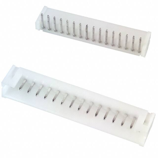

Crimp PH CONNECTOR Emboss Tape Disconnectable Crimp style connectors 2.0mm (.079") pitch Features –––––––––––––––––––––––– • Reliable contact The contact has long dimples near the center to ensure a good connection at all times, even under conditions of vibration and mechanical abuse, and when used with low voltage and low current circuits. • Fully shrouded header The fully shrouded header has walls on all four sides to prevent improper connection to the mating housing and to prevent the instruction of flux and other contaminants. • Printed circuit board retention mechanism The solder side of the header has a retention mechanism that prevents it from floating during soldering. As a result, the header can be positioned accurately. • Surface mount model (SMT) This connector is also available in a surface mount This is a thin, low-profile 2.0mm (.079") pitch connector 7.5mm (.295") in height after mounting and 4.5mm (.177") in width. It is designed to meet the demand for high-density connection of internal wires to printed circuit boards. It is compact, highly reliable and low in cost. configuration. Its housing is made of heat resistant resin so that it is not adversely affected during reflow soldering. Because of its tiny size and ability to be surface mounted, this connector meets the demand for high-density mounting of components inside electronic products. Specifications ––––––––––––––––––– • Current rating: 2A AC, DC (AWG #24) • Voltage rating: 100V AC, DC • Temperature range: -25˚C to +85˚C (including temperature rise in applying electrical current) • Contact resistance: Initial value/10m Ω max. After environmental testing/20m Ω max. • Insulation resistance: 1,000M Ω min. • Withstanding voltage: 800V AC/minute • Applicable wire: AWG #32 to #24 • Applicable PC board thickness: 0.8 to 1.6mm(.031" to .063") * Contact JST if Lead-Free product is required. * Refer to "General Instruction and Notice when using Terminals and Connectors" at the end of this catalog. * Contact JST for details. Standards –––––––––––––––––––––– 0 1 2 Recognized E60389 Certified LR20812 R75087 47 6 5 4 3 2 PH CONNECTOR Contact ––––––––––––––––––––––––––––––––––––––––––––––––––––––––––––––––– Applicable wire Model No. 5.7(.224) 2.05(.081) 1.0 (.039) AWG # Insulation O.D. mm(in.) SPH-002T-P0.5S 0.05 to 0.22 30 to 24 0.9 to 1.5(.035 to .059) SPH-002T-P0.5L 0.08 to 0.22 28 to 24 0.8 to 1.5(.031 to .059) 8,000 SPH-004T-P0.5S 0.032 to 0.08 32 to 28 0.5 to 0.9(.020 to .035) 10,000 8,000 Material and Finish 2.08 (.082) 2.85(.112) Q'ty / reel mm2 Phosphor bronze, tin-plated Note: 1. Contact JST for gold-plated contacts. 2. SPH-002T-P0.5L is low-insertion force type contact, for easier insertion/ withdrawal, which would be less resistant to the vibration. The crimp height is different from the standard. 3. When using AWG#32 or #30 wires, reflow-treated headers (Low insertion force type, Model No. B#B-PH-KL or S#B-PH-KL) are recommendable. 4. Contact JST for details. 1.5 (.059) Housing ––––––––––––––––––––––––––––––––––––––––––––––––––––––––––––––––– B 2.0 (.079) 4.5(.177) 6.35(.250) Circuit No.1 A 0.5 (.020) 1.9 (.075) 0.6(.024) Circuits Model No. 2 PHR- 2 3 PHR- 3 4 Dimensions mm(in.) B Q'ty / box 2.0( .079) 5.8( .228) 1,000 4.0( .157) 7.8( .307) 1,000 PHR- 4 6.0( .236) 9.8( .386) 1,000 5 PHR- 5 8.0( .315) 11.8( .465) 1,000 6 PHR- 6 10.0( .394) 13.8( .543) 1,000 7 PHR- 7 12.0( .472) 15.8( .622) 1,000 8 PHR- 8 14.0( .551) 17.8( .701) 1,000 9 PHR- 9 16.0( .630) 19.8( .780) 1,000 10 PHR-10 18.0( .709) 21.8( .858) 1,000 11 PHR-11 20.0( .787) 23.8( .937) 1,000 12 PHR-12 22.0( .866) 25.8(1.016) 1,000 13 PHR-13 24.0( .945) 27.8(1.094) 1,000 14 PHR-14 26.0(1.024) 29.8(1.173) 1,000 15 PHR-15 28.0(1.102) 31.8(1.252) 1,000 16 PHR-16 30.0(1.181) 33.8(1.331) 1,000 A Material Nylon 66, UL94V-0, natural (white) As the color identification, the following alphabet shall be put in the underlined part. For availability, delivery and minimum order quantity, contact JST. ex. 48 PHR-2-oo(blank)…natural (white) BK…black R…red TR…tomato red BL…blue Y…yellow L…lemon yellow M…green D…orange N…brown P…purple PK…pink H…gray LE…light blue FY…vivid yellow PH CONNECTOR Through-hole type shrouded header ––––––––––––––––––––––––––––––––––––––––– The shrouded headers are interchangeable with those of the KR, KRD and CR insulation displacement connectors. Model No. Top entry type (2 circuits) 4.5(.177) 1.7(.067) 4.5(.177) 1.7(.067) 6.0(.236) B A 3.4 (.134) 1.95 (.077) 3.4 (.134) 6.0(.236) B (3 circuits or more) 0.5 (.020) 2.0 (.079) A 1.95 (.077) Circuit No.1 0.5 (.020) Circuit No.1 Side entry type 1.95 (.077) 2.0 (.079) A 0.5 (.020) 1.6 (.063) 6.0(.236) 6.25(.246) 4.8(.189) 1.7(.067) B Circuit No.1 Q'ty / box Dimensions mm(in.) Circuits Top entry type Side entry type A 2 B 2B-PH-K-S S 2B-PH-K-S 2.0( .079) 3 B 3B-PH-K-S S 3B-PH-K-S 4.0( .157) 4 B 4B-PH-K-S S 4B-PH-K-S 6.0( .236) 5 B 5B-PH-K-S 6 Top entry type Side entry type 5.9( .232) 1,000 1,000 7.9( .311) 1,000 1,000 9.9( .390) 1,000 500 S 5B-PH-K-S 8.0( .315) 11.9( .469) 1,000 500 B 6B-PH-K-S S 6B-PH-K-S 10.0( .394) 13.9( .547) 1,000 500 7 B 7B-PH-K-S S 7B-PH-K-S 12.0( .472) 15.9( .626) 500 500 8 B 8B-PH-K-S S 8B-PH-K-S 14.0( .551) 17.9( .705) 500 250 9 B 9B-PH-K-S S 9B-PH-K-S 16.0( .630) 19.9( .783) 500 250 10 B10B-PH-K-S S10B-PH-K-S 18.0( .709) 21.9( .862) 500 250 11 B11B-PH-K-S S11B-PH-K-S 20.0( .787) 23.9( .941) 500 250 12 B12B-PH-K-S S12B-PH-K-S 22.0( .866) 25.9(1.020) 500 250 13 B13B-PH-K-S S13B-PH-K-S 24.0( .945) 27.9(1.098) 250 250 14 B14B-PH-K-S S14B-PH-K-S 26.0(1.024) 29.9(1.177) 250 250 15 B15B-PH-K-S S15B-PH-K-S 28.0(1.102) 31.9(1.256) 250 200 16 B16B-PH-K-S S16B-PH-K-S 30.0(1.181) 33.9(1.335) 250 200 3.4 (.134) B Material and Finish Post: Brass, copper-undercoated, tin/lead-plated Wafer: Nylon 66, UL94V-0, natural (white) As the color identification, the following alphabet shall be put in the underlined part. For availability, delivery and minimum order quantity, contact JST. ex. B2B-PH-K-ooS…natural (white) K…black R…red TR…tomato red E…blue Y…yellow L…lemon yellow M…green O…orange N…brown P…purple PK…pink H…gray LE…light blue FY…vivid yellow (blank)…ivory 49 PH CONNECTOR Through-hole type shrouded header ––––––––––––––––– Model No. Top entry type (2 circuits) (3 circuits or more) 4.5(.177) 1.7(.067) 4.5(.177) 1.7(.067) B 0.5 (.020) A 3.4 (.134) 3.4 (.134) 1.95 (.077) 6.0(.236) 6.0(.236) B Circuits Circuit No.1 2.0 (.079) A 1.95 (.077) 0.5 (.020) Circuit No.1 Side entry type 1.95 (.077) 2.0 (.079) A 0.5 (.020) 1.6 (.063) 6.0(.236) B 6.25(.246) 4.8(.189) 1.7(.067) Top entry type A B Top entry type Side entry type 2 B 2B-PH-KL S 2B-PH-KL 2.0( .079) 5.9( .232) 1,000 1,000 3 B 3B-PH-KL S 3B-PH-KL 4.0( .157) 7.9( .311) 1,000 1,000 4 B 4B-PH-KL S 4B-PH-KL 6.0( .236) 9.9( .390) 1,000 500 5 B 5B-PH-KL S 5B-PH-KL 8.0( .315) 11.9( .469) 1,000 500 6 B 6B-PH-KL S 6B-PH-KL 10.0( .394) 13.9( .547) 1,000 500 7 B 7B-PH-KL S 7B-PH-KL 12.0( .472) 15.9( .626) 500 500 8 B 8B-PH-KL S 8B-PH-KL 14.0( .551) 17.9( .705) 500 250 9 B 9B-PH-KL S 9B-PH-KL 16.0( .630) 19.9( .783) 500 250 10 B10B-PH-KL S10B-PH-KL 18.0( .709) 21.9( .862) 500 250 11 B11B-PH-KL S11B-PH-KL 20.0( .787) 23.9( .941) 500 250 12 B12B-PH-KL S12B-PH-KL 22.0( .866) 25.9(1.020) 500 250 13 B13B-PH-KL S13B-PH-KL 24.0( .945) 27.9(1.098) 250 250 14 B14B-PH-KL S14B-PH-KL 26.0(1.024) 29.9(1.177) 250 200 15 B15B-PH-KL S15B-PH-KL 28.0(1.102) 31.9(1.256) 250 200 16 B16B-PH-KL S16B-PH-KL 30.0(1.181) 33.9(1.335) 250 200 3.4 (.134) Circuit No.1 Q'ty / box Dimensions mm(in.) Side entry type Material and Finish Post: Copper alloy, copper-undercoated, tin/lead-plated (reflow-treated) Wafer: Nylon 66, UL94V-0, gray As the color identification, the following alphabet shall be put in the underlined part. For availability, delivery and minimum order quantity, contact JST. ex. B2B-PH-KL-oo(blank)…gray R…red E…blue S…natural (white) Through-hole type PC board layout (viewed from soldering side) and Assembly layout ––– Top entry type 4.5 (.177) 2.0±0.05 (.079±.002) Side entry type 2.0±0.05 (.079±.002) 0.7 + 00.1 (.028 + 0.004)dia. 4.8(.189) 0.7 + 0.1 0 (.028 + 0.004 )dia. 8.0(.315) 6.0(.236) 9.6(.378) 7.6(.299) 6.25 (.246) Note: 1. Tolerances are non-cumulative: ±0.05mm(±.002") for all centers. 2. Hole dimensions differ according to the kind of printed circuit board and piercing method. If printed circuit boards made of hard material are used, the hole dimensions should be larger. The hole dimensions shown above are reference values. Contact JST for details. 50 PH CONNECTOR SMT type shrouded header ––––––––––––––––––––––––––––––––––––––––––––––––– •The shrouded headers are interchangeable with those of the KR, KRD and CR insulation displacement connectors. ¨ V approved. •SMT type shrouded headers are not TU SM3 type SM3, SM4 type Top entry type B 5.0 (.197) 1.9(.075) A 2.0(.079) [2.0 (.079)] 6.6(.260) 2.975 (.117) 1.4 (.055) 2.2 (.087) Circuit No.1 5.5(.217) 2.4(.094) Side entry type 2.0 2.95 (.079) (.116) A B Dimensions mm(in.) Model No. Circuits Top entry type Side entry type B Top entry type Side entry type A Q'ty / reel 2 B 2B-PH-SM3-TB S 2B-PH-SM3-TB 2.0( .079) 7.95( .313) 7.9( .311) 1,000 3 B 3B-PH-SM3-TB S 3B-PH-SM3-TB 4.0( .157) 9.95( .392) 9.9( .390) 1,000 4 B 4B-PH-SM3-TB S 4B-PH-SM3-TB 6.0( .236) 11.95( .470) 11.9( .469) 1,000 5 B 5B-PH-SM3-TB S 5B-PH-SM3-TB 8.0( .315) 13.95( .549) 13.9( .547) 1,000 6 B 6B-PH-SM3-TB S 6B-PH-SM3-TB 10.0( .394) 15.95( .628) 15.9( .626) 1,000 7 B 7B-PH-SM3-TB S 7B-PH-SM3-TB 12.0( .472) 17.95( .707) 17.9( .705) 1,000 8 B 8B-PH-SM3-TB S 8B-PH-SM3-TB 14.0( .551) 19.95( .785) 19.9( .783) 1,000 9 B 9B-PH-SM3-TB S 9B-PH-SM3-TB 16.0( .630) 21.95( .864) 21.9( .862) 1,000 10 B10B-PH-SM3-TB S10B-PH-SM3-TB 18.0( .709) 23.95( .943) 23.9( .941) 1,000 11 B11B-PH-SM3-TB 20.0( .787) 25.95(1.022) 25.9(1.020) 1,000 12 B12B-PH-SM3-TB S12B-PH-SM3-TB 22.0( .866) 27.95(1.100) 27.9(1.098) 1,000 13 B13B-PH-SM3-TB S13B-PH-SM3-TB 24.0( .945) 29.95(1.179) 29.9(1.177) 1,000 14 B14B-PH-SM3-TB S14B-PH-SM3-TB 26.0(1.024) 31.95(1.258) 31.9(1.256) 1,000 15 B15B-PH-SM3-TB S15B-PH-SM3-TB 28.0(1.102) 33.95(1.337) 33.9(1.335) 1,000 16 B16B-PH-SM3-TB – – 30.0(1.181) 35.95(1.415) 35.9(1.413) 1,000 Material and Finish 1.6 (.063) 6.0(.236) Post: Copper alloy, copper-undercoated, tin/lead-plated Wafer: Nylon 46, UL94V-0, natural (white) Solder tab: Brass, copper-undercoated, tin/lead-plated [2.6 (.102)] Note: Contact JST for the top entry type headers with suction cap. SM4 type Dimensions mm(in.) Model No. Circuits Top entry type Side entry type A B Top entry type Side entry type Q'ty / reel 2 B 2B-PH-SM4-TB S 2B-PH-SM4-TB 2.0( .079) 7.95( .313) 7.9( .311) 1,000 3 B 3B-PH-SM4-TB S 3B-PH-SM4-TB 4.0( .157) 9.95( .392) 9.9( .390) 1,000 4 B 4B-PH-SM4-TB S 4B-PH-SM4-TB 6.0( .236) 11.95( .470) 11.9( .469) 1,000 5 B 5B-PH-SM4-TB S 5B-PH-SM4-TB 8.0( .315) 13.95( .549) 13.9( .547) 1,000 6 B 6B-PH-SM4-TB S 6B-PH-SM4-TB 10.0( .394) 15.95( .628) 15.9( .626) 1,000 7 B 7B-PH-SM4-TB S 7B-PH-SM4-TB 12.0( .472) 17.95( .707) 17.9( .705) 1,000 8 B 8B-PH-SM4-TB S 8B-PH-SM4-TB 14.0( .551) 19.95( .785) 19.9( .783) 1,000 9 B 9B-PH-SM4-TB S 9B-PH-SM4-TB 16.0( .630) 21.95( .864) 21.9( .862) 1,000 10 B10B-PH-SM4-TB S10B-PH-SM4-TB 18.0( .709) 23.95( .943) 23.9( .941) 1,000 11 B11B-PH-SM4-TB S11B-PH-SM4-TB 20.0( .787) 25.95(1.022) 25.9(1.020) 1,000 12 B12B-PH-SM4-TB S12B-PH-SM4-TB 22.0( .866) 27.95(1.100) 27.9(1.098) 1,000 13 B13B-PH-SM4-TB S13B-PH-SM4-TB 24.0( .945) 29.95(1.179) 29.9(1.177) 1,000 14 B14B-PH-SM4-TB S14B-PH-SM4-TB 26.0(1.024) 31.95(1.258) 31.9(1.256) 1,000 15 B15B-PH-SM4-TB S15B-PH-SM4-TB 28.0(1.102) 33.95(1.337) 33.9(1.335) 1,000 16 B16B-PH-SM4-TB – 30.0(1.181) 35.95(1.415) – 1,000 Material and Finish Post: Copper alloy, copper-undercoated, tin-plated Wafer: 6T nylon, UL94V-0, natural (white) Solder tab: Brass, nickel-undercoated, tin/copper alloy-plated Note: Contact JST for the top entry type headers with suction cap. As the color identification, the following alphabet shall be put in the underlined part. For availability, delivery and minimum order quantity, contact JST. ex. B2B-PH-SM3-oo-TB (blank)…natural (white) R…red E…blue M…green L…lemon yellow K…black 51 PH CONNECTOR Taping specifications –––––––––––––––––––––––––––––––––––––––––––––––––––––– 380 ± 2.0(14.961 ± .079)dia. Feeding direction [13(.512)dia.] W1 +- 2.5 1.0 ( +- .098 .039 ) Feeding direction Carrier tape Leader part The end 100(3.937)min. part 160 Connector (6.299)min. mounting part 400(15.748)min. 2.0 ± 0.5 (.079 ± .020) Top entry type (7 to 16 circuits) Feeding direction 1.55±0.05 (.061±.002)dia. 4.0±0.1 (.157±.004) 1.55±0.05 (.061±.002)dia. 4.0±0.1 (.157±.004) 1.75±0.1 (.069±.004) Feeding direction 2.0±0.1 (.079±.004) 1.75±0.1 (.069±.004) Top entry type (2 to 6 circuits) 2.0±0.1 (.079±.004) Cover tape leader Cover tape F±0.1 (.004) S±0.1(.004) W±0.3(.012) F±0.1 (.004) W±0.3(.012) Cover tape Carrier tape 12.0±0.1 (.472±.004) Side entry type (2 to 6 circuits) Side entry type (7 to 15 circuits) Feeding direction 2.0±0.1 (.079±.004) 1.55±0.05 (.061±.002)dia. 4.0±0.1 (.157±.004) Cover tape 2.0±0.1 (.079±.004) 1.75 ± 0.1 (.069 ±.004) Feeding direction 1.75±0.1 (.069±.004) 1.55±0.05 (.061±.002)dia. 4.0±0.1 (.157±.004) Carrier tape 12.0±0.1 (.472±.004) F ±0.1 (.004) S±0.1(.004) W±0.3(.012) F±0.1 (.004) W±0.3(.012) Cover tape Carrier tape Carrier tape 12.0±0.1 (.472±.004) 12.0±0.1 (.472±.004) Taping dimensions mm(in.) Circuits Top entry type Side entry type 52 Reel dimensions mm(in.) Q'ty / reel F S W W1 2 to 3 7.5( .295) – 16.0( .630) 17.5( .689) 1,000 4 to 6 11.5( .453) – 24.0( .945) 25.5(1.004) 1,000 7 to 9 14.2( .559) 28.4(1.118) 32.0(1.260) 33.5(1.319) 1,000 10 to 14 20.2( .795) 40.4(1.591) 44.0(1.732) 45.5(1.791) 1,000 15 to 16 26.2(1.031) 52.4(2.063) 56.0(2.205) 57.5(2.264) 1,000 2 to 3 7.5( .295) – 16.0( .630) 17.5( .689) 1,000 4 to 6 11.5( .453) – 24.0( .945) 25.5(1.004) 1,000 7 to 9 14.2( .559) 28.4(1.118) 32.0(1.260) 33.5(1.319) 1,000 10 to 14 20.2( .795) 40.4(1.591) 44.0(1.732) 45.5(1.791) 1,000 15 26.2(1.031) 52.4(2.063) 56.0(2.205) 57.5(2.264) 1,000 Note: 1. Specifications conform to JIS C 0806. The tape width, connector loading recess square hole dimensions, etc. are determined by the number of circuits and external shape of the connector to be loaded. 2. Specifications are subject to change without prior notice. PH CONNECTOR SMT type PC board layout (viewed from component side) and Assembly layout ––––––––– SM3, SM4 type Top entry type Side entry type 1.6±0.1 2.0±0.05 (.063±.004) (.079±.002) 1.0 (.039) min. End face of wafer on the mating side 9.6(.378) 1.0(.039) 7.6(.299) 5.5(.217) 1.5±0.1 (.059±.004) 5.5(.217)max. 9.0(.354)min. 8.6(.339) 6.6(.260) End face of wafer on the mating side 2.0(.079) max. 7.5(.295) min. 3.0±0.1 1.0 (.118±.004) (.039) [2.0(.079)] 3.4±0.1 (.134±.004) 0.2 (.008) 5.0(.197) 1.6±0.1 1.6±0.1 2.0±0.05 (.063±.004) (.063±.004) (.079±.002) 1.0 (.039) min. Note: 1. Tolerances are non-cumulative: ±0.05mm(±.002" ) for all centers. 2. The dimensions above should serve as a guideline. Contact JST for details. Applicator for the semi-automatic press AP-K2N ––––––––––––––––––––––––––––––– Contact SPH-002T-P0.5S SPH-004T-P0.5S SPH-002T-P0.5L Crimp applicator MKS-L(-10) with safety cover without safety cover Compact crimp applicator MKS-LS with safety cover without safety cover Strip-crimp applicator MKS-SC with safety cover APLMK SPH002-05S APLNC SPH002-05S APLMKLS SPH002-05S APLLSNC SPH002-05S APLSC SPH002-05S APLMK SPH004-05S APLNC SPH004-05S – – APLSC SPH004-05S APLMK SPH002-05L APLNC SPH002-05L APLMKLS SPH002-05L APLLSNC SPH002-05L APLSC SPH002-05L 53

物料型号: - 该连接器型号包括SPH-002T-P0.5S、SPH-002T-P0.5L、SPH-004T-P0.5S等,具体型号取决于适用的电线规格和绝缘外径。
器件简介: - 这是一种2.0mm间距的低矮型连接器,设计用于满足印刷电路板上内部线缆的高密度连接需求。它具有紧凑、高可靠性和低成本的特点。
引脚分配: - 引脚分配信息未在文档中明确列出,但提供了不同型号的适用电线规格和绝缘外径范围。
参数特性: - 电流额定值:2A AC/DC(AWG #24) - 电压额定值:100V AC/DC - 温度范围:-25°C至+85°C - 接触电阻:初始值/10mΩ最大,环境测试后/20mΩ最大 - 绝缘电阻:最小1,000MΩ - 耐电压:800V AC/分钟 - 适用电线:AWG #32至#24 - 适用PCB板厚:0.8至1.6mm(.031"至.063")
功能详解: - 连接器具有可靠的接触、全遮蔽式针头、PCB固定机制和表面贴装型号(SMT)。
应用信息: - 该连接器适用于需要高密度组件安装的电子产品内部。
封装信息: - 提供了不同电路数量的型号,包括2至16个电路的型号,以及它们的尺寸和每盒数量。
材料和表面处理: - 接触材料为锡磷青铜,镀锡处理;外壳材料为尼龙66,UL94V-0,自然色(白色)。还提供了金镀接触的选项。
标准: - 该连接器符合E60389认证,LR20812和R75087标准。
