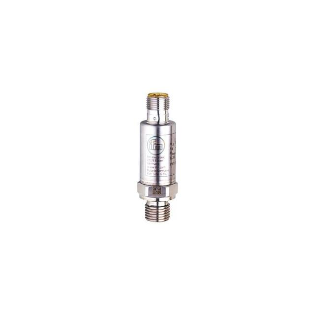

PT5412 Pressure transmitter PT-160-SEG14-A-ZVG/US/ 1 /W Sealing Product characteristics Output signal analogue signal Measuring range 0...160 bar Process connection 0...2320 psi 0...16 MPa threaded connection G 1/4 external thread (DIN EN ISO 1179-2) Application Application for industrial applications Media liquids and gases Medium temperature [°C] -40...90 Min. bursting pressure 1100 bar 15950 psi 110 MPa Pressure rating 400 bar 5800 psi 40 Mpa Note on pressure rating Vacuum resistance static [mbar] Type of pressure -1000 relative pressure Electrical data Operating voltage Min. insulation resistance [V] [MΩ] Protection class 100; (500 V DC) III Reverse polarity protection Power-on delay time 8.5...36 DC yes [s] < 0.1 Inputs / outputs Number of inputs and outputs Number of analogue outputs: 1 ifm electronic gmbh • Friedrichstraße 1 • 45128 Essen — We reserve the right to make technical alterations without prior notice. — EN-GB — PT5412-01 — 07.09.2015 — PT5412 Pressure transmitter PT-160-SEG14-A-ZVG/US/ /W Outputs Total number of outputs 1 Output signal analogue signal Number of analogue outputs 1 Analogue current output [mA] Max. load [Ω] 4...20 (Ub – 8,5 V) / 21,5 mA; @8,5V= 0 Ω; @12V max. 160 Ω; @24V max. 720 Ω Short-circuit proof yes Overload protection yes Measuring/setting range Measuring range 0...160 bar 0...2320 psi 0...16 MPa Accuracy / deviations Repeatability [% of the span] Characteristics deviation [% of the span] < ± 0,05; (with temperature fluctuations < 10 K) < ± 0,5; (incl. drift when overtightened, zero point and span error, non-linearity, hysteresis) Linearity deviation < ± 0,1 (BFSL) / < ± 0,2 (LS) [% of the span] Hysteresis deviation < ± 0,2 [% of the span] Long-term stability < ± 0,1; (per 6 months) [% of the span] Temperature coefficient zero point and span [% of the span / 10 K] < 0,1 (-25...90 °C) / < 0,2 (-40...-25 °C) Response times Step response time analogue output [ms] 1 Ambient temperature [°C] -40...90 Storage temperature [°C] -40...100 Operating conditions Protection IP 67; IP 69K Tests / approvals DIN EN 61000-6-2 EMC DIN EN 61000-6-3 Shock resistance DIN EN 60068-2-27 Vibration resistance MTTF 50 g (11 ms) DIN EN 60068-2-6 [years] UL approval Pressure Equipment Directive 20 g (10...2000 Hz) 784 UL Approval no. J026 Sound engineering practice; can be used for group 2 fluids; group 1 fluids on request ifm electronic gmbh • Friedrichstraße 1 • 45128 Essen — We reserve the right to make technical alterations without prior notice. — EN-GB — PT5412-01 — 07.09.2015 — PT5412 Pressure transmitter PT-160-SEG14-A-ZVG/US/ /W Mechanical data Weight [g] 60 Materials 1.4542 (17-4 PH / 630); stainless steel (1.4404 / 316L); PEI Materials (wetted parts) 1.4542 (17-4 PH / 630) Min. pressure cycles Tightening torque 60 million; (at 1.2 times nominal pressure) [Nm] 25...35; (recommended tightening torque; depends on lubrication, seal and pressure rating) Process connection Process connection sealing Restrictor element integrated threaded connection G 1/4 external thread (DIN EN ISO 1179-2) FKM (DIN EN ISO 1179-2) no (can be retrofitted) Remarks BFSL = Best Fit Straight Line Remarks LS = limit value setting Pack quantity 1 pcs. Electrical connection Connector: 1 x M12 Connection OUT analogue output The following pin connection is available at article number PT53xx Pin 1: L+, Pin 3: OUT colours to DIN EN 60947-5-2 Core colours : BN brown WH white ifm electronic gmbh • Friedrichstraße 1 • 45128 Essen — We reserve the right to make technical alterations without prior notice. — EN-GB — PT5412-01 — 07.09.2015 —
