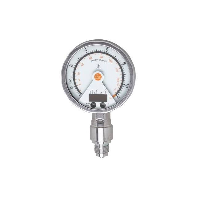

PG2454 Pressure sensor with analogue display PG-010-REB12-MFRKG/US/ 1 2 3 /P analogue display alphanumeric display 4-digit sensor field (programming button) Product characteristics Output signal switching signal; analogue signal; (configurable) Measuring range -1...10 bar Process connection -14.4...145 psi threaded connection G 1/2 external thread Application Special feature Gold-plated contacts Application for industrial applications Media liquids and gases Medium temperature [°C] -25...80 Min. bursting pressure 150 bar 2175 psi Pressure rating 50 bar 725 psi Type of pressure MAWP (for applications according to CRN) relative pressure; vacuum 38 bar 551 psi ifm electronic gmbh • Friedrichstraße 1 • 45128 Essen — We reserve the right to make technical alterations without prior notice. — EN-GB — PG2454-01 — 01.04.2021 — PG2454 Pressure sensor with analogue display PG-010-REB12-MFRKG/US/ /P Electrical data Operating voltage [V] 18...32 DC Current consumption [mA] < 70; (24 V) Min. insulation resistance [MΩ] 100; (500 V DC) Protection class III Reverse polarity protection Power-on delay time yes [s] 6 Integrated watchdog yes Inputs / outputs Number of inputs and outputs Number of digital outputs: 1; Number of analogue outputs: 1 Outputs Total number of outputs 2 Output signal switching signal; analogue signal; (configurable) Electrical design PNP/NPN Number of digital outputs 1 Output function normally open / normally closed; (parameterisable) Max. voltage drop switching output DC [V] Permanent current rating of switching output DC [mA] 250 Switching frequency DC [Hz] 75 2 Number of analogue outputs Analogue current output Max. load 1 [mA] 4...20, invertible; (scalable) [Ω] (Ub - 10 V) / 20 mA Short-circuit protection yes Type of short-circuit protection pulsed Overload protection yes Measuring/setting range Measuring range -1...10 bar -14.4...145 psi Set point SP -0.96...16 bar -14...232 psi Reset point rP -1...15.96 bar -14.4...231.6 psi Analogue start point -1...13.5 bar -14.4...195.8 psi Analogue end point 1.5...16 bar 21.8...232 psi 0.02 bar 0.2 psi In steps of Accuracy / deviations Switch point accuracy [% of the span] Repeatability [% of the span] Characteristics deviation [% of the span] Hysteresis deviation [% of the span] Long-term stability < ± 0,5; (Turn down 1:1) < ± 0,1; (with temperature fluctuations < 10 K; Turn down 1:1) < ± 0,25 (BFSL) / < ± 0,5 (LS); (Turn down 1:1; BFSL = Best Fit Straight Line) < ± 0,25; (Turn down 1:1) < ± 0,1; (Turn down 1:1; per 6 months) ifm electronic gmbh • Friedrichstraße 1 • 45128 Essen — We reserve the right to make technical alterations without prior notice. — EN-GB — PG2454-01 — 01.04.2021 — PG2454 Pressure sensor with analogue display PG-010-REB12-MFRKG/US/ /P [% of the span] Temperature coefficient zero point [% of the span / 10 K] < ± 0,2; (0...70 °C) Temperature coefficient span [% of the span / 10 K] < ± 0,2; (0...70 °C) Response times Response time [ms]

物料型号为PG2454,是一款带模拟显示的压力传感器。
器件简介包括模拟显示和数字显示,4位数字传感器场(编程按钮),以及CE、CRN、S、ERC等认证标志。
引脚分配包括1个M12连接器,2个输出(OUT1为开关输出,OUT2为模拟输出)。
参数特性包括测量范围-1...10bar(-14.4...145 psi),过程连接为G1/2外螺纹,应用为工业应用,介质为液体和气体,介质温度范围-25...80°C,最小爆破压力150bar(2175 psi),压力额定值为50bar(725 psi),测量类型为相对压力和真空。
功能详解包括电气数据、输入/输出、测量/设置范围、精度/偏差、长期稳定性、温度系数、响应时间、操作条件、保护等级、测试/认证、机械数据、显示/操作元素等。
应用信息为适用于工业应用,封装信息为重量约608克,材料包括不锈钢(1.4404/316L)、PA、FKM、PTFE、视窗玻璃:4毫米层压安全玻璃,过程连接为G1/2外螺纹,显示单元包括2个绿色LED、1个黄色LED、1个红色LED环、红色4位数字显示,具有模拟显示和数字显示功能。
