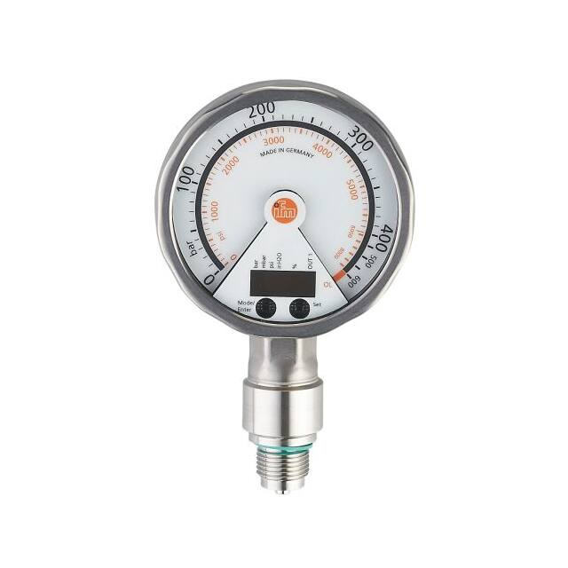

PG2451 Pressure sensor with analogue display PG-250-REB12-MFRKG/US/ /P Product characteristics Output signal switching signal; analogue signal; (configurable) Measuring range 0...250 bar Process connection 0...3625 psi threaded connection G 1/2 external thread Application Special feature Gold-plated contacts Application for industrial applications Media liquids and gases Conditionally suitable for Medium temperature use in gases at pressures > 25 bar only on request [°C] -25...80 Min. bursting pressure 1000 bar Pressure rating 600 bar Type of pressure 14500 psi 8700 psi relative pressure ifm electronic gmbh • Friedrichstraße 1 • 45128 Essen — We reserve the right to make technical alterations without prior notice. — EN-GB — PG2451-00 — 01.04.2021 — PG2451 Pressure sensor with analogue display PG-250-REB12-MFRKG/US/ /P Electrical data Operating voltage [V] 18...32 DC Current consumption [mA] < 70; (24 V) Min. insulation resistance [MΩ] 100; (500 V DC) Protection class III Reverse polarity protection Power-on delay time yes [s] 6 Integrated watchdog yes Inputs / outputs Number of inputs and outputs Number of digital outputs: 1; Number of analogue outputs: 1 Outputs Total number of outputs 2 Output signal switching signal; analogue signal; (configurable) Electrical design PNP/NPN Number of digital outputs 1 Output function normally open / normally closed; (parameterisable) Max. voltage drop switching output DC [V] Permanent current rating of switching output DC [mA] 250 Switching frequency DC [Hz] 75 2 Number of analogue outputs Analogue current output Max. load 1 [mA] 4...20, invertible; (scalable) [Ω] (Ub - 10 V) / 20 mA Short-circuit protection yes Type of short-circuit protection pulsed Overload protection yes Measuring/setting range Measuring range 0...250 bar 0...3625 psi Set point SP 1...400 bar 15...5800 psi Reset point rP 0...399 bar 0...5785 psi Analogue start point 0...350 bar 0...5075 psi Analogue end point 50...400 bar 725...5800 psi 0.5 bar 5 psi In steps of Accuracy / deviations Switch point accuracy [% of the span] Repeatability [% of the span] Characteristics deviation [% of the span] Hysteresis deviation [% of the span] Long-term stability < ± 0,6; (Turn down 1:1) < ± 0,1; (with temperature fluctuations < 10 K; Turn down 1:1) < ± 0,35 (BFSL) / < ± 0,6 (LS); (Turn down 1:1; BFSL = Best Fit Straight Line) < ± 0,5; (Turn down 1:1) < ± 0,1; (Turn down 1:1; per 6 months) ifm electronic gmbh • Friedrichstraße 1 • 45128 Essen — We reserve the right to make technical alterations without prior notice. — EN-GB — PG2451-00 — 01.04.2021 — PG2451 Pressure sensor with analogue display PG-250-REB12-MFRKG/US/ /P [% of the span] Temperature coefficient zero point [% of the span / 10 K] < ± 0,3; (0...70 °C) Temperature coefficient span [% of the span / 10 K] < ± 0,3; (0...70 °C) Response times Response time [ms]

物料型号:PG2451
器件简介: - 该传感器具有模拟显示功能,适用于工业应用。 - 特殊特性包括镀金触点。
引脚分配: - 电气连接:1个M12连接器,触点镀金。 - 引脚功能: - L+:电源正极 - OUT1:开关输出 - OUT2:模拟输出
参数特性: - 输出信号:可配置的开关信号或模拟信号。 - 测量范围:0...250 bar(0...3625 psi)。 - 过程连接:G1/2外螺纹。 - 介质:液体和气体。 - 介质温度:-25...80°C。 - 最小爆破压力:1000 bar(14500 psi)。 - 压力额定值:600 bar(8700 psi)。 - 压力类型:相对压力。
功能详解: - 电气数据: - 工作电压:18...32 DC。 - 电流消耗:<70 mA(24V)。 - 绝缘电阻:最小100 MΩ(500V DC)。 - 反极性保护:有。 - 上电延时:6秒。 - 内置看门狗:有。 - 输入/输出: - 数字输出数量:1。 - 模拟输出数量:1。 - 输出信号:可配置的开关信号或模拟信号。 - 电气设计:PNP/NPN。 - 数字输出功能:常开/常闭(可参数化)。 - 最大电压降:2V DC。 - 永久电流额定值:250 mA。 - 开关频率:75 Hz。 - 模拟电流输出:4...20 mA,可逆(可扩展)。 - 最大负载:(Ub - 10V) / 20 mA。 - 短路保护:有。 - 过载保护:有。
应用信息: - 适用于工业应用。 - 适用于液体和气体的测量。 - 可在大于25bar的压力下使用气体,但需特别要求。
封装信息: - 重量:611.5克(包括不锈钢、PA、FKM、PTFE、4毫米层压安全玻璃视窗)。 - 材料: - 接触介质部分:Al203(陶瓷)、FKM、不锈钢(1.4404 / 316L)。 - 过程连接:G1/2外螺纹。 - 显示/操作元件:2个绿色LED显示单元,黄色开关状态LED,红色开关点LED环,红色4位数字功能显示,模拟显示(0...350可旋转,单元断开时指针不可见),红色4位数字显示测量值,带刻度,扩展显示范围(最大)400 bar(5800 psi)。
