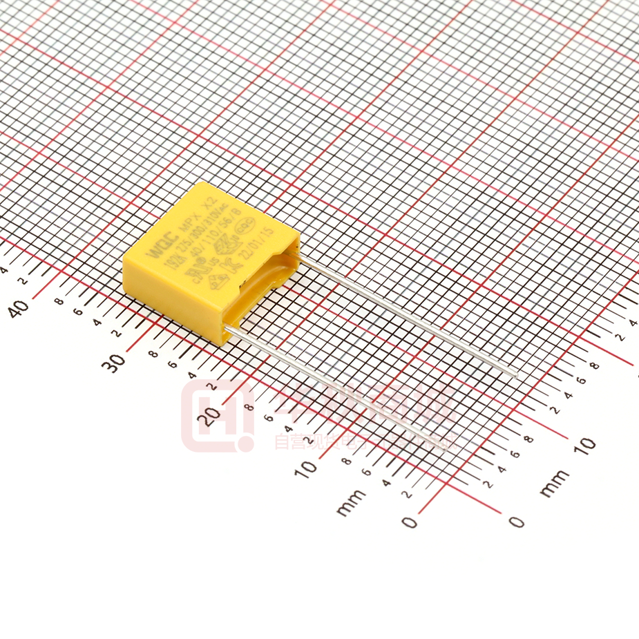

    安规电容 径向 1.9nF ±10% 310V
C50Q3192KC2L230210 数据手册
C50 MKP62 Series CQC 10 CQC () ENEC-VDE () UL/CUL (/ ) KC ( ) CB TEST CERTIFICATE WQC GB/T 14472-1993,X2,275Vac,300Vac,310Vac, 0.0010uF~3.3uF, 40/110/56/B (Certificate No.):CQC14001113971 EN 60384-14:2006-04,X2,275Vac,300Vac,310Vac, 0.0010uF~3.3uF, 40/110/56/B (Certificate No.):40040406 UL 60384-14:2009,X2,275Vac,300Vac,310Vac, 0.0010uF~3.3uF, 40/110/56/B (Certificate No.):E466405,CCN:FOWX2/8 KC 60384-14/1(2014-09),X2,275Vac,300Vac,310Vac, 0.0010uF~3.3uF, 40/110/56/B (Certificate No.):SU03073-14001/14002/14003 IEC 60384-14:2005,X2,275Vac,300Vac,310Vac, 0.0010uF~3.3uF, 40/110/56/B (Certificate No.):CN29302 R WQC R C50 MKP62 Series WQC C50 MKP62 Series R ■ Dimemsioms(mm) 275Vac/300Vac/310Vac 275Vac/300Vac/310Vac CN (μF) w H T P d 0.0010 10.5 9.0 4.0 7.5 0.6 B3LT C50Q3102KB3L23**** 0.0022 10.5 9.0 4.0 7.5 0.6 B3LT C50Q3222KB3L23**** 0.0047 10.5 9.0 4.0 7.5 0.6 0.0100 10.5 9.0 4.0 7.5 0.0220 10.5 9.0 4.0 0.0022 10.5 12.0 0.0047 BOX CN (µF) 275Vac/300Vac/310Vac H T P d 0.15 13.0 14.0 8.0 10.0 0.6 C5LT C50Q3154KC5L23**** 0.18 13.0 14.0 8.0 10.0 0.6 C5LT C50Q3184KC5L23**** B3LT C50Q3472KB3L23**** 0.22 13.0 14.0 8.0 10.0 0.6 0.6 B3LT C50Q3103KB3L23**** 0.15 13.0 15.0 8.0 10.0 7.5 0.6 B3LT C50Q3223KB3L23**** 0.18 13.0 15.0 8.0 6.0 7.5 0.6 B5LT C50Q3222KB5L23**** 0.22 13.0 15.0 10.5 12.0 6.0 7.5 0.6 B5LT C50Q3472KB5L23**** 0.0010 0.010 10.5 12.0 6.0 7.5 0.6 B5LT C50Q3103KB5L23**** 0.033 10.5 12.0 6.0 7.5 0.6 0.039 10.5 12.0 6.0 7.5 0.047 10.5 12.0 6.0 0.056 10.5 12.0 0.068 CN (μF) T P d 0.33 18.0 15.5 9.5 15.0 0.8 D5 C50Q3334KD5L23**** 0.39 18.0 15.5 9.5 15.0 0.8 D5 C50Q3394KD5L23**** C5LT C50Q3224KC5L23**** 0.47 18.0 15.5 9.5 15.0 0.8 D5 C50Q3474KD5L23**** 0.6 C8LT C50Q3154KC8L23**** 0.47 18.0 19.0 11.0 15.0 0.8 D7 C50Q3474KD7L23**** 10.0 0.6 C8LT C50Q3184KC8L23**** 0.22 26.5 16.5 7.0 22.5 0.8 E2 C50Q3224KE2L23**** 8.0 10.0 0.6 C8LT C50Q3224KC8L23**** 0.33 26.5 17.0 8.5 22.5 0.8 E3 C50Q3334KE3L23**** 18.0 11.0 5.0 15.0 0.8 D1 C50Q3102KD1L23**** 0.47 26.5 19.0 10.0 22.5 0.8 E4 C50Q3474KE4L23**** 0.0022 18.0 11.0 5.0 15.0 0.8 D1 C50Q3222KD1L23**** 0.56 26.5 19.0 10.0 22.5 0.8 E4 C50Q3564KE4L23**** B5LT C50Q3333KB5L23**** 0.0047 18.0 11.0 5.0 15.0 0.8 D1 C50Q3472KD1L23**** 0.68 26.5 19.0 10.0 22.5 0.8 E4 C50Q3684KE4L23**** 0.6 B5LT C50Q3393KB5L23**** 0.010 18.0 11.0 5.0 15.0 0.8 D1 C50Q3103KD1L23**** 0.82 26.5 19.0 10.0 22.5 0.8 E4 C50Q3824KE4L23**** 7.5 0.6 B5LT C50Q3473KB5L23**** 0.033 18.0 11.0 5.0 15.0 0.8 D1 C50Q3333KD1L23**** 1.00 26.5 19.0 10.0 22.5 0.8 E4 C50Q3105KE4L23**** 6.0 7.5 0.6 B5LT C50Q3563KB5L23**** 0.039 18.0 11.0 5.0 15.0 0.8 D1 C50Q3393KD1L23**** 0.68 32.0 20.0 11.0 27.5 0.8 F1 C50Q3684KF1L23**** 10.5 12.0 6.0 7.5 0.6 B5LT C50Q3683KB5L23**** 0.047 18.0 11.0 5.0 15.0 0.8 D1 C50Q3473KD1L23**** 1.0 32.0 22.0 13.0 27.5 0.8 F2 C50Q3105KF2L23**** 0.082 10.5 12.0 6.0 7.5 0.6 B5LT C50Q3823KB5L23**** 0.056 18.0 11.0 5.0 15.0 0.8 D1 C50Q3563KD1L23**** 1.2 32.0 22.0 13.0 27.5 0.8 F2 C50Q3125KF2L23**** 0.10 10.5 12.0 6.0 7.5 0.6 B5LT C50Q3104KB5L23**** 0.068 18.0 11.0 5.0 15.0 0.8 D1 C50Q3683KD1L23**** 1.5 32.0 22.0 13.0 27.5 0.8 F2 C50Q3155KF2L23**** 0.0010 13.0 9.0 4.0 10.0 0.6 C1 C50Q3102KC1L23**** 0.082 18.0 12.0 6.0 15.0 0.8 D2 C50Q3823KD2L23**** 1.8 32.0 25.0 14.0 27.5 0.8 F3 C50Q3185KF3L23**** 0.0022 13.0 9.0 4.0 10.0 0.6 C1 C50Q3222KC1L23**** 0.033 18.0 12.0 6.0 15.0 0.8 D2 C50Q3333KD2L23**** 2.0 32.0 25.0 14.0 27.5 0.8 F3 C50Q3205KF3L23**** 0.0047 13.0 9.0 4.0 10.0 0.6 C1 C50Q3472KC1L23**** 0.039 18.0 12.0 6.0 15.0 0.8 D2 C50Q3393KD2L23**** 2.7 32.0 25.0 14.0 27.5 0.8 F3 C50Q3275KF3L23**** 0.0010 12.0 11.0 5.0 10.0 0.6 C2 C50Q3102KC2L23**** 0.047 18.0 12.0 6.0 15.0 0.8 D2 C50Q3473KD2L23**** 3.0 32.0 28.0 18.0 27.5 0.8 Fc C50Q3305KFcL23**** 0.0022 12.0 11.0 5.0 10.0 0.6 C2 C50Q3222KC2L23**** 0.056 18.0 12.0 6.0 15.0 0.8 D2 C50Q3563KD2L23**** 3.3 32.0 28.0 18.0 27.5 0.8 Fc C50Q3335KFcL23**** 0.0047 12.0 11.0 5.0 10.0 0.6 C2 C50Q3472KC2L23**** 0.068 18.0 12.0 6.0 15.0 0.8 D2 C50Q3683KD2L23**** 0.010 12.0 11.0 5.0 10.0 0.6 C2 C50Q3103KC2L23**** 0.082 18.0 12.0 6.0 15.0 0.8 D2 C50Q3823KD2L23**** 0.033 12.0 11.0 5.0 10.0 0.6 C2 C50Q3333KC2L23**** 0.10 18.0 12.0 6.0 15.0 0.8 D2 C50Q3104KD2L23**** 0.039 12.0 11.0 5.0 10.0 0.6 C2 C50Q3393KC2L23**** 0.12 18.0 12.0 6.0 15.0 0.8 D2 C50Q3124KD2L23**** 0.047 12.0 11.0 5.0 10.0 0.6 C2 C50Q3473KC2L23**** 0.15 18.0 12.0 6.0 15.0 0.8 D2 C50Q3154KD2L23**** 0.056 12.0 11.0 5.0 10.0 0.6 C2 C50Q3563KC2L23**** 0.18 18.0 12.0 6.0 15.0 0.8 D2 C50Q3184KD2L23**** 0.068 12.0 11.0 5.0 10.0 0.6 C2 C50Q3683KC2L23**** 0.22 18.0 12.0 6.0 15.0 0.8 D2 C50Q3224KD2L23**** 0.082 12.0 11.0 5.0 10.0 0.6 C2 C50Q3823KC2L23**** 0.12 18.0 13.5 7.5 15.0 0.8 D3 C50Q3124KD3L23**** 0.10 12.0 11.0 5.0 10.0 0.6 C2 C50Q3104KC2L23**** 0.15 18.0 13.5 7.5 15.0 0.8 D3 C50Q3154KD3L23**** 0.047 13.0 12.0 6.0 10.0 0.6 C3 C50Q3473KC3L23**** 0.18 18.0 13.5 7.5 15.0 0.8 D3 C50Q3184KD3L23**** 0.056 13.0 12.0 6.0 10.0 0.6 C3 C50Q3563KC3L23**** 0.22 18.0 13.5 7.5 15.0 0.8 D3 C50Q3224KD3L23**** 0.068 13.0 12.0 6.0 10.0 0.6 C3 C50Q3683KC3L23**** 0.22 18.0 14.5 8.5 15.0 0.8 D4 C50Q3224KD4L23**** 0.082 13.0 12.0 6.0 10.0 0.6 C3 C50Q3823KC3L23**** 0.27 18.0 14.5 8.5 15.0 0.8 D4 C50Q3274KD4L23**** 0.10 13.0 12.0 6.0 10.0 0.6 C3 0.33 18.0 14.5 8.5 15.0 0.8 D4 C50Q3334KD4L23**** Part number C50Q3104KC3L23**** 1."****" .Internal use. TYPE Part number W BOX H TYPE W BOX TYPE Part number DONGGUAN WEIQING ELECTRONICS CO., LTD. Add: 1st Floor, Building 12, No.7 Tenth Road of Science&Technology, SongShan Lake High-tech Industrial Development Zone, Dongguan, Guangdong TEL: 0769-88956188 88956198 FAX:0769-88956168 Web: www.weiqingchina.com.cn Safety Capacitor Y Series Contact: Tella CP: 86-15917656770, 18925809339 Email: wqc208@weiqingchina.com.cn Specifications Voltage Characteristics Tolerance Out Diameter (MAX) Unit Remarks Y1 Series 100PF 400VAC Y5P K 7 PC 220PF 400VAC Y5P K 7 PC 330PF 400VAC Y5P K 7 PC 470PF 400VAC Y5P K 7 PC 1000PF 400VAC Y5U K 8 PC 1000PF 400VAC Y5V M 7.5 PC 2200PF 400VAC Y5V M 9.5 PC 3300PF 400VAC Y5V M 10 PC 4700PF 400VAC Y5V M 11 PC Specifications Voltage Characteristics Tolerance Out Diameter (MAX) Unit Y2 Series 1000PF 300VAC Y5V M 7 PC 2200PF 300VAC Y5V M 7 PC 3300PF 300VAC Y5V M 9 PC 4700PF 300VAC Y5V M 9.5 PC 10000PF/P9.5 300VAC Y5V M 14 PC 470PF 400VAC Y5U K 7 PC 222M 400VAC Y5U M 10 PC 222M 250VAC Y5U M 7.5 PC 102K 400VAC Y5U K 10 PC 471 400VAC Y5U K 6.3 PC 102 400VAC Y5U M PC 471 400VAC Y5U K PC 103 300VAC Y5V M 222 400VAC Y5U M PC 222 300VAC Y5U M PC 221 400VAC Y5P K PC 102 400VAC Y5U K PC Remarks: Lead Time: 3-10days Shipping Terms: EXW Payment Terms: 30% Deposit, 70% Before Delivery 13 PC Remarks C33 CBB23 Series WQC R WQC R C33 CBB23 Series WQC C33 CBB23 Series ■Dimemsioms(mm)(Reduced sizes) 160Vdc(90Vac) 160Vdc(90Vac) CN w H T P (μF) max max max d Part number CN W H T P (µF) max max max 250Vdc(160Vac) d Part number CN W H T P (μF) max max max d Part number 0.027 7.2 7.5 3.5 5.0 0.5 C332C273JA******** 0.82 17.5 14.5 8.5 15.0 0.8 C332C824JD******** 0.012 7.2 7.5 3.5 5.0 0.5 C332E123JA******** 0.033 7.2 7.5 3.5 5.0 0.5 C332C333JA******** 1.0 17.5 16.0 10.0 15.0 0.8 C332C105JD******** 0.015 7.2 7.5 3.5 5.0 0.5 C332E153JA******** 0.039 7.2 7.5 3.5 5.0 0.5 C332C393JA******** 1.2 17.5 19.0 10.0 15.0 0.8 C332C125JD******** 0.018 7.2 7.5 3.5 5.0 0.5 C332E183JA******** 0.047 7.2 9.5 4.5 5.0 0.6 C332C473JA******** 1.5 17.5 19.0 11.0 15.0 0.8 C332C155JD******** 0.022 7.2 7.5 3.5 5.0 0.5 C332E223JA******** 0.056 7.2 9.5 4.5 5.0 0.6 C332C563JA******** 1.8 17.5 15.0 11.0 15.0 0.8 C332C185JD******** 0.027 7.2 7.5 3.5 5.0 0.5 C332E273JA******** 0.47 26.5 15.0 6.0 22.5 0.8 C332C474JE******** 0.033 7.2 7.5 3.5 5.0 0.5 C332E333JA******** 0.068 7.2 9.5 4.5 5.0 0.6 C332C683JA******** 0.082 7.2 10.0 5.0 5.0 0.6 C332C823JA******** 0.56 26.5 15.0 6.0 22.5 0.8 C332C564JE******** 0.039 7.2 7.5 3.5 5.0 0.5 C332E393JA******** 0.10 7.2 10.0 5.0 5.0 0.6 C332C104JA******** 0.68 26.5 16.0 6.0 22.5 0.8 C332C684JE******** 0.047 7.2 9.5 4.5 5.0 0.6 C332E473JA******** 0.12 7.2 11.0 6.0 5.0 0.6 C332C124JA******** 0.82 26.5 16.0 7.0 22.5 0.8 C332C824JE******** 0.056 7.2 9.5 4.5 5.0 0.6 C332E563JA******** 0.15 7.2 11.0 6.0 5.0 0.6 C332C154JA******** 1.0 26.5 17.0 7.0 22.5 0.8 C332C105JE******** 0.068 7.2 10.0 5.0 5.0 0.6 C332E683JA******** 0.068 10.5 9.0 4.0 7.5 0.6 C332C683JB******** 1.2 26.5 17.0 8.5 22.5 0.8 C332C125JE******** 0.082 7.2 10.0 5.0 5.0 0.6 C332E823JA******** 0.082 10.5 9.0 4.0 7.5 0.6 C332C823JB******** 1.5 26.5 18.5 8.5 22.5 0.8 C332C155JE******** 0.10 7.2 11.0 6.0 5.0 0.6 C332E104JA******** 0.10 10.5 11.0 5.0 7.5 0.6 C332C104JB******** 1.8 26.5 20.0 10.0 22.5 0.8 C332C185JE******** 0.120 7.2 11.0 6.0 5.0 0.6 C332E124JA******** 0.6 C332C124JB******** 0.8 C332C225JE******** 0.027 10.5 9.0 4.0 7.5 0.6 C332E273JB******** 7.5 0.6 C332C154JB******** 2.7 26.5 22.0 12.0 22.5 0.8 C332C275JE******** 0.033 10.5 9.0 40.0 7.5 0.6 C332E333JB******** 0.12 0.15 10.5 11.0 10.5 12.0 5.0 6.0 7.5 2.2 26.5 22.0 11.0 22.5 0.18 10.5 12.0 6.0 7.5 0.6 C332C184JB******** 3.3 26.5 18.0 9.0 22.5 0.8 C332C335JE******** 0.039 10.5 9.0 4.0 7.5 0.6 C332E393JB******** 0.082 13.0 9.0 4.0 10.0 0.6 C332C823JC******** 1.0 32.0 18.0 9.0 27.5 0.8 C332C105JF******** 0.047 10.5 9.0 4.0 7.5 0.6 C332E473JB******** 0.10 13.0 9.0 4.0 10.0 0.6 C332C104JC******** 1.2 32.0 18.0 9.0 27.5 0.8 C332C125JF******** 0.056 10.5 9.0 4.0 7.5 0.6 C332E563JB******** 0.12 13.0 11.0 5.0 10.0 0.6 C332C124JC******** 1.5 32.0 18.0 9.0 27.5 0.8 C332C155JF******** 0.068 10.5 9.0 4.0 7.5 0.6 C332E683JB******** 0.15 13.0 11.0 5.0 10.0 0.6 C332C154JC******** 1.8 32.0 18.0 9.0 27.5 0.8 C332C185JF******** 0.082 10.5 11.0 5.0 7.5 0.6 C332E823JB******** 0.18 13.0 11.0 5.0 10.0 0.6 C332C184JC******** 2.2 32.0 18.0 9.0 27.5 0.8 C332C225JF******** 0.10 10.5 11.0 5.0 7.5 0.6 C332E104JB******** 0.22 13.0 12.0 6.0 10.0 0.6 C332C224JC******** 2.7 32.0 20.0 11.0 27.5 0.8 C332C275JF******** 0.12 10.5 11.0 5.0 7.5 0.6 C332E124JB******** 3.3 32.0 20.0 11.0 27.5 0.8 C332C335JF******** 0.15 10.5 12.0 6.0 7.5 0.6 C332E154JB******** 0.27 13.0 12.0 6.0 10.0 0.6 C332C274JC******** 0.18 17.5 11.0 5.0 15.0 0.8 C332C184JD******** 3.9 32.0 22.0 13.0 27.5 0.8 C332C395JF******** 0.18 10.5 12.0 6.0 7.5 0.6 C332E184JB******** 0.22 17.5 11.0 5.0 15.0 0.8 C332C224JD******** 4.7 32.0 28.0 14.0 27.5 0.8 C332C475JF******** 0.033 13.0 9.0 4.0 10.0 0.6 C332E333JC******** 0.27 17.5 11.0 5.0 15.0 0.8 C332C274JD******** 5.6 32.0 24.5 15.0 27.5 0.8 C332C565JF******** 0.039 13.0 9.0 4.0 10.0 0.6 C332E393JC******** 0.33 17.5 11.0 5.0 15.0 0.8 C332C334JD******** 6.8 32.0 33.0 18.0 27.5 0.8 C332C685JF******** 0.047 13.0 9.0 4.0 10.0 0.6 C332E473JC******** 0.39 17.5 12.0 6.0 15.0 0.8 C332C394JD******** 8.2 32.0 33.0 18.0 27.5 0.8 C332C825JF******** 0.056 13.0 9.0 4.0 10.0 0.6 C332E563JC******** 0.47 17.5 12.0 6.0 15.0 0.8 C332C474JD******** 10.0 32.0 33.0 18.0 27.5 0.8 C332C106JF******** 0.068 13.0 9.0 4.0 10.0 0.6 C332E683JC******** 0.56 17.5 13.5 7.5 15.0 0.8 C332C564JD******** 12.0 32.0 37.0 22.0 27.5 0.8 C332C126JF******** 0.082 13.0 9.0 4.0 10.0 0.6 C332E823JC******** 0.8 C332C684JD******** 0.8 C332C156JF******** 0.10 13.0 11.0 5.0 10.0 0.6 C332E104JC******** 0.12 13.0 11.0 5.0 10.0 0.6 C332E124JC******** 0.15 13.0 11.0 5.0 10.0 0.6 C332E154JC******** 0.18 13.0 12.0 6.0 10.0 0.6 C332E184JC******** 0.22 13.0 12.0 6.0 10.0 0.6 C332E224JC******** 0.10 17.5 11.0 5.0 15.0 0.8 C332E104JD******** 0.12 17.5 11.0 5.0 15.0 0.8 C332E124JD******** 0.15 17.5 11.0 5.0 15.0 0.8 C332E154JD******** 0.68 17.5 13.5 7.5 15.0 : 1."*******" .Internal use. 15.0 32.0 37.0 22.0 27.5 R WQC C33 CBB23 Series R ■ Dimemsioms(mm)(Reduced sizes) 400Vdc(220Vac)@ 250Vdc(160Vac) CN w H T (μF) max max max P d Part number CN W H T (µF) max max max 400Vdc(220Vac)@ P d Part number CN W H T (μF) max max max P d Part number 0.18 17.5 11.0 5.0 15.0 0.8 C332E184JD******** 0.0039 7.2 7.5 3.5 5.0 0.5 C332G392JA******** 0.10 17.5 11.0 5.0 15.0 0.8 C332G104JD******** 0.22 17.5 11.0 5.0 15.0 0.8 C332E224JD******** 0.0047 7.2 7.5 3.5 5.0 0.5 C332G472JA******** 0.12 17.5 11.0 5.0 15.0 0.8 C332G124JD******** 0.27 17.5 12.0 6.0 15.0 0.8 C332E274JD******** 0.0056 7.2 7.5 3.5 5.0 0.5 C332G562JA******** 0.15 17.5 12.0 6.0 15.0 0.8 C332G154JD******** 0.33 17.5 12.0 6.0 15.0 0.8 C332E334JD******** 0.0068 7.2 7.5 3.5 5.0 0.5 C332G682JA******** 0.18 17.5 12.0 6.0 15.0 0.8 C332G184JD******** 0.39 17.5 13.5 7.5 15.0 0.8 C332E394JD******** 0.0082 7.2 7.5 3.5 5.0 0.5 C332G822JA******** 0.22 17.5 13.5 7.5 15.0 0.8 C332G224JD******** 0.47 17.5 13.5 7.5 15.0 0.8 C332E474JD******** 0.010 7.2 7.5 3.5 5.0 0.5 C332G103JA******** 0.27 17.5 13.5 7.5 15.0 0.8 C332G274JD******** 0.56 17.5 13.5 7.5 15.0 0.8 C332E564JD******** 0.012 7.2 7.5 3.5 5.0 0.5 C332G123JA******** 0.33 17.5 14.5 8.5 15.0 0.8 C332G334JD******** 0.68 17.5 14.5 8.5 15.0 0.8 C332E684JD******** 0.015 7.2 9.5 4.5 5.0 0.6 C332G153JA******** 0.39 17.5 16.0 10.0 15.0 0.8 C332G394JD******** 0.82 17.5 16.0 10.0 15.0 0.8 C332E824JD******** 0.018 7.2 9.5 4.5 5.0 0.6 C332G183JA******** 0.47 17.5 16.0 10.0 15.0 0.8 C332G474JD******** 1.0 17.5 16.0 11.0 15.0 0.8 C332E105JD******** 0.022 7.2 9.5 4.5 5.0 0.6 C332G223JA******** 0.56 17.5 19.0 11.0 15.0 0.8 C332G564JD******** 1.2 17.5 19.0 6.0 15.0 0.8 C332E125JD******** 0.027 7.2 10.0 5.0 5.0 0.6 C332G273JA******** 0.68 17.5 19.0 11.0 15.0 0.8 C332G684JD******** 0.39 26.5 15.0 6.0 22.5 0.8 C332E394JE******** 0.033 7.2 11.0 6.0 5.0 0.6 C332G333JA******** 0.18 26.5 15.0 6.0 22.5 0.8 C332G184JE******** 0.47 26.5 15.0 6.0 22.5 0.8 C332E474JE******** 0.039 7.2 11.0 6.0 5.0 0.6 C332G393JA******** 0.22 26.5 15.0 6.0 22.5 0.8 C332G224JE******** 0.56 26.5 15.0 6.0 22.5 0.8 C332E564JE******** 0.047 7.2 11.0 6.0 5.0 0.6 C332G473JA******** 0.27 26.5 15.0 6.0 22.5 0.8 C332G274JE******** 0.68 26.5 15.0 6.0 22.5 0.8 C332E684JE******** 0.010 10.5 9.0 4.0 7.5 0.6 C332G103JB******** 0.33 26.5 15.0 6.0 22.5 0.8 C332G334JE******** 0.82 26.5 15.0 6.0 22.5 0.8 C332E824JE******** 0.012 10.5 9.0 4.0 7.5 0.6 C332G123JB******** 0.39 26.5 16.0 7.0 22.5 0.8 C332G394JE******** 1.0 26.5 16.0 7.0 22.5 0.8 C332E105JE******** 0.015 10.5 9.0 4.0 7.5 0.6 C332G153JB******** 0.47 26.5 16.0 7.0 22.5 0.8 C332G474JE******** 1.2 26.5 17.0 8.5 22.5 0.8 C332E125JE******** 0.018 10.5 9.0 4.0 7.5 0.6 C332G183JB******** 0.56 26.5 17.0 8.5 22.5 0.8 C332G564JE******** 1.5 26.5 17.0 8.5 22.5 0.8 C332E155JE******** 0.022 10.5 9.0 4.0 7.5 0.6 C332G223JB******** 0.68 26.5 17.0 8.5 22.5 0.8 C332G684JE******** 1.8 26.5 18.5 10.0 22.5 0.8 C332E185JE******** 0.027 10.5 9.0 4.0 7.5 0.6 C332G273JB******** 0.82 26.5 18.5 10.0 22.5 0.8 C332G824JE******** 2.2 26.5 20.0 11.0 22.5 0.8 C332E225JE******** 0.033 10.5 11.0 5.0 7.5 0.6 C332G333JB******** 1.0 26.5 20.0 11.0 22.5 0.8 C332G105JE******** 2.7 26.5 22.0 12.0 22.5 0.8 C332E275JE******** 0.039 10.5 11.0 5.0 7.5 0.6 C332G393JB******** 1.2 26.5 22.0 12.0 22.5 0.8 C332G125JE******** 0.82 32.0 18.0 9.0 27.0 0.8 C332E824JF******** 0.047 10.5 11.0 5.0 7.5 0.6 C332G473JB******** 1.5 26.5 22.0 12.0 22.5 0.8 C332G155JE******** 1.0 32.0 18.0 9.0 27.0 0.8 C332E105JF******** 0.056 10.5 12.0 6.0 7.5 0.6 C332G563JB******** 0.56 32.0 18.0 9.0 27.5 0.8 C332G564JF******** 1.2 32.0 18.0 9.0 27.0 0.8 C332E125JF******** 0.068 10.5 12.0 6.0 7.5 0.6 C332G683JB******** 0.68 32.0 18.0 9.0 27.5 0.8 C332G684JF******** 1.5 32.0 18.0 9.0 27.0 0.8 C332E155JF******** 0.015 13.0 9.0 4.0 10.0 0.6 C332G153JC******** 0.82 32.0 18.0 9.0 27.5 0.8 C332G824JF******** 1.8 32.0 18.0 9.0 27.0 0.8 C332E185JF******** 0.018 13.0 9.0 4.0 10.0 0.6 C332G183JC******** 1.0 32.0 18.0 9.0 27.5 0.8 C332G105JF******** 2.2 32.0 18.0 9.0 27.0 0.8 C332E225JF******** 0.022 13.0 9.0 4.0 10.0 0.6 C332G223JC******** 1.2 32.0 20.0 11.0 27.5 0.8 C332G125JF******** 2.7 32.0 20.0 11.0 27.0 0.8 C332E275JF******** 0.027 13.0 9.0 4.0 10.0 0.6 C332G273JC******** 1.5 32.0 20.0 11.0 27.5 0.8 C332G155JF******** 3.3 32.0 20.0 11.0 27.0 0.8 C332E335JF******** 0.033 13.0 9.0 4.0 10.0 0.6 C332G333JC******** 1.8 32.0 22.0 13.0 27.5 0.8 C332G185JF******** 3.9 32.0 22.0 13.0 27.0 0.8 C332E395JF******** 0.039 13.0 9.0 4.0 10.0 0.6 C332G393JC******** 2.2 32.0 24.5 15.0 27.5 0.8 C332G225JF******** 4.7 32.0 28.0 14.0 27.0 0.8 C332E475JF******** 0.047 13.0 11.0 5.0 10.0 0.6 C332G473JC******** 2.7 32.0 28.0 14.0 27.5 0.8 C332G275JF******** 5.6 32.0 24.0 15.0 27.0 0.8 C332E565JF******** 0.056 13.0 11.0 5.0 10.0 0.6 C332G563JC******** 3.3 32.0 33.0 18.0 27.5 0.8 C332G335JF******** 6.8 32.0 33.0 18.0 27.0 0.8 C332E685JF******** 0.068 13.0 11.0 5.0 10.0 0.6 C332G683JC******** 3.9 32.0 33.0 18.0 27.5 0.8 C332G395JF******** 8.2 32.0 33.0 18.0 27.0 0.8 C332E825JF******** 0.082 13.0 12.0 6.0 10.0 0.6 C332G823JC******** 4.7 32.0 37.0 22.0 27.5 0.8 C332G475JF******** 10.0 32.0 33.0 18.0 27.0 0.8 C332E106JF******** 0.1 13.0 12.0 6.0 10.0 0.6 C332G104JC******** 5.6 32.0 37.0 22.0 27.5 0.8 C332G565JF******** 12.0 32.0 37.0 22.0 27.0 0.8 C332E126JF******** 0.068 17.5 11.0 5.0 15.0 0.8 C332G683JD******** 15.0 32.0 37.0 22.0 27.0 0.8 C332E156JF******** 0.082 17.5 11.0 5.0 15.0 0.8 C332G823JD******** : 1."*******" .Internal use. 2.“@”。lnterference。 "@"Not suitable for across-the-line applications.Pls refer to lnterference Suppression Capacitors. WQC C33 CBB23 Series R ■Dimemsioms(mm)(Reduced sizes) 630Vdc(250Vac)@ 630Vdc(250Vac)@ CN w H T P (μF) max max max 0.0010 7.2 7.5 3.5 d Part number 5.0 0.5 C332J102JA******** C332J102JA******** 0.0012 7.2 7.5 3.5 5.0 0.5 0.0015 7.2 7.5 3.5 5.0 0.0018 7.2 7.5 3.5 5.0 0.0022 7.2 7.5 3.5 0.0027 7.2 7.5 0.0033 7.2 0.0039 7.2 0.0047 0.0056 CN W H T P (µF) max max max 0.027 10.5 12.0 6.0 d 630Vdc(250Vac)@ Part number CN W H T P (μF) max max max d Part number 7.5 0.6 C332J273JB******** 0.12 17.5 13.5 7.5 15.0 0.8 C332J124JD******** C332J333JB******** 0.15 17.5 13.5 7.5 15.0 0.8 C332J154JD******** 0.033 10.5 12.0 6.0 7.5 0.6 0.5 C332J152JA******** 0.001 13.0 9.0 4.0 10.0 0.6 C332J102JC******** 0.18 17.5 14.5 8.5 15.0 0.8 C332J184JD******** 0.5 C332J182JA******** 0.0012 13.0 9.0 4.0 10.0 0.6 C332J122JC******** 0.22 17.5 16.0 10.0 15.0 0.8 C332J224JD******** 5.0 0.5 C332J222JA******** 0.0015 13.0 9.0 4.0 10.0 0.6 C332J152JC******** 0.27 17.5 19.0 11.0 15.0 0.8 C332J274JD******** 3.5 5.0 0.5 C332J272JA******** 0.0018 13.0 9.0 4.0 10.0 0.6 C332J182JC******** 0.33 17.5 19.0 11.0 15.0 0.8 C332J334JD******** 7.5 3.5 5.0 0.5 C332J332JA******** 0.0022 13.0 9.0 4.0 10.0 0.6 C332J222JC******** 0.082 26.5 15.0 6.0 22.5 0.8 C332J823JE******** 9.5 4.5 5.0 0.6 C332J392JA******** 0.0027 13.0 9.0 4.0 10.0 0.6 C332J272JC******** 0.10 26.5 15.0 6.0 22.5 0.8 C332J104JE******** 7.2 9.5 4.5 5.0 0.6 C332J472JA******** 0.0033 13.0 9.0 4.0 10.0 0.6 C332J332JC******** 0.12 26.5 15.0 6.0 22.5 0.8 C332J124JE******** 7.2 10.0 5.0 5.0 0.6 C332J562JA******** 0.0039 13.0 9.0 4.0 10.0 0.6 C332J392JC******** 0.15 26.5 15.0 6.0 22.5 0.8 C332J154JE******** 0.0068 7.2 10.0 5.0 5.0 0.6 C332J682JA******** 0.0047 13.0 9.0 4.0 10.0 0.6 C332J472JC******** 0.18 26.5 15.0 6.0 22.5 0.8 C332J184JE******** 0.0082 7.2 11.0 6.0 5.0 0.6 C332J822JA******** 0.0056 13.0 9.0 4.0 10.0 0.6 C332J562JC******** 0.22 26.5 16.0 7.0 22.5 0.8 C332J224JE******** 0.010 7.2 11.0 6.0 5.0 0.6 C332J103JA******** 0.0068 13.0 9.0 4.0 10.0 0.6 C332J682JC******** 0.27 26.5 17.0 8.5 22.5 0.8 C332J274JE******** 0.012 7.2 11.0 6.0 5.0 0.6 C332J123JA******** 0.0082 13.0 9.0 4.0 10.0 0.6 C332J822JC******** 0.33 26.5 17.0 8.5 22.5 0.8 C332J334JE******** 0.001 10.5 9.0 4.0 7.5 0.6 C332J102JB******** 0.010 13.0 9.0 4.0 10.0 0.6 C332J103JC******** 0.39 26.5 18.5 10.0 22.5 0.8 C332J394JE******** 0.0012 10.5 9.0 4.0 7.5 0.6 C332J122JB******** 0.012 13.0 9.0 4.0 10.0 0.6 C332J123JC******** 0.47 26.5 18.5 10.0 22.5 0.8 C332J474JE******** 0.0015 10.5 9.0 4.0 7.5 0.6 C332J152JB******** 0.015 13.0 9.0 4.0 10.0 0.6 C332J153JC******** 0.56 26.5 20.0 11.0 22.5 0.8 C332J564JE******** 0.0018 10.5 9.0 4.0 7.5 0.6 C332J182JB******** 0.018 13.0 9.0 4.0 10.0 0.6 C332J183JC******** 0.68 26.5 22.0 12.0 22.5 0.8 C332J684JE******** 0.0022 10.5 9.0 4.0 7.5 0.6 C332J222JB******** 0.022 13.0 11.0 5.0 10.0 0.6 C332J223JC******** 0.33 32.0 18.0 9.0 27.5 0.8 C332J334JF******** 0.0027 10.5 9.0 4.0 7.5 0.6 C332J272JB******** 0.027 13.0 11.0 5.0 10.0 0.6 C332J273JC******** 0.39 32.0 18.0 9.0 27.5 0.8 C332J394JF******** C332J332JB******** 0.033 13.0 11.0 5.0 10.0 0.6 C332J333JC******** 0.47 32.0 18.0 9.0 27.5 0.8 C332J474JF******** 0.0033 10.5 9.0 4.0 7.5 0.6 0.0039 10.5 9.0 4.0 7.5 0.6 C332J392JB******** 0.039 13.0 12.0 6.0 10.0 0.6 C332J393JC******** 0.56 32.0 20.0 11.0 27.5 0.8 C332J564JF******** 0.0047 10.5 9.0 4.0 7.5 0.6 C332J472JB******** 0.047 13.0 12.0 6.0 10.0 0.6 C332J473JC******** 0.68 32.0 20.0 11.0 27.5 0.8 C332J684JF******** 0.0056 10.5 9.0 4.0 7.5 0.6 C332J562JB******** 0.027 17.5 11.0 5.0 15.0 0.8 C332J273JD******** 0.82 32.0 20.0 11.0 27.5 0.8 C332J824JF******** 0.0068 10.5 9.0 4.0 7.5 0.6 C332J682JB******** 0.033 17.5 11.0 5.0 15.0 0.8 C332J333JD******** 1.0 32.0 22.0 13.0 27.5 0.8 C332J105JF******** 0.0082 10.5 9.0 4.0 7.5 0.6 C332J822JB******** 0.039 17.5 11.0 5.0 15.0 0.8 C332J393JD******** 1.2 32.0 24.5 15.0 27.5 0.8 C332J125JF******** C332J103JB******** 0.047 17.5 11.0 5.0 15.0 0.8 C332J473JD******** 1.5 32.0 28.0 14.0 27.5 0.8 C332J155JF******** 0.010 10.5 9.0 4.0 7.5 0.6 0.012 0.015 10.5 9.0 4.0 7.5 0.6 C332J123JB******** 0.056 17.5 11.0 5.0 15.0 0.8 C332J563JD******** 1.8 32.0 33.0 18.0 27.5 0.8 C332J185JF******** 10.5 11.0 5.0 7.5 0.6 C332J153JB******** 0.068 17.5 12.0 6.0 15.0 0.8 C332J683JD******** 2.2 32.0 33.0 18.0 27.5 0.8 C332J225JF******** 0.018 10.5 11.0 5.0 7.5 0.6 C332J183JB******** 0.082 17.5 12.0 6.0 15.0 0.8 C332J823JD******** 2.7 32.0 37.0 22.0 27.5 0.8 C332J275JF******** 0.022 10.5 11.0 5.0 7.5 0.6 C332J223JB******** 0.10 17.5 13.5 7.5 15.0 0.8 C332J104JD******** 3.3 32.0 37.0 22.0 27.5 0.8 C332J335JF******** : 1."*******" .Internal use. 2.“@”。lnterference。 "@"Not suitable for across-the-line applications.Pls refer to lnterference Suppression Capacitors. WQC C33 CBB23 Series R ■Dimemsioms(mm)(Reduced sizes) 1600Vdc(600Vac) 1000Vdc(400Vac) CN (μF) w H T max max max P d Part number CN (µF) W H T max max max P d 2000Vdc(700Vac) Part number CN (μF) W H T max max max P d Part number 0.0010 13.0 9.0 4.0 10.0 0.6 C333A102JC******** 0.00056 17.5 11.0 5.0 15.0 0.8 C333C561JD******** 0.00056 17.5 11.0 5.0 15.0 0.8 C333D561JD******** 0.0012 13.0 9.0 4.0 10.0 0.6 C333A122JC******** 0.00062 17.5 11.0 5.0 15.0 0.8 C333C621JD******** 0.00062 17.5 11.0 5.0 15.0 0.8 C333D621JD******** 0.0015 13.0 9.0 4.0 10.0 0.6 C333A152JC******** 0.00068 17.5 11.0 5.0 15.0 0.8 C333C681JD******** 0.00068 17.5 11.0 5.0 15.0 0.8 C333D681JD******** 0.0018 13.0 9.0 4.0 10.0 0.6 C333A182JC******** 0.00082 17.5 11.0 5.0 15.0 0.8 C333C821JD******** 0.00082 17.5 11.0 5.0 15.0 0.8 C333D821JD******** 0.0022 13.0 9.0 4.0 10.0 0.6 C333A222JC******** 0.0010 17.5 11.0 5.0 15.0 0.8 C333C102JD******** 0.0010 17.5 11.0 5.0 15.0 0.8 C333D102JD******** 0.0027 13.0 9.0 4.0 10.0 0.6 C333A272JC******** 0.0012 17.5 11.0 5.0 15.0 0.8 C333C122JD******** 0.0012 17.5 11.0 5.0 15.0 0.8 C333D122JD******** 0.0033 13.0 9.0 4.0 10.0 0.6 C333A332JC******** 0.0015 17.5 11.0 5.0 15.0 0.8 C333C152JD******** 0.0015 17.5 11.0 5.0 15.0 0.8 C333D152JD******** 0.0039 13.0 9.0 4.0 10.0 0.6 C333A392JC******** 0.0018 17.5 11.0 5.0 15.0 0.8 C333C182JD******** 0.0018 17.5 11.0 5.0 15.0 0.8 C333D182JD******** 0.0047 13.0 11.0 5.0 10.0 0.6 C333A472JC******** 0.0022 17.5 11.0 5.0 15.0 0.8 C333C222JD******** 0.0022 17.5 11.0 5.0 15.0 0.8 C333D222JD******** 0.0056 13.0 11.0 5.0 10.0 0.6 C333A562JC******** 0.0027 17.5 11.0 5.0 15.0 0.8 C333C272JD******** 0.0027 17.5 11.0 5.0 15.0 0.8 C333D272JD******** 0.0068 13.0 11.0 5.0 10.0 0.6 C333A682JC******** 0.0033 17.5 11.0 5.0 15.0 0.8 C333C332JD******** 0.0033 17.5 11.0 5.0 15.0 0.8 C333D332JD******** 0.0082 13.0 12.0 6.0 10.0 0.6 C333A822JC******** 0.0039 17.5 11.0 5.0 15.0 0.8 C333C392JD******** 0.0039 17.5 11.0 5.0 15.0 0.8 C333D392JD******** 0.0100 13.0 12.0 6.0 10.0 0.6 C333A103JC******** 0.0047 17.5 11.0 5.0 15.0 0.8 C333C472JD******** 0.0047 17.5 11.0 5.0 15.0 0.8 C333D472JD******** 0.0022 17.5 11.0 5.0 15.0 0.8 C333A222JD******** 0.0056 17.5 11.0 5.0 15.0 0.8 C333C562JD******** 0.0056 17.5 12.0 6.0 15.0 0.8 C333D562JD******** 0.0027 17.5 11.0 5.0 15.0 0.8 C333A272JD******** 0.0068 17.5 11.0 5.0 15.0 0.8 C333C682JD******** 0.0068 17.5 12.0 6.0 15.0 0.8 C333D682JD******** 0.0033 17.5 11.0 5.0 15.0 0.8 C333A332JD******** 0.0082 17.5 12.0 6.0 15.0 0.8 C333C822JD******** 0.0082 17.5 13.5 7.5 15.0 0.8 C333D822JD******** 0.0039 17.5 11.0 5.0 15.0 0.8 C333A392JD******** 0.010 17.5 12.0 6.0 15.0 0.8 C333C103JD******** 0.010 17.5 13.5 7.5 15.0 0.8 C333D103JD******** 0.0047 17.5 11.0 5.0 15.0 0.8 C333A472JD******** 0.012 17.5 12.0 6.0 15.0 0.8 C333C123JD******** 0.012 17.5 14.5 8.5 15.0 0.8 C333D123JD******** 0.0056 17.5 11.0 5.0 15.0 0.8 C333A562JD******** 0.015 17.5 13.5 7.5 15.0 0.8 C333C153JD******** 0.015 17.5 14.5 8.5 15.0 0.8 C333D153JD******** 0.0068 17.5 11.0 5.0 15.0 0.8 C333A682JD******** 0.018 17.5 13.5 7.5 15.0 0.8 C333C183JD******** 0.018 17.5 16.0 10.0 15.0 0.8 C333D183JD******** 0.0082 17.5 11.0 5.0 15.0 0.8 C333A822JD******** 0.022 17.5 14.5 8.5 15.0 0.8 C333C223JD******** 0.022 17.5 19.0 11.0 15.0 0.8 C333D223JD******** 0.010 17.5 11.0 5.0 15.0 0.8 C333A103JD******** 0.027 17.5 16.0 10.0 15.0 0.8 C333C273JD******** 0.0068 26.5 15.0 6.0 22.5 0.8 C333D682JE******** 0.012 17.5 11.0 5.0 15.0 0.8 C333A123JD******** 0.033 17.5 16.0 10.0 15.0 0.8 C333C333JD******** 0.0082 26.5 15.0 6.0 22.5 0.8 C333D822JE******** 0.015 17.5 12.0 6.0 15.0 0.8 C333A153JD******** 0.039 17.5 19.0 11.0 15.0 0.8 C333C393JD******** 0.010 26.5 15.0 6.0 22.5 0.8 C333D103JE******** 0.018 17.5 12.0 6.0 15.0 0.8 C333A183JD******** 0.047 17.5 19.0 11.0 15.0 0.8 C333C473JD******** 0.012 26.5 15.0 6.0 22.5 0.8 C333D123JE******** 0.022 17.5 13.5 7.5 15.0 0.8 C333A223JD******** 0.015 26.5 15.0 6.0 22.5 0.8 C333C153JE******** 0.015 26.5 15.0 6.0 22.5 0.8 C333D153JE******** 0.027 17.5 13.5 7.5 15.0 0.8 C333A273JD******** 0.018 26.5 15.0 6.0 22.5 0.8 C333C183JE******** 0.018 26.5 16.0 7.0 22.5 0.8 C333D183JE******** 0.033 17.5 14.5 8.5 15.0 0.8 C333A333JD******** 0.022 26.5 15.0 6.0 22.5 0.8 C333C223JE******** 0.022 26.5 17.0 8.5 22.5 0.8 C333D223JE******** 0.039 17.5 16.0 10.0 15.0 0.8 C333A393JD******** 0.027 26.5 16.0 7.0 22.5 0.8 C333C273JE******** 0.027 26.5 17.0 8.5 22.5 0.8 C333D273JE******** 0.047 17.5 16.0 10.0 15.0 0.8 C333A473JD******** 0.033 26.5 16.0 7.0 22.5 0.8 C333C333JE******** 0.033 26.5 18.5 10.0 22.5 0.8 C333D333JE******** 0.056 17.5 19.0 11.0 15.0 0.8 C333A563JD******** 0.039 26.5 17.0 8.5 22.5 0.8 C333C393JE******** 0.039 26.5 18.5 10.0 22.5 0.8 C333D393JE******** 0.068 17.5 19.0 11.0 15.0 0.8 C333A683JD******** 0.047 26.5 18.5 10.0 22.5 0.8 C333C473JE******** 0.047 26.5 22.0 12.0 22.5 0.8 C333D473JE******** 0.018 26.5 15.0 6.0 22.5 0.8 C333A183JE******** 0.056 26.5 18.5 10.0 22.5 0.8 C333C563JE******** 0.056 26.5 22.0 12.0 22.5 0.8 C333D563JE******** 0.022 26.5 15.0 6.0 22.5 0.8 C333A223JE******** 0.068 26.5 22.0 12.0 22.5 0.8 C333C683JE******** 0.027 26.5 15.0 6.0 22.5 0.8 C333A273JE******** 0.082 26.5 22.0 12.0 22.5 0.8 C333C823JE******** 0.033 26.5 15.0 6.0 22.5 0.8 C333A333JE******** 0.10 26.5 22.0 12.0 22.5 0.8 C333C104JE******** 0.039 26.5 15.0 6.0 22.5 0.8 C333A393JE******** 0.047 26.5 16.0 7.0 22.5 0.8 C333A473JE******** 0.056 26.5 16.0 7.0 22.5 0.8 C333A563JE******** 0.068 26.5 17.0 8.5 22.5 0.8 C333A683JE******** 0.082 26.5 17.0 8.5 22.5 0.8 C333A823JE******** 0.10 26.5 18.5 10.0 22.5 0.8 C333A104JE******** 0.12 26.5 22.0 12.0 22.5 0.8 C333A124JE******** 0.15 26.5 22.0 12.0 22.5 0.8 C333A154JE******** : 1."*******" .Internal use. C31 CBB 2 1 Series WQC R WQC R C31 CBB 2 1 Series WQC C31 CBB 2 1 Series ■ Dimemsioms(mm)Pattern I (High sizes) 250Vdc(160Vac) 100Vdc(63Vac)/160Vdc(90Vac)# CN W H T (μF) max max max 0.010 0.011 0.012 0.013 0.015 0.016 0.018 0.020 0.022 0.024 0.027 0.030 0.033 0.036 0.039 0.043 0.047 0.051 0.056 0.062 0.068 0.075 0.082 0.091 0.10 0.11 0.12 0.13 0.15 0.16 0.18 0.20 0.22 0.24 0.27 0.30 0.33 0.36 0.39 0.43 0.47 0.51 0.56 0.62 0.68 0.75 0.82 0.91 1.0 1.1 1.2 1.3 1.5 1.6 1.8 2.0 2.2 2.4 2.7 3.0 3.3 R 10.0 10.0 10.0 10.0 10.0 10.0 10.0 10.0 10.0 10.0 10.0 10.0 10.0 10.0 10.0 10.0 10.0 10.0 10.0 10.0 10.0 10.0 10.0 10.0 10.0 10.0 10.0 13.0 13.0 13.0 13.0 13.0 13.0 13.0 13.0 19.0 19.0 19.0 19.0 19.0 19.0 19.0 19.0 19.0 19.0 19.0 19.0 24.0 24.0 24.0 24.0 24.0 24.0 24.0 24.0 29.0 29.0 29.0 29.0 29.0 29.0 10.0 10.0 10.5 10.5 11.0 11.0 11.0 9.0 9.0 9.0 9.5 9.5 10.0 10.0 10.0 10.5 10.5 9.0 9.0 9.5 9.5 9.5 10.5 10.5 10.5 11.0 11.0 10.5 11.0 11.0 12.0 12.0 12.5 12.5 13.0 11.5 12.0 12.0 12.5 12.5 13.0 13.0 13.5 13.5 14.0 14.5 15.0 15.0 15.5 16.0 16.0 16.5 17.0 17.5 18.0 17.5 18.0 18.5 20.0 20.5 21.0 6.0 6.0 6.5 6.5 7.0 7.0 7.5 5.0 5.5 5.5 5.5 6.0 6.0 6.0 6.5 6.5 7.0 5.5 5.5 5.5 6.0 6.0 6.0 6.0 6.5 6.5 6.5 6.0 6.5 6.5 6.5 7.0 7.0 7.5 7.5 6.5 6.5 7.0 7.0 7.5 7.5 8.0 8.0 8.5 9.0 9.5 9.5 8.5 8.5 9.0 9.5 9.5 10.5 11.0 11.5 10.5 11.0 11.5 11.5 12.0 13.0 P d Part number 7.5 7.5 7.5 7.5 7.5 7.5 7.5 7.5 7.5 7.5 7.5 7.5 7.5 7.5 7.5 7.5 7.5 7.5 7.5 7.5 7.5 7.5 7.5 7.5 7.5 7.5 7.5 10.0 10.0 10.0 10.0 10.0 10.0 10.0 10.0 15.0 15.0 15.0 15.0 15.0 15.0 15.0 15.0 15.0 15.0 15.0 15.0 20.0 20.0 20.0 20.0 20.0 20.0 20.0 25.0 25.0 25.0 25.0 25.0 25.0 25.0 0.6 0.6 0.6 0.6 0.6 0.6 0.6 0.6 0.6 0.6 0.6 0.6 0.6 0.6 0.6 0.6 0.6 0.6 0.6 0.6 0.6 0.6 0.6 0.6 0.6 0.6 0.6 0.6 0.6 0.6 0.6 0.6 0.6 0.6 0.6 0.6 0.6 0.6 0.6 0.6 0.6 0.6 0.6 0.6 0.6 0.8 0.8 0.8 0.8 0.8 0.8 0.8 0.8 0.8 0.8 0.8 0.8 0.8 0.8 0.8 0.8 C312A103J07******* C312A113J07******* C312A123J07******* C312A133J07******* C312A153J07******* C312A163J07******* C312A183J07******* C312A203J07******* C312A223J07******* C312A243J07******* C312A273J07******* C312A303J07******* C312A333J07******* C312A363J07******* C312A393J07******* C312A433J07******* C312A473J07******* C312A513J07******* C312A563J07******* C312A623J07******* C312A683J07******* C312A753J07******* C312A823J07******* C312A913J07******* C312A104J07******* C312A114J07******* C312A124J07******* C312A134J10******* C312A154J10******* C312A164J10******* C312A184J10******* C312A204J10******* C312A224J10******* C312A244J10******* C312A274J10******* C312A304J15******* C312A334J15******* C312A364J15******* C312A394J15******* C312A434J15******* C312A474J15******* C312A514J15******* C312A564J15******* C312A624J15******* C312A684J15******* C312A754J15******* C312A824J15******* C312A914J20******* C312A105J20******* C312A115J20******* C312A125J20******* C312A135J20******* C312A155J20******* C312A165J20******* C312A185J25******* C312A205J25******* C312A225J25******* C312A245J25******* C312A275J25******* C312A305J25******* C312A335J25******* CN W H T (µF) max max max 0.010 0.011 0.012 0.013 0.015 0.016 0.018 0.020 0.022 0.024 0.027 0.030 0.033 0.036 0.039 0.043 0.047 0.051 0.056 0.062 0.068 0.075 0.082 0.091 0.10 0.11 0.12 0.13 0.15 0.16 0.18 0.20 0.22 0.24 0.27 0.30 0.33 0.36 0.39 0.43 0.47 0.51 0.56 0.62 0.68 0.75 0.82 0.91 1.0 1.1 1.2 1.3 1.5 1.6 1.8 2.0 2.2 2.4 2.7 3.0 3.3 10.0 10.0 10.0 10.0 10.0 10.0 10.0 10.0 10.0 10.0 10.0 10.0 10.0 10.0 10.0 10.0 10.0 13.0 13.0 13.0 13.0 13.0 13.0 13.0 13.0 13.0 13.0 19.0 19.0 19.0 19.0 19.0 19.0 19.0 19.0 19.0 19.0 24.0 24.0 24.0 24.0 24.0 24.0 24.0 24.0 24.0 24.0 24.0 29.0 29.0 29.0 29.0 29.0 29.0 29.0 29.0 29.0 29.0 29.0 29.0 29.0 10.0 10.0 10.5 9.0 9.5 9.5 10.0 9.0 9.0 9.5 9.5 9.5 10.0 10.0 10.0 10.5 10.5 10.0 10.0 10.5 10.5 11.0 10.5 11.0 11.0 11.0 11.5 12.0 12.0 12.5 13.5 14.0 14.0 14.5 15.0 15.0 15.5 14.0 14.5 15.0 15.0 15.5 16.0 16.5 17.5 18.0 18.5 19.0 17.5 18.0 18.0 18.5 19.5 20.5 21.5 22.0 22.5 23.0 24.0 24.5 25.5 6.0 6.0 6.5 6.5 6.0 6.0 6.0 5.0 5.5 5.5 5.5 6.0 6.0 6.0 6.5 6.5 7.0 6.0 6.5 6.5 7.0 7.0 6.0 6.0 6.5 6.5 7.0 6.5 7.0 7.0 7.0 7.0 7.5 7.5 8.0 8.5 9.0 8.5 8.5 8.5 9.0 9.5 10.0 10.0 10.5 11.0 11.5 12.0 9.0 9.5 10.0 10.0 11.0 10.5 11.5 12.0 12.5 13.0 14.0 14.5 15.5 400Vdc(200Vac) P d Part number 7.5 7.5 7.5 7.5 7.5 7.5 7.5 7.5 7.5 7.5 7.5 7.5 7.5 7.5 7.5 7.5 7.5 10.0 10.0 10.0 10.0 10.0 10.0 10.0 10.0 10.0 10.0 15.0 15.0 15.0 15.0 15.0 15.0 15.0 15.0 15.0 15.0 20.0 20.0 20.0 20.0 20.0 20.0 20.0 20.0 20.0 20.0 20.0 25.0 25.0 25.0 25.0 25.0 25.0 25.0 25.0 25.0 25.0 25.0 25.0 25.0 0.6 0.6 0.6 0.6 0.6 0.6 0.6 0.6 0.6 0.6 0.6 0.6 0.6 0.6 0.6 0.6 0.6 0.6 0.6 0.6 0.6 0.6 0.6 0.6 0.6 0.6 0.6 0.6 0.6 0.6 0.6 0.6 0.6 0.6 0.6 0.6 0.6 0.8 0.8 0.8 0.8 0.8 0.8 0.8 0.8 0.8 0.8 0.8 0.8 0.8 0.8 0.8 0.8 0.8 0.8 0.8 0.8 0.8 0.8 0.8 0.8 C312E103J07******* C312E113J07******* C312E123J07******* C312E133J07******* C312E153J07******* C312E163J07******* C312E183J07******* C312E203J07******* C312E223J07******* C312E243J07******* C312E273J07******* C312E303J07******* C312E333J07******* C312E363J07******* C312E393J07******* C312E433J07******* C312E473J07******* C312E513J10******* C312E563J10******* C312E623J10******* C312E683J10******* C312E753J10******* C312E823J10******* C312E913J10******* C312E104J10******* C312E114J10******* C312E124J10******* C312E134J15******* C312E154J15******* C312E164J15******* C312E184J15******* C312E204J15******* C312E224J15******* C312E244J15******* C312E274J15******* C312E304J15******* C312E334J15******* C312E364J20******* C312E394J20******* C312E434J20******* C312E474J20******* C312E514J20******* C312E564J20******* C312E624J20******* C312E684J20******* C312E754J20******* C312E824J20******* C312E914J20******* C312E105J25******* CN W H T (μF) max max max 0.010 0.011 0.012 0.013 0.015 0.016 0.018 0.020 0.022 0.024 0.027 0.030 0.033 0.036 0.039 0.043 0.047 0.051 0.056 0.062 0.068 0.075 0.082 0.091 0.10 0.11 0.12 0.13 0.15 0.16 0.18 0.20 0.22 0.24 0.27 0.30 0.33 0.36 0.39 0.43 0.47 0.51 0.56 0.62 0.68 0.75 0.82 0.91 1.0 10.0 10.0 10.0 10.0 10.0 10.0 10.0 10.0 10.0 13.0 13.0 13.0 13.0 13.0 13.0 13.0 13.0 13.0 13.0 19.0 19.0 19.0 19.0 19.0 19.0 19.0 19.0 19.0 19.0 19.0 24.0 24.0 24.0 24.0 24.0 24.0 24.0 29.0 29.0 29.0 29.0 29.0 29.0 29.0 29.0 29.0 34.0 34.0 34.0 C312E115J25******* C312E125J25******* C312E135J25******* C312E155J25******* C312E165J25******* C312E185J25******* C312E205J25******* C312E225J25******* C312E245J25******* C312E275J25******* C312E305J25******* C312E335J25******* : 1."*******" .Internal use. 2.“#”160Vdc,4-52C.“#”when the rated voltage is 160Vdc,the ding4-5 is 2C. 3.“@” !$%。'+/lnterference;。 10.0 10.0 10.5 10.5 11.0 11.0 11.0 11.5 12.0 10.5 12.0 12.0 12.0 12.5 12.5 13.0 13.0 13.5 14.0 12.0 13.5 13.5 13.5 14.0 14.5 14.5 15.0 15.0 15.5 16.0 15.0 15.0 16.0 16.0 16.5 17.0 17.5 16.5 17.0 17.5 18.5 19.0 19.5 20.0 19.5 21.0 20.5 21.0 21.5 6.0 6.0 6.5 6.5 7.0 7.0 7.5 7.5 8.0 6.5 6.5 6.5 7.0 7.0 7.0 7.5 8.0 8.0 8.5 6.5 6.5 6.5 7.0 7.0 7.5 8.0 8.0 8.5 9.0 9.0 8.0 8.5 8.5 9.0 9.5 10.0 10.0 9.5 9.5 10.0 10.0 10.5 11.0 11.5 12.0 12.5 12.0 12.0 13.0 P d 7.5 7.5 7.5 7.5 7.5 7.5 7.5 7.5 7.5 10.0 10.0 10.0 10.0 10.0 10.0 10.0 10.0 10.0 10.0 15.0 15.0 15.0 15.0 15.0 15.0 15.0 15.0 15.0 15.0 15.0 20.0 20.0 20.0 20.0 20.0 20.0 20.0 25.0 25.0 25.0 25.0 25.0 25.0 25.0 25.0 25.0 30.0 30.0 30.0 0.6 0.6 0.6 0.6 0.6 0.6 0.6 0.6 0.6 0.6 0.6 0.6 0.6 0.6 0.6 0.6 0.6 0.6 0.6 0.6 0.6 0.6 0.6 0.6 0.6 0.6 0.6 0.6 0.6 0.8 0.8 0.8 0.8 0.8 0.8 0.8 0.8 0.8 0.8 0.8 0.8 0.8 0.8 0.8 0.8 0.8 0.8 0.8 0.8 Part number C312G103J07******* C312G113J07******* C312G123J07******* C312G133J07******* C312G153J07******* C312G163J07******* C312G183J07******* C312G203J07******* C312G223J07******* C312G243J10******* C312G273J10******* C312G303J10******* C312G333J10******* C312G363J10******* C312G393J10******* C312G433J10******* C312G473J10******* C312G513J10******* C312G563J10******* C312G623J15******* C312G683J15******* C312G753J15******* C312G823J15******* C312G913J15******* C312G104J15******* C312G114J15******* C312G124J15******* C312G134J15******* C312G154J15******* C312G164J15******* C312G184J20******* C312G204J20******* C312G224J20******* C312G244J20******* C312G274J20******* C312G304J20******* C312G334J20******* C312G364J25******* C312G394J25******* C312G434J25******* C312G474J25******* C312G514J25******* C312G564J25******* C312G624J25******* C312G684J25******* C312G754J25******* C312G824J30******* C312G914J30******* C312G105J30******* WQC C31 CBB21 Series R ■ Dimemsioms(mm)Pattern I (High sizes) T CN W H P (μF) max max max d 1000Vdc(400Vac) 630Vdc(220Vac)@ 630Vdc(220Vac)@ Part number CN W H T P (µF) max max max d Part number CN W H T P (μF) max max max d Part number 0.0010 10.0 9.0 5.5 7.5 0.6 C312J102J07******* 0.024 19.0 12.0 6.5 15.0 0.6 C312J243J15******* 0.0010 10.0 9.0 5.5 7.5 0.6 C313A102J07******* 0.0011 10.0 9.0 5.5 7.5 0.6 C312J112J07******* 0.027 19.0 12.0 7.0 15.0 0.6 C312J273J15******* 0.0011 10.0 9.0 5.5 7.5 0.6 C313A112J07******* 0.0012 10.0 9.0 5.0 7.5 0.6 C312J122J07******* 0.030 19.0 12.5 7.0 15.0 0.6 C312J303J15******* 0.0012 10.0 9.0 5.0 7.5 0.6 C313A122J07******* 0.0013 10.0 9.0 5.0 7.5 0.6 C312J132J07******* 0.033 19.0 12.5 7.5 15.0 0.6 C312J333J15******* 0.0013 10.0 9.0 5.0 7.5 0.6 C313A132J07******* 0.0015 10.0 9.0 5.0 7.5 0.6 C312J152J07******* 0.036 19.0 13.0 8.0 15.0 0.6 C312J363J15******* 0.0015 10.0 9.0 5.0 7.5 0.6 C313A152J07******* 0.0016 10.0 9.0 5.5 7.5 0.6 C312J162J07******* 0.039 19.0 13.0 8.0 15.0 0.6 C312J393J15******* 0.0016 10.0 9.0 5.5 7.5 0.6 C313A162J07******* 0.0018 10.0 9.0 5.5 7.5 0.6 C312J182J07******* 0.043 19.0 13.5 8.0 15.0 0.6 C312J433J15******* 0.0018 10.0 9.0 5.5 7.5 0.6 C313A182J07******* 0.0020 10.0 9.0 5.5 7.5 0.6 C312J202J07******* 0.047 19.0 13.5 8.5 15.0 0.6 C312J473J15******* 0.0020 10.0 9.0 5.5 7.5 0.6 C313A202J07******* 0.0022 10.0 9.0 6.0 7.5 0.6 C312J222J07******* 0.051 19.0 14.0 9.0 15.0 0.8 C312J513J15******* 0.0022 10.0 9.0 6.0 7.5 0.6 C313A222J07******* 0.0024 10.0 9.0 5.0 7.5 0.6 C312J242J07******* 0.056 19.0 15.0 8.5 15.0 0.8 C312J563J15******* 0.0024 10.0 10.0 6.0 7.5 0.6 C313A242J07******* 0.0027 10.0 9.0 5.0 7.5 0.6 C312J272J07******* 0.062 19.0 15.5 9.0 15.0 0.8 C312J623J15******* 0.0027 10.0 10.0 6.0 7.5 0.6 C313A272J07******* 0.0030 10.0 9.0 5.0 7.5 0.6 C312J302J07******* 0.068 24.0 14.5 8.0 20.0 0.8 C312J683J20******* 0.0030 10.0 10.0 6.5 7.5 0.6 C313A302J07******* 0.0033 10.0 9.0 5.5 7.5 0.6 C312J332J07******* 0.075 24.0 15.0 8.0 20.0 0.8 C312J753J20******* 0.0033 10.0 10.0 6.5 7.5 0.6 C313A332J07******* 0.0036 10.0 9.0 5.5 7.5 0.6 C312J362J07******* 0.082 24.0 15.0 8.5 20.0 0.8 C312J823J20******* 0.0036 10.0 10.5 7.0 7.5 0.6 C313A362J07******* 0.0039 10.0 9.0 5.5 7.5 0.6 C312J392J07******* 0.091 24.0 15.0 8.5 20.0 0.8 C312J913J20******* 0.0039 10.0 10.5 7.0 7.5 0.6 C313A392J07******* 0.0043 10.0 9.5 6.0 7.5 0.6 C312J432J07******* 0.10 24.0 16.0 9.0 20.0 0.8 C312J104J20******* 0.0043 10.0 10.5 7.0 7.5 0.6 C313A432J07******* 0.0047 10.0 9.5 6.0 7.5 0.6 C312J472J07******* 0.11 24.0 16.0 9.5 20.0 0.8 C312J114J20******* 0.0047 10.0 11.0 7.5 7.5 0.6 C313A472J07******* 0.0051 10.0 9.5 6.5 7.5 0.6 C312J512J07******* 0.12 24.0 16.5 10.0 20.0 0.8 C312J124J20******* 0.0051 10.0 11.0 7.5 7.5 0.6 C313A512J07******* 0.0056 10.0 10.0 6.5 7.5 0.6 C312J562J07******* 0.13 24.0 17.0 10.0 20.0 0.8 C312J134J20******* 0.0056 10.0 11.5 8.0 7.5 0.6 C313A562J07******* 0.0062 10.0 10.0 6.5 7.5 0.6 C312J622J07******* 0.15 24.0 17.5 10.5 20.0 0.8 C312J154J20******* 0.0062 10.0 11.5 8.5 7.5 0.6 C313A622J07******* 0.0068 12.5 9.0 5.5 10.0 0.6 C312J682J10******* 0.16 24.0 18.0 11.0 20.0 0.8 C312J164J20******* 0.0068 12.5 10.5 7.0 10.0 0.6 C313A682J10******* 0.0075 12.5 9.0 6.0 10.0 0.6 C312J752J10******* 0.18 24.0 19.5 11.0 20.0 0.8 C312J184J20******* 0.0075 12.5 10.5 7.0 10.0 0.6 C313A752J10******* 0.0082 12.5 9.0 6.0 10.0 0.6 C312J822J10******* 0.20 29.0 19.0 10.0 25.0 0.8 C312J204J25******* 0.0082 12.5 10.5 7.0 10.0 0.6 C313A822J10******* 0.0091 12.5 9.5 6.0 10.0 0.6 C312J912J10******* 0.22 29.0 19.5 10.0 25.0 0.8 C312J224J25******* 0.0091 12.5 11.0 7.5 10.0 0.6 C313A912J10******* 0.010 13.0 11.0 6.0 10.0 0.6 C312J103J10******* 0.24 29.0 20.0 10.5 25.0 0.8 C312J244J25******* 0.011 13.0 11.5 6.5 10.0 0.6 C312J113J10******* 0.27 29.0 20.5 11.5 25.0 0.8 C312J274J25******* 0.012 13.0 11.5 6.5 10.0 0.6 C312J123J10******* 0.30 29.0 21.5 11.5 25.0 0.8 C312J304J25******* 10.0 0.6 C312J133J10******* 0.33 29.0 22.0 12.0 25.0 0.8 C312J334J25******* 0.6 C312J153J10******* 0.36 29.0 22.5 12.5 25.0 0.8 C312J364J25******* 0.6 C312J163J10******* 0.39 34.0 20.5 12.5 30.0 0.8 C312J394J30******* 0.6 C312J183J10******* 0.43 34.0 21.5 13.0 30.0 0.8 C312J434J30******* C312J203J10******* 0.47 34.0 22.0 13.5 30.0 0.8 C312J474J30******* 0.51 34.0 22.5 14.0 30.0 0.8 C312J514J30******* 0.56 34.0 23.0 14.5 30.0 0.8 C312J564J30******* 0.013 0.015 0.016 0.018 13.0 13.0 13.0 13.0 11.5 12.0 12.0 13.0 7.0 7.0 7.5 7.5 10.0 10.0 10.0 0.020 13.0 13.5 8.0 10.0 0.6 0.022 13.0 13.5 8.0 10.0 0.6 C312J223J10******* : 1."*******" .Internal use. 2.“@” !$%。'+/lnterference;。 "@"Not suitable for across-the-line applications.Pls refer to lnterference Suppression Capacitors. WQC C31 CBB 2 1 Series ■ Dimemsioms(mm)Pattern II (Reduced sizes) 400Vdc(200Vac) 100Vdc(63Vac)/250Vdc(160Vac)# CN (μF) w H T max max max 0.010 0.011 0.012 0.013 0.015 0.016 0.018 0.020 0.022 0.024 0.027 0.030 0.033 0.036 0.039 0.043 0.047 0.051 0.056 0.062 0.068 0.075 0.082 0.091 0.10 0.11 0.12 0.13 0.15 0.16 0.18 0.20 0.22 0.24 0.27 0.30 0.33 0.36 0.39 0.43 0.47 0.51 0.56 0.62 0.68 0.75 0.82 0.91 1.0 1.1 1.2 1.3 1.5 1.6 1.8 2.0 2.2 2.4 2.7 3.0 3.3 9.8 9.8 9.8 9.8 9.8 9.8 9.8 9.8 9.8 9.8 9.8 9.8 9.8 9.8 9.8 9.8 9.8 12.3 12.3 12.3 12.3 12.3 12.3 12.3 12.3 12.3 12.3 12.3 12.3 12.3 12.3 12.3 12.3 12.3 17.5 17.5 17.5 17.5 17.5 17.5 17.5 17.5 17.5 17.5 17.5 17.5 17.5 17.5 17.5 17.5 25.2 25.2 25.2 25.2 25.2 25.2 25.2 25.2 25.2 25.2 25.2 7.7 7.8 7.9 8.0 7.8 7.9 8.1 8.2 8.4 8.6 7.6 7.7 7.9 8.0 8.1 8.3 8.5 8.0 8.1 8.3 8.5 8.6 8.8 8.1 8.3 8.5 8.6 8.6 8.9 9.0 9.3 9.5 9.8 10.0 10.5 10.8 11.0 11.2 11.4 11.6 11.9 12.1 12.4 12.7 13.5 13.9 14.2 14.9 15.0 15.5 14.8 15.1 15.6 15.9 16.4 16.9 18.3 18.7 19.3 19.9 20.5 4.0 4.2 4.3 4.4 4.2 4.3 4.4 4.6 4.8 4.9 4.0 4.1 4.2 4.4 4.5 4.7 4.8 4.3 4.5 4.6 4.8 5.0 5.2 4.5 4.7 4.8 5.0 4.9 5.2 5.4 5.6 5.9 6.1 6.4 5.3 5.5 5.8 6.0 6.2 6.4 6.6 6.9 7.2 7.5 7.8 8.2 8.5 8.9 9.3 9.7 7.5 7.8 8.3 8.6 9.1 10.1 9.9 10.4 10.9 11.6 12.1 P d 7.5 7.5 7.5 7.5 7.5 7.5 7.5 7.5 7.5 7.5 7.5 7.5 7.5 7.5 7.5 7.5 7.5 10.0 10.0 10.0 10.0 10.0 10.0 10.0 10.0 10.0 10.0 10.0 10.0 10.0 10.0 10.0 10.0 10.0 15.0 15.0 15.0 15.0 15.0 15.0 15.0 15.0 15.0 15.0 15.0 15.0 15.0 15.0 15.0 15.0 22.5 22.5 22.5 22.5 22.5 22.5 22.5 22.5 22.5 22.5 22.5 0.6 0.6 0.6 0.6 0.6 0.6 0.6 0.6 0.6 0.6 0.6 0.6 0.6 0.6 0.6 0.6 0.6 0.6 0.6 0.6 0.6 0.6 0.6 0.6 0.6 0.6 0.6 0.6 0.6 0.6 0.6 0.6 0.6 0.6 0.6 0.6 0.6 0.6 0.6 0.6 0.6 0.6 0.6 0.8 0.8 0.8 0.8 0.8 0.8 0.8 0.8 0.8 0.8 0.8 0.8 0.8 0.8 0.8 0.8 0.8 0.8 Part number C312A103J07******* C312A113J07******* C312A123J07******* C312A133J07******* C312A153J07******* C312A163J07******* C312A183J07******* C312A203J07******* C312A223J07******* C312A243J07******* C312A273J07******* C312A303J07******* C312A333J07******* C312A363J07******* C312A393J07******* C312A433J07******* C312A473J07******* C312A513J10******* C312A563J10******* C312A623J10******* C312A683J10******* C312A753J10******* C312A823J10******* C312A913J10******* C312A104J10******* C312A114J10******* C312A124J10******* C312A134J10******* C312A154J10******* C312A164J10******* C312A184J10******* C312A204J10******* C312A224J10******* C312A244J10******* C312A274J15******* C312A304J15******* C312A334J15******* C312A364J15******* C312A394J15******* C312A434J15******* C312A474J15******* C312A514J15******* C312A564J15******* C312A624J15******* C312A684J15******* C312A754J15******* C312A824J15******* C312A914J15******* C312A105J15******* CN (µF) W H T max max max 0.010 0.011 0.012 0.013 0.015 0.016 0.018 0.020 0.022 0.024 0.027 0.030 0.033 0.036 0.039 0.043 0.047 0.051 0.056 0.062 0.068 0.075 0.082 0.091 0.10 0.11 0.12 0.13 0.15 0.16 0.18 0.20 0.22 0.24 0.27 0.30 0.33 0.36 0.39 0.43 0.47 0.51 0.56 0.62 0.68 0.75 0.82 0.91 1.0 9.8 9.8 9.8 9.8 9.8 9.8 9.8 9.8 9.8 12.3 12.3 12.3 12.3 12.3 12.3 12.3 12.3 12.3 12.3 12.3 12.3 12.3 12.3 12.3 12.3 12.3 17.5 17.5 17.5 17.5 17.5 17.5 17.5 17.5 17.5 17.5 17.5 17.5 17.5 17.5 17.5 25.2 25.2 25.2 25.2 25.2 25.2 25.2 25.2 7.8 7.9 8.0 8.1 8.4 8.5 8.7 8.9 9.1 8.0 8.1 8.3 8.5 8.6 8.7 8.8 9.0 9.2 9.4 8.9 9.1 9.3 9.5 9.8 10.0 10.3 10.7 10.9 11.2 11.3 11.6 11.9 12.2 12.5 12.9 13.7 14.1 14.4 14.7 15.1 15.5 14.8 15.2 15.6 15.9 16.3 16.7 17.2 17.7 4.1 4.2 4.4 4.5 4.7 4.8 5.0 5.3 5.5 4.3 4.5 4.7 4.8 5.0 5.0 5.2 5.4 5.6 5.8 5.2 5.4 5.7 5.9 6.1 6.4 6.6 5.5 5.7 6.0 6.1 6.4 6.7 7.0 7.3 7.6 8.0 8.4 87.0 9.0 9.4 9.8 7.6 7.9 8.3 9.1 9.6 10.0 10.5 10.9 P d 7.5 7.5 7.5 7.5 7.5 7.5 7.5 7.5 7.5 10.0 10.0 10.0 10.0 10.0 10.0 10.0 10.0 10.0 10.0 10.0 10.0 10.0 10.0 10.0 10.0 10.0 15.0 15.0 15.0 15.0 15.0 15.0 15.0 15.0 15.0 15.0 15.0 15.0 15.0 15.0 15.0 22.5 22.5 22.5 22.5 22.5 22.5 22.5 22.5 0.6 0.6 0.6 0.6 0.6 0.6 0.6 0.6 0.6 0.6 0.6 0.6 0.6 0.6 0.6 0.6 0.6 0.6 0.6 0.6 0.6 0.6 0.6 0.6 0.6 0.6 0.6 0.6 0.6 0.6 0.6 0.6 0.6 0.6 0.8 0.8 0.8 0.8 0.8 0.8 0.8 0.8 0.8 0.8 0.8 0.8 0.8 0.8 0.8 630Vdc(220Vac)@ Part number C312G103J07******* C312G113J07******* C312G123J07******* C312G133J07******* C312G153J07******* C312G163J07******* C312G183J07******* C312G203J07******* C312G223J07******* C312G243J10******* C312G273J10******* C312G303J10******* C312G333J10******* C312G363J10******* C312G393J10******* C312G433J10******* C312G473J10******* C312G513J10******* C312G563J10******* C312G623J10******* C312G683J10******* C312G753J10******* C312G823J10******* C312G913J10******* C312G104J10******* C312G114J10******* C312G124J15******* C312G124J15******* C312G154J15******* C312G164J15******* C312G184J15******* C312G204J15******* C312G224J15******* C312G244J15******* CN (μF) 0.0010 0.0011 0.0012 0.0013 0.0015 0.0016 0.0018 0.0020 0.0022 0.0024 0.0027 0.0030 0.0033 0.0036 0.0039 0.0043 0.0047 0.0051 0.0056 0.0062 0.0068 0.0075 0.0082 0.0091 0.010 0.110 0.012 0.013 0.015 0.016 0.018 0.020 0.022 0.024 C312G274J15******* C312G304J15******* C312G334J15******* C312G364J15******* C312G394J15******* C312G434J15******* C312G474J15******* C312G514J22******* C312G564J22******* C312G624J22******* C312G684J22******* C312G754J22******* C312G824J22******* C312G914J22******* C312G105J22******* C312A115J15******* C312A125J22******* C312A135J22******* C312A155J22******* C312A165J22******* C312A185J22******* C312A205J22******* C312A225J22******* C312A245J22******* C312A275J22******* C312A305J22******* C312A335J22******* : 1."*******" .Internal use. 2.“#”250Vdc,4-52E.“#”when the rated voltage is 250Vdc,the ding4-5 is 2E. W H T max max max 10.0 10.0 10.0 10.0 10.0 10.0 10.0 10.0 10.0 9.8 9.8 9.8 9.8 9.8 9.8 9.8 9.8 9.8 9.8 9.8 12.3 12.3 12.3 12.3 12.3 12.3 12.3 12.3 12.3 12.3 12.3 12.3 12.3 12.3 7.9 8.1 8.2 8.3 8.1 8.2 7.8 9.0 8.1 8.0 8.1 8.3 8.5 8.0 8.2 8.3 8.5 8.6 8.8 9.0 8.0 8.2 8.3 8.5 7.8 7.9 8.0 8.1 8.3 8.5 8.6 8.8 8.9 9.1 4.3 4.4 4.5 4.7 4.4 4.5 4.2 4.3 4.5 4.3 4.5 4.7 4.8 4.4 4.5 4.7 4.9 5.0 5.2 5.4 4.4 4.5 4.7 4.9 4.1 4.2 4.4 4.5 4.7 4.8 4.9 5.1 5.3 5.5 P d Part number 7.5 7.5 7.5 7.5 7.5 7.5 7.5 7.5 7.5 7.5 7.5 7.5 7.5 7.5 7.5 7.5 7.5 7.5 7.5 7.5 10.0 10.0 10.0 10.0 10.0 10.0 10.0 10.0 10.0 10.0 10.0 10.0 10.0 10.0 0.6 0.6 0.6 0.6 0.6 0.6 0.6 0.6 0.6 0.6 0.6 0.6 0.6 0.6 0.6 0.6 0.6 0.6 0.6 0.6 0.6 0.6 0.6 0.6 0.6 0.6 0.6 0.6 0.6 0.6 0.6 0.6 0.6 0.6 C312J102J07******* C312J112J07******* C312J122J07******* C312J132J07******* C312J152J07******* C312J162J07******* C312J182J07******* C312J202J07******* C312J222J07******* C312J242J07******* C312J272J07******* C312J302J07******* C312J332J07******* C312J362J07******* C312J392J07******* C312J432J07******* C312J472J07******* C312J512J07******* C312J562J07******* C312J622J07******* C312J682J10******* C312J752J10******* C312J822J10******* C312J912J10******* C312J103J10******* C312J113J10******* C312J123J10******* C312J133J10******* C312J153J10******* C312J163J10******* C312J183J10******* C312J203J10******* C312J223J10******* C312J243J10******* R WQC ■ C31 CBB21 Series R Dimemsioms(mm)Pattern II (Reduced sizes) 1000/1250Vdc#(400Vac) 630Vdc(220Vac)@ CN (μF) w H T max max max 0.027 12.3 9.4 0.030 12.3 9.6 0.033 12.3 0.036 P d Part number CN (µF) W H T max max max 5.7 10.0 0.6 C312J273J10******* 0.0010 10.0 7.9 6.0 10.0 0.6 C312J303J10******* 0.0011 10.0 8.1 9.9 6.2 10.0 0.6 C312J333J10******* 0.0012 10.0 12.3 10.1 6.4 10.0 0.6 C312J363J10******* 0.0013 0.039 12.3 10.3 6.7 10.0 0.6 C312J393J10******* 0.043 17.5 10.7 5.4 15.0 0.6 0.047 17.5 10.8 5.6 15.0 0.051 17.5 11.0 5.8 0.056 17.5 11.2 0.062 17.5 0.068 P d 4.3 7.5 0.6 C313A102J07******* 4.4 7.5 0.6 C313A102J07******* 8.2 4.5 7.5 0.6 C313A122J07******* 10.0 8.3 4.7 7.5 0.6 C313A132J07******* 0.0015 10.0 8.1 4.4 7.5 0.6 C313A152J07******* C312J433J15******* 0.0016 10.0 8.2 4.5 7.5 0.6 C313A162J07******* 0.6 C312J473J15******* 0.0018 10.0 7.8 4.2 7.5 0.6 C313A182J07******* 15.0 0.6 C312J513J15******* 0..0020 10.0 8.0 4.3 7.5 0.6 C313A202J07******* 6.0 15.0 0.6 C312J563J15******* 0.0022 10.0 8.1 4.5 7.5 0.6 C313A222J07******* 11.4 6.2 15.0 0.6 C312J623J15******* 0.0024 10.0 7.7 4.0 7.5 0.6 C313A242J07******* 17.5 11.7 6.5 15.0 0.6 C312J683J15******* 0.0027 10.0 7.8 4.2 7.5 0.6 C313A272J07******* 0.075 17.5 11.9 6.7 15.0 0.6 C312J753J15******* 0.0030 10.0 8.0 4.4 7.5 0.6 C313A302J07******* 0.082 17.5 12.2 7.0 15.0 0.6 C312J823J15******* 0.0033 10.0 8.2 4.5 7.5 0.6 C313A332J07******* 0.091 17.5 12.5 7.3 15.0 0.6 C312J913J15******* 0.0036 10.0 8.3 4.7 7.5 0.6 C313A362J07******* 0.10 17.5 12.8 7.6 15.0 0.8 C312J104J15******* 0.0039 10.0 8.4 4.8 7.5 0.6 C313A392J07******* 0.11 17.5 13.6 7.9 15.0 0.8 C312J114J15******* 0.0043 10.0 8.2 4.5 7.5 0.6 C313A432J07******* 0.12 17.5 13.9 8.2 15.0 0.8 C312J124J15******* 0.0047 10.0 8.3 4.7 7.5 0.6 C313A472J07******* 0.13 17.5 14.2 8.5 15.0 0.8 C312J134J15******* 0.0051 10.0 8.5 4.8 7.5 0.6 C313A512J07******* 0.15 17.5 14.7 9.0 15.0 0.8 C312J154J15******* 0.0056 10.0 8.7 5.0 7.5 0.6 C313A562J07******* 0.16 17.5 15.0 9.3 15.0 0.8 C312J164J15******* 0.0062 10.0 8.7 5.0 7.5 0.6 C313A622J07******* 0.18 17.5 15.5 9.8 15.0 0.8 C312J184J15******* 0.0068 12.0 8.9 5.2 10.0 0.6 C313A682J10******* 0.20 17.5 16.0 10.3 15.0 0.8 C312J204J15******* 0.0075 12.0 9.1 5.4 10.0 0.6 C313A752J10******* 0.22 25.2 15.2 7.9 22.5 0.8 C312J224J22******* 0.0082 12.0 9.3 5.6 10.0 0.6 C313A822J10******* 0.20 25.2 15.5 8.2 22.5 0.8 C312J204J22******* 0.0091 12.0 9.5 5.9 10.0 0.6 C313A912J10******* 0.27 25.2 15.9 9.2 22.5 0.8 C312J274J22******* 0.010 12.0 9.9 6.3 10.0 0.6 C313A103J10******* 0.30 25.2 16.4 9.6 22.5 0.8 C312J304J22******* 0.33 25.2 16.8 10.0 22.5 0.8 C312J334J22******* 0.36 25.2 17.2 10.4 22.5 0.8 C312J364J22******* 0.39 25.2 17.6 10.8 22.5 0.8 C312J394J22******* 0.43 25.2 18.1 11.3 22.5 0.8 C312J434J22******* 0.47 25.2 18.6 11.8 22.5 0.8 C312J474J22******* 0.51 25.2 19.0 12.2 22.5 0.8 C312J514J22******* 0.56 25.2 19.6 12.8 22.5 0.8 C312J564J22******* Part number : 1."*******" .Internal use. 2.“#”1250Vdc,4-53B.“#”when the rated voltage is 1250Vdc,the ding4-5 is 3B. 3.“@” !$%。'+/lnterference;。 "@"Not suitable for across-the-line applications.Pls refer to lnterference Suppression Capacitors. C23 CL23 Series WQC R WQC R C23 CL23 Series WQC C23 CL23 Series ■ Dimemsioms(mm)(Reduced sizes) 100Vdc(63Vac) 63Vdc(40Vac) CN (μF) w H T max max max 0.47 10.5 8.5 0.68 10.5 9.0 1.0 10.5 1.5 CN (µF) W H T max max max 250Vdc(160Vac) P d Part number CN (μF) 3.5 7.5 0.5 C232A224JB******** 0.07 10.5 8.5 4.0 7.5 0.6 C232A334JB******** 0.10 10.5 8.5 9.0 4.0 7.5 0.6 C232A394JB******** 0.15 10.5 10.5 9.0 4.0 7.5 0.6 C232A474JB******** 0.18 0.68 10.5 11.0 5.0 7.5 0.6 C232A684JB******** C231J104JC******** 1.0 10.5 12.0 6.0 7.5 0.6 0.6 C231J154JC******** 0.10 13.0 9.0 4.0 10.0 10.0 0.6 C231J224JC******** 0.15 13.0 9.0 4.0 4.0 10.0 0.6 C231J334JC******** 0.22 13.0 9.0 9.0 4.0 10.0 0.6 C231J474JC******** 0.33 13.0 13.0 9.0 4.0 10.0 0.6 C231J684JC******** 0.47 1.0 13.0 9.0 4.0 10.0 0.6 C231J105JC******** 1.5 13.0 11.0 5.0 10.0 0.6 1.8 13.0 12.0 6.0 10.0 2.2 13.0 12.0 6.0 0.68 17.5 11.0 1.0 17.5 1.5 P d 3.5 7.5 0.5 C231J474JB******** 0.22 10.5 8.5 4.0 7.5 0.6 C231J684JB******** 0.33 10.5 9.0 11.0 5.0 7.5 0.6 C231J105JB******** 0.39 10.5 10.5 12.0 6.0 7.5 0.6 C231J155JB******** 0.47 1.8 10.5 12.0 6.0 7.5 0.6 C231J185JB******** 0.1 13.0 9.0 4.0 10.0 0.6 0.15 13.0 9.0 4.0 10.0 0.22 13.0 9.0 4.0 0.33 13.0 9.0 0.47 13.0 0.68 W H T max max max P d Part number 3.5 7.5 0.5 C232E703JB******** 3.5 7.5 0.5 C232E104JB******** 9.0 4.0 7.5 0.6 C232E154JB******** 10.5 11.0 5.0 7.5 0.6 C232E184JB******** 0.22 10.5 11.0 5.0 7.5 0.6 C232E224JB******** C232A105JB******** 0.27 10.5 12.0 6.0 7.5 0.6 C232E274JB******** 0.6 C232A104JC******** 0.33 10.5 12.0 6.0 7.5 0.6 C232E334JB******** 10.0 0.6 C232A154JC******** 0.03 13.0 9.0 4.0 10.0 0.6 C232E303JC******** 4.0 10.0 0.6 C232A224JC******** 0.05 13.0 9.0 4.0 10.0 0.6 C232E503JC******** 9.0 4.0 10.0 0.6 C232A334JC******** 0.07 13.0 9.0 4.0 10.0 0.6 C232E703JC******** 13.0 9.0 4.0 10.0 0.6 C232A474JC******** 0.10 13.0 9.0 4.0 10.0 0.6 C232E104JC******** 0.68 13.0 9.0 4.0 10.0 0.6 C232A684JC******** 0.15 13.0 9.0 4.0 10.0 0.6 C232E154JC******** C231J155JC******** 1.0 13.0 11.0 5.0 10.0 0.6 C232A105JC******** 0.22 13.0 11.0 5.0 10.0 0.6 C232E224JC******** 0.6 C231J185JC******** 1.5 13.0 12.0 6.0 10.0 0.6 C232A155JC******** 0.33 13.0 11.0 5.0 10.0 0.6 C232E334JC******** 10.0 0.6 C231J225JC******** 0.33 17.5 11.0 5.0 15.0 0.8 C232A334JD******** 0.39 13.0 12.0 6.0 10.0 0.6 C232E394JC******** 5.0 15.0 0.8 C231J684JD******** 0.47 17.5 11.0 5.0 15.0 0.8 C232A474JD******** 0.47 13.0 12.0 6.0 10.0 0.6 C232E474JC******** 11.0 5.0 15.0 0.8 C231J105JD******** 0.68 17.5 11.0 5.0 15.0 0.8 C232A684JD******** 0.10 17.5 11.0 5.0 15.0 0.8 C232E104JD******** 17.5 11.0 5.0 15.0 0.8 C231J155JD******** 1.0 17.5 11.0 5.0 15.0 0.8 C232A105JD******** 0.15 17.5 11.0 5.0 15.0 0.8 C232E154JD******** 1.8 17.5 11.0 5.0 15.0 0.8 C231J185JD******** 1.5 17.5 12.0 6.0 15.0 0.8 C232A155JD******** 0.22 17.5 11.0 5.0 15.0 0.8 C232E224JD******** 2.2 17.5 11.0 5.0 15.0 0.8 C231J225JD******** 1.8 17.5 12.0 6.0 15.0 0.8 C232A185JD******** 0.33 17.5 11.0 5.0 15.0 0.8 C232E334JD******** 3.3 17.5 12.0 6.0 15.0 0.8 C231J335JD******** 2.2 17.5 12.0 6.0 15.0 0.8 C232A225JD******** 0.47 17.5 11.0 5.0 15.0 0.8 C232E474JD******** 4.7 17.5 13.5 7.5 15.0 0.8 C231J475JD******** 3.3 17.5 13.5 7.5 15.0 0.8 C232A335JD******** 0.68 17.5 12.0 6.0 15.0 0.8 C232E684JD******** 6.8 17.5 14.5 8.5 15.0 0.8 C231J685JD******** 4.7 17.5 14.5 8.5 15.0 0.8 C232A475JD******** 1.0 17.5 13.5 7.5 15.0 0.8 C232E105JD******** 10.0 17.5 19.0 11.0 15.0 0.8 C231J106JD******** 1.5 26.5 15.0 6.0 22.5 0.8 C232A155JE******** 1.5 17.5 14.5 8.5 15.0 0.8 C232E155JD******** 3.3 26.5 16.0 7.0 22.5 0.8 C231J335JE******** 1.8 26.5 15.0 6.0 22.5 0.8 C232A185JE******** 0.22 26.5 15.0 6.0 22.5 0.8 C232E224JE******** 4.7 26.5 16.0 7.0 22.5 0.8 C231J475JE******** 2.2 26.5 15.0 6.0 22.5 0.8 C232A225JE******** 0.47 26.5 15.0 6.0 22.5 0.8 C232E474JE******** 6.8 26.5 16.0 7.0 22.5 0.8 C231J685JE******** 3.3 26.5 15.0 6.0 22.5 0.8 C232A335JE******** 0.68 26.5 15.0 6.0 22.5 0.8 C232E684JE******** 10.0 26.5 17.0 8.5 22.5 0.8 C231J106JE******** 4.7 26.5 16.0 7.0 22.5 0.8 C232A475JE******** 1.0 26.5 15.0 6.0 22.5 0.8 C232E105JE******** 15.0 26.5 20.0 11.0 22.5 0.8 C231J156JE******** 6.8 26.5 18.5 10.0 22.5 0.8 C232A685JE******** 1.5 26.5 16.0 7.0 22.5 0.8 C232E155JE******** 4.7 32.0 18.0 9.0 27.5 0.8 C231J475JF******** 10.0 26.5 22.0 12.0 22.5 0.8 C232A106JE******** 1.8 26.5 16.0 7.0 22.5 0.8 C232E185JE******** 6.8 32.0 18.0 9.0 27.5 0.8 C231J685JF******** 4.7 32.0 18.0 9.0 27.5 0.8 C232A475JF******** 2.2 26.5 12.4 8.5 22.5 0.8 C232E225JE******** 10.0 32.0 18.0 9.0 27.5 0.8 C231J106JF******** 6.8 32.0 18.0 9.0 27.5 0.8 C232A685JF******** 3.3 26.5 17.0 11.0 22.5 0.8 C232E335JE******** 15.0 32.0 18.0 9.0 27.5 0.8 C231J156JF******** 10.0 32.0 20.0 11.0 27.5 0.8 C232A106JF******** 1.5 32.0 20.0 9.0 27.5 0.8 C232E155JF******** 22.0 32.0 22.0 13.0 27.5 0.8 C231J226JF******** 15.0 32.0 20.0 11.0 27.5 0.8 C232A156JF******** 1.8 32.0 18.0 9.0 27.5 0.8 C232E185JF******** 33.0 32.0 24.5 15.0 27.5 0.8 C231J336JF******** 22.0 32.0 25.0 13.0 27.5 0.8 C232A226JF******** 2.2 32.0 18.0 9.0 27.5 0.8 C232E225JF******** 47.0 32.0 30.0 16.0 27.5 0.8 C231J476JF******** 33.0 32.0 30.0 16.0 27.5 0.8 C232A336JF******** 3.3 32.0 18.0 9.0 27.5 0.8 C232E335JF******** 4.7 32.0 20.0 11.0 27.5 0.8 C232E475JF******** 6.8 32.0 22.0 13.0 27.5 0.8 C232E685JF******** 10.0 32.0 24.5 15.0 27.5 0.8 C232E106JF******** Part number : 1."*******" .Internal use. R WQC ■ C23 CL23 Series R Dimemsioms(mm)(Reduced sizes) w H T max max max 0.022 10.5 8.5 0.033 10.5 8.5 0.047 10.5 0.068 1000Vdc(300Vac) 630Vdc(220Vac)@ 400Vdc(200Vac) CN (μF) P d Part number CN (µF) W H T max max max 3.5 7.5 0.5 C232G223JB******** 0.0022 10.5 8.5 3.5 7.5 0.5 C232G333JB******** 0.0047 10.5 8.5 9.0 4.0 7.5 0.5 C232G473JB******** 0.0068 10.5 10.5 11.0 5.0 7.5 0.6 C232G683JB******** 0.01 0.082 10.5 12.0 6.0 7.5 0.6 C232G823JB******** 0.1 10.5 12.0 6.0 7.5 0.6 0.01 13.0 9.0 4.0 10.0 0.015 13.0 9.0 4.0 0.022 13.0 9.0 0.033 13.0 0.047 CN (μF) W H T max max max P d P d Part number 3.5 7.5 0.5 C232J222JB******** 0.0010 10.5 8.5 3.5 7.5 0.5 C232J472JB******** 0.0015 10.5 8.5 3.5 7.5 0.5 C233A102JB******** 3.5 7.5 0.5 8.5 3.5 7.5 0.5 C232J682JB******** 0.0022 10.5 C233A152JB******** 8.5 3.5 7.5 0.5 10.5 8.5 3.5 7.5 0.5 C232J103JB******** 0.0033 C233A222JB******** 10.5 8.5 3.5 7.5 0.5 0.015 10.5 9.0 4.0 7.5 0.6 C232J153JB******** C233A332JB******** 0.0047 10.5 8.5 3.5 7.5 0.5 C232G104JB******** 0.022 10.5 11.0 5.0 7.5 0.6 C233A472JB******** C232J223JB******** 0.0068 10.5 9.0 4.0 7.5 0.6 0.6 C232G103JC******** 0.033 10.5 12.0 6.0 7.5 C233A682JB******** 0.6 C232J333JB******** 0.01 10.5 11.0 5.0 7.5 0.6 10.0 0.6 C232G153JC******** 0.047 10.5 9.0 6.0 C233A103JB******** 7.5 0.6 C232J473JB******** 0.015 10.5 12.0 6.0 7.5 0.6 4.0 10.0 0.6 C232G223JC******** 0.0047 13.0 9.0 C233A153JB******** 4.0 10.0 0.6 C232J472JC******** 0.001 13.0 9.0 4.0 10.0 0.6 9.0 4.0 10.0 0.6 C232G333JC******** 0.0068 13.0 C233A102JC******** 9.0 4.0 10.0 0.6 C232J682JC******** 0.0015 13.0 9.0 4.0 10.0 0.6 13.0 9.0 4.0 10.0 0.6 C232G473JC******** 0.01 C233A152JC******** 13.0 9.0 4.0 10.0 0.6 C232J103JC******** 0.0022 13.0 9.0 4.0 10.0 0.6 0.056 13.0 9.0 4.0 10.0 0.6 C232G563JC******** C233A222JC******** 0.015 13.0 9.0 4.0 10.0 0.6 C232J153JC******** 0.0033 13.0 9.0 4.0 10.0 0.6 0.068 13.0 11.0 5.0 10.0 0.6 C233A332JC******** C232G683JC******** 0.022 13.0 9.0 4.0 10.0 0.6 C232J223JC******** 0.0047 13.0 9.0 4.0 10.0 0.6 0.1 13.0 11.0 5.0 10.0 C233A472JC******** 0.6 C232G104JC******** 0.033 13.0 11.0 5.0 10.0 0.6 C232J333JC******** 0.0056 13.0 9.0 4.0 10.0 0.6 0.15 13.0 12.0 6.0 C233A562JC******** 10.0 0.6 C232G154JC******** 0.047 13.0 11.0 5.0 10.0 0.6 C232J473JC******** 0.0068 13.0 9.0 4.0 10.0 0.6 0.047 17.5 11.0 C233A682JC******** 5.0 15.0 0.8 C232G473JD******** 0.068 13.0 12.0 6.0 10.0 0.6 C232J683JC******** 0.01 13.0 9.0 4.0 10.0 0.6 0.068 17.5 C233A103JC******** 11.0 5.0 15.0 0.8 C232G683JD******** 0.033 17.5 11.0 5.0 15.0 0.8 C232J333JD******** 0.015 13.0 11.0 5.0 10.0 0.6 0.1 C233A153JC******** 17.5 11.0 5.0 15.0 0.8 C232G104JD******** 0.047 17.5 11.0 5.0 15.0 0.8 C232J473JD******** 0.022 13.0 11.0 5.0 10.0 0.6 C233A223JC******** 0.15 17.5 11.0 5.0 15.0 0.8 C232G154JD******** 0.068 17.5 11.0 5.0 15.0 0.8 C232J683JD******** 0.01 17.5 11.0 5.0 15.0 0.8 C233A103JD******** 0.22 17.5 12.0 6.0 15.0 0.8 C232G224JD******** 0.1 17.5 12.0 6.0 15.0 0.8 C232J104JD******** 0.015 17.5 11.0 5.0 15.0 0.8 C233A153JD******** 0.33 17.5 13.5 7.5 15.0 0.8 C232G334JD******** 0.15 17.5 13.5 7.5 15.0 0.8 C232J154JD******** 0.022 17.5 11.0 5.0 15.0 0.8 C233A223JD******** 0.47 17.5 14.5 8.5 15.0 0.8 C232G474JD******** 0.22 17.5 16.0 10.0 15.0 0.8 C232J224JD******** 0.033 17.5 12.0 6.0 15.0 0.8 C233A333JD******** 0.56 17.5 16.0 10.0 15.0 0.8 C232G564JD******** 0.33 17.5 0.0 11.0 15.0 0.8 C232J334JD******** 0.047 17.5 13.5 6.0 15.0 0.8 C233A473JD******** 0.68 17.5 16.0 10.0 15.0 0.8 C232G684JD******** 0.1 26.5 19.0 6.0 22.5 0.8 C232J104JE******** 0.068 17.5 14.5 7.5 15.0 0.8 C233A683JD******** 0.22 26.5 15.0 6.0 22.5 0.8 C232G224JE******** 0.15 26.5 15.0 6.0 22.5 0.8 C232J154JE******** 0.1 17.5 15.0 8.5 15.0 0.8 C233A104JD******** 0.33 26.5 15.0 6.0 22.5 0.8 C232G334JE******** 0.22 26.5 15.0 7.0 22.5 0.8 C232J224JE******** 0.033 26.5 15.0 6.0 22.5 0.8 C233A333JE******** 0.47 26.5 15.0 6.0 22.5 0.8 C232G474JE******** 0.33 26.5 16.016.0 7.0 22.5 0.8 C232J334JE******** 0.047 26.5 15.0 6.0 22.5 0.8 C233A473JE******** 0.68 26.5 16.0 7.0 22.5 0.8 C232G684JE******** 0.47 26.5 17.0 8.5 22.5 0.8 C232J474JE******** 0.068 26.5 15.0 6.0 22.5 0.8 C233A683JE******** 1.0 26.5 18.5 10.0 22.5 0.8 C232G105JE******** 0.68 26.5 22.0 12.0 22.5 0.8 C232J684JE******** 0.1 26.5 15.0 6.0 22.5 0.8 C233A104JE******** 1.5 26.5 22.0 12.0 22.5 0.8 C232G155JE******** 0.33 32.0 18.0 9.0 27.5 0.8 C232J334JF******** 0.15 26.5 16.0 7.0 22.5 0.8 C233A154JE******** 0.68 32.0 18.0 9.0 27.5 0.8 C232G684JF******** 0.47 32.0 18.0 9.0 27.5 0.8 C232J474JF******** 0.22 26.5 17.0 8.5 22.5 0.8 C233A224JE******** 1.0 32.0 18.0 9.0 27.5 0.8 C232G105JF******** 0.68 32.0 20.0 11.0 27.5 0.8 C232J684JF******** 0.33 26.5 20.0 11.0 22.5 0.8 C233A334JE******** 1.5 32.0 20.0 11.0 27.5 0.8 C232G155JF******** 1.0 32.0 20.0 11.0 27.5 0.8 C232J105JF******** 0.15 32.0 18.0 9.0 27.5 0.8 C233A154JF******** 1.8 32.0 20.0 11.0 27.5 0.8 C232G185JF******** 0.22 32.0 18.0 9.0 27.5 0.8 C233A224JF******** 2.2 32.0 22.0 13.0 27.5 0.8 C232G225JF******** 0.33 32.0 20.0 11.0 27.5 0.8 C233A334JF******** 3.3 32.0 24.5 15.0 27.5 0.8 C232G335JF******** 0.47 32.0 20.0 11.0 27.5 0.8 C233A474JF******** 4.7 32.0 30.0 16.0 27.5 0.8 C232G475JF******** 0.68 32.0 28.0 14.0 27.5 0.8 C233A684JF******** 6.8 32.0 33.0 18.0 27.5 0.8 C232G685JF******** 1.00 32.0 30.0 16.0 27.5 0.8 C233A105JF******** 1.50 32.0 37.0 22.0 27.5 0.8 C233A155JF******** Part number : 1."*******" .Internal use. 2.“@”。lnterference。 "@"Not suitable for across-the-line applications.Pls refer to lnterference Suppression Capacitors. C21 CL21 Series WQC R WQC R C21 CL21 Series WQC C21 CL21 Series ■ Dimemsioms( mm ) 250Vdc(160Vac) 50Vdc(30Vac)/63Vdc(40Vac)/100Vdc(63Vac)# CN (μF) w H T max max max P d Part number CN (µF) W H T max max max 0.010 10.0 9.0 0.012 10.0 9.0 5.5 7.5 0.6 C212A103J07******* 0.010 10.0 9.0 5.5 7.5 0.6 C212A123J07******* 0.012 10.0 9.0 0.015 10.0 9.5 6.0 7.5 0.6 C212A153J07******* 0.015 10.0 0.018 10.0 10.0 6.0 7.5 0.6 C212A183J07******* 0.018 0.022 10.0 9.0 5.5 7.5 0.6 C212A223J07******* 0.027 10.0 9.5 6.0 7.5 0.6 0.033 10.0 8.5 5.0 7.5 0.039 10.0 9.0 5.0 0.047 10.0 9.0 0.056 10.0 0.068 400Vdc(200Vac) P d Part number CN (μF) W H T max max max 5.5 7.5 0.6 C212E103J07******* 0.010 10.0 9.0 5.5 7.5 0.6 C212E123J07******* 0.012 10.0 9.0 9.5 6.0 7.5 0.6 C212E153J07******* 0.015 10.0 10.0 10.0 6.0 7.5 0.6 C212E183J07******* 0.018 0.022 10.0 9.5 5.5 7.5 0.6 C212E223J07******* C212A273J07******* 0.027 10.0 9.5 6.0 7.5 0.6 0.6 C212A333J07******* 0.033 10.0 8.5 5.0 7.5 7.5 0.6 C212A393J07******* 0.039 10.0 9.0 5.0 5.5 7.5 0.6 C212A473J07******* 0.047 10.0 9.0 9.5 6.0 7.5 0.6 C212A563J07******* 0.056 10.0 10.0 9.0 5.5 7.5 0.6 C212A683J07******* 0.068 0.082 10.0 9.5 6.0 7.5 0.6 C212A823J07******* 0.10 10.0 8.5 5.0 7.5 0.6 0.12 10.0 8.5 5.0 7.5 0.15 10.0 8.5 5.0 0.18 10.0 9.0 0.22 10.0 0.27 P d 5.5 7.5 0.6 C212G103J07******* 5.5 7.5 0.6 C212G123J07******* 9.5 6.0 7.5 0.6 C212G153J07******* 10.0 10.0 6.0 7.5 0.6 C212G183J07******* 0.022 10.0 9.5 5.5 7.5 0.6 C212G223J07******* C212E273J07******* 0.027 10.0 9.5 6.0 7.5 0.6 C212G273J07******* 0.6 C212E333J07******* 0.033 10.0 10.0 6.0 7.5 0.6 C212G333J07******* 7.5 0.6 C212E393J07******* 0.039 10.0 10.0 6.5 7.5 0.6 C212G393J07******* 5.5 7.5 0.6 C212E473J07******* 0.047 10.0 10.0 7.0 7.5 0.6 C212G473J07******* 9.5 6.0 7.5 0.6 C212E563J07******* 0.056 13.0 10.5 6.0 10.0 0.6 C212G563J07******* 10.0 9.0 5.5 7.5 0.6 C212E683J07******* 0.068 13.0 11.0 6.5 10.0 0.6 C212G683J07******* 0.082 10.0 9.5 6.0 7.5 0.6 C212E823J07******* 0.082 13.0 11.5 7.0 10.0 0.6 C212G823J07******* C212A104J07******* 0.10 10.0 10.0 6.0 7.5 0.6 C212E104J07******* 0.10 13.0 12.0 7.0 10.0 0.6 C212G104J07******* 0.6 C212A124J07******* 0.12 10.0 10.0 6.5 7.5 0.6 C212E124J07******* 0.12 13.0 12.5 8.0 10.0 0.6 C212G124J10******* 7.5 0.6 C212A154J07******* 0.15 10.0 10.5 6.5 7.5 0.6 C212E154J07******* 0.15 19.0 11.5 7.0 15.0 0.6 C212G154J15******* 5.5 7.5 0.6 C212A184J07******* 0.18 13.0 10.0 6.0 10.0 0.6 C212E184J07******* 0.18 19.0 12.0 7.5 15.0 0.6 C212G184J15******* 9.5 5.5 7.5 0.6 C212A224J07******* 0.22 13.0 11.0 6.5 10.0 0.6 C212E224J07******* 0.22 19.0 13.0 8.0 15.0 0.6 C212G224J15******* 10.0 10.0 6.5 7.5 0.6 C212A274J07******* 0.27 13.0 11.5 7.0 10.0 0.6 C212E274J07******* 0.27 19.0 13.5 9.0 15.0 0.6 C212G274J15******* 0.33 13.0 10.5 6.0 10.0 0.6 C212A334J10******* 0.33 13.0 12.5 7.0 10.0 0.6 C212E334J10******* 0.33 19.0 14.5 9.5 15.0 0.8 C212G334J15******* 0.39 13.0 11.0 6.0 10.0 0.6 C212A334J10******* 0.39 19.0 11.5 6.0 15.0 0.6 C212E394J15******* 0.39 19.0 15.0 9.5 15.0 0.8 C212G394J15******* 0.47 13.0 11.5 6.5 10.0 0.6 C212A474J10******* 0.47 19.0 12.0 6.5 15.0 0.8 C212E474J15******* 0.47 19.0 16.0 10.5 15.0 0.8 C212G474J15******* 0.56 13.0 12.0 7.0 10.0 0.6 C212A564J10******* 0.56 19.0 12.0 7.0 15.0 0.8 C212E564J15******* 0.56 24.0 15.0 9.5 20.0 0.8 C212G564J20******* 0.68 19.0 11.5 6.0 15.0 0.6 C212A684J15******* 0.68 19.0 13.0 7.5 15.0 0.8 C212E684J15******* 0.68 24.0 16.0 0.5 20.0 0.8 C212G684J20******* 0.82 19.0 12.5 6.5 15.0 0.6 C212A824J15******* 0.82 19.0 13.5 8.5 15.0 0.8 C212E824J15******* 0.82 24.0 17.0 11.5 20.0 0.8 C212G824J20******* 1.0 19.0 12.5 7.0 15.0 0.8 C212A105J15******* 1.0 19.0 14.0 9.0 15.0 0.8 C212E105J15******* 1.0 29.0 17.0 10.5 25.0 0.8 C212G105J25******* 1.2 19.0 13.5 7.5 15.0 0.8 C212A125J15******* 1.2 24.0 13.5 8.5 20.0 0.8 C212E125J20******* 1.2 29.0 18.0 11.5 25.0 0.8 C212G125J25******* 1.5 19.0 14.0 8.5 15.0 0.8 C212A155J15******* 1.5 24.0 14.0 9.0 20.0 0.8 C212E155J20******* 1.5 29.0 19.5 12.5 25.0 0.8 C212G155J25******* 1.8 19.0 14.5 9.0 15.0 0.8 C212A185J15******* 1.8 24.0 16.0 9.5 20.0 0.8 C212E185J20******* 1.8 34.0 21.0 12.0 30.0 0.8 C212G185J30******* 2.2 24.0 14.5 8.5 20.0 0.8 C212A225J20******* 2.2 24.0 17.0 10.0 20.0 0.8 C212E225J20******* 2.2 34.0 21.5 13.5 30.0 0.8 C212G225J30******* 2.7 24.0 15.0 85.0 20.0 0.8 C212A275J20******* 2.7 24.0 18.0 11.5 20.0 0.8 C212E275J20******* 2.7 34.0 23.0 14.5 30.0 0.8 C212G275J30******* 3.3 24.0 16.0 9.5 20.0 0.8 C212A335J20******* 3.3 29.0 18.0 11.5 25.0 0.8 C212E335J25******* 3.3 34.0 24.5 16.5 30.0 0.8 C212G335J30******* 3.9 24.0 17.0 10.0 20.0 0.8 C212A395J20******* 3.9 29.0 18.5 11.5 25.0 0.8 C212E395J25******* 3.9 34.0 26.0 17.5 30.0 0.8 C212G395J30******* 4.7 29.0 17.0 10.0 25.0 0.8 C212A475J25******* 4.7 29.0 20.0 13.0 25.0 0.8 C212E475J25******* 4.7 34.0 28.0 19.5 30.0 0.8 C212G475J30******* 5.6 29.0 17.5 10.5 25.0 0.8 C212A565J25******* 5.6 34.0 19.5 12.5 30.0 0.8 C212E565J30******* 6.8 29.0 18.5 11.5 25.0 0.8 C212A685J25******* 6.8 34.0 21.5 13.5 30.0 0.8 C212E685J30******* 8.2 29.0 19.5 12.5 25.0 0.8 C212A825J25******* 8.2 34.0 23.0 14.5 30.0 0.8 C212E825J30******* 10.0 29.0 21.0 14.0 25.0 0.8 C212A106J25******* 10.0 34.0 24.5 16.0 30.0 0.8 C212E106J30******* Part number CN (μF) w H T max max max 630Vdc(220Vac)@ CN (μF) w H T max max max 0.010 13.0 9.0 0.012 13.0 9.0 0.015 13.0 0.018 630Vdc(220Vac)@ 630Vdc(220Vac)@ P d 5.0 10.0 0.6 C212J103J10******* 0.068 16.0 12.5 5.0 10.0 0.6 C212J123J10******* 0.082 16.0 13.0 9.5 5.5 10.0 0.6 C212J153J10******* 0.10 19.0 13.0 10.0 6.0 10.0 0.6 C212J183J10******* 0.12 0.022 13.0 10.0 6.0 10.0 0.6 C212J223J10******* 0.027 13.0 10.5 6.5 10.0 0.6 0.033 13.0 11.0 7.0 10.0 0.039 13.0 11.5 7.0 0.047 16.0 12.0 0.056 16.0 12.0 CN (μF) w H T max max max P d P d 8.0 12.5 0.6 C212J683J12******* 0.47 29.0 18.0 8.5 12.5 0.6 C212J823J12******* 0.56 29.0 19.0 10.0 25.0 0.8 C212J474J25******* 10.5 25.0 0.8 13.0 8.0 15.0 0.8 C212J104J15******* 0.68 29.0 C212J564J25******* 20.0 12.0 25.0 0.8 19.0 13.5 9.0 15.0 0.8 C212J124J15******* 0.82 C212J684J25******* 29.0 21.5 13.0 25.0 0.8 0.15 19.0 14.0 9.5 15.0 0.8 C212J154J15******* C212J824J25******* 1.0 34.0 21.5 13.0 30.0 0.8 C212J273J10******* 0.18 19.0 15.0 10.0 15.0 0.8 C212J105J30******* C212J184J15******* 1.2 34.0 22.5 14.0 30.0 0.8 0.6 C212J333J10******* 0.22 19.0 16.0 11.0 15.0 C212J125J30******* 0.8 C212J224J15******* 1.5 34.0 24.5 15.0 30.0 0.8 10.0 0.6 C212J393J10******* 0.03 24.0 16.0 9.5 C212J155J30******* 20.0 0.8 C212J304J20******* 1.8 34.0 26.0 17.0 30.0 0.8 7.0 12.5 0.6 C212J473J12******* 0.33 24.0 17.0 C212J185J30******* 10.0 20.0 0.8 C212J334J20******* 2.2 34.0 27.5 19.5 30.0 0.8 7.5 12.5 0.6 C212J563J12******* 0.39 24.0 18.0 C212J225J30******* 11.0 20.0 0.8 C212J394J20******* Part number : 1."*******".Internal use. 2.“#” Part number !$%&50Vdc,63Vdc',/4-5;1H,1J.“#”when the rated voltage is 50Vdc,63Vdc,the ding4-5 is 1H,1J. 3.“@” 。lnterference。 "@"Not suitable for across-the-line applications.Pls refer to lnterference Suppression Capacitors. Part number R C24 CL23B Series WQC R WQC R C24 CL23B Series WQC C24 CL23B Series ■ Dimemsioms(mm) (Capacitor Thickness)T Dimension Tokerance(W,H,T) ≤3.5 >3.5 0.2 0.4 Pattern I (High performance) 100Vdc(63Vac) 50Vdc (30Vac)/63Vdc(40Vac)# CN (μF) w H T P d CN (µF) W H T P d 0.0010 7.2 6.5 2.5 5.0 0.5 0.0012 7.2 6.5 2.5 5.0 0.5 C241J102J05******* 0.0010 7.2 6.5 2.5 5.0 0.5 C241J122J05******* 0.0012 7.2 6.5 2.5 5.0 0.5 0.0015 7.2 6.5 2.5 5.0 0.5 C241J152J05******* 0.0015 7.2 6.5 2.5 5.0 0.0018 7.2 6.5 2.5 5.0 0.5 C241J182J05******* 0.0018 7.2 6.5 2.5 0.0022 7.2 6.5 2.5 5.0 0.5 C241J222J05******* 0.0022 7.2 6.5 0.0027 7.2 6.5 2.5 5.0 0.5 C241J272J05******* 0.0027 7.2 0.0033 7.2 6.5 2.5 5.0 0.5 C241J332J05******* 0.0033 0.0039 7.2 6.5 2.5 5.0 0.5 C241J392J05******* 0.0047 7.2 6.5 2.5 5.0 0.5 0.0056 7.2 6.5 2.5 5.0 0.0068 7.2 6.5 2.5 0.0082 7.2 6.5 0.010 7.2 0.012 250Vdc(160Vac) CN (μF) W H T P d C242A102J05******* 0.0010 7.2 6.5 2.5 5.0 0.5 C242E102J05******* C242A122J05******* 0.0012 7.2 6.5 2.5 5.0 0.5 C242E122J05******* 0.5 C242A152J05******* 0.0015 7.2 6.5 2.5 5.0 0.5 C242E152J05******* 5.0 0.5 C242A182J05******* 0.0018 7.2 6.5 2.5 5.0 0.5 C242E182J05******* 2.5 5.0 0.5 C242A222J05******* 0.0022 7.2 6.5 2.5 5.0 0.5 C242E222J05******* 6.5 2.5 5.0 0.5 C242A272J05******* 0.0027 7.2 6.5 2.5 5.0 0.5 C242E272J05******* 7.2 6.5 2.5 5.0 0.5 C242A332J05******* 0.0033 7.2 6.5 2.5 5.0 0.5 C242E332J05******* 0.0039 7.2 6.5 2.5 5.0 0.5 C242A392J05******* 0.0039 7.2 6.5 2.5 5.0 0.5 C242E392J05******* C241J472J05******* 0.0047 7.2 6.5 2.5 5.0 0.5 C242A472J05******* 0.0047 7.2 6.5 2.5 5.0 0.5 C242E472J05******* 0.5 C241J562J05******* 0.0056 7.2 6.5 2.5 5.0 0.5 C242A562J05******* 0.0056 7.2 6.5 2.5 5.0 0.5 C242E562J05******* 5.0 0.5 C241J682J05******* 0.0068 7.2 6.5 2.5 5.0 0.5 C242A682J05******* 0.0068 7.2 6.5 2.5 5.0 0.5 C242E682J05******* 2.5 5.0 0.5 C241J822J05******* 0.0082 7.2 6.5 2.5 5.0 0.5 C242A822J05******* 0.0082 7.2 6.5 2.5 5.0 0.5 C242E822J05******* 6.5 2.5 5.0 0.5 C241J103J05******* 0.010 7.2 6.5 2.5 5.0 0.5 C242A103J05******* 0.010 7.2 6.5 2.5 5.0 0.5 C242E103J05******* 7.2 6.5 2.5 5.0 0.5 C241J123J05******* 0.012 7.2 6.5 2.5 5.0 0.5 C242A123J05******* 0.012 7.2 6.5 2.5 5.0 0.5 C242E123J05******* 0.015 7.2 6.5 2.5 5.0 0.5 C241J153J05******* 0.015 7.2 6.5 2.5 5.0 0.5 C242A153J05******* 0.015 7.2 6.5 2.5 5.0 0.5 C242E153J05******* 0.018 7.2 6.5 2.5 5.0 0.5 C241J183J05******* 0.018 7.2 6.5 2.5 5.0 0.5 C242A183J05******* 0.018 7.2 6.5 2.5 5.0 0.5 C242E183J05******* 0.022 7.2 6.5 2.5 5.0 0.5 C241J223J05******* 0.022 7.2 6.5 2.5 5.0 0.5 C242A223J05******* 0.022 7.2 7.5 3.5 5.0 0.5 C242E223J05******* 0.027 7.2 6.5 2.5 5.0 0.5 C241J273J05******* 0.027 7.2 6.5 2.5 5.0 0.5 C242A273J05******* 0.027 7.2 7.5 3.5 5.0 0.5 C242E273J05******* 0.033 7.2 6.5 2.5 5.0 0.5 C241J333J05******* 0.033 7.2 6.5 2.5 5.0 0.5 C242A333J05******* 0.033 7.2 7.5 3.5 5.0 0.5 C242E333J05******* 0.039 7.2 6.5 2.5 5.0 0.5 C241J393J05******* 0.039 7.2 6.5 2.5 5.0 0.5 C242A393J05******* 0.039 7.2 7.5 3.5 5.0 0.5 C242E393J05******* 0.047 7.2 6.5 2.5 5.0 0.5 C241J473J05******* 0.047 7.2 6.5 2.5 5.0 0.5 C242A473J05******* 0.047 7.2 9.5 4.5 5.0 0.6 C242E473J05******* 0.056 7.2 6.5 2.5 5.0 0.5 C241J563J05******* 0.056 7.2 6.5 2.5 5.0 0.5 C242A563J05******* 0.056 7.2 9.5 4.5 5.0 0.6 C242E563J05******* 0.068 7.2 6.5 2.5 5.0 0.5 C241J683J05******* 0.068 7.2 6.5 2.5 5.0 0.5 C242A683J05******* 0.068 7.2 9.5 4.5 5.0 0.6 C242E683J05******* 0.082 7.2 6.5 2.5 5.0 0.5 C241J823J05******* 0.082 7.2 6.5 2.5 5.0 0.5 C242A823J05******* 0.082 7.2 10.0 5.0 5.0 0.6 C242E823J05******* 0.10 7.2 6.5 2.5 5.0 0.5 C241J104J05******* 0.10 7.2 7.5 3.5 5.0 0.5 C242A104J05******* 0.10 7.2 10.0 5.0 5.0 0.6 C242E104J05******* 0.12 7.2 6.5 2.5 5.0 0.5 C241J124J05******* 0.12 7.2 9.5 4.5 5.0 0.6 C242A124J05******* 0.12 7.2 11.0 6.0 5.0 0.6 C242E124J05******* 0.15 7.2 7.5 3.5 5.0 0.5 C241J154J05******* 0.15 7.2 9.5 4.5 5.0 0.6 C242A154J05******* 0.15 7.2 11.0 6.0 5.0 0.6 C242E154J05******* 0.18 7.2 7.5 3.5 5.0 0.5 C241J184J05******* 0.18 7.2 9.5 4.5 5.0 0.6 C242A184J05******* 0.22 7.2 7.5 3.5 5.0 0.5 C241J224J05******* 0.22 7.2 10.0 5.0 5.0 0.6 C242A224J05******* 0.27 7.2 9.5 4.5 5.0 0.6 C241J274J05******* 0.27 7.2 10.0 5.0 5.0 0.6 C242A274J05******* 0.33 7.2 9.5 4.5 5.0 0.6 C241J334J05******* 0.33 7.2 11.0 6.0 5.0 0.6 C242A334J05******* 0.39 7.2 9.5 4.5 5.0 0.6 C241J394J05******* 0.39 7.2 11.0 6.0 5.0 0.6 C242A394J05******* 0.47 7.2 10.0 5.0 5.0 0.6 C241J474J05******* 0.47 7.2 11.0 6.0 5.0 0.6 C242A474J05******* 0.56 7.2 10.0 5.0 5.0 0.6 C241J564J05******* 0.56 7.2 11.0 6.0 5.0 0.6 C242A564J05******* 0.68 7.2 11.0 6.0 5.0 0.6 C241J684J05******* 0.82 7.2 11.0 6.0 5.0 0.6 C241J824J05******* 1.00 7.2 11.0 6.0 5.0 0.6 C241J105J05******* Part number Part number : 1."*******".Internal use. 2.“#”50Vdc,63Vdc,!4-5$%&'1H,1J.“#”when the rated voltage is 50Vdc,63Vdc,the ding4-5 is 1H,1J. Part number R WQC C24 CL23B Series R ■ Dimemsioms(mm) (Capacitor Thickness)T Dimension Tokerance(W,H,T) ≤3.5 >3.5 0.2 0.4 Pattern I (High performance) 500Vdc(220Vac) 400Vdc(200Vac) CN (μF) Part number CN (µF) w H T P d W H T P d 0.0010 7.2 6.5 2.5 5.0 0.0012 7.2 6.5 2.5 5.0 0.5 C242G102J05******* 0.0010 7.2 6.5 2.5 5.0 0.5 C242G122J05******* 0.0012 7.2 6.5 2.5 5.0 0.0015 7.2 6.5 2.5 5.0 0.5 C242G152J05******* 0.0015 7.2 6.5 2.5 0.0018 7.2 6.5 2.5 5.0 0.5 C242G182J05******* 0.0018 7.2 6.5 0.0022 7.2 6.5 2.5 5.0 0.5 C242G222J05******* 0.0022 7.2 0.0027 7.2 6.5 2.5 5.0 0.5 C242G272J05******* 0.0027 0.0033 7.2 6.5 2.5 5.0 0.5 C242G332J05******* 0.0039 7.2 6.5 2.5 5.0 0.5 0.0047 7.2 6.5 2.5 5.0 0.0056 7.2 7.5 3.5 0.0068 7.2 7.5 0.0082 7.2 0.010 630Vdc(220Vac) Part number CN (μF) W H T P d 0.5 C242H102J05******* 0.0010 7.2 6.5 2.5 5.0 0.5 C242J102J05******* 0.5 C242H122J05******* 0.0012 7.2 6.5 2.5 5.0 0.5 C242J122J05******* 5.0 0.5 C242H152J05******* 0.0015 7.2 6.5 2.5 5.0 0.5 C242J152J05******* 2.5 5.0 0.5 C242H182J05******* 0.0018 7.2 7.5 3.5 5.0 0.5 C242J182J05******* 6.5 2.5 5.0 0.5 C242H222J05******* 0.0022 7.2 7.5 3.5 5.0 0.5 C242J222J05******* 7.2 6.5 2.5 5.0 0.5 C242H272J05******* 0.0027 7.2 7.5 3.5 5.0 0.5 C242J272J05******* 0.0033 7.2 7.5 3.5 5.0 0.5 C242H332J05******* 0.0033 7.2 7.5 3.5 5.0 0.5 C242J332J05******* C242G392J05******* 0.0039 7.2 7.5 3.5 5.0 0.5 C242H392J05******* 0.0039 7.2 7.5 3.5 5.0 0.5 C242J392J05******* 0.5 C242G472J05******* 0.0047 7.2 7.5 3.5 5.0 0.5 C242H472J05******* 0.0047 7.2 9.5 4.5 5.0 0.6 C242J472J05******* 5.0 0.5 C242G562J05******* 0.0056 7.2 7.5 3.5 5.0 0.5 C242H562J05******* 0.0056 7.2 9.5 4.5 5.0 0.6 C242J562J05******* 3.5 5.0 0.5 C242G682J05******* 0.0068 7.2 9.5 4.5 5.0 0.6 C242H682J05******* 0.0068 7.2 9.5 4.5 5.0 0.6 C242J682J05******* 7.5 3.5 5.0 0.5 C242G822J05******* 0.0082 7.2 9.5 4.5 5.0 0.6 C242H822J05******* 0.0082 7.2 9.5 4.5 5.0 0.6 C242J822J05******* 7.2 7.5 3.5 5.0 0.5 C242G103J05******* 0.010 7.2 9.5 4.5 5.0 0.6 C242H103J05******* 0.010 7.2 10.0 5.0 5.0 0.6 C242J103J05******* 0.012 7.2 9.5 4.5 5.0 0.6 C242G123J05******* 0.012 7.2 9.5 4.5 5.0 0.6 C242H123J05******* 0.012 7.2 11.0 6.0 5.0 0.6 C242J123J05******* 0.015 7.2 9.5 4.5 5.0 0.6 C242G153J05******* 0.015 7.2 10.0 5.0 5.0 0.6 C242H153J05******* 0.015 7.2 11.0 6.0 5.0 0.6 C242J153J05******* 0.018 7.2 9.5 4.5 5.0 0.6 C242G183J05******* 0.018 7.2 11.0 6.0 5.0 0.6 C242H183J05******* 0.018 7.2 11.0 6.0 5.0 0.6 C242J183J05******* 0.022 7.2 10.0 5.0 5.0 0.6 C242G223J05******* 0.022 7.2 11.0 6.0 5.0 0.6 C242H223J05******* 0.027 7.2 11.0 6.0 5.0 0.6 C242G273J05******* 0.027 7.2 11.0 6.0 5.0 0.6 C242H273J05******* 0.033 7.2 11.0 6.0 5.0 0.6 C242G333J05******* 0.039 7.2 11.0 6.0 5.0 0.6 C242G393J05******* 0.047 7.2 11.0 6.0 5.0 0.6 C242G473J05******* : 1."*******".Internal use. Part number WQC C24 CL23B Series ■ Dimemsioms(mm) (Capacitor Thickness)T Dimension Tokerance(W,H,T) ≤3.5 >3.5 0.2 0.4 Pattern II (Reduced sizes) 100Vdc(63Vac) 50Vdc (30Vac)/63Vdc(40Vac)# CN (μF) CN (µF) w H T P d W H T P d 0.15 7.2 6.5 2.5 5.0 0.5 0.18 7.2 6.5 2.5 5.0 0.5 C241J154J05******* 0.10 7.2 6.5 2.5 5.0 0.5 C241J184J05******* 0.12 7.2 6.5 2.5 5.0 0.5 0.22 7.2 6.5 2.5 5.0 0.5 C241J224J05******* 0.15 7.2 7.5 3.5 5.0 0.27 7.2 6.5 2.5 5.0 0.5 C241J274J05******* 0.18 7.2 7.5 3.5 0.33 7.2 7.5 3.5 5.0 0.5 C241J334J05******* 0.22 7.2 7.5 0.39 7.2 7.5 3.5 5.0 0.5 C241J394J05******* 0.27 7.2 0.47 7.2 7.5 3.5 5.0 0.5 C241J474J05******* 0.33 0.56 7.2 9.5 4.5 5.0 0.6 C241J564J05******* 0.68 7.2 9.5 4.5 5.0 0.6 0.82 7.2 9.5 4.5 5.0 1.0 7.2 10.0 5.0 1.5 7.2 5.0 2.2 7.2 11.0 250Vdc(140Vac) CN (μF) W H T P d C242A104J05******* 0.022 7.2 6.5 2.5 5.0 0.5 C242E223J05******* C242A124J05******* 0.027 7.2 6.5 2.5 5.0 0.5 C242E273J05******* 0.5 C242A154J05******* 0.033 7.2 6.5 2.5 5.0 0.5 C242E333J05******* 5.0 0.5 C242A184J05******* 0.039 7.2 7.5 3.5 5.0 0.5 C242E393J05******* 3.5 5.0 0.5 C242A224J05******* 0.047 7.2 7.5 3.5 5.0 0.5 C242E473J05******* 9.5 4.5 5.0 0.6 C242A274J05******* 0.056 7.2 7.5 3.5 5.0 0.5 C242E563J05******* 7.2 9.5 4..5 5.0 0.6 C242A334J05******* 0.068 7.2 7.5 3.5 5.0 0.5 C242E683J05******* 0.39 7.2 9.5 4.5 5.0 0.6 C242A394J05******* 0.082 7.2 9.5 4.5 5.0 0.6 C242E823J05******* C241J684J05******* 0.47 7.2 10.0 5.0 5.0 0.6. C242A474J05******* 0.10 7.2 9.5 4.5 5.0 0.6 C242E104J05******* 0.6 C241J824J05******* 0.56 7.2 10.0 5.0 5.0 0.6 C242A564J05******* 0.12 7.2 9.5 4.5 5.0 0.6 C242E124J05******* 5.0 0.6 C241J105J05******* 0.68 7.2 11.0 6.0 5.0 0.6 C242A684J05******* 0.15 7.2 10.0 5.0 5.0 0.6 C242E154J05******* 6.0 5.0 0.6 C241J155J05******* 0.82 7.2 11.0 6.0 5.0 0.6 C242A824J05******* 0.18 7.2 11.0 6.0 5.0 0.6 C242E184J05******* 6.0 5.0 0.6 C241J225J05******* 1.0 7.2 11.0 6.0 5.0 0.6 C242A105J05******* 0.2 7.2 11.0 6.0 5.0 0.6 C242E204J05******* Part number 500/630Vdc(220Vac)# 400Vdc(160Vac) CN (μF) w H T P d 0.0056 7.2 6.5 2.5 5.0 0.5 0.0068 7.2 6.5 2.5 5.0 0.5 0.0082 7.2 6.5 2.5 5.0 0.010 7.2 6.5 2.5 0.012 7.2 6.5 0.015 7.2 0.018 Part number CN (µF) W C242G562J05******* 0.0018 7.2 6.5 2.5 5.0 0.5 C242G682J05******* 0.0022 7.2 6.5 2.5 5.0 0.5 0.5 C242G822J05******* 0.0027 7.2 6.5 2.5 5.0 5.0 0.5 C242G103J05******* 0.0033 7.2 6.5 2.5 2.5 5.0 0.5 C242G123J05******* 0.0039 7.2 6.5 7.5 3.5 5.0 0.5 C242G153J05******* 0.0047 7.2 7.2 7.5 3.5 5.0 0.5 C242G183J05******* 0.0056 0.022 7.2 7.5 3.5 5.0 0.5 C242G223J05******* 0.027 7.2 7.5 3.5 5.0 0.5 0.033 7.2 9.5 4.5 5.0 0.039 7.2 9.5 4.5 0.047 7.2 9.5 0.051 7.2 0.056 Part number 700Vdc(250Vac) CN (μF) W H T P d C242J182J05******* 0.0010 7.2 6.5 2.5 5.0 0.5 C241V102J05******* C242J222J05******* 0.0012 7.2 6.5 2.5 5.0 0.5 C241V122J05******* 0.5 C242J272J05******* 0.0015 7.2 6.5 2.5 5.0 0.5 C241V152J05******* 5.0 0.5 C242J332J05******* 0.0018 7.2 6.5 2.5 5.0 0.5 C241V182J05******* 2.5 5.0 0.5 C242J392J05******* 0.0022 7.2 6.5 2.5 5.0 0.5 C241V222J05******* 6.5 2.5 5.0 0.5 C242J472J05******* 0.0027 7.2 6.5 2.5 5.0 0.5 C241V272J05******* 7.2 7.5 3.5 5.0 0.5 C242J562J05******* 0.0033 7.2 7.5 3.5 5.0 0.5 C241V332J05******* 0.0068 7.2 7.5 3.5 5.0 0.5 C242J682J05******* 0.0039 7.2 7.5 3.5 5.0 0.5 C241V392J05******* C242G273J05******* 0.0082 7.2 7.5 3.5 5.0 0.5 C242J822J05******* 0.0047 7.2 7.5 3.5 5.0 0.5 C241V472J05******* 0.6 C242G333J05******* 0.010 7.2 7.5 3.5 5.0 0.5 C242J103J05******* 0.0056 7.2 7.5 3.5 5.0 0.5 C241V562J05******* 5.0 0.6 C242G393J05******* 0.012 7.2 9.5 4.5 5.0 0.6 C242J123J05******* 0.0068 7.2 7.5 3.5 5.0 0.5 C241V682J05******* 4.5 5.0 0.6 C242G473J05******* 0.015 7.2 9.5 4.5 5.0 0.6 C242J153J05******* 0.0082 7.2 9.5 4.5 5.0 0.6 C241V822J05******* 10.0 5.0 5.0 0.6 C242G513J05******* 0.018 7.2 9.5 4.5 5.0 0.6 C242J183J05******* 0.010 7.2 9.5 4.5 5.0 0.6 C241V103J05******* 7.2 11.0 6.0 5.0 0.6 C242G563J05******* 0.022 7.2 10.0 5.0 5.0 0.6 C242J223J05******* 0.012 7.2 9.5 4.5 5.0 0.6 C241V123J05******* 0.068 7.2 11.0 6.0 5.0 0.6 C242G683J05******* 0.027 7.2 11.0 6.0 5.0 0.6 C242J273J05******* 0.015 7.2 10.0 5.0 5.0 0.6 C241V153J05******* 0.082 7.2 11.0 6.0 5.0 0.6 C242G823J05******* 0.033 7.2 11.0 6.0 5.0 0.6 C242J333J05******* 0.018 7.2 11.0 6.0 5.0 0.6 C241V183J05******* 0.10 7.2 11.0 6.0 5.0 0.6 C242G104J05******* 0.022 7.2 11.0 6.0 5.0 0.6 C241V223J05******* Part number H T P d Part number : 1."*******".Internal use. 2.“#”50Vdc,500Vdc,!4-5$%&'1H,2H.“#”when the rated voltage is 50Vdc,500Vdc,the ding4-5 is 1H,2H. Part number R CBB81 High-voltage Metallized Polypropylene Film/Foil Capacitor(Epoxy Resin Coated) 1. Product Introduction CBB81 High-voltage Metallized Polypropylene Film/Foil Capacitor(Epoxy Resin Coated) --Outline Drawing 2. Product Parameter Reference Standard GB/T 14579(IEC 60384-17) Climatic Category 40/105/21 Rated Temperature 85℃ Operating Temperature Range -40℃~105℃ (+85℃ to + 105℃: decreasing factor 1.25% per ℃ for UR) Rated Voltage 630V, 800V, 1000/1250V, 1600V, 2000V, 2500V Capacitance Range 0.0010uF~0.10uF Capacitance Tolerance ±3%(H),±5%(J), ±10%(K) Voltage Proof 1.75UR(5s) Dissipation Factor ≤10x10-4(1kHz, 20℃) ≤20x10-4(10kHz, 20℃) Insulation Resistance ≥100 000MΩ, (20℃, 100V, 1min) If the working voltage(U) is lower than the rated voltage(UR), the Pattern I dV/dt(V/us) UR(V) 800 P=15.0 P=19.0 P=22.0 P=25.0 P=27.0 15000 14000 12000 -- -- capacitor can be worked at a higher dV/dt. In this case, the maximum allowed dV/dt is obtain by multiplying the right value with UR/U 1000/1200 30000 20000 -- 15000 -- 1600/2000 36000 22000 -- 16000 12000 Pattern II UR(V) dV/dt(V/us) P=15.0 630/800 11 000 1000/1250 28 000 1600 32 000 2000 35 000 2500 40 000 3. Product feature and application Features: -Metallized polypropylene film/foil, wound construction -Low loss and small inherent temperature rise -Negative temperature coefficient of capacitance -Flame retardant epoxy resin powder coating (UL94V-0) Applications: -Horizontal resonance circuits of large screen monitor and colour TV -Suitable for high pulse and high current loading circuit -Suitable for electronic ballast 4. Product Detail Dimensions(mm)Pattern I (High sizes) 800Vdc CN(μF) W(max) H(max) T(max) 0.0010 18.5 12.0 7.0 0.0012 18.5 12.5 7.0 0.0015 18.5 13.0 7.5 0.0016 18.5 13.0 8.0 0.0018 18.5 13.5 8.0 0.0020 18.5 13.5 8.5 0.0022 18.5 14.0 9.0 0.0024 18.5 14.5 9.0 0.0027 18.5 14.5 9.5 0.0030 18.5 15.0 10.0 0.0033 18.5 15.5 10.0 0.0036 18.5 13.0 8.0 0.0039 18.5 13.5 8.5 0.0043 18.5 14.0 8.5 0.0047 18.5 14.0 9.0 0.0049 18.5 14.0 9.0 0.0051 18.5 14.5 9.0 0.0053 18.5 14.5 9.5 0.0056 18.5 14.5 9.5 0.0060 18.5 15.0 10.0 0.0062 18.5 15.0 10.0 0.0065 18.5 15.5 10.0 0.0068 18.5 15.5 10.5 0.0072 18.5 15.5 10.5 0.0075 18.5 16.0 10.5 0.0078 18.5 16.0 11.0 0.0082 18.5 16.5 11.0 0.0840 18.5 16.5 11.0 0.0091 18.5 17.0 11.5 0.010 18.5 17.5 12.0 0.012 18.5 13.0 8.0 0.015 18.5 14.0 8.5 0.018 18.5 14.5 9.5 0.022 18.5 15.5 10.0 0.024 18.5 15.5 10.5 0.027 18.5 16.0 11.0 0.033 23.0 16.0 9.5 0.036 23.0 16.5 9.5 0.039 23.0 16.5 10.0 0.047 23.0 17.5 11.0 P 15.0 15.0 15.0 15.0 15.0 15.0 15.0 15.0 15.0 15.0 15.0 15.0 15.0 15.0 15.0 15.0 15.0 15.0 15.0 15.0 15.0 15.0 15.0 15.0 15.0 15.0 15.0 15.0 15.0 15.0 15.0 15.0 15.0 15.0 15.0 15.0 19.0 19.0 19.0 19.0 d 0.8 0.8 0.8 0.8 0.8 0.8 0.8 0.8 0.8 0.8 0.8 0.8 0.8 0.8 0.8 0.8 0.8 0.8 0.8 0.8 0.8 0.8 0.8 0.8 0.8 0.8 0.8 0.8 0.8 0.8 0.8 0.8 0.8 0.8 0.8 0.8 0.8 0.8 0.8 0.8 Part number C342K102J15******* C342K122J15******* C342K152J15******* C342K162J15******* C342K182J15******* C342K202J15******* C342K222J15******* C342K242J15******* C342K272J15******* C342K302J15******* C342K332J15******* C342K362J15******* C342K392J15******* C342K432J15******* C342K472J15******* C342K492J15******* C342K512J15******* C342K532J15******* C342K562J15******* C342K602J15******* C342K622J15******* C342K652J15******* C342K682J15******* C342K722J15******* C342K752J15******* C342K782J15******* C342K822J15******* C342K842J15******* C342K912J15******* C342K103J15******* C342K123J15******* C342K153J15******* C342K183J15******* C342K223J15******* C342K223J15******* C342K273J15******* C342K333J19******* C342K363J19******* C342K393J19******* C342K473J19******* 0.056 0.068 0.082 0.10 23.0 26.0 26.0 26.0 18.5 19.0 20.0 21.5 11.5 11.0 12.0 13.0 19.0 22.0 22.0 22.0 0.8 0.8 0.8 0.8 C342K563J19******* C342K683J22******* C342K823J22******* C342K104J22******* Dimensions(mm)Pattern I (High sizes) 1000/1200Vdc# CN(μF) W(max) H(max) T(max) 0.0010 18.5 12.0 7.0 0.0012 18.5 12.5 7.0 0.0015 18.5 13.0 7.5 0.0016 18.5 13.0 8.0 0.0018 18.5 13.5 8.0 0.0020 18.5 13.5 8.5 0.0022 18.5 14.0 9.0 0.0024 18.5 14.5 9.0 0.0027 18.5 14.5 9.5 0.0030 18.5 15.0 10.0 0.0033 18.5 15.5 10.0 0.0036 18.5 13.0 8.0 0.0039 18.5 13.5 8.5 0.0043 18.5 14.0 8.5 0.0047 18.5 14.0 9.0 0.0049 18.5 14.0 9.0 0.0051 18.5 14.5 9.0 0.0053 18.5 14.5 9.5 0.0056 18.5 14.5 9.5 0.0060 23.0 14.5 7.5 0.0062 23.0 14.5 7.5 0.0065 23.0 14.5 8.0 0.0068 23.0 14.5 8.0 0.0072 23.0 15.0 8.0 0.0075 23.0 15.0 8.0 0.0078 23.0 15.0 8.5 0.0082 23.0 15.5 8.5 0.0840 23.0 15.5 8.5 0.0091 23.0 15.5 9.0 0.010 23.0 16.0 9.0 0.012 23.0 16.5 10.0 0.015 29.0 15.5 9.0 0.018 29.0 16.5 9.5 0.022 29.0 18.5 10.0 0.024 29.0 18.5 10.5 P 15.0 15.0 15.0 15.0 15.0 15.0 15.0 15.0 15.0 15.0 15.0 15.0 15.0 15.0 15.0 15.0 15.0 15.0 15.0 19.0 19.0 19.0 19.0 19.0 19.0 19.0 19.0 19.0 19.0 19.0 19.0 25.0 25.0 25.0 25.0 d 0.8 0.8 0.8 0.8 0.8 0.8 0.8 0.8 0.8 0.8 0.8 0.8 0.8 0.8 0.8 0.8 0.8 0.8 0.8 0.8 0.8 0.8 0.8 0.8 0.8 0.8 0.8 0.8 0.8 0.8 0.8 0.8 0.8 0.8 0.8 Part number C343A 102J15******* C343A 122J15******* C343A 152J15******* C343A 162J15******* C343A 182J15******* C343A 202J15******* C343A 222J15******* C343A 242J15******* C343A 272J15******* C343A 302J15******* C343A 332J15******* C343A 362J15******* C343A 392J15******* C343A 432J15******* C343A 472J15******* C343A 492J15******* C343A 512J15******* C343A 532J15******* C343A 562J15******* C343A 602J19******* C343A 622J19******* C343A 652J19******* C343A 682J19******* C343A 722J19******* C343A 752J19******* C343A 782J19******* C343A 822J19******* C343A 842J19******* C343A 912J19******* C343A 103J19******* C343A 123J19******* C343A 153J25******* C343A 183J25******* C343A 223J25******* C343A 223J25******* 0.027 0.033 0.036 29.0 29.0 29.0 18.5 20.5 20.5 11.0 12.0 12.5 25.0 25.0 25.0 0.8 0.8 0.8 C343A 273J25******* C343A 333J25******* C343A 363J25******* Dimensions(mm)Pattern I (High sizes) 1600/2000Vdc# CN(μF) W(max) H(max) T(max) 0.0010 18.5 12.0 7.0 0.0012 18.5 12.5 7.0 0.0015 18.5 13.0 7.5 0.0016 18.5 13.0 8.0 0.0018 18.5 13.5 8.0 0.0020 18.5 13.5 8.5 0.0022 18.5 14.0 9.0 0.0024 18.5 14.5 9.0 0.0027 18.5 14.5 9.5 0.0030 18.5 15.0 10.0 0.0033 18.5 15.5 10.0 0.0036 23.0 14.5 9.0 0.0039 23.0 15.5 9.0 0.0043 23.0 16.0 9.0 0.0047 23.0 16.0 9.5 0.0049 23.0 16.5 9.5 0.0051 23.0 16.5 10.0 0.0053 23.0 16.5 10.0 0.0056 23.0 17.0 10.0 0.0060 23.0 15.5 8.5 0.0062 23.0 15.5 9.0 0.0065 23.0 15.5 9.0 0.0068 23.0 16.0 9.0 0.0072 23.0 16.0 9.5 0.0075 23.0 16.5 9.5 0.0078 23.0 16.5 9.5 0.0082 23.0 16.5 10.0 0.0840 23.0 16.5 10.0 0.0091 23.0 17.0 10.5 0.010 29.0 15.5 8.5 0.012 29.0 16.0 9.5 0.015 29.0 18.0 9.5 0.018 29.0 19.0 10.5 0.022 29.0 20.0 11.5 0.024 29.0 20.5 12.0 0.027 31.0 20.5 12.0 0.033 31.0 21.5 13.0 P 15.0 15.0 15.0 15.0 15.0 15.0 15.0 15.0 15.0 15.0 15.0 19.0 19.0 19.0 19.0 19.0 19.0 19.0 19.0 19.0 19.0 19.0 19.0 19.0 19.0 19.0 19.0 19.0 19.0 25.0 25.0 25.0 25.0 25.0 25.0 27.0 27.0 d 0.8 0.8 0.8 0.8 0.8 0.8 0.8 0.8 0.8 0.8 0.8 0.8 0.8 0.8 0.8 0.8 0.8 0.8 0.8 0.8 0.8 0.8 0.8 0.8 0.8 0.8 0.8 0.8 0.8 0.8 0.8 0.8 0.8 0.8 0.8 0.8 0.8 Part number C343C102J15******* C343C122J15******* C343C152J15******* C343C162J15******* C343C182J15******* C343C202J15******* C343C222J15******* C343C242J15******* C343C272J15******* C343C302J15******* C343C332J15******* C343C362J19******* C343C392J19******* C343C432J19******* C343C472J19******* C343C492J19******* C343C512J19******* C343C532J19******* C343C562J19******* C343C602J19******* C343C622J19******* C343C652J19******* C343C682J19******* C343C722J19******* C343C752J19******* C343C782J19******* C343C822J19******* C343C842J19******* C343C912J19******* C343C103J25******* C343C123J25******* C343C153J25******* C343C183J25******* C343C223J25******* C343C223J25******* C343C273J27******* C343C333J27******* 0.036 31.0 22.0 13.5 27.0 0.8 C343C363J27******* 1. "*******": Internal use 2. .“#”when the rated voltage is 1200Vdc,the ding4-5 is 3L. 3. .“#”when the rated voltage is 2000Vdc,the ding4-5 is 3D Dimensions(mm)Pattern II (Reduced sizes) 630/800Vdc(400Vac)# CN(μF) W(max) H(max) T(max) 0.0010 18.0 10.1 5.7 0.0012 18.0 10.5 6.0 0.0015 18.0 11.0 6.5 0.0016 18.0 11.6 6.4 0.0018 18.0 11.9 6.7 0.0020 18.0 12.2 7.0 0.0022 18.0 12.5 7.3 0.0024 18.0 12.7 7.5 0.0027 18.0 13.1 7.9 0.0030 18.0 13.5 8.3 0.0033 18.0 13.8 8.6 0.0036 18.0 11.7 6.5 0.0039 18.0 12.0 6.7 0.0043 18.0 12.2 7.0 0.0047 18.0 12.9 7.3 0.0049 18.0 11.9 6.7 0.0051 18.0 12.0 6.8 0.0053 18.0 12.1 6.9 0.0056 18.0 11.5 6.2 0.0060 18.0 11.6 6.4 0.0062 18.0 11.7 6.5 0.0065 18.0 11.8 6.6 0.0068 18.0 12.0 6.8 0.0072 18.0 12.1 6.9 0.0075 18.0 12.2 7.0 0.0078 18.0 12.4 7.1 0.0082 18.0 12.5 7.3 0.0084 18.0 12.6 7.4 0.0091 18.0 12.8 7.6 P 15.0 15.0 15.0 15.0 15.0 15.0 15.0 15.0 15.0 15.0 15.0 15.0 15.0 15.0 15.0 15.0 15.0 15.0 15.0 15.0 15.0 15.0 15.0 15.0 15.0 15.0 15.0 15.0 15.0 d 0.8 0.8 0.8 0.8 0.8 0.8 0.8 0.8 0.8 0.8 0.8 0.8 0.8 0.8 0.8 0.8 0.8 0.8 0.8 0.8 0.8 0.8 0.8 0.8 0.8 0.8 0.8 0.8 0.8 Part number C342J102J15******* C342J122J15******* C342J152J15******* C342J162J15******* C342J182J15******* C342J202J15******* C342J222J15******* C342J242J15******* C342J272J15******* C342J302J15******* C342J332J15******* C342J362J15******* C342J392J15******* C342J432J15******* C342J472J15******* C342J492J15******* C342J512J15******* C342J532J15******* C342J562J15******* C342J602J15******* C342J622J15******* C342J652J15******* C342J682J15******* C342J722J15******* C342J752J15******* C342J782J15******* C342J822J15******* C342J842J15******* C342J912J15******* 0.010 0.012 0.015 0.018 0.022 0.024 0.027 0.033 0.036 18.0 18.0 18.0 18.0 18.0 18.0 18.0 18.0 18.0 13.2 11.4 12.0 12.6 13.8 14.1 14.6 16.4 16.8 8.0 6.2 6.8 7.4 8.1 8.4 8.9 9.1 9.5 15.0 15.0 15.0 15.0 15.0 15.0 15.0 15.0 15.0 0.8 0.8 0.8 0.8 0.8 0.8 0.8 0.8 0.8 C342J103J15******* C342J123J15******* C342J153J15******* C342J183J15******* C342J223J15******* C342J223J15******* C342J273J15******* C342J333J15******* C342J363J15******* Dimensions(mm)Pattern II (Reduced sizes) 1000/1250Vdc(450Vac)# CN(μF) W(max) H(max) T(max) 0.0010 18.0 10.1 5.7 0.0012 18.0 10.5 6.0 0.0015 18.0 11.0 6.5 0.0016 18.0 11.6 6.4 0.0018 18.0 11.9 6.7 0.0020 18.0 12.2 7.0 0.0022 18.0 12.5 7.3 0.0024 18.0 12.7 7.5 0.0027 18.0 13.6 7.9 0.0030 18.0 14.0 8.3 0.0033 18.0 14.3 8.6 0.0036 18.0 11.7 6.5 0.0039 18.0 12.0 6.7 0.0043 18.0 12.2 7.0 0.0047 18.0 12.5 7.3 0.0049 18.0 12.6 7.4 0.0051 18.0 12.8 7.5 0.0053 18.0 12.9 7.7 0.0056 18.0 12.1 6.9 0.0060 18.0 12.3 7.1 0.0062 18.0 12.4 7.2 0.0065 18.0 12.6 7.4 0.0068 18.0 12.7 7.5 0.0072 18.0 12.9 7.7 0.0075 18.0 13.5 7.8 0.0078 18.0 13.7 8.0 0.0082 18.0 13.9 8.1 0.0084 18.0 13.9 8.2 P 15.0 15.0 15.0 15.0 15.0 15.0 15.0 15.0 15.0 15.0 15.0 15.0 15.0 15.0 15.0 15.0 15.0 15.0 15.0 15.0 15.0 15.0 15.0 15.0 15.0 15.0 15.0 15.0 d 0.8 0.8 0.8 0.8 0.8 0.8 0.8 0.8 0.8 0.8 0.8 0.8 0.8 0.8 0.8 0.8 0.8 0.8 0.8 0.8 0.8 0.8 0.8 0.8 0.8 0.8 0.8 0.8 Part number C343A102J15******* C343A122J15******* C343A152J15******* C343A162J15******* C343A182J15******* C343A202J15******* C343A222J15******* C343A242J15******* C343A272J15******* C343A302J15******* C343A332J15******* C343A362J15******* C343A392J15******* C343A432J15******* C343A472J15******* C343A492J15******* C343A512J15******* C343A532J15******* C343A562J15******* C343A602J15******* C343A622J15******* C343A652J15******* C343A682J15******* C343A722J15******* C343A752J15******* C343A782J15******* C343A822J15******* C343A842J15******* 0.0091 0.010 0.012 0.015 0.018 0.022 18.0 18.0 18.0 18.0 18.0 18.0 14.2 14.6 15.4 14.9 15.7 16.7 9.0 9.4 10.2 9.7 10.5 11.5 15.0 15.0 15.0 15.0 15.0 15.0 0.8 0.8 0.8 0.8 0.8 0.8 C343A912J15******* C343A103J15******* C343A123J15******* C343A153J15******* C343A183J15******* C343A223J15******* Dimensions(mm)Pattern II (Reduced sizes) 1600Vdc(450Vac) CN(μF) W(max) H(max) T(max) 0.0010 18.0 10.4 6.0 0.0012 18.0 10.8 6.4 0.0015 18.0 11.3 6.9 0.0016 18.0 12.0 6.8 0.0018 18.0 12.3 7.1 0.0020 18.0 12.7 7.4 0.0022 18.0 12.9 7.7 0.0024 18.0 13.7 8.0 0.0027 18.0 11.4 6.2 0.0030 18.0 11.7 6.5 0.0033 18.0 11.9 6.7 0.0036 18.0 11.4 6.2 0.0039 18.0 11.6 6.4 0.0043 18.0 11.8 6.6 0.0047 18.0 12.1 6.9 0.0049 18.0 12.2 7.0 0.0051 18.0 12.3 7.1 0.0053 18.0 12.4 7.2 0.0056 18.0 12.6 7.4 0.0060 18.0 12.8 7.6 0.0062 18.0 12.9 7.7 0.0065 18.0 13.6 7.9 0.0068 18.0 13.7 8.0 0.0072 18.0 13.9 8.2 0.0075 18.0 14.1 8.4 0.0078 18.0 14.2 90.0 0.0082 18.0 14.4 9.2 0.0084 18.0 14.5 9.3 0.0091 18.0 14.9 9.6 0.0100 18.0 15.3 10.0 0.0120 18.0 16.1 10.9 P 15.0 15.0 15.0 15.0 15.0 15.0 15.0 15.0 15.0 15.0 15.0 15.0 15.0 15.0 15.0 15.0 15.0 15.0 15.0 15.0 15.0 15.0 15.0 15.0 15.0 15.0 15.0 15.0 15.0 15.0 15.0 d 0.8 0.8 0.8 0.8 0.8 0.8 0.8 0.8 0.8 0.8 0.8 0.8 0.8 0.8 0.8 0.8 0.8 0.8 0.8 0.8 0.8 0.8 0.8 0.8 0.8 0.8 0.8 0.8 0.8 0.8 0.8 Part number C343C102J15******* C343C122J15******* C343C152J15******* C343C162J15******* C343C182J15******* C343C202J15******* C343C222J15******* C343C242J15******* C343C272J15******* C343C302J15******* C343C332J15******* C343C362J15******* C343C392J15******* C343C432J15******* C343C472J15******* C343C492J15******* C343C512J15******* C343C532J15******* C343C562J15******* C343C602J15******* C343C622J15******* C343C652J15******* C343C682J15******* C343C722J15******* C343C752J15******* C343C782J15******* C343C822J15******* C343C842J15******* C343C912J15******* C343C103J15******* C343C123J15******* 1. "*******": Internal use 2. “#”when the rated voltage is 800Vdc, the ding4-5 is 2K. 3. “#”when the rated voltage is 1250Vdc ,the ding4-5 is 3B. Dimensions(mm)Pattern II (Reduced sizes) 2000Vdc(500Vac) CN(μF) W(max) H(max) T(max) 0.0010 18.0 10.4 6.0 0.0012 18.0 10.8 6.4 0.0015 18.0 11.3 6.9 0.0016 18.0 12.0 6.8 0.0018 18.0 12.3 7.1 0.0020 18.0 12.7 7.4 0.0022 18.0 12.9 7.7 0.0024 18.0 11.8 6.6 0.0027 18.0 12.1 6.9 0.0030 18.0 12.4 7.2 0.0033 18.0 12.7 7.5 0.0036 18.0 12.2 7.0 0.0039 18.0 12.4 7.2 0.0043 18.0 12.7 7.5 0.0047 18.0 13.5 7.8 0.0049 18.0 13.7 8.0 0.0051 18.0 13.8 8.1 0.0053 18.0 13.9 8.2 0.0056 18.0 14.2 8.4 0.0060 18.0 14.4 9.2 0.0062 18.0 14.5 9.3 0.0065 18.0 14.7 9.5 0.0068 18.0 14.9 9.7 0.0072 18.0 15.2 9.9 0.0075 18.0 15.3 10.1 0.0078 18.0 15.5 10.3 0.0082 18.0 15.7 10.5 0.0084 18.0 15.8 10.6 0.0091 18.0 16.2 11.0 0.01 18.0 16.7 11.5 P 15.0 15.0 15.0 15.0 15.0 15.0 15.0 15.0 15.0 15.0 15.0 15.0 15.0 15.0 15.0 15.0 15.0 15.0 15.0 15.0 15.0 15.0 15.0 15.0 15.0 15.0 15.0 15.0 15.0 15.0 d 0.8 0.8 0.8 0.8 0.8 0.8 0.8 0.8 0.8 0.8 0.8 0.8 0.8 0.8 0.8 0.8 0.8 0.8 0.8 0.8 0.8 0.8 0.8 0.8 0.8 0.8 0.8 0.8 0.8 0.8 Part number C343D102J15******* C343D122J15******* C343D152J15******* C343D162J15******* C343D182J15******* C343D202J15******* C343D222J15******* C343D242J15******* C343D272J15******* C343D302J15******* C343D332J15******* C343D362J15******* C343D392J15******* C343D432J15******* C343D472J15******* C343D492J15******* C343D512J15******* C343D532J15******* C343D562J15******* C343D602J15******* C343D622J15******* C343D652J15******* C343D682J15******* C343D722J15******* C343D752J15******* C343D782J15******* C343D822J15******* C343D842J15******* C343D912J15******* C343D103J15******* Dimensions(mm)Pattern II (Reduced sizes) 2500Vdc(500Vac) CN(μF) W(max) H(max) T(max) 0.0010 18.0 10.4 6.0 0.0012 18.0 10.8 6.4 0.0015 18.0 11.3 6.9 0.0016 18.0 12.0 6.8 0.0018 18.0 12.3 7.1 0.0020 18.0 12.7 7.4 0.0022 18.0 12.9 7.7 0.0024 18.0 11.8 6.6 0.0027 18.0 12.1 6.9 0.0030 18.0 12.4 7.2 0.0033 18.0 12.7 7.5 0.0036 18.0 13.5 7.8 0.0039 18.0 13.8 8.1 0.0043 18.0 14.1 8.4 0.0047 18.0 14.5 9.3 0.0049 18.0 14.6 9.4 0.0051 18.0 14.8 9.6 0.0053 18.0 15.0 9.7 0.0056 18.0 15.2 10.0 0.0060 18.0 15.5 10.3 0.0062 18.0 15.6 10.4 0.0065 18.0 15.9 10.6 0.0068 18.0 16.1 10.9 0.0072 18.0 16.3 11.1 0.0075 18.0 16.5 11.3 0.0078 18.0 16.7 11.5 "*******": Internal use Automatic Production Line P 15.0 15.0 15.0 15.0 15.0 15.0 15.0 15.0 15.0 15.0 15.0 15.0 15.0 15.0 15.0 15.0 15.0 15.0 15.0 15.0 15.0 15.0 15.0 15.0 15.0 15.0 d 0.8 0.8 0.8 0.8 0.8 0.8 0.8 0.8 0.8 0.8 0.8 0.8 0.8 0.8 0.8 0.8 0.8 0.8 0.8 0.8 0.8 0.8 0.8 0.8 0.8 0.8 Part number C343E102J15******* C343E122J15******* C343E152J15******* C343E162J15******* C343E182J15******* C343E202J15******* C343E222J15******* C343E242J15******* C343E272J15******* C343E302J15******* C343E332J15******* C343E362J15******* C343E392J15******* C343E432J15******* C343E472J15******* C343E492J15******* C343E512J15******* C343E532J15******* C343E562J15******* C343E602J15******* C343E622J15******* C343E652J15******* C343E682J15******* C343E722J15******* C343E752J15******* C343E782J15*******
