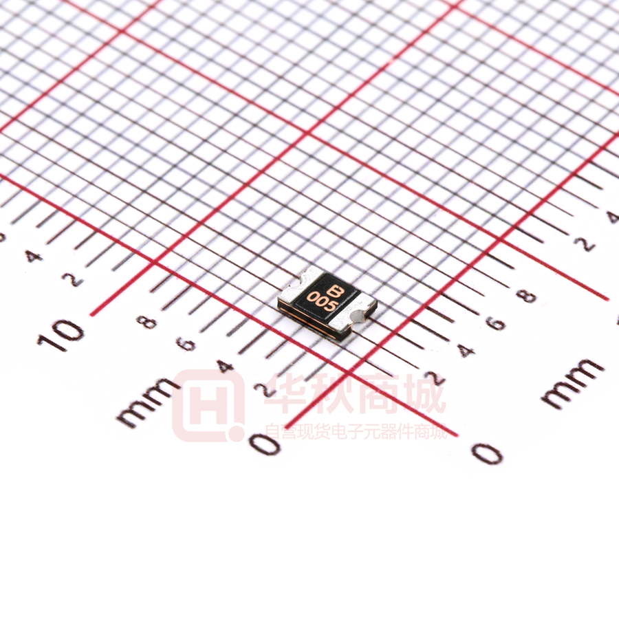

    PTC自恢复保险丝 FUSE1210 30V 50mA
BSMD1210-005-30V 数据手册
BHFUSE BSMD1210 Series Surface Mount PTC Device  Features       Size 0.12*0.10 inch /3.2*2.5 mm RoHS compliant, lead-free and halogen-free Fast response to fault current Low resistance Low profile Compatible with high temperature solders  Applications  Computer, Mobile phones, Multimedia  Automotive, Industrial controls, Telephony and broadband  Game machines, Portable electronics, Battery  Electrical Characteristics(25℃) Part Number Ihold (A) Itrip (A) Vmax (Vdc) Imax (A) Pd typ (W) Time to trip (A) (Sec) Rmin (Ω) R1max (Ω) BSMD1210-005-30V 0.05 0.15 30 40 0.6 0.25 1.50 2.800 50.00 BSMD1210-005-60V 0.05 0.15 60 40 0.6 0.25 1.50 2.800 50.00 BSMD1210-010-30V 0.10 0.34 30 40 0.6 0.50 0.60 0.800 15.00 BSMD1210-010-60V 0.10 0.34 60 40 0.6 0.50 0.60 0.800 15.00 BSMD1210-020-30V 0.20 0.40 30 40 0.6 8.00 0.02 0.400 5.000 BSMD1210-020-60V 0.20 0.40 60 40 0.6 8.00 0.02 0.400 5.000 BSMD1210-035-6V 0.35 0.70 6 100 0.6 8.00 0.20 0.200 1.300 BSMD1210-035-16V 0.35 0.70 16 100 0.6 8.00 0.20 0.200 1.300 BSMD1210-050-13.2V 0.50 1.00 13.2 100 0.6 8.00 0.10 0.180 0.900 BSMD1210-050-24V 0.50 1.00 24 100 0.6 8.00 0.10 0.180 0.900 BSMD1210-075-6V 0.75 1.50 6 100 0.6 8.00 0.10 0.070 0.400 BSMD1210-075-16V 0.75 1.50 16 100 0.6 8.00 0.10 0.070 0.400 BSMD1210-110-6V 1.10 2.20 6 100 0.6 8.00 0.30 0.050 0.230 BSMD1210-110-12V 1.10 2.20 12 100 0.6 8.00 0.30 0.050 0.230 BSMD1210-150-6V 1.50 3.00 6 100 0.8 8.00 0.50 0.030 0.110 BSMD1210-150-12V 1.50 3.00 12 100 0.8 8.00 0.50 0.030 0.110 BSMD1210-175-6V 1.75 3.50 6 100 0.8 8.00 0.60 0.020 0.080 BSMD1210-200-6V 2.00 4.00 6 100 0.8 8.00 1.00 0.015 0.070 BSMD1210-260-6V 2.60 5.00 6 100 0.8 8.00 2.50 0.010 0.060 Specifications are subject to change without notice Revision 2017 Polymer PTC Thermistor 1/6 BHFUSE BSMD1210 Series Surface Mount PTC Device Ihold = Hold current: maximum current device will pass without tripping in 25℃ still air. Itrip = Trip current: minimum current at which the device will trip in 25℃ still air. Vmax = Maximum voltage device can withstand without damage at rated current (Imax). Imax = Maximum fault current device can withstand without damage at rated voltage (Vmax). Pd typ. = Typical power dissipated from device when in the tripped state at 25℃ still air. Rmin = Minimum resistance of device in initial (un-soldered) state. R1max = Maximum resistance of device at 25℃ measured one hour after tripping or reflow soldering of 260℃ for 20 sec. Caution:Operation beyond the specified ratings may result in damage and possible arcing and flame.  WARNING  Users shall independently assess the suitability of these devices for each of their applications.  Operation of these devices beyond the stated maximum ratings could result in damage to the devices and lead to electrical arcing and/or fire.  These devices are intended to protect against the effects of temporary over-current or over-temperature conditions and are not intended to perform as protective devices where such conditions are expected to be repetitive or prolonged in duration.  Exposure to silicon-based oils, solvents, electrolytes, acids, and similar materials can adversely affect the prolonged of these PPTC devices.  These devices undergo thermal expansion under fault conditions, and thus shall be provided with adequate space and be protected against mechanical stresses.  Circuits with inductance may generate a voltage (L di/dt) above the rated voltage of the PPTC device. Specifications are subject to change without notice Revision 2017 Polymer PTC Thermistor 2/6 BHFUSE BSMD1210 Series Surface Mount PTC Device  Thermal Derating Curve  Typical Time-to-Trip At 25℃  Thermal Derating Chart Part Number Ambient operating temperature hold current(Ihold) -40℃ -20℃ 0℃ 25℃ 40℃ 50℃ 60℃ 70℃ 85℃ BSMD1210-005 0.08 0.07 0.06 0.05 0.04 0.04 0.03 0.03 0.02 BSMD1210-010 0.16 0.14 0.12 0.10 0.08 0.07 0.06 0.05 0.03 BSMD1210-020 0.29 0.26 0.22 0.20 0.16 0.14 0.13 0.11 0.08 BSMD1210-035 0.47 0.45 0.40 0.35 0.33 0.28 0.24 0.21 0.18 BSMD1210-050 0.76 0.67 0.58 0.50 0.43 0.40 0.36 0.32 0.28 BSMD1210-075 1.00 0.97 0.86 0.75 0.64 0.59 0.54 0.48 0.40 BSMD1210-110 1.69 1.48 1.29 1.10 0.88 0.76 0.65 0.57 0.43 BSMD1210-150 2.13 1.92 1.71 1.50 1.26 1.14 1.01 0.89 0.71 BSMD1210-175 2.54 2.30 2.02 1.75 1.47 1.33 1.18 1.05 0.86 BSMD1210-200 2.90 2.63 2.31 2.00 1.68 1.52 1.35 1.20 0.98 BSMD1210-260 3.43 3.22 2.93 2.60 2.23 2.03 1.87 1.57 1.35 Specifications are subject to change without notice Revision 2017 Polymer PTC Thermistor 3/6 BHFUSE BSMD1210 Series Surface Mount PTC Device  Soldering Parameters Profile Feature Pb-Free Assembly Average Ramp-Up Rate(Tsmax to Tp) 3℃/second max Preheat -Temperature Min(Tsmin) -Temperature Max(Tsmax) -Time(Tsmin to Tsmax) 150℃ 200℃ 60~180 seconds Time maintained above: -Temperature(TL) -Time(tL) 217℃ 60~150 seconds Peak Temperature(Tp) 260℃ Ramp-Down Rate 6℃/second max Time 25℃ to Peak Temperature 8 minutes max Storage Condition 0℃~30℃,30%-60%RH  Recommended reflow methods: IR, vapor phase oven, hot air oven, N2 environment for lead-free.  Recommended maximum paste thickness is 0.25mm.  Devices can be cleaned using standard industry methods and solvents. Note 1: All temperature refer to topside of the package, measured on the package body surface. Note 2: If reflow temperatures exceed the recommended profile, devices may not meet the performance requirements.  Environmental Specifications Test Conditions Resistance change Passive aging +85°C, 1000 hrs. ±5% typical Humidity aging +85°C, 85% R.H. , 168 hours ±5% typical Thermal shock +85°C to -40°C, 20 times ±33% typical Resistance to solvent MIL-STD-202,Method 215 No change Vibration MIL-STD-202,Method 201 No change Ambient operating conditions : - 40 °C to +85 °C Maximum surface temperature of the device in the tripped state is 125 °C Specifications are subject to change without notice Revision 2017 Polymer PTC Thermistor 4/6 BHFUSE BSMD1210 Series Surface Mount PTC Device  Physical Dimensions & Recommended Pad Layout (mm) A 1.00 1.00 D Part Number 2.50 B 035 B E Marking Quantity BSMD1210-005-30V B005 BSMD1210-005-60V 2.00 C A B C D E Min Max Min Max Min Max Min Min 4000 3.00 3.50 2.35 2.80 0.60 1.20 0.30 0.10 B005 4000 3.00 3.50 2.35 2.80 0.60 1.20 0.30 0.10 BSMD1210-010-30V B010 4000 3.00 3.50 2.35 2.80 0.60 1.20 0.30 0.10 BSMD1210-010-60V B010 4000 3.00 3.50 2.35 2.80 0.60 1.20 0.30 0.10 BSMD1210-020-30V B020 4000 3.00 3.50 2.35 2.80 0.50 1.10 0.30 0.10 BSMD1210-020-60V B020 4000 3.00 3.50 2.35 2.80 0.50 1.10 0.30 0.10 BSMD1210-035-6V B035 4000 3.00 3.50 2.35 2.80 0.50 1.10 0.30 0.10 BSMD1210-035-16V B035 4000 3.00 3.50 2.35 2.80 0.50 1.10 0.30 0.10 BSMD1210-050-13.2V B050 4000 3.00 3.50 2.35 2.80 0.50 1.10 0.30 0.10 BSMD1210-050-24V B050 4000 3.00 3.50 2.35 2.80 0.50 1.10 0.30 0.10 BSMD1210-075-6V B075 4000 3.00 3.50 2.35 2.80 0.50 1.10 0.30 0.10 BSMD1210-075-16V B075 4000 3.00 3.50 2.35 2.80 0.50 1.10 0.30 0.10 BSMD1210-110-6V B110 4000 3.00 3.50 2.35 2.80 0.50 1.10 0.30 0.10 BSMD1210-110-12V B110 4000 3.00 3.50 2.35 2.80 0.50 1.10 0.30 0.10 BSMD1210-150-6V B150 4000 3.00 3.50 2.35 2.80 0.50 1.20 0.30 0.10 BSMD1210-150-12V B150 4000 3.00 3.50 2.35 2.80 0.50 1.20 0.30 0.10 BSMD1210-175-6V B175 4000 3.00 3.50 2.35 2.80 0.80 1.40 0.30 0.10 BSMD1210-200-6V B200 4000 3.00 3.50 2.35 2.80 0.80 1.40 0.30 0.10 BSMD1210-260-6V B260 4000 3.00 3.50 2.35 2.80 1.00 1.60 0.30 0.10 Specifications are subject to change without notice Revision 2017 Polymer PTC Thermistor 5/6 BHFUSE BSMD1210 Series Surface Mount PTC Device  Tape And Reel Specifications (mm) Governing Specifications BSMD1210-005-30V~ BSMD1210-035-16V BSMD1210-050-13.2V~ BSMD1210-175-6V BSMD1210-200-6V~ BSMD1210-260-6V W 8.0 ± 0.3 8.0 ± 0.3 8.0 ± 0.3 F 3.5 ± 0.05 3.5 ± 0.05 3.5 ± 0.05 E1 1.75 ± 0.1 1.75 ± 0.1 1.75 ± 0.1 D0 1.55 ± 0.05 1.55 ± 0.05 1.55 ± 0.05 D1 1.0 ± 0.1 1.0 ± 0.1 1.0 ± 0.1 P0 4.0 ± 0.1 4.0 ± 0.1 4.0 ± 0.1 P1 4.0 ± 0.1 4.0 ± 0.1 4.0 ± 0.1 P2 2.0 ± 0.05 2.0 ± 0.05 2.0 ± 0.05 A0 2.9 ± 0.1 2.9 ± 0.1 2.9 ± 0.1 B0 3.65 ± 0.1 3.65 ± 0.1 3.65 ± 0.1 T 0.2 ± 0.1 0.2 ± 0.1 0.2 ± 0.1 K0 0.74 ± 0.1 1.04 ± 0.1 1.35 ± 0.1 Leader min 390 390 390 Trailer min 160 160 160 Reel Dimensions  C φ178 ± 1.0 D φ60.2 ± 0.5 H 11.0 ± 0.5 W 9.0 ± 1.5 Contact information SHENZHEN HCHC ELECTRONIC CO., LTD TEL: 0755-85259917 FAX: 0755-28704432 E-MAIL: sale@hchc-elec.com Specifications are subject to change without notice Revision 2017 Polymer PTC Thermistor 6/6
