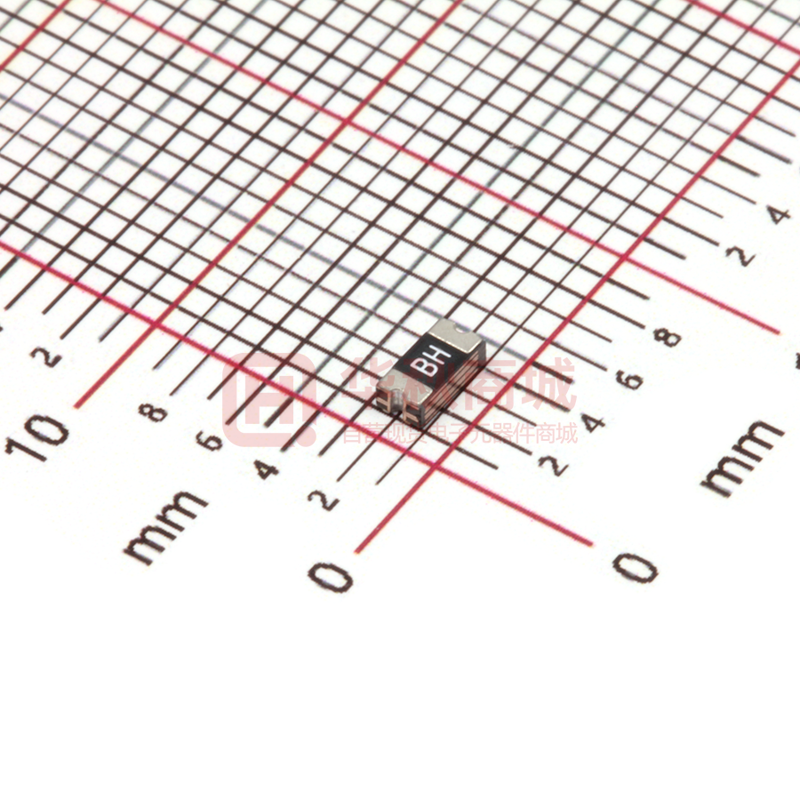

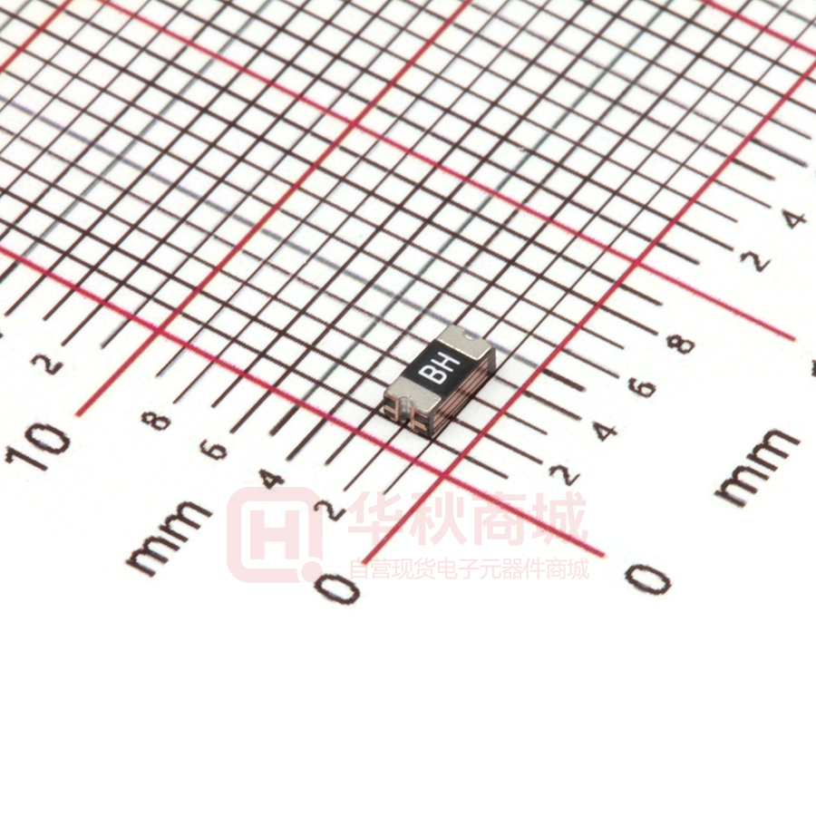

BHFUSE BSMD1206 Series Surface Mount PTC Device  Features       Size 0.12*0.06 inch /3.2*1.6 mm RoHS compliant, lead-free and halogen-free Fast response to fault current Low resistance Low-profile Compatible with high temperature solders  Applications  Computer, Mobile phones, Multimedia  Automotive, Industrial controls, Telephony and broadband  Game machines, Portable electronics, Battery  Electrical Characteristics(25℃) Part Number Ihold (A) Itrip (A) Vmax (V) Imax (A) Pd (W) Time to trip (A) (Sec) Rmin (Ω) R1max (Ω) BSMD1206-005-30V 0.05 0.15 30 40 0.4 0.25 1.50 3.60 50.0 BSMD1206-005-60V 0.05 0.15 60 40 0.4 0.25 1.50 3.60 50.0 BSMD1206-010-30V 0.10 0.25 30 40 0.4 0.50 1.00 1.60 15.0 BSMD1206-010-60V 0.10 0.25 60 40 0.4 0.50 1.00 1.60 15.0 BSMD1206-012-60V 0.12 0.29 60 40 0.4 0.50 1.00 1.60 13.0 BSMD1206-016-33V 0.16 0.37 33 40 0.4 1.00 0.30 1.00 6.00 BSMD1206-020-24V 0.20 0.46 24 40 0.6 8.00 0.10 0.35 2.70 BSMD1206-020-30V 0.20 0.46 30 40 0.6 8.00 0.10 0.35 2.70 BSMD1206-025-16V 0.25 0.50 16 40 0.6 8.00 0.10 0.35 2.50 BSMD1206-025-24V 0.25 0.50 24 40 0.6 8.00 0.10 0.35 2.50 BSMD1206-025-30V 0.25 0.50 30 40 0.6 8.00 0.10 0.35 2.50 BSMD1206-035-6V 0.35 0.75 6 40 0.6 8.00 0.10 0.25 1.50 BSMD1206-035-16V 0.35 0.75 16 40 0.6 8.00 0.10 0.25 1.50 BSMD1206-035-30V 0.35 0.75 30 40 0.6 8.00 0.10 0.25 1.50 BSMD1206-050-6V 0.50 1.00 6 100 0.6 8.00 0.10 0.15 0.70 BSMD1206-050-13.2V 0.50 1.00 13.2 100 0.6 8.00 0.10 0.15 0.70 BSMD1206-050-16V 0.50 1.00 16 100 0.6 8.00 0.10 0.15 0.70 BSMD1206-050-24V 0.50 1.00 24 40 0.6 8.00 0.10 0.15 0.70 BSMD1206-050-30V 0.50 1.00 30 40 0.6 8.00 0.10 0.15 0.70 BSMD1206-075-6V 0.75 1.50 6 100 0.6 8.00 0.20 0.09 0.50 BSMD1206-075-13.2V 0.75 1.50 13.2 100 0.6 8.00 0.20 0.09 0.50 BSMD1206-075-16V 0.75 1.50 16 100 0.6 8.00 0.20 0.09 0.50 Specifications are subject to change without notice Revision 2017 Polymer PTC Thermistor 1/8 BHFUSE BSMD1206 Series Surface Mount PTC Device Part Number Ihold (A) Itrip (A) Vmax (V) Imax (A) Pd (W) Time to trip (A) (S) Ri (Ω) R1max (Ω) BSMD1206-075-24V 0.75 1.50 24 40 0.6 8.00 0.20 0.09 0.50 BSMD1206-075-30V 0.75 1.50 30 40 0.6 8.00 0.20 0.09 0.50 BSMD1206-100-6V 1.00 1.80 6 100 0.6 8.00 0.30 0.05 0.27 BSMD1206-100-13.2V 1.00 1.80 13.2 100 0.6 8.00 0.30 0.05 0.27 BSMD1206-100-16V 1.00 1.80 16 100 0.6 8.00 0.30 0.05 0.27 BSMD1206-100-24V 1.00 1.80 24 40 0.6 8.00 0.30 0.05 0.27 BSMD1206-110-6V 1.10 2.20 6 100 0.6 8.00 0.30 0.04 0.25 BSMD1206-150-6V 1.50 3.00 6 100 0.8 8.00 0.30 0.025 0.130 BSMD1206-150-13.2V 1.50 3.00 13.2 40 0.8 8.00 0.30 0.025 0.130 BSMD1206-150-16V 1.50 3.00 16 40 0.8 8.00 0.30 0.025 0.130 BSMD1206-200-6V 2.00 3.50 6 100 0.8 8.00 1.50 0.015 0.080 BSMD1206-200-12V 2.00 3.50 12 100 0.8 8.00 1.50 0.015 0.080 BSMD1206-200-16V 2.00 3.50 16 40 0.8 8.00 1.50 0.015 0.080 BSMD1206-260-6V 2.60 5.20 6 100 0.8 8.00 2.00 0.010 0.060 BSMD1206-300-6V 3.00 6.00 6 100 1.0 8.00 4.00 0.010 0.050 BSMD1206-350-6V 3.50 7.00 6 100 1.2 10.0 5.00 0.005 0.040 Ihold = Hold current: maximum current device will pass without tripping in 25℃ still air. Itrip = Trip current: minimum current at which the device will trip in 25℃ still air. Vmax = Maximum voltage device can withstand without damage at rated current (Imax) Imax = Maximum fault current device can withstand without damage at rated voltage (Vmax) Pd typ. = Typical power dissipated from device when in the tripped state at 25℃ still air. Rmin = Minimum resistance of device in initial (un-soldered) state. R1max = Maximum resistance of device at 25℃ measured one hour after tripping or reflow soldering of 260℃ for 20 sec. Caution:Operation beyond the specified ratings may result in damage and possible arcing and flame. Specifications are subject to change without notice Revision 2017 Polymer PTC Thermistor 2/8 BHFUSE BSMD1206 Series Surface Mount PTC Device  WARNING  Users shall independently assess the suitability of these devices for each of their applications.  Operation of these devices beyond the stated maximum ratings could result in damage to the devices and lead to electrical arcing and/or fire.  These devices are intended to protect against the effects of temporary over-current or over-temperature conditions and are not intended to perform as protective devices where such conditions are expected to be repetitive or prolonged in duration.  Exposure to silicon-based oils, solvents, electrolytes, acids, and similar materials can adversely affect the performance of these PPTC devices.  These devices undergo thermal expansion under fault conditions, and thus shall be provided with adequate space and be protected against mechanical stresses.  Circuits with inductance may generate a voltage (L di/dt) above the rated voltage of the PPTC device.  Thermal Derating Curve Specifications are subject to change without notice Revision 2017  Typical Time-to-Trip At 25℃ Polymer PTC Thermistor 3/8 BHFUSE BSMD1206 Series Surface Mount PTC Device  Thermal Derating Chart Part Number Ambient operating temperature hold current(Ihold) -40℃ -20℃ 0℃ 25℃ 40℃ 50℃ 60℃ 70℃ 85℃ BSMD1206-005 0.074 0.066 0.056 0.050 0.042 0.037 0.035 0.030 0.027 BSMD1206-010 0.148 0.132 0.116 0.100 0.085 0.075 0.070 0.060 0.055 BSMD1206-012 0.18 0.16 0.14 0.12 0.10 0.09 0.08 0.07 0.06 BSMD1206-016 0.24 0.21 0.18 0.16 0.14 0.13 0.12 0.11 0.10 BSMD1206-020 0.30 0.26 0.23 0.20 0.17 0.15 0.14 0.12 0.11 BSMD1206-025 0.37 0.33 0.29 0.25 0.22 0.20 0.17 0.15 0.12 BSMD1206-035 0.50 0.45 0.40 0.35 0.30 0.27 0.24 0.21 0.15 BSMD1206-050 0.71 0.64 0.57 0.50 0.42 0.39 0.35 0.31 0.25 BSMD1206-075 1.14 1.01 0.88 0.75 0.65 0.59 0.54 0.49 0.41 BSMD1206-100 1.45 1.31 1.15 1.00 0.84 0.77 0.69 0.61 0.48 BSMD1206-110 1.60 1.45 1.30 1.10 0.95 0.80 0.72 0.66 0.55 BSMD1206-150 2.18 1.94 1.72 1.50 1.28 1.17 1.06 0.96 0.77 BSMD1206-200 2.88 2.63 2.34 2.00 1.74 1.58 1.42 1.17 0.93 BSMD1206-260 3.43 3.22 2.93 2.60 2.23 2.03 1.87 1.57 1.35 BSMD1206-300 4.05 3.66 3.36 3.00 2.50 2.28 2.00 1.62 1.38 BSMD1206-350 4.65 4.22 3.92 3.50 2.92 2.68 2.35 1.91 1.42 Specifications are subject to change without notice Revision 2017 Polymer PTC Thermistor 4/8 BHFUSE BSMD1206 Series Surface Mount PTC Device  Soldering Parameters Profile Feature Pb-Free Assembly Average Ramp-Up Rate(Tsmax to Tp) 3℃/second max Preheat -Temperature Min(Tsmin) -Temperature Max(Tsmax) -Time(Tsmin to Tsmax) 150℃ 200℃ 60~180 seconds Time maintained above: -Temperature(TL) -Time(tL) 217℃ 60~150 seconds Peak Temperature(Tp) 260℃ Ramp-Down Rate 6℃/second max Time 25℃ to Peak Temperature 8 minutes max Storage Condition 0℃~30℃,30%-60%RH  Recommended reflow methods: IR, vapor phase oven, hot air oven, N2 environment for lead-free.  Recommended maximum paste thickness is 0.25mm.  Devices can be cleaned using standard industry methods and solvents. Note 1: All temperature refer to topside of the package, measured on the package body surface. Note 2: If reflow temperatures exceed the recommended profile, devices may not meet the performance requirements.  Environmental Specifications Test Conditions Resistance change Passive aging +85°C, 1000 hrs. ±5% typical Humidity aging +85°C, 85% R.H. , 168 hours ±5% typical Thermal shock +85°C to -40°C, 20 times ±33% typical Resistance to solvent MIL-STD-202,Method 215 No change Vibration MIL-STD-202,Method 201 No change Ambient operating conditions : - 40 °C to +85 °C Maximum surface temperature of the device in the tripped state is 125 °C Specifications are subject to change without notice Revision 2017 Polymer PTC Thermistor 5/8 BHFUSE BSMD1206 Series Surface Mount PTC Device  Physical Dimensions & Recommended Pad Layout (mm) A 1.0 1.0 1.8 BF B 1.8 D Part Number E Marking Quantity BSMD1206-005-30V BZ BSMD1206-005-60V C A B C D E Min Max Min Max Min Max Min Min 3500 3.00 3.60 1.50 1.90 0.60 1.20 0.15 0.10 BZ 3500 3.00 3.60 1.50 1.90 0.60 1.20 0.15 0.10 BSMD1206-010-30V BN 3500 3.00 3.60 1.50 1.90 0.60 1.20 0.15 0.10 BSMD1206-010-60V BN 3500 3.00 3.60 1.50 1.90 0.60 1.20 0.15 0.10 BSMD1206-012-60V BN 3500 3.00 3.60 1.50 1.90 0.60 1.20 0.15 0.10 BSMD1206-016-33V BT 3500 3.00 3.60 1.50 1.90 0.40 1.00 0.15 0.10 BSMD1206-020-24V BA 3500 3.00 3.60 1.50 1.90 0.40 1.00 0.15 0.10 BSMD1206-020-30V BA 3500 3.00 3.60 1.50 1.90 0.40 1.00 0.15 0.10 BSMD1206-025-16V BA 3500 3.00 3.60 1.50 1.90 0.40 1.00 0.15 0.10 BSMD1206-025-24V BA 3500 3.00 3.60 1.50 1.90 0.40 1.00 0.15 0.10 BSMD1206-025-30V BA 3500 3.00 3.60 1.50 1.90 0.40 1.00 0.15 0.10 BSMD1206-035-6V BB 3500 3.00 3.60 1.50 1.90 0.40 1.00 0.15 0.10 BSMD1206-035-16V BB 3500 3.00 3.60 1.50 1.90 0.40 1.00 0.15 0.10 BSMD1206-035-30V BB 3500 3.00 3.60 1.50 1.90 0.40 1.00 0.15 0.10 BSMD1206-050-6V BF 3500 3.00 3.60 1.50 1.90 0.40 1.00 0.15 0.10 BSMD1206-050-13.2V BF 3500 3.00 3.60 1.50 1.90 0.40 1.00 0.15 0.10 BSMD1206-050-16V BF 3500 3.00 3.60 1.50 1.90 0.40 1.00 0.15 0.10 BSMD1206-050-24V BF 3500 3.00 3.60 1.50 1.90 0.40 1.00 0.15 0.10 BSMD1206-050-30V BF 3500 3.00 3.60 1.50 1.90 0.40 1.00 0.15 0.10 BSMD1206-075-6V BG 3500 3.00 3.60 1.50 1.90 0.50 1.00 0.15 0.10 BSMD1206-075-13.2V BG 3500 3.00 3.60 1.50 1.90 0.50 1.00 0.15 0.10 BSMD1206-075-16V BG 3500 3.00 3.60 1.50 1.90 0.50 1.00 0.15 0.10 BSMD1206-075-24V BG 3500 3.00 3.60 1.50 1.90 0.50 1.00 0.15 0.10 BSMD1206-075-30V BG 3500 3.00 3.60 1.50 1.90 0.50 1.00 0.15 0.10 BSMD1206-100-6V BH 3500 3.00 3.60 1.50 1.90 0.50 1.00 0.15 0.10 BSMD1206-100-13.2V BH 3500 3.00 3.60 1.50 1.90 0.50 1.00 0.15 0.10 Specifications are subject to change without notice Revision 2017 Polymer PTC Thermistor 6/8 BHFUSE BSMD1206 Series Surface Mount PTC Device Part Number Marking Quantity BSMD1206-100-16V BH BSMD1206-100-24V A B C D E Min Max Min Max Min Max Min Min 3500 3.00 3.60 1.50 1.90 0.50 1.00 0.15 0.10 BH 3500 3.00 3.60 1.50 1.90 0.50 1.00 0.15 0.10 BSMD1206-110-6V BH 3500 3.00 3.60 1.50 1.90 0.50 1.00 0.15 0.10 BSMD1206-150-6V BI 3500 3.00 3.60 1.50 1.90 0.50 1.00 0.15 0.10 BSMD1206-150-13.2V BI 3500 3.00 3.60 1.50 1.90 0.80 1.60 0.15 0.10 BSMD1206-200-6V BK 3500 3.00 3.60 1.50 1.90 0.70 1.30 0.15 0.10 BSMD1206-200-12V BK 3500 3.00 3.60 1.50 1.90 0.70 1.30 0.15 0.10 BSMD1206-200-16V BK 3500 3.00 3.60 1.50 1.90 0.70 1.60 0.15 0.10 BSMD1206-260-6V BP 3500 3.00 3.60 1.50 1.90 1.00 1.60 0.15 0.10 BSMD1206-300-6V BP 3500 3.00 3.60 1.50 1.90 1.00 1.60 0.15 0.10 BSMD1206-350-6V BV 3500 3.00 3.60 1.50 1.90 1.00 1.60 0.15 0.10 Specifications are subject to change without notice Revision 2017 Polymer PTC Thermistor 7/8 BHFUSE BSMD1206 Series Surface Mount PTC Device  Tape And Reel Specifications (mm) Governing Specifications BSMD1206-005-30V~ BSMD1206-050-16V BSMD1206-050-24V~ BSMD1206-075-33V BSMD1206-100-6V~ BSMD1206-350-6V W 8.0 ± 0.3 8.0 ± 0.3 8.0 ± 0.3 F 3.5 ± 0.05 3.5 ± 0.05 3.5 ± 0.05 E1 1.75 ± 0.1 1.75 ± 0.1 1.75 ± 0.1 D0 1.55 ± 0.05 1.55 ± 0.05 1.55 ± 0.05 D1 1.0 ± 0.1 1.0 ± 0.1 1.0 ± 0.1 P0 4.0 ± 0.1 4.0 ± 0.1 4.0 ± 0.1 P1 4.0 ± 0.1 4.0 ± 0.1 4.0 ± 0.1 P2 2.0 ± 0.05 2.0 ± 0.05 2.0 ± 0.05 A0 1.95 ± 0.1 1.95 ± 0.1 1.95 ± 0.1 B0 3.65 ± 0.1 3.65 ± 0.1 3.65 ± 0.1 T 0.2 ± 0.1 0.2 ± 0.1 0.2 ± 0.1 K0 0.74 ± 0.1 1.04 ± 0.1 1.35 ± 0.1 Leader min 390 390 390 Trailer min 160 160 160 Reel Dimensions  C φ178 ± 1.0 D φ60.2 ± 0.5 H 11.0 ± 0.5 W 9.0 ± 1.5 Contact information SHENZHEN HCHC ELECTRONIC CO., LTD TEL: 0755-85259917 FAX: 0755-28704432 E-MAIL: sale@hchc-elec.com Specifications are subject to change without notice Revision 2017 Polymer PTC Thermistor 8/8

物料型号:BSMD1206系列自恢复保险丝
器件简介:BSMD1206系列是表面贴装的PTC热敏电阻器,具有尺寸小、响应快、低电阻、低轮廓、符合RoHS标准等特性。
引脚分配:文档中未明确提供引脚分配信息,但通常这类器件为无引脚表面贴装元件。
参数特性: - 工作温度范围:-40°C 至 85°C - 保持电流(Ihold):设备在25℃静止空气中不会触发的最大电流。 - 触发电流(Itrip):设备在25℃静止空气中触发的最小电流。 - 最大电压(Vmax):在额定电流(Imax)下设备能够承受的最大电压,而不损坏。 - 最大电流(Imax):在额定电压(Vmax)下设备能够承受的最大故障电流,而不损坏。 - 典型功耗(Pd):设备在25℃静止空气中触发状态下的典型功耗。 - 触发时间:设备从电流超过Itrip到电阻增加到稳定状态所需的时间。 - 最小电阻(Rmin):设备初始(未焊接)状态的最小电阻。 - 最大电阻(R1max):设备在260℃下焊接或回流焊接后一小时测量的最大电阻。
功能详解:BSMD1206系列自恢复保险丝主要用于保护电路免受临时过电流或过热条件的影响,不适用于预期会重复或持续时间较长的过电流或过热条件。
应用信息:适用于计算机、手机、多媒体、汽车电子、工业控制、电话和宽带、游戏机、便携式电子设备、电池等领域。
封装信息:尺寸为0.120.06英寸/3.21.6毫米,兼容高温焊接。
