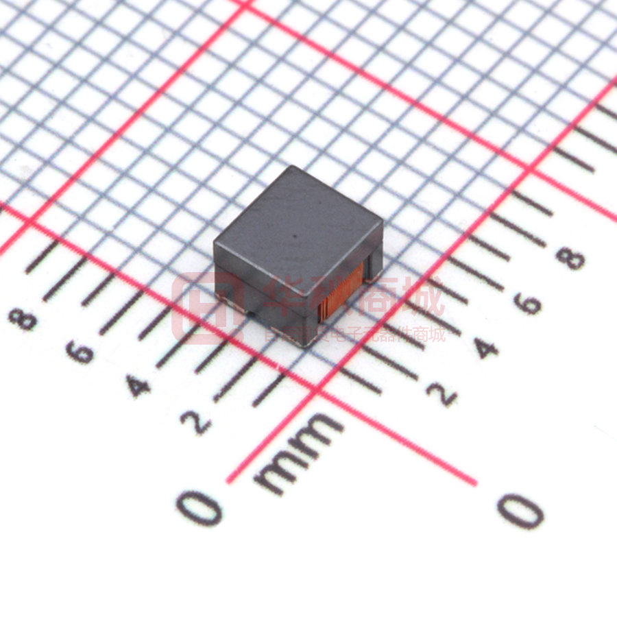

    共模电感 80µH 200mA 1.3Ω Original CHOKE_3.5X3.2MM_SM
DCM3532F2SF-800T02 数据手册
P1 TAI-TECH Wire Wound Type Common Mode Filter DCM3532F2SF-800T02 ECN HISTORY LIST REV DATE DESCRIPTION APPROVED CHECKED DRAWN 1.0 18/07/02 新發行 楊祥忠 林志鴻 張展耀 備 註 www.tai-tech.com.tw P2 TAI-TECH Wire Wound Type Common Mode Filter DCM3532F2SF-800T02 1. Features 1. High common mode impedance at high frequency effects excellent noise Halogen Pb Halogen-free Pb-free suppression performance. 2. DCM3532F2SF series realizes small size and low profile. 3.5x3.2x2.2 mm 3. 100% Lead(Pb) & Halogen-Free and RoHS compliant. 2. Dimension A C Recommended PC Board Pattern D D B D D Series A(mm) B(mm) C(mm) 3532F2SF 3.5±0.2 3.2±0.2 2.2±0.2 D1(mm) D2(mm) L(mm) H(mm) G1(mm) G2(mm) 4.40 3.80 2.45 0.90 0.63±0.05 1.18±0.05 Units: mm 3. Part Numbering DCM 3532 F A B C 2 S F D F E - 800 T02 G H A: Series B: Dimension C: Material Ferrite Core D: Number of Lines 2=2 lines E: Type S=Shielded F: Lead free G: Inductance H: Rated Current 800=80μH 02=200mA 4. Specification TAI-TECH Part Number DCM3532F2SF-800T02 Inductance (μH) [100kHz] DC Resistance (Ω) max. Rated Current (mA) Rated Volt. (Vdc) IR (Ω) min. 75~160 1.3 200 50 10M www.tai-tech.com.tw P3 TAI-TECH 100000 DCM3532F2SF-800 Common Mode IMPEDANCE(Ohm) 10000 1000 100 10 Normal Mode 1 1 10 100 1000 FREQUENCY(MHz) 5.Schematic Diagram 6. MEASURING CIRCUITS 2LINE 7. Materials No. Description Specification a. Upper Plate Ferrite b. Core Ferrite Core c Termination Tin (Pb Free) d Wire Enameled Copper Wire www.tai-tech.com.tw 10000 P4 TAI-TECH 8. Reliability and Test Condition Item Performance Operating temperature -40~+125℃ (Including self - temperature rise) Storage temperature -40~+125℃ (on board) Test Condition Electrical Performance Test Z(common mode) DCR Agilent-4291A+ Agilent -16197A Refer to standard electrical characteristics list. I.R. Temperature Rise Test Agilent-4338B Agilent4339 Rated Current < 1A ∆T 20℃Max 1.Applied the allowed DC current. 2.Temperature measured by digital surface thermometer Rated Current ≧1A ∆T 40℃Max Reliability Test Preconditioning: Run through IR reflow for 2 times.( IPC/JEDEC J-STD-020DClassification Reflow Profiles) Temperature:125±2℃ Life Test Applied current:rated current Duration:1000±12hrs Measured at room temperature after placing for 24±2 hrs Preconditioning: Run through IR reflow for 2 times.( IPC/JEDEC J-STD-020DClassification Reflow Profiles Load Humidity Humidity:85±2﹪R.H, Temperature:85℃±2℃ Moisture Resistance Appearance:No damage. Inductance:within±10% of initial value Impedance:within±15% of initial value RDC:within ±15% of initial value and shall not exceed the specification value Thermal shock Duration:1000hrs Min. with 100% rated current Measured at room temperature after placing for 24±2 hrs Preconditioning: Run through IR reflow for 2 times.( IPC/JEDEC J-STD-020DClassification Reflow Profiles 1. Baked at50℃ for 25hrs, measured at room temperature after placing for 4 hrs. 2. Raise temperature to 65±2℃ 90-100%RH in 2.5hrs, and keep 3 hours, cool down to 25℃ in 2.5hrs. 3. Raise temperature to 65±2℃ 90-100%RH in 2.5hrs, and keep 3 hours, cool down to 25℃ in 2.5hrs,keep at 25℃ for 2 hrs then keep at -10℃ for 3 hrs 4. Keep at 25℃ 80-100%RH for 15min and vibrate at the frequency of 10 to 55 Hz to 10 Hz, measure at room temperature after placing for 1~2 hrs. Preconditioning: Run through IR reflow for 2 times.( IPC/JEDEC J-STD-020DClassification Reflow Profiles Condition for 1 cycle Step1:-40±2℃ 30±5min Step2:25±2℃ ≦0.5min Step3:125±2℃ 30±5min Number of cycles: 500 Measured at room temperature after placing for 24±2 hrs Oscillation Frequency: 10~2K~10Hz for 20 minutes Vibration Equipment: Vibration checker Total Amplitude:1.52mm±10% Testing Time : 12 hours(20 minutes, 12 cycles each of 3 orientations)。 www.tai-tech.com.tw P5 TAI-TECH Item Performance Bending Appearance:No damage. Impedance:within±15% of initial value Inductance:within±10% of initial value RDC:within ±15% of initial value and shall not exceed the specification value Shock Solder ability More than 95% of the terminal electrode should be covered with solder。 Test Condition Shall be mounted on a FR4 substrate of the following dimensions: >=0805 inch(2012mm):40x100x1.2mm =0805 inch(2012mm):1.2mm 0805:1kg ,
