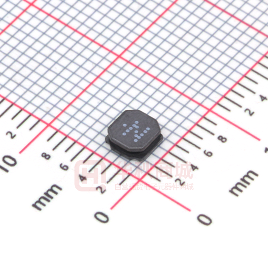

P1 TAI-TECH Power Inductor HPC4018B-SERIES ECN HISTORY LIST REV DATE DESCRIPTION APPROVED CHECKED DRAWN 1.0 13/04/22 新 發 行 楊祥忠 詹偉特 林宜蕰 備 註 www.tai-tech.com.tw P2 TAI-TECH Power Inductor HPC4018B-SERIES 1. Features 1. This specification applies Low Profile Power Inductors. 2. 100% Lead(Pb) & Halogen-Free and RoHS compliant. 2. Dimension Halogen Pb Halogen-free Pb-free H I G I Series A(mm) B(mm) C(mm) D(mm) E(mm) G(mm) H(mm) I(mm) HPC4018B 4.0±0.2 4.0±0.2 1.8 max. 1.1±0.2 2.5±0.2 2.8 ref. 3.7 ref. 1.2 ref. Units: mm Test Frequency (Hz) SRF (MHz) min. DCR (Ω) ±20% I sat (A) 3. Part Numbering HPC 4018 B A B C - 3R3 D M E A: Series B: Dimension C: Control S/N D: Inductance E: Inductance Tolerance 3R3=3.3uH M=±20%;Y=±30% 4. Specification TAI-TECH Part Number Inductance Inductance Tolerance Symbol (uH) (%) I rms (A) HPC4018B-1R0Y A 1.0 ±30% 1V100K 90 0.027 4.00 3.20 HPC4018B-2R2M C 2.2 ±20% 1V100K 60 0.042 3.00 2.20 HPC4018B-3R3M E 3.3 ±20% 1V100K 45 0.055 2.30 2.00 HPC4018B-4R7M H 4.7 ±20% 1V100K 35 0.070 2.00 1.70 HPC4018B-6R8M I 6.8 ±20% 1V100K 30 0.098 1.60 1.45 HPC4018B-100M K 10 ±20% 1V100K 25 0.150 1.30 1.20 HPC4018B-150M M 15 ±20% 1V100K 18 0.210 1.10 0.85 HPC4018B-220M N 22 ±20% 1V100K 15 0.290 0.90 0.72 HPC4018B-330M P 33 ±20% 1V100K 12 0.460 0.70 0.55 Note: Isat:Based on inductance change (△L/L0:≦-30%)@ ambient temp. Irms:Based on temperature rise (△T:40℃ typ.) www.tai-tech.com.tw P3 TAI-TECH HPC4018B-SERIES HPC4018B-SERIES 20 85 330 0 68 220 -10 -20 51 L(%) INDUCTANCE(uH) 10 150 330 17 1R0 6R8 4R7 3R3 2R2 -70 3R3 2R2 10 100 -60 6R8 4R7 1 220 150 -50 100 0 0.1 -30 -40 34 100 1R0 -80 1000 0 1 2 3 4 5 DC CURRENT(A) FREQUENCY(MHz) Core chipping The appearance standard of the chipping size on top side, and bottom side ferrite core is listed below. Type HPC4018B L W 1.5mm Max. 1.5mm Max. Void appearance tolerance Limit Size of voids occurring to coating resin is specified below. Exposed wire tolerance limit of coating resin part on product side. Size of exposed wire occurring to coating resin is specified below. 1. Width direction(dimension a):Acceptable when a≦w/2 Nonconforming when a>w/2 2. Length direction(dimension b):Dimension b is not specified. 3. The total area of exposed wire occurring to each sides is not greater than 50% of coating resin area, and is acceptable. External appearance criterion for exposed wire Exposed end of the winding wire at the secondary side should be 2mm and below. www.tai-tech.com.tw P4 TAI-TECH 5. Exectrde appearance criterion for exposed wire 6. Material List No. Item Material 1 Core Ni-Zn ferrite 2 Wire Copper Wire 3 Coating Epoxy with magnetic 4 Solder Lead free 7. Reliability and Test Condition Item Operating Temperature Storage Temperature Performance - 25 ~ +125℃. Test Method and Remarks Including self-generated heat -40 ~ +85℃. - 5 to 40℃ for the product with taping. Rated current Inductance (L) Within the specified tolerance DC Resistance LCR Meter: HP 4285A or equivalent, 100kHz, 1V DC Ohmmeter: HIOKI3227 or equivalent Temperature characteristics Inductance change:Within±20% Resistance to flexure substrate No damage. Measurement of inductance shall be taken at temperature rang within–25℃ to +85℃. With reference to inductance value at+20 ℃,change rate shall be calculated. Measurement of inductance shall be taken at temperature rang within–40℃ to +125℃. With reference to inductance value at+20 ℃,change rate shall be calculated. The test samples shall be soldered to the testing board by the reflow. As illustrated below, apply force in the direction of the arrow indicating until deflection of the test board reaches to 2mm. Substrate size:100x40x1.0 Substrate material:glass epoxy-resin Solder cream thickness:0.15 The test samples shall be soldered to the testing board and by the reflow. Adhesion of Terminal electrode Shall not come off PC board. Applied force:10 N to X and Y directions. Duration:5s Solder cream thickness:0.15 www.tai-tech.com.tw P5 TAI-TECH Item Performance Test Method and Remarks The test samples shall be soldered to the test board by the reflow. Then it shall be submitted to below test conditions. Frequency: 10-55Hz Total Amplitude: 1.5mm (May not exceed acceleration 196m/S2 ) Sweeping Method:10Hz to 55Hz to 10Hz for 1min. Time:2 hours each in X,Y, and Z Direction. Recovery: At least 2hrs of recovery under the standard condition after the test, followed by the measurement within 48hrs. Resistance to Vibration Inductance change:Within±10% No abnormality observed in appearance. Solderability The test samples shall be dipped in flux, and then immersed in molten solder as shown in below. Flux:methanol solution containing rosin 25% At least 90% of surface of terminal electrode is covered by new solder. Solder temperature: 245±5℃ Time: 5±1.0 sec. Immersion depth: All sides of mounting terminal shall be immersed. Test board thickness:1.0mm Test board material:glass epoxy resin THE Chip shall be stabilized normal condition for1~2hours befor measuring R e flo w S o ld e r in g Resistance to soldering Inductance change:Within±10% No abnormality observed in appearance. P R E - H E A T IN G S O L D E R IN G 20~40s NATURAL C O O L IN G T P ( 2 6 0 ° C / 4 0 s m a x .) 217 60~150s 200 150 60~180s 480s m ax. 25 T IM E ( s e c .) The test samples shall be soldered to the test board by the reflow. The test samples shall be placed at specified temperature for specified time by step 1 to step 4 as shown below in sequence. The temperature cycles shall be repeated 100 cycles . Thermal shock Test Method and Remarks The test samples shall be soldered to the test board by the reflow. The test samples shall be placed in thermostatic oven set at specified temperature and humidity as shown in below. Temperature: 40±2℃ Humidity: 90~95%RH Time: 504+/-8 hrs Damp heat life test Inductance change:Within±10% No abnormality observed in appearance. Loading under damp heat life test The test samples shall be soldered to the test board by the reflow. The test samples shall be placed in thermostatic oven set at specified temperature and humidity and applied the rated current continuously as shown in below. Temperature: 60±2℃ Humidity: 90~95%RH Applied current: Rated current Time: 500+24/-0 hrs Low temperature life test The test samples shall be soldered to the test board by the reflow. After that, the test samples shall be placed at test conditions as shown in below. Temperature:-40±2℃ Time: 500±8 hrs. Loading at high temperature life test The test samples shall be soldered to the test board by the reflow. Temperature: 85±2℃. Applied current: Rated current Time: 500±8 hrs. www.tai-tech.com.tw P6 TAI-TECH 8. Soldering 9. Packaging Information (1) Reel Dimension (2) Tape Dimension COVER TAPE C B D 2.0±0.5 A EMBOSSED CARRIER Type A(mm) B(mm) C(mm) D(mm) Type A(mm) HPC4018B 13.5±1.0 80±2.0 13±0.5 330±3.0 HPC4018B 4.3±0.1 B(mm) Ko(mm) P(mm) W(mm) 4.3±0.1 2.1±0.1 (3) Packaging Quantity Type Chip / Reel HPC4018B 3500 Application Notice ‧Storage Conditions To maintain the solderability of terminal electrodes: 1. TAI-TECH products meet IPC/JEDEC J-STD-020D standard-MSL, level 1. 2. Temperature and humidity conditions: Less than 40℃ and 60% RH. 3. Recommended products should be used within 12 months form the time of delivery. 4. The packaging material should be kept where no chlorine or sulfur exists in the air. ‧Transportation 1. Products should be handled with care to avoid damage or contamination from perspiration and skin oils. 2. The use of tweezers or vacuum pick up is strongly recommended for individual components. 3. Bulk handling should ensure that abrasion and mechanical shock are minimized. www.tai-tech.com.tw 8.0±0.1 12±0.3 t(mm) 0.3±0.1
HPC4018B-220M
1. 物料型号:HPC4018B系列 2. 器件简介:这是一系列低剖面功率电感器,符合RoHS标准,无铅和无卤素。 3. 引脚分配:PDF中未提供具体的引脚分配图,但提到了电感器的尺寸参数。 4. 参数特性: - 电感值范围从1.0μH到33μH,公差有+20%和+30%两种。 - 测试频率为1V100KHz。 - SRF(自谐频率)最小值从12MHz至90MHz不等。 - DCR(直流电阻)值从0.027Ω至0.460Ω不等。 - 饱和电流(Isat)从0.70A至4.00A不等。 - 有效值电流(Irms)从0.55A至3.20A不等。 5. 功能详解:PDF中提到了电感器的外部视觉标准、尺寸公差、以及材料列表,包括Ni-Zn铁氧体芯、铜线、带磁性的环氧树脂涂层和无铅焊料。 6. 应用信息:文档中没有直接提到具体的应用信息,但通常这类电感器用于电源管理、开关电源、电池充电器等电子设备中。 7. 封装信息:提供了封装的尺寸信息,如A、B、C、D、E、G、H和I的具体毫米值。
