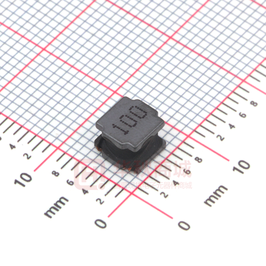

HPC6045NF-100M
HPC6045NF-100M
    TAI-TECH(台庆)
    SMD,6x6mm
    功率电感 10µH ±20% 52mΩ IND_6X6MM_SM
HPC6045NF-100M 数据手册
TAI-TECH P1 SMD Power Inductor HPC6045NF-Series ECN HISTORY LIST REV DATE DESCRIPTION APPROVED CHECKED DRAWN 1.0 16/08/11 新發行 楊祥忠 詹偉特 何秦芝 備 註 TAI-TECH P2 SMD Power Inductor HPC6045NF-Series 1. Features 2. Dimension Halogen Pb Halogen-free Pb-free Recommended Land pattern 2R2 B(mm) B’(mm) C(mm) D(mm) E(mm) HPC6045NF 6.0±0.3 6.0±0.3 Series A(mm) 4.8±0.2 4.2±0.3 1.7±0.3 4.5±0.3 4.25±0.3 F(mm) 2R2 Y D E L(mm) G(mm) G1(mm) H(mm) 6.5 4.25 1.80min 4.8 3. Part Numbering HPC 6045 NF A B C A: Series B: Dimension C: Type D: Inductance E: Inductance Tolerance . - A/B*C 2R2=2.20uh 100=10uh,101=100uh,102=1000uh M=±20%,Y=±30%. marking direction cannot decide polarity. Color: Black, unidirectional. magnetic shielding TAI-TECH P3 4. Specification Part Number Inductance L0 (uH) @0A Rated current Tolerance K L M Temperature current I rms (A) Y Saturation current I sat (A) Typ Max Typ Max DCR (mΩ) @25℃ ±20%. HPC6045NF-R36 0.36 / / ±20% ±30% 9.00 8.50 18.00 16.50 4.80 HPC6045NF-R47 0.47 / / ±20% ±30% 8.60 8.00 17.00 16.00 6.80 HPC6045NF-R82 0.82 / / ±20% ±30% 8.20 7.50 14.50 13.50 8.50 HPC6045NF-1R0 1.00 / / ±20% ±30% 8.00 7.30 13.50 12.50 10.0 HPC6045NF-1R2 1.20 / / ±20% ±30% 7.50 7.00 12.50 11.50 10.5 HPC6045NF-1R3 1.30 / / ±20% ±30% 7.50 7.00 12.50 11.50 10.5 HPC6045NF-1R5 1.50 / / ±20% ±30% 7.00 6.60 12.00 11.00 11.7 HPC6045NF-1R8 1.80 / / ±20% ±30% 6.80 6.20 11.00 10.00 12.0 HPC6045NF-2R0 2.00 / / ±20% ±30% 6.50 5.80 10.50 9.50 13.5 HPC6045NF-2R2 2.20 / / ±20% ±30% 6.00 5.30 9.50 8.55 15.0 HPC6045NF-2R3 2.30 / / ±20% ±30% 5.80 5.00 9.30 8.20 16.0 HPC6045NF-3R0 3.00 / / ±20% ±30% 5.20 4.60 8.00 7.50 20.0 HPC6045NF-3R3 3.30 / / ±20% ±30% 5.00 4.50 7.80 7.30 21.0 HPC6045NF-3R6 3.60 / / ±20% ±30% 4.90 4.30 7.40 6.90 22.5 HPC6045NF-4R7 4.70 / ±15% ±20% ±30% 4.50 4.00 6.80 6.20 26.0 HPC6045NF-5R6 5.60 / ±15% ±20% ±30% 4.10 3.70 6.40 5.70 31.0 HPC6045NF-6R3 6.30 / ±15% ±20% ±30% 3.80 3.50 5.90 5.30 33.0 HPC6045NF-6R8 6.80 / ±15% ±20% ±30% 3.60 3.30 5.70 5.15 34.0 HPC6045NF-8R2 8.20 / ±15% ±20% ±30% 3.40 2.90 5.10 4.50 46.0 HPC6045NF-100 10.0 ±10% ±15% ±20% ±30% 3.20 2.60 4.60 4.20 52.0 HPC6045NF-150 15.0 ±10% ±15% ±20% ±30% 2.80 2.20 3.80 3.30 71.0 HPC6045NF-180 18.0 ±10% ±15% ±20% ±30% 2.60 2.10 3.40 2.90 80.0 HPC6045NF-220 22.0 ±10% ±15% ±20% ±30% 2.30 1.90 3.30 2.70 96.0 HPC6045NF-330 33.0 ±10% ±15% ±20% ±30% 1.80 1.50 2.50 2.10 145 HPC6045NF-470 47.0 ±10% ±15% ±20% ±30% 1.60 1.20 2.00 1.75 200 HPC6045NF-560 56.0 ±10% ±15% ±20% ±30% 1.40 1.00 1.80 1.65 230 HPC6045NF-680 68.0 ±10% ±15% ±20% ±30% 1.10 0.92 1.60 1.52 305 HPC6045NF-820 82.0 ±10% ±15% ±20% ±30% 0.98 0.88 1.50 1.40 365 HPC6045NF-101 100 ±10% ±15% ±20% ±30% 0.92 0.82 1.33 1.25 456 HPC6045NF-121 120 ±10% ±15% ±20% ±30% 0.85 0.79 1.20 1.10 500 HPC6045NF-151 150 ±10% ±15% ±20% ±30% 0.75 0.70 1.10 1.00 626 HPC6045NF-181 180 ±10% ±15% ±20% ±30% 0.68 0.60 1.00 0.90 745 HPC6045NF-221 220 ±10% ±15% ±20% ±30% 0.60 0.50 0.88 0.77 900 HPC6045NF-331 330 ±10% ±15% ±20% ±30% 0.55 0.45 0.60 0.55 1400 HPC6045NF-471 470 ±10% ±15% ±20% ±30% 0.40 0.35 0.50 0.45 2050 Note: 1. All test data referenced to 25℃ ambient , Ls/Q:1MHz/1V. 2. Testing Instrument : HP4284A,CH11025,CH3302,CH1320 ,CH1320S LCR METER / Rdc:CH502BC MICRO OHMMETER. 3. Heat Rated Current (Irms) will cause the coil temperature rise approximately Δt of 40℃ (keep 1min.). 4. Saturation Current (Isat) will cause L0 to drop 30% typical. (keep quickly). 5. The part temperature (ambient + temp rise) should not exceed 125℃under worst case operating conditions.Circuit design,component,PCB trace size and thickness,airflow and other cooling provisions all affect the part temperature. Part temperature should be verified in the end application. 6. Special inquiries besides the above common used types can be met on your requirement. TAI-TECH P4 5. Material List b a c d NO Items Materials a Core Ferrite Core b Wire Copper Wire c Coating Epoxy with magnetic d Solder Lead free 6. Reliability and Test Condition Item Performance Operating temperature -40~+125℃(Including self - temperature rise) Storage temperature -40~+125℃ (on board) Test Condition Electrical Performance Test Inductance Refer to standard electrical characteristics list. DCR HP4284A,CH11025,CH3302,CH1320,CH1320S LCR Meter. CH502BC,Agilent33420A Micro-Ohm Meter. Saturation Current (Isat) △L30% typical. Saturation DC Current (Isat) will cause L0 to drop △L(%)(keep quickly). Heat Rated Current (Irms) Approximately △T≦40℃ Heat Rated Current (Irms) will cause the coil temperature rise △T(℃) without core loss. 1.Applied the allowed DC current(keep 1 min.). 2.Temperature measured by digital surface thermometer Reliability Test Life Test Preconditioning: Run through IR reflow for 2 times.( IPC/JEDEC J-STD-020DClassification Reflow Profiles) Temperature:125±2℃(Bead) Temperature: 85±2℃(Inductor) Applied current:rated current Duration:1000±12hrs Measured at room temperature after placing for 24±2 hrs Load Humidity Preconditioning: Run through IR reflow for 2 times.( IPC/JEDEC J-STD-020DClassification Reflow Profiles Humidity:85±2﹪R.H, Temperature:85℃±2℃ Duration:1000hrs Min. with 100% rated current Measured at room temperature after placing for 24±2 hrs Thermal shock Preconditioning: Run through IR reflow for 2 times.( IPC/JEDEC J-STD-020DClassification Reflow Profiles Condition for 1 cycle Step1:-40±2℃ 30±5min Step2:25±2℃ ≦0.5min Step3:105±2℃ 30±5min Number of cycles: 500 Measured at room temperature after placing for 24±2 hrs Appearance:No damage. Inductance:within±10% of initial value Q:Shall not exceed the specification value. RDC:within ±15% of initial value and shall not exceed the specification value Vibration Oscillation Frequency: 10~2K~10Hz for 20 minutes Equipment: Vibration checker Total Amplitude:1.52mm±10% Testing Time : 12 hours(20 minutes, 12 cycles each of 3 orientations)。 Shock Peak Normal Wave value duration (D) form (g’s) (ms) Shall be mounted on a FR4 substrate of the SMD dimensions: 1500 0.5 Half-sine following >=0805:40x100x1.2mm =0805:1.2mm 0805:1kg ,
