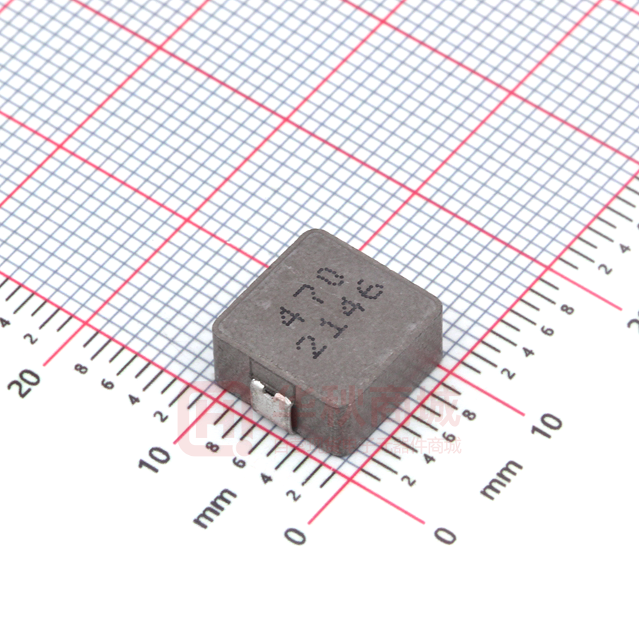

    功率电感 47µH ±20% IND_11X10MM_SM 5.00mm 11.00 x 10.00mm 127mΩ 3.5A
TMPA1005S-470MN-D 数据手册
TAI-TECH SMD Power Inductor TMPA1005S-Series(N)-D 1. Features 1. Shielded construction. 2. Capable of corresponding high frequency . Halogen 3. Low loss realized with low DCR. 4. High performance (Isat) realized by metal dust core. Halogen-free 5. Ultra low buzz noise, due to composite construction. 6. 100% Lead(Pb)-Free and RoHS compliant. 7. Operating temperature -40~+125℃(Including self - temperature rise) 2. Applications 1. DC/DC converters in distributed power systems. 2. DC/DC converter for Field Programmable Gate Array(FPGA). 3. Battery powered devices. 4. Thin type on-board power supply module for exchanger. 5. VRM for server. 6. High current, low profile POL converters. 7. PDA/notebook/desktop/server and battery powered devices. 3. Dimensions C A A` D E B 2R2 1916 leadframe C A A` Recommend PC Board Pattern L H E B 1R0 1916 D non-leadframe Series A A` TMPA1005 11.0±0.5 G B 10.0±0.5 10.0±0.3 C 4.8±0.2 D E See Spec 2.0±0.3 table Unit:mm L(mm) 4. Part Numbering TMPA 1005 S A B C A: Series B: Dimension C: Type D: Inductance E: Inductance Tolerance F: Code - 1R0 MN D E - G(mm) H(mm) 12.5 5.4 3.5 Note: 1. The above PCB layout reference only. 2. Recommend solder paste thickness at 0.15mm and above. D F BxC Standard. R10=0.1uh,1R0=1.0uh,100=10uh,101=100uh,102=1000uh. K=±10%,L=±15%,M=±20%,N=±25%,Y=±30% Marking: Black.1R0 and 1916(19YY, 16 WW,follow production date). TAI-TECH 5. Specification Heat Rating Current DC I rms ( A ) Saturation Current DC I sat ( A ) Part Number Inductance L0 A(uH) ±20% Typ Max Typ Max TMPA1005S-R30MN-D 0.30 36.0 32.0 55.0 TMPA1005S-R36MN-D 0.36 34.0 30.0 TMPA1005S-R47MN-D 0.47 33.0 29.0 TMPA1005S-R68MN-D 0.68 28.0 TMPA1005S-1R0MN-D 1.00 25.0 TMPA1005S-1R5MN-D 1.50 TMPA1005S-2R2MN-D TMPA1005S-3R3MN-D DCR (mΩ)Typ DCR (mΩ)Max E(mm) ±0.3 Type 49.0 0.67 0.80 3.0 non-leadframe 52.0 46.0 0.82 0.92 3.0 non-leadframe 46.0 40.0 1.15 1.32 3.0 non-leadframe 25.0 35.0 32.0 1.60 1.90 2.5 non-leadframe 23.0 33.0 30.0 2.60 3.00 2.5 non-leadframe 23.0 21.0 27.0 24.0 3.40 3.80 2.5 non-leadframe 2.20 19.5 17.5 20.0 18.0 5.10 5.60 3.0 leadframe 3.30 17.0 15.0 17.5 15.5 8.10 9.10 3.0 leadframe TMPA1005S-4R7MN-D 4.70 15.0 13.0 16.0 14.0 9.30 10.5 3.0 leadframe TMPA1005S-5R6MN-D 5.60 13.0 11.0 15.0 12.5 12.8 14.4 3.0 leadframe TMPA1005S-6R8MN-D 6.80 12.0 10.0 14.0 12.0 15.0 17.3 3.0 leadframe TMPA1005S-8R2MN-D 8.20 10.0 8.50 13.5 11.5 16.1 18.8 3.0 leadframe TMPA1005S-100MN-D 10.0 7.6 7.2 13.0 11.0 18.9 21.8 3.0 leadframe TMPA1005S-150MN-D 15.0 6.5 6.0 8.5 7.5 32.0 39.0 3.0 leadframe TMPA1005S-220MN-D 22.0 6.0 5.5 6.0 5.5 44.0 54.0 3.0 leadframe TMPA1005S-330MN-D 33.0 5.5 5.0 5.8 5.2 74.0 86.0 3.0 leadframe TMPA1005S-470MN-D 47.0 4.5 4.0 4.0 3.5 106.0 127.0 3.0 leadframe TMPA1005S-101MN-D 100 2.2 2.0 2.8 2.4 242.0 290.0 3.0 leadframe Note: 1. Test frequency : Ls : 100KHz /1.0V. 2. All test data referenced to 25℃ ambient. 3. Testing Instrument(or equ) : L: HP4284A,CH11025,CH3302,CH1320,CH1320S LCR METER / Rdc:CH16502,Agilent33420A MICRO OHMMETER. 4. Heat Rated Current (Irms) will cause the coil temperature rise approximately ΔT of 40℃ 5. Saturation Current (Isat) will cause L0 to drop approximately 30%. 6. The part temperature (ambient + temp rise) should not exceed 125℃under worst case operating conditions.Circuit design,component,PCB trace size and thickness,airflow and other cooling provisions all affect the part temperature. Part temperature should be verified in the end application. 7. Special inquiries besides the above common used types can be met on your requirement. TAI-TECH 6. Typical Performance Curves
