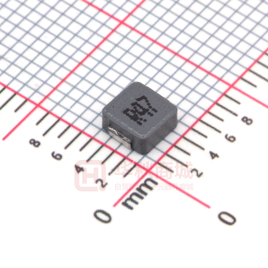

    功率电感 470nH ±20% IND_4.45X4.06MM_SM 2.00mm 4.45 x 4.06mm 14mΩ 7A
TMPC0402HP-R47MG-Z02 数据手册
TAI-TECH P1 SMD Power Inductor TMPC0402HP-Series(G)-Z02 ECN HISTORY LIST REV DATE DESCRIPTION APPROVED CHECKED DRAWN 1.0 15/04/15 新發行 楊祥忠 詹偉特 何秦芝 1.1 15/09/10 更改卷軸 A(mm)尺寸定義 : 12.0±0.5 改 12.4+2/-0 楊祥忠 詹偉特 何秦芝 1.2 17/03/24 增加:電流 MAX 規格 楊祥忠 詹偉特 何秦芝 備 注 TAI-TECH P2 SMD Power Inductor TMPC0402HP-Series(G)-Z02 1. Features 1. Carbonyl powder inductor. 2. Compact design. 3. High current,low DCR,high efficiency. Halogen Pb Halogen-free Pb-free 4. Very low acoustic noise and very low leakage flux noise. 5. High reliability. 6. 100% Lead(Pb) & Halogen-Free and RoHS compliant. 2. Applications Note PC power system,incl. IMVP-6 DC/DC converter . 3. Dimensions Recommend PC Board Pattern Dr. MOS application C D H L E B A   1R0 G Series A(mm) B(mm) TMPC0402HP 4.45±0.25 4.06±0.25 C(mm) D(mm) E(mm) 1.8±0.2 0.76±0.30 2.0±0.20 1R0 MG D E 4. Part Numbering TMPC 0402 HP A B C A: Series B: Dimension C: Type D: Inductance E: Inductance Tolerance F: Control S/N - - Z02 F BxC H: Carbonyl powder, P:PAD broaden. 1R0=1.00uH M=±20% 印字:黑色.單向印字. L(mm) G(mm) H(mm) 5.2 2.2 2.4 Note: 1. The above PCB layout reference only. 2. Recommend solder paste thickness at 0.12mm and above. TAI-TECH P3 5. Specification I rms (A) Part Number Inductance L0 (uH)±20% @0A Typ Max TMPC0402HP-R10YG-Z02 0.10±30% 12.0 10.0 TMPC0402HP-R18YG-Z02 0.18±30% 13.5 11.0 I sat (A) Max DCR(mΩ) Typ.@25℃ DCR(mΩ) Max.@25℃ 35.0 30.0 3.2 4.0 28.0 25.0 4.6 5.4 Typ TMPC0402HP-R22YG-Z02 0.22±30% 13.0 11.0 24.0 21.0 6.6 7.3 TMPC0402HP-R33MG-Z02 0.33 10.0 9.00 18.0 16.0 7.8 8.6 TMPC0402HP-R36MG-Z02 0.36 9.00 8.00 15.0 13.0 8.7 12 TMPC0402HP-R47MG-Z02 0.47 8.00 7.00 120 11.0 11.2 14 TMPC0402HP-R50MG-Z02 0.50 7.80 6.80 11.3 10.0 13 15 TMPC0402HP-R56MG-Z02 0.56 7.30 6.50 10.0 9.00 13.5 16 TMPC0402HP-R60MG-Z02 0.60 7.30 6.50 11.0 10.0 15.5 18.5 TMPC0402HP-R68MG-Z02 0.68 7.00 6.30 10.0 9.00 16 19 TMPC0402HP-R82MG-Z02 0.82 6.00 5.30 9.50 8.50 19 23 TMPC0402HP-1R0MG-Z02 1.00 5.00 4.40 8.50 7.50 22 27 TMPC0402HP-1R2MG-Z02 1.20 4.80 4.20 7.80 7.00 25 30 TMPC0402HP-1R5MG-Z02 1.50 4.50 4.00 7.00 6.20 34.8 42 TMPC0402HP-1R8MG-Z02 1.80 4.30 3.80 6.50 5.80 43 52 TMPC0402HP-2R2MG-Z02 2.20 4.00 3.50 6.00 5.40 51 61 TMPC0402HP-3R3MG-Z02 3.30 3.50 3.00 4.00 3.60 69 76 TMPC0402HP-3R6MG-Z02 3.60 3.10 2.70 3.80 3.40 75 90 TMPC0402HP-4R7MG-Z02 4.70 2.60 2.20 3.50 3.20 95 105 TMPC0402HP-5R6MG-Z02 5.60 2.20 2.00 3.00 2.70 112 125 TMPC0402HP-6R8MG-Z02 6.80 2.10 1.80 2.80 2.50 150 172 TMPC0402HP-8R2MG-Z02 8.20 2.00 1.60 2.50 2.20 158 180 TMPC0402HP-100MG-Z02 10.0 1.80 1.40 2.30 2.00 215 243 TMPC0402HP-120MG-Z02 12.0 1.65 1.30 2.10 1.90 275 330 TMPC0402HP-150MG-Z02 15.0 1.50 1.20 1.90 1.70 325 374 TMPC0402HP-200MG-Z02 20.0 1.30 1.10 1.70 1.50 435 480 TMPC0402HP-220MG-Z02 22.0 1.20 1.00 1.40 1.20 470 500 Note: 1. Test frequency : L/Q : 100KHz /1.0V; 2. All test data referenced to 25℃ ambient. 3. Testing Instrument : L/Q: HP4284A,CH11025,CH3302,CH1320 ,CH1320S LCR METER / Rdc:CH16502,Agilent33420A MICRO OHMMETER. 4. Heat Rated Current (Irms) will cause the coil temperature rise approximately Δt of 40℃. 5. Saturation Current (Isat) will cause L0 to drop approximately 20%; 6. The part temperature (ambient + temp rise) should not exceed 125℃under worst case operating conditions.Circuit design,component,PCB trace size and thickness,airflow and other cooling provisions all affect the part temperature. Part temperature should be verified in the end application. 7. Special inquiries besides the above common used types can be met on your requirement. TAI-TECH P4 6. Material List NO Items Materials 1 Core Carbonyl Powder. 2 Wire Polyester Wire or equivalent. 3 Clip 100% Pb free solder(Ni+Sn---Plating) 4 paint Epoxy resin 5 Ink Halogen-free ketone 7. Reliability and Test Condition Item Performance Operating temperature -40~+125℃ (Including self - temperature rise) Storage temperature 1.-10~+40℃,50~60%RH (Product without taping) 2.-40~+125℃ (on board) Test Condition Electrical Performance Test Inductance Refer to standard electrical characteristics list. DCR HP4284A,CH11025,CH3302,CH1320,CH1320S LCR Meter. CH16502,Agilent33420A Micro-Ohm Meter. Saturation Current (Isat) Approximately △L20%. Saturation DC Current (Isat) will cause L0 to drop △L(%) Heat Rated Current (Irms) Approximately △T40℃ Heat Rated Current (Irms) will cause the coil temperature rise △T(℃). 1.Applied the allowed DC current 2.Temperature measured by digital surface thermometer Reliability Test Preconditioning: Run through IR times.( IPC/JEDEC J-STD-020DClassification Reflow Profiles) Temperature: 125±2℃(Inductor) Life Test reflow for 2 Applied current:rated current Duration:1000±12hrs Measured at room temperature after placing for 24±2 hrs Preconditioning: Run through IR times.( IPC/JEDEC J-STD-020DClassification Reflow Profiles Humidity:85±2﹪ R.H, Load Humidity reflow for 2 Temperature:85℃±2℃ Duration:1000hrs Min. with 100% rated current Measured at room temperature after placing for 24±2 hrs Appearance:No damage. Moisture Resistance Inductance:within±10% of initial value Q:Shall not exceed the specification value. RDC:within ±15% of initial value and shall not exceed the specification value Thermal shock Preconditioning: Run through IR reflow for 2 times.( IPC/JEDEC J-STD-020DClassification Reflow Profiles 1. Baked at50℃ for 25hrs, measured at room temperature after placing for 4 hrs. 2. Raise temperature to 65±2℃ 90-100%RH in 2.5hrs, and keep 3 hours, cool down to 25℃ in 2.5hrs. 3. Raise temperature to 65±2℃ 90-100%RH in 2.5hrs, and keep 3 hours, cool down to 25℃ in 2.5hrs,keep at 25℃ for 2 hrs then keep at -10℃ for 3 hrs 4. Keep at 25℃ 80-100%RH for 15min and vibrate at the frequency of 10 to 55 Hz to 10 Hz, measure at room temperature after placing for 1~2 hrs. Preconditioning: Run through IR reflow times.( IPC/JEDEC J-STD-020DClassification Reflow Profiles Condition for 1 cycle Step1:-40±2℃ 30±5min for Step2:25±2℃ ≦0.5min Step3:125±2℃ 30±5min Number of cycles: 500 Measured at room temperature after placing for 24±2 hrs Oscillation Frequency: 10~2K~10Hz for 20 minutes Vibration Equipment: Vibration checker Total Amplitude:1.52mm±10% Testing Time : 12 hours(20 minutes, 12 cycles each of 3 orientations)。 2 TAI-TECH Item Shock P5 Performance Type Peak value (g’s) Normal duration (D) (ms) Wave form Velocity change (Vi)ft/sec SMD 50 11 Half-sine 11.3 Lead 50 11 Half-sine 11.3 Appearance:No damage. Inductance:within±10% of initial value Q:Shall not exceed the specification value. RDC:within ±15% of initial value and shall not exceed the specification value Bending Solderability Test Condition More than 95% of the terminal electrode should be covered with solder。 Shall be mounted on a FR4 substrate of the following dimensions: >=0805 inch(2012mm):40x100x1.2mm =0805 inch(2012mm):1.2mm 0805 inch(2012mm):1kg ,
