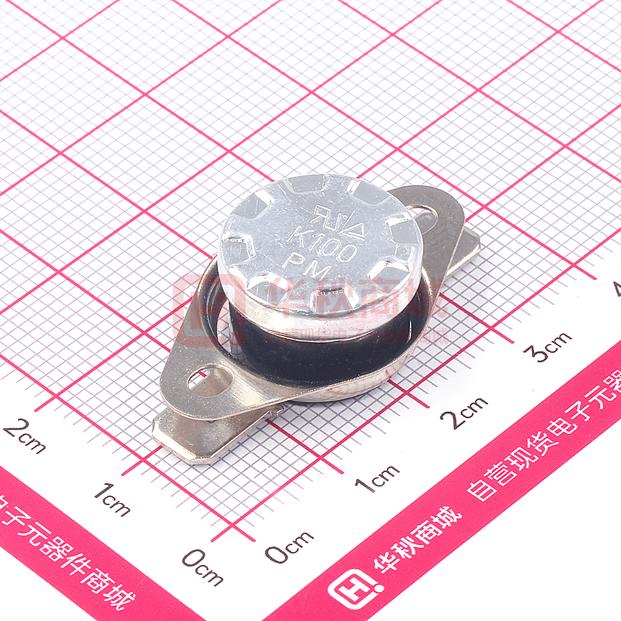

    XCFUSE(旭程)
    SW2_33.6X32MM_TM
    温控开关 SW2_33.6X32MM_TM 10A 250V ±3℃ 100℃ 10000Cycles
