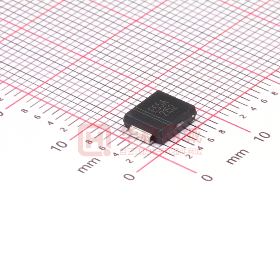

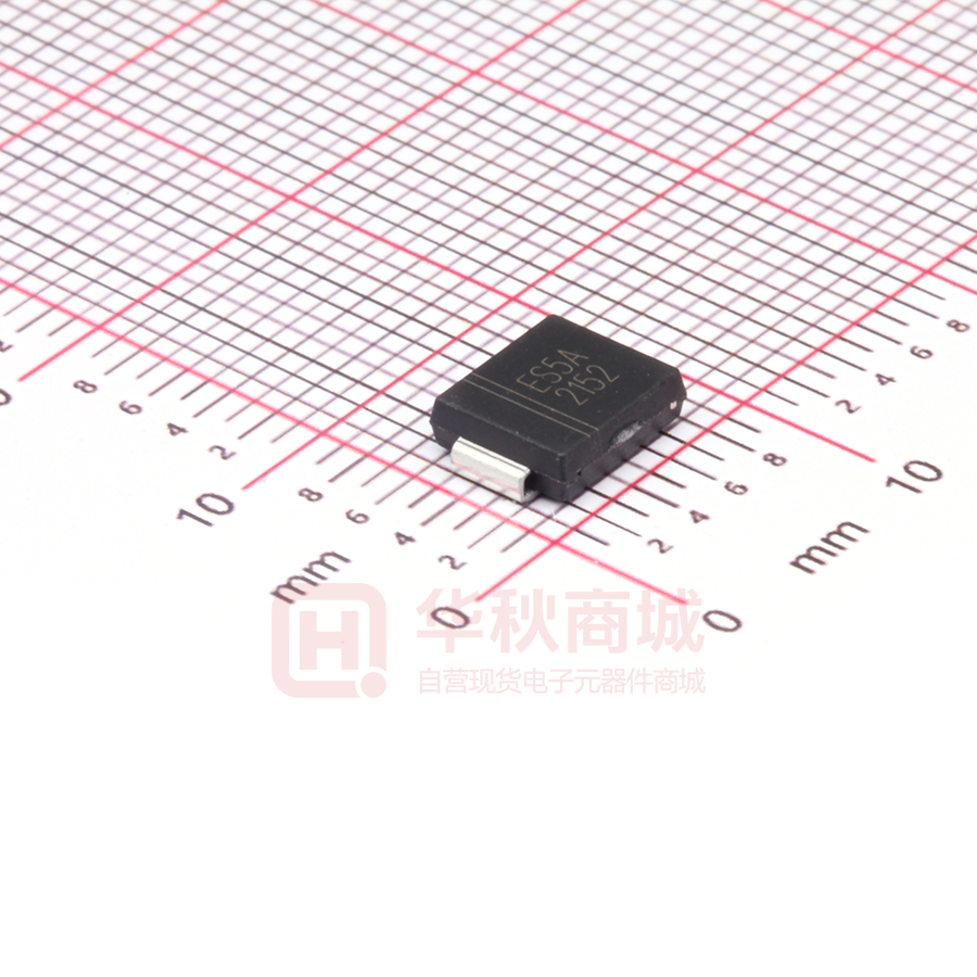

    二极管配置:独立式 直流反向耐压(Vr):50V 平均整流电流(Io):5A 正向压降(Vf):1V@5A 反向电流(Ir):5μA@50V 反向恢复时间(trr):35ns 工作温度(最小值):-5...
ES5AC 数据手册
山东晶导微电子股份有限公司 ES5AC THRU ES5JC Jingdao Microelectronics co.LTD Surface Mount Superfast Recovery Rectifier Reverse Voltage – 50 to 600 V Forward Current –5 A PINNING PIN FEATURES • For surface mounted applications • Low profile package • Glass Passivated Chip Junction • Superfast reverse recovery time • Lead free in comply with EU RoHS 2011/65/EU directives DESCRIPTION 1 Cathode 2 Anode 2 1 MECHANICAL DATA • Case : SMC • Terminals: Solderable per MIL-STD-750, Method 2026 • A pprox. Weight : 0.22g / 0.0077oz Top View Marking Code: ES5A~ES5J Simplified outline SMC and symbol Absolute Maximum Ratings and Characteristics Ratings at 25 °C ambient temperature unless otherwise specified. Single phase, half wave, 60 Hz, resistive or inductive load. For capacitive load, derate current by 20%. Symbols Parameter ES5AC ES5BC ES5CC ES5DC ES5EC ES5GC ES5JC Units Maximum Repetitive Peak Reverse Voltage V RRM 50 100 150 200 300 400 600 V Maximum RMS voltage V RMS 35 70 105 140 210 280 420 V Maximum DC Blocking Voltage V DC 50 100 150 200 300 400 600 V Maximum Average Forward Rectified Current at T c = 100 °C I F(AV) 5 A Peak Forward Surge Current 8.3 ms Single Half Sine Wave Superimposed on Rated Load I FSM 120 A Maximum Forward Voltage at 5 A VF Maximum DC Reverse Current T a = 25 °C at Rated DC Blocking Voltage T a =125 °C Typical Junction Capacitance at V R =4V, f=1MHz Maximum Reverse Recovery Time (1) Typical Thermal Resistance (2) Operating and Storage Temperature Range 1.25 1 1.68 V IR 5 100 μA Cj 50 pF t rr 35 ns RθJA RθJC 35 13 °C/W T j , T stg -55 ~ +150 °C (1)Measured with I F = 0.5 A, I R = 1 A, I rr = 0.25 A . (2)P.C.B. mounted with 2.0" X 2.0" (5 X 5 cm) copper pad areas. 2017.04 SMC-E-ES5AC~ES5JC-5A600V Page 1 of 3 山东晶导微电子股份有限公司 ES5AC THRU ES5JC Jingdao Microelectronics co.LTD Fig.1 Reverse Recovery Time Characteristic And Test Circuit Diagram 50 ohm Noninductive t rr 10 ohm Noninductive +0.5 D.U.T + PULSE GENERATOR Note 2 25Vdc approx 0 - -0.25 1 ohm NonInductive OSCILLOSCOPE Note 1 -1.0 Note:1.Rise Time = 7ns, max. Input Impedance = 1megohm,22pF. 2. Ries Time =10ns, max. Source Impedance = 50 ohms. 10ns/div Set time Base for 10ns/div Fig.3 Typical Reverse Characteristics 7.0 300 6.0 100 I R - Reverse Current ( μ A) Average Forward Current (A) Fig.2 Maximum Average Forward Current Rating 5.0 4.0 3.0 2.0 1.0 Single phase half-wave 60 Hz resistive or inductive load T J =125°C 10 T J =75°C 1.0 T J =25°C 0.1 0.0 25 50 75 100 125 150 0 175 20 40 Case Temperature (°C) Junction Capacitance ( pF) Instaneous Forward Current (A) T J =25°C 1.0 ES5AC~ES5DC ES5EC/ES5GC ES5JC 0.01 T J =25°C 100 0.001 0.5 1.0 1.5 100 Fig.5 Typical Junction Capacitance 10 0 80 % of PIV.VOLTS Fig.4 Typical Forward Characteristics 0.1 60 2.0 2.5 Instaneous Forward Voltage (V) 10 T J=25°C f = 1.0MHz V sig = 50mV p-p 1 0.1 1.0 10 100 Reverse Voltage (V) Peak Forward Surage Current (A) Fig.6 Maximum Non-Repetitive Peak Forward Surage Current 140 120 100 80 60 40 20 8.3 ms Single Half Sine Wave (JEDEC Method) 00 1 10 100 Number of Cycles 2017.04 www.sdjingdao.com Page 2 of 3 山东晶导微电子股份有限公司 ES5AC THRU ES5JC Jingdao Microelectronics co.LTD PACKAGE OUTLINE SMC Plastic surface mounted package; 2 leads E A A1 A C b D L E1 VM A SMC mechanical data A E D E1 A1 C L b max 2.62 7.0 6.2 8.0 0.21 0.31 1.6 3.25 min 2.00 6.5 5.6 7.6 0.05 0.15 0.9 2.75 max 103 276 244 315 8.3 12 63 128 min 79 256 220 299 2.0 5.9 35 108 UNIT mm mil Marking The recommended mounting pad size 3.8 (150) 4.1 (160) 4.3 (170) 4.1 (160) Type number Marking code ES5AC ES5A ES5BC ES5B ES5CC ES5C ES5DC ES5D ES5EC ES5E ES5GC ES5G ES5JC ES5J mm Unit : (mil) 2017.04 JD704229B5 Page 3 of 3
