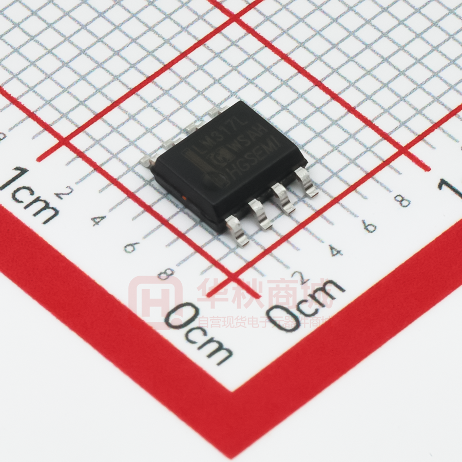

The LM317L is available in a standard TO-92 transistor
package, the SO-8 package, and 6-Bump micro SMD package. The LM317L is rated for operation over a −25˚C to
125˚C range.

Connection Diagrams
TO-92 Plastic package
8-Pin SOIC
Top View
