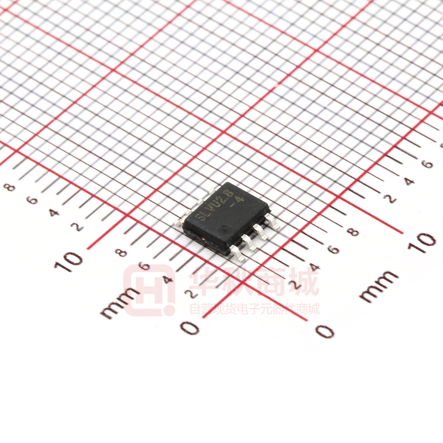

SLVU2.8-4N ESD Protection Diode Array » Features ■ 240Watts peak pulse power (tp = 8/20μs,Pin1,8-2,7 Pin3,6-4,5) ■ SOP8 package ■ Solid-state silicon-avalanche technology ■ Low clamping voltage ■ Low leakage current ■ Protection four data/power line ■ IEC 61000-4-2 ±30V contact ±30kV air ■ 1.2/50μs 12ohm 2kV (GbE PHY side) ■ 10/700μs 40ohm 4kV (GbE PHY side) » Applications ■ 10/100/1000 Ethernet ■ LAN/WAN Equipment ■ Security Cameras ■ » Mechanical Data ■ SOP8 package ■ Molding compound flammability rating: UL 94V-0 Notebook and PC Computers ■ Packaging: Tape and Reel ■ Integrated magnetics/RJ-45 connectors ■ RoHS/WEEE Compliant ■ Industry Control » Schematic & PIN Configuration Revision 2018 8 7 6 5 1 2 3 4 www.born-tw.com 1/5 SLVU2.8-4N » Absolute Maximum Rating Rating Symbo Peak Pulse Power ( tp =8/20μs ) Value Units PPP Pin1,8-2,7 Pin3,6-4,5 240 W Ipp Pin1,8-2,7 Pin3,6-4,5 16 A 30 30 kV Peak Pulse Current ( tp =8/20μs ) (note1) ESD per IEC 61000-4-2 (Air) ESD per IEC 61000-4-2 (Contact) Conditions VESD Lead Soldering Temperature TL 260(10seconds) ℃ Junction Temperature TJ -55 to + 125 ℃ Storage Temperature Tstg -55 to + 125 ℃ » Electrical Characteristics Parameter Symbol Reverse Stand-Off Voltage Conditions Min Typical VRWM Max Units 5.0 V VBR IT=1mA Reverse Leakage Current IR VRWM=5V,T=25℃ 0.2 0.5 uA Clamping Voltage VC IPP=16A,tp=8/20μs Pin1,8-2,7,Pin3,6-4,5 12 15 V Junction Capacitance Cj VR = 0V, f = 1MHz Pin1,8-2,7 Pin3,6-4,5 1.2 1.4 pF Reverse Breakdown Voltage » 6 8.0 V Electrical Parameters (TA = 25°C unless otherwise noted) Symbol IPP Maximum Reverse Peak Pulse Current VC Clamping Voltage @ IPP VRWM IR VBR IT I Parameter IPP Working Peak Reverse Voltage VC VBR Maximum Reverse Leakage Current @ V RWM VRWM IT IR I IT R VRWM VBR VC V Breakdown Voltage @ IT Test Current IPP Note:. 8/20μs pulsewaveform. Revision 2018 www.born-tw.com 2/5 SLVU2.8-4N » Typical Characteristic Curves Fig.1 Peak Pulse Power RatingCurve Fig.2 Pulse Derating Curve Percent of Rated Power for Ipp Peak Pulse Power –PPP(KW) 10 240w 8/20μswaveform 1 0.1 0.01 0.1 1 10 100 110 100 8 0 6 0 40 2 0 0 1000 0 Pulse Duration tp(μs) Fig.3 PulseWaveform-8/20μs 120 Fig.4 PulseWaveform-ESD(IEC61000-4-2) 100%IPP , 8μS 100% 90% 30ns 80 50%IPP, 20μS e-t 60 Percent of IPP Percent of IPP 100 40 20 0 150 25 50 75 100 1 Ambient Temperature—TA(℃) 60ns 10% 0 5 10 15 20 25 30 tr 0.7 to 1ns 0 30 Time (μs) Fig.5 Eye Diagram - HDMI mask at 5.0Gbpsper channel 60 Time (ns) Fig.6 Insertion LossS21 2 3.2GHz @ -1dB Horizontal: 50 ps/div Vertical: 200 mV/div Insertion Loss (dB) 0 -2 -4 5GHz @ -3dB -6 -8 -10 100k 1M 10M 100M 1G 10G Frequency (Hz) Revision 2018 www.born-tw.com 3/5 SLVU2.8-4N » Application Information Lightning Surge Test Results for Gigabit Ethernet During the metallic (line-to-line) surge test, the line being stressed is tied to the surge generator with the remaining lines tied together and connected to the generator ground. Current will flow through the line transformer transferring energy to the PHY side of the transformer. Figure 7 shows the test set-up for measuring the clamping voltage of the device. This set up is designed to test the surge in an actual gigabit Ethernet (GbE) circuit. Two 4.7 Ohm resistors is used for decoupling. The clamping voltage of the SLVU2.8-4N for a metallic mode 4000V (100A) 10/700μs surge. The clamping voltage, measured at less than 13 volts, provides sufficient clamping margin to minimize electrical stress and is well below the failure voltage range of typical GbE PHY chips (Figure 8 ). Ipp RL =4.7Ω + + Vin Vc R L =4.7 Ω - Gigabit Ethernet Phy - Figure 7 - Clamping Voltage Test Set-Up RJ-45 1 2 3 4 5 6 7 8 Gigabit Ethernet PHY Figure 8 - GbE Protection to Lightning, ESD, and CDE Revision 2018 www.born-tw.com 4/5 SLVU2.8-4N » Outline Drawing – SOP8 Ref. (mm) A a1 a2 b b1 C D E e e3 F L M » C Min. Typ. 0.10 0.35 0.19 4.80 5.80 3.80 0.40 0.50 1.27 3.81 0.85 Max. 5.00 6.20 b1 A a2 1.75 0.25 1.65 0.48 0.25 45° b e e3 8° a1 L D E F 4.00 1.27 0.6 M Marking SLVU2.8 -4L » Ordering information Order code SLVU2.8-4N Revision 2018 Package SOP8 Base qty 2500 www.born-tw.com Delivery mode Tape and reel 5/5
