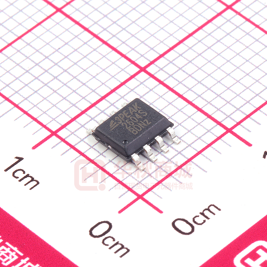

TP2604  /  TP2608 Dual/Quad, Ultra‐low  Distortion,  36V  RRO  Op‐amps     Features  Ultra-low Distortion: 0.0001% at 1 kHz  Low Noise: 17 nV/√Hz  High Slew Rate: 6.5 V/μs  Wide Bandwidth: 10 MHz  Low Supply Current: 1.2mA per Amplifier  Wide Supply Range: 2.7 V to 36 V, or Dual-Supply ±1.35 V to ±18 V  Low Input Offset Voltage: 0.5 mV Typical  Low VOS TC: 2.0 µV/°C  Low Input Bias Current: 0.04 pA Typical  Rail-to-Rail Output Voltage Range  Unity Gain Stable for 220pF Capacitive Load  Drive 600 Ω Load  –40°C to 125°C Operation Range  Green, Popular Type Package Description The TP2604/2608 are ultra-low distortion, high-voltage CMOS op-amps featuring THD+N of 0.0001% at 1kHz. This feature along with its low noise, very high PSRR makes TP260x ideal choices for professional audio equipments. The TP2604/2608 are unity gain stable with 220pF capacitive load with a wide 10MHz bandwidth, 6.5V/μs high slew rate, which makes the device appropriate for current-to-voltage converters. The TP2604/2608 can operate from a single-supply voltage of +2.7V to +36.0V or a dual-supply voltage of ±1.35V to ±18.0V. Rail-to-rail output characteristics allow the full power-supply voltage to be used for signal range. The TP2604 is dual channel version available in 8-pin SOIC and MSOP package. The TP2608 is quad channel version available in 14-pin SOIC and TSSOP package. 3PEAK and the 3PEAK logo are registered trademarks of Applications       Professional Audio Equipments Line Drivers or Line Receivers Pre-amplification and Filtering PCM DAC I/V Converter Transducer Amplifier Data Acquisition Pin Configuration (Top View) 3PEAK INCORPORATED. All other trademarks are the property of their respective owners. Related 36V RRO Op-amps Supply Voltage Single 2.7V to 36V or Dual ±1.35V to ±18V Supply Current 125 μA GBWP Slew Rate 350 μA 1.2 mA 1.5 MHz 3 MHz 10 MHz 0.8 V/μs 3 V/μs 6.5 V/μs Dual TP2614 TP2634 TP2604 Quad TP2618 TP2638 TP2608 LEFT DAC TP2604 RIGHT DAC   Figure 1. TP2604 in Audio Equipment www.3peakic.com REV0.0 1  TP2604 / TP2608    Dual/Quad, Ultra‐low Distortion, 36V RRO Op‐amps Order Information Model Name TP2604 TP2608 Order Number Package Marking Information Transport Media, Quantity TP2604-SR 8-Pin SOIC Tape and Reel, 4,000 2604S TP2604-VR 8-Pin MSOP Tape and Reel, 3,000 2604V TP2608-SR 14-Pin SOIC Tape and Reel, 2,500 2608S TP2608-TR 14-Pin TSSOP Tape and Reel, 3,000 2608T Note (1): ‘YW’ is date coding scheme. 'Y' stands for calendar year, and 'W' stands for single workweek coding scheme. Absolute Maximum Ratings Note 1 Supply Voltage: V+ – V–....................................48.0V – + Input Voltage............................. V – 0.3 to V + 0.3 Current at Supply Pins……………............... ±60mA Operating Temperature Range........–40°C to 125°C ±20mA Maximum Junction Temperature................... 150°C Output Current: OUT.................................... ±25mA Storage Temperature Range........... –65°C to 150°C Input Current: +IN, –IN Note 2.......................... Output Short-Circuit Duration Note 3…......... Indefinite Lead Temperature (Soldering, 10 sec) ......... 260°C Note 1: Stresses beyond those listed under Absolute Maximum Ratings may cause permanent damage to the device. Exposure to any Absolute Maximum Rating condition for extended periods may affect device reliability and lifetime. Note 2: The inputs are protected by ESD protection diodes to each power supply. If the input extends more than 500mV beyond the power supply, the input current should be limited to less than 10mA. Note 3: A heat sink may be required to keep the junction temperature below the absolute maximum. This depends on the power supply voltage and how many amplifiers are shorted. Thermal resistance varies with the amount of PC board metal connected to the package. The specified values are for short traces connected to the leads. ESD, Electrostatic Discharge Protection 2  Symbol Parameter Condition HBM Human Body Model ESD MIL-STD-883H Method 3015.8 3 kV CDM Charged Device Model ESD JEDEC-EIA/JESD22-C101E 2 kV REV0.0 Minimum Level Unit www.3peakic.com          TP2604 / TP2608 Dual/Quad,  Ultra‐low  Distortion,  36V  RRO Op‐amps Electrical Characteristics The specifications are at TA = 27°C. VSUPPLY = ±15V, VCM = VOUT =0V, RL = 100kΩ, CL =100pF. SYMBOL VOS VOS TC IB PARAMETER UNITS -4.0 +4.0 mV Input Offset Voltage Drift -40°C to 125°C TA = 27 °C 0.04 pA TA = 85 °C 100 pA TA = 125 °C 5.7 nA 0.001 pA f = 0.1Hz to 10Hz 3.2 μVRMS f = 20Hz to 20kHz 2.0 μVRMS f = 1kHz Differential Common Mode VCM = -14.6V to 13V 17 nV/√Hz Input Bias Current Input Voltage Noise Input Voltage Noise Density Input Capacitance PSRR Common Mode Rejection Ratio Common-mode Input Voltage Range Power Supply Rejection Ratio AVOL Open-Loop Large Signal Gain VOL, VOH Output Swing from Supply Rail RLOAD = 100kΩ ROUT Closed-Loop Output Impedance RO VCM MAX ±0.5 2.0 VN CMRR TYP VCM = VDD/2 Input Offset Current CIN MIN Input Offset Voltage IOS eN CONDITIONS μV/°C 2.9 5 126 V– pF dB V+-2.0 V 130 dB VOUT = 0V, RLOAD = 100kΩ 110 130 dB VOUT = -14.9V to 14.9V, RLOAD = 100kΩ 110 130 dB 50 mV G = 1, f = 1kHz, IOUT = 0 0.01 Ω Open-Loop Output Impedance f = 1kHz, IOUT = 0 125 Ω ISC Output Short-Circuit Current Sink or source current 25 mA VDD Supply Voltage IQ Quiescent Current per Amplifier PM Phase Margin GM GBWP SR FPBW tS THD+N Xtalk 2.7 36 V 1.2 mA RLOAD = 100kΩ, CLOAD = 100pF 56 ° Gain Margin RLOAD = 100kΩ, CLOAD = 100pF 8 dB Gain-Bandwidth Product f = 1kHz AV = 1, VOUT = 0V to 10V, CLOAD = 100pF, RLOAD = 100kΩ 10 MHz 6.5 V/μs 70 1.5 1.6 kHz 0.0001 % 110 dB Slew Rate Full Power Bandwidth Note 1 Settling Time, 0.1% Settling Time, 0.01% Total Harmonic Distortion and Noise Channel Separation AV = –1, 10V Step f = 1kHz, AV =1, RL = 1kΩ, VOUT = 3.5VRMS f = 1kHz, RL = 1kΩ μs Note 1: Full power bandwidth is calculated from the slew rate FPBW = SR/π • VP-P www.3peakic.com REV0.0 3  TP2604 / TP2608    Dual/Quad, Ultra‐low Distortion, 36V RRO Op‐amps Typical Performance Characteristics Total Harmonic Distortion + Noise vs. Frequency Total Harmonic Distortion + Noise vs. Output Voltage  0.01 0.1 V DD=30V RL=1kΩ Vo=3.5Vrms 0.001 THD+N (%) THD+N (%) 0.01 VDD=30V RL=1kΩ f=1kHz G=10V/V 0.001 0.0001 0.0001 G=1V/V 0.00001 0.00001 10 100 1k 10k Frequency (Hz) 0.1 100k 1 10 100 Output Voltage (Vp-p)             Open-Loop Gain and Phase Input Voltage Noise Spectral Density 1k 180 V DD=30V RL=1kΩ Noise (nV/√Hz) Gain(dB) & Phase 130 Phase 80 30 1 1 10 100 1k 10k 100k Frequency (Hz) 1M 0.1 10M 100M   1 10 100 1k 10k 100k 1M Frequency (Hz)               Input Bias Current vs. Temperature    Input Bias Current vs. Input Common Mode Voltage  1E-08 1E-08 1E-10 Input Bias Current (A) Input Bias Current (A) 10 Open Loop Gain -20 1E-12 1E-14 1E-16 1E-10 1E-12 1E-14 1E-18 -50 0 50 Temperature (C) -15 100 -10 -5 0 5 10 Common Mode Voltage (V) 15             4  100 REV0.0   www.3peakic.com          TP2604 / TP2608 Dual/Quad,  Ultra‐low  Distortion,  36V  RRO Op‐amps Common Mode Rejection Ratio Unity Gain Bandwidth vs. Temperature 12 Unity Gain Bandwidth (MHz) CMRR(dB) 150 100 11.5 11 50 -15 -10 -5 0 5 10 Common Mode Voltage (V)   -50 15 0 50 100 Temperature (C)                          Quiescent Current vs. Temperature Short Circuit Current vs. Temperature Short Circuit Current (mA) 31 30 29 Sinking Current 28 27 26 25 Sourcing Current 24 -50 0 50 Temperature (C) 100                  Power-Supply Rejection Ratio   Quiescent Current vs. Supply Voltage 150 PSRR+ PSRR(dB) PSRR100 50 0 1 10 100 1k 10k 100k Frequency (Hz) 1M 10M              www.3peakic.com REV0.0 5  TP2604 / TP2608    Dual/Quad, Ultra‐low Distortion, 36V RRO Op‐amps Pin Functions -IN: Inverting Input of the Amplifier. Voltage range of this pin can go from V– to (V+ - 2.0V). +IN: Non-Inverting Input of Amplifier. This pin has the same voltage range as –IN. OUT: Amplifier Output. The voltage range extends to within milli-volts of each supply rail. V+ or +VS: Positive Power Supply. Typically the voltage is from 2.7V to 36V. Split supplies are possible as long as the voltage between V+ and V– is between 2.7V and 36V. A bypass capacitor of 0.1μF as close to the part as possible should be used between power supply pins or between supply pins and ground. V– or –VS: Negative Power Supply. It is normally tied to ground. It can also be tied to a voltage other than ground as long as the voltage between V+ and V– is from 2.7V to 36V. If it is not connected to ground, bypass it with a capacitor of 0.1μF as close to the part as possible. Operation The TP2604 and TP2608 have input signal range from V– to (V+ – 2.0V). The output can extend all the way to the supply rails. The input stage is comprised of a PMOS differential amplifier for best noise and THD performance. The Class-AB control buffer and output bias stage uses a proprietary compensation technique to take full advantage of the process technology to drive very high capacitive loads. This is evident from the transient over shoot measurement plots in the Typical Performance Characteristics. Applications Information Wide Supply Voltage The TP2604/2608 operational amplifiers can operate with power supply voltages from 2.7V to 36V. Each amplifier draws 1.2mA quiescent current at 30V supply voltage. The TP2604/2608 is optimized for wide bandwidth low power applications. They have an industry leading high GBW to power ratio and the GBW remains nearly constant over specified temperature range. Low Input Referred Noise The TP2604/2608 provides a low input referred noise density of 17nV/√Hz at 1kHz. The voltage noise will grow slowly with the frequency in wideband range, and the input voltage noise is typically 2.0μVRMS at the frequency of 20Hz to 20kHz. Ultra Low Distortion The TP2604/2608 has an ultra low distortion of less than 0.0001% at 1kHz. Along with its low voltage noise, TP2604/2608 is ideal for high-fidelity audio signal amplification or filtering. Low Input Bias Current The TP2604/2608 is a CMOS OPA family and features very low input bias current in pA range. The low input bias current allows the amplifiers to be used in applications with high resistance sources. Care must be taken to minimize PCB Surface Leakage. See below section on “PCB Surface Leakage” for more details. PCB Surface Leakage In applications where low input bias current is critical, Printed Circuit Board (PCB) surface leakage effects need to be considered. Surface leakage is caused by humidity, dust or other contamination on the board. Under low humidity conditions, a typical resistance between nearby traces is 1012Ω. A 5V difference would cause 5pA of current to flow, which is greater than the TP2604/2608 OPA’s input bias current at +27°C (±1pA, typical). It is recommended to use multi-layer PCB layout and route the OPA’s -IN and +IN signal under the PCB surface. The effective way to reduce surface leakage is to use a guard ring around sensitive pins (or traces). The guard ring is biased at the same voltage as the sensitive pin. An example of this type of layout is shown in Figure 2 for Inverting Gain application. 6  REV0.0 www.3peakic.com          TP2604 / TP2608 Dual/Quad,  Ultra‐low  Distortion,  36V  RRO Op‐amps 1. For Non-Inverting Gain and Unity-Gain Buffer: a) Connect the non-inverting pin (VIN+) to the input with a wire that does not touch the PCB surface. b) Connect the guard ring to the inverting input pin (VIN–). This biases the guard ring to the Common Mode input voltage. 2. For Inverting Gain and Trans-impedance Gain Amplifiers (convert current to voltage, such as photo detectors): a) Connect the guard ring to the non-inverting input pin (VIN+). This biases the guard ring to the same reference voltage as the op-amp (e.g., VDD/2 or ground). b) Connect the inverting pin (VIN–) to the input with a wire that does not touch the PCB surface.   Figure 2 The Layout of Guard Ring Ground Sensing and Rail to Rail Output The TP2604/2608 family has excellent output drive capability. It drives 600 load directly with good THD performance. The output stage is a rail-to-rail topology that is capable of swinging to within 50mV of either rail. The maximum output current is a function of total supply voltage. As the supply voltage to the amplifier increases, the output current capability also increases. Attention must be paid to keep the junction temperature of the IC below 150°C when the output is in continuous short-circuit. The output of the amplifier has reverse-biased ESD diodes connected to each supply. The output should not be forced more than 0.3V beyond either supply, otherwise current will flow through these diodes. Driving Large Capacitive Load The TP2604/2608 op-amp family is designed to drive large capacitive loads. As always, larger load capacitance decreases overall phase margin in a feedback system where internal frequency compensation is utilized. As the load capacitance increases, the feedback loop’s phase margin decreases, and the closed-loop bandwidth is reduced. This produces gain peaking in the frequency response, with overshoot and ringing in output step response. The unity-gain buffer (G = +1V/V) is the most sensitive to large capacitive loads. When driving large capacitive loads with the TP2604/2608 op-amp family (e.g., > 1,000 pF), different compensation schemes (Figure 3) improve the feedback loop’s phase margin and stability.          CC  120 1012 CL                                                         RC  www.3peakic.com R2 4CL 1010  1 CC  CL  103   RC REV0.0 7  TP2604 / TP2608    Dual/Quad, Ultra‐low Distortion, 36V RRO Op‐amps          CC  50                                                             R2 CL RC  R2 2CL  1010  1  R2 R1  CC  CL  103   RC         RC  NOTE R2 10 2CL  10  1  R2 R1  CC  CL  103                     R2 RC  10 RC 2CL  10  1  R2 R1  CC  CL  103   RC : Design equations and component values are approximate, User adjustment is required for optimum performance. Figure 3 Driving Large Capacitive Loads Power Supply Layout and Bypass The TP2604/2608 OPA’s power supply pin (VDD for single-supply) should have a local bypass capacitor (i.e., 0.01μF to 0.1μF) within 2mm for good high frequency performance. It can also use a bulk capacitor (i.e., 1μF or larger) within 100mm to provide large, slow currents. This bulk capacitor can be shared with other analog parts. Ground layout improves performance by decreasing the amount of stray capacitance and noise at the OPA’s inputs and outputs. To decrease stray capacitance, minimize PC board lengths and resistor leads, and place external components as close to the op amps’ pins as possible. Proper Board Layout To ensure optimum performance at the PCB level, care must be taken in the design of the board layout. To avoid leakage currents, the surface of the board should be kept clean and free of moisture. Coating the surface creates a barrier to moisture accumulation and helps reduce parasitic resistance on the board. Keeping supply traces short and properly bypassing the power supplies minimizes power supply disturbances due to output current variation, such as when driving an ac signal into a heavy load. Bypass capacitors should be connected as closely as possible to the device supply pins. Stray capacitances are a concern at the outputs and the inputs of the amplifier. It is recommended that signal traces be kept at least 5mm from supply lines to minimize coupling. 8  REV0.0 www.3peakic.com          TP2604 / TP2608 Dual/Quad,  Ultra‐low  Distortion,  36V  RRO Op‐amps A variation in temperature across the PCB can cause a mismatch in the Seebeck voltages at solder joints and other points where dissimilar metals are in contact, resulting in thermal voltage errors. To minimize these thermocouple effects, orient resistors so heat sources warm both ends equally. Input signal paths should contain matching numbers and types of components, where possible to match the number and type of thermocouple junctions. For example, dummy components such as zero value resistors can be used to match real resistors in the opposite input path. Matching components should be located in close proximity and should be oriented in the same manner. Ensure leads are of equal length so that thermal conduction is in equilibrium. Keep heat sources on the PCB as far away from amplifier input circuitry as is practical. The use of a ground plane is highly recommended. A ground plane reduces EMI noise and also helps to maintain a constant temperature across the circuit board. fp  20kHz   Figure 4 Three-Pole Low-Pass Filter DAC I/V Amplifier and Low-Pass Filter  Low  pass 2  pole Butterworth C1*  COUT 2 R1fc f-3dB  20KHz R1  Feedback resistance  2k  fc  Crossover frequency  8MHz   Figure 5 DAC I/V Amplifier and Low-Pass Filter   www.3peakic.com REV0.0 9  TP2604 / TP2608    Dual/Quad, Ultra‐low Distortion, 36V RRO Op‐amps Package Outline Dimensions SO-8 (SOIC-8)   A2 C θ L1 A1 e E D Symbol E1 10  REV0.0 Dimensions In In Millimeters Inches Min Max Min Max A1 0.100 0.250 0.004 0.010 A2 1.350 1.550 0.053 0.061 b 0.330 0.510 0.013 0.020 C 0.190 0.250 0.007 0.010 D 4.780 5.000 0.188 0.197 E 3.800 4.000 0.150 0.157 E1 5.800 6.300 0.228 0.248 e b Dimensions 1.270 TYP 0.050 TYP L1 0.400 1.270 0.016 0.050 θ 0° 8° 0° 8° www.3peakic.com          TP2604 / TP2608 Dual/Quad,  Ultra‐low  Distortion,  36V  RRO Op‐amps Package Outline Dimensions MSOP-8       Dimensions Dimensions In In Millimeters Inches Min Max Min Max A 0.800 1.200 0.031 0.047 A1 0.000 0.200 0.000 0.008 A2 0.760 0.970 0.030 0.038 b 0.30 TYP 0.012 TYP C 0.15 TYP 0.006 TYP D 2.900 e 0.65 TYP E 2.900 3.100 0.114 0.122 E1 4.700 5.100 0.185 0.201 L1 0.410 0.650 0.016 0.026 θ 0° 6° 0° 6° Symbol   E E1       e   b D     3.100 0.114 0.122 0.026 A1 R1 R θ L1 www.3peakic.com L L2 REV0.0 11  TP2604 / TP2608    Dual/Quad, Ultra‐low Distortion, 36V RRO Op‐amps Package Outline Dimensions SO-14 (SOIC-14)         Dimensions   In Millimeters Symbol MIN TYP MAX A 1.35 1.60 1.75 A1 0.10 0.15 0.25 A2 1.25 1.45 1.65 b 0.36 D 8.53 8.63 8.73 E 5.80 6.00 6.20 E1 3.80 3.90 4.00         e L 0.49 1.27 BSC 0.45 0.60 L1 1.04 REF L2 0.25 BSC θ 0° 0.80 8°     12  REV0.0 www.3peakic.com          TP2604 / TP2608 Dual/Quad,  Ultra‐low  Distortion,  36V  RRO Op‐amps Package Outline Dimensions TSSOP-14       Dimensions   E1 E       e   A A2   c D     Symbol In Millimeters MIN TYP MAX A - - 1.20 A1 0.05 - 0.15 A2 0.90 1.00 1.05 b 0.20 - 0.28 c 0.10 - 0.19 D 4.86 4.96 5.06 E 6.20 6.40 6.60 E1 4.30 4.40 4.50 e L A1     R1 R 0.65 BSC 0.45 0.60 0.75 L1 1.00 REF L2 0.25 BSC R 0.09 - - θ 0° - 8° θ L1 L L2   www.3peakic.com REV0.0 13
