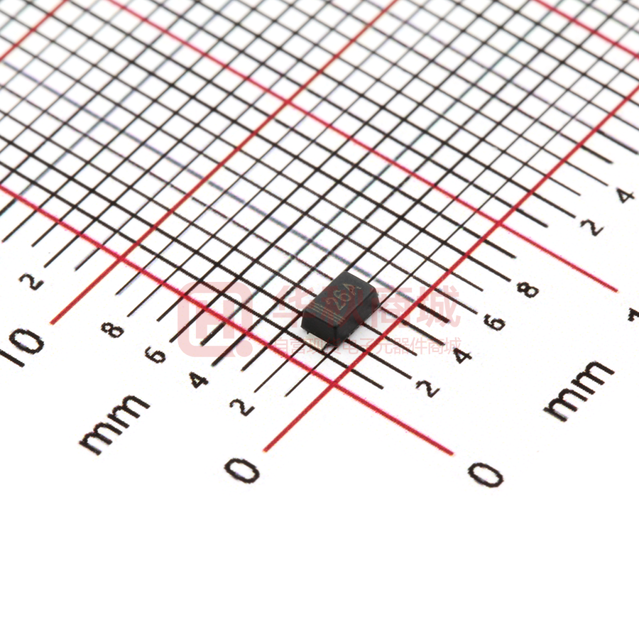

SMFJ Series Transient Voltage Suppressors ROHS Features Peak power dissipation 200W @10 x 1000 us Pulse Low profile package. Excellent clamping capability. Glass passivated junction. Fast response time: typically less than 1ns from 0 Volts to BV min Typical IR less than 1uA when VBR min above 15V. IEC 61000-4-2 ESD 30KV(Air), 30KV(Contact) SOD-123FL ESD protection of data lines in accordance with IEC 61000-4-2 EFT protection of data lines in accordance with IEC 61000-4-4 Halogen free and RoHS compliant Lead-free finish Mechanical Characteristics CASE: SOD-123FL Molded Plastic over glass passivated junction. Mounting Position: Any Polarity: by cathode band denotes uni-directional device, none cathode band denotes bi-directional device. Terminal: Solder plated Maximum Ratings and Characteristics @ 25°C Ambient Temperature (unless otherwise noted) Parameter Peak Pulse Power Dissipation on 10/1000 us Waveform Peak Pulse Current of on 10/1000us Waveform (Note 1, 2, FIG.1) (Note 1, FIG.3) Operating Junction Temperature Range Storage Temperature Range Notes: 1. Non-repetitive current pulse, per Fig.3 and derated above TA=25°C per Fig.2. 1/7 Symbol Value Units PPPM Min 200 W IPPM See Table 1 A TJ -55 to 150 °C TSTG -55 to 150 °C SMFJ Series Transient Voltage Suppressors ROHS Electrical Specification @ Tamb 25°C Type Number Marking Reverse Breakdown Voltage Stand-Off Min. @IT Voltage Breakdown Voltage Max. @ IT Test Current Maximum Clamping Voltage @IPP Peak Pulse Current Reverse Leakage @VRMW Uni Bi Uni Bi VRMW(V) VBR MIN(V) VBR MAX(V) IT (mA) VC(V) IPP(A) IR(uA) SMFJ5.0A SMFJ5.0 CA 5.0A 5.0CA 5.0 6.40 7.00 10 9.2 21.7 400.0 SMFJ6.0A SMFJ6.0CA 6.0A 6.0CA 6.0 6.67 7.37 10 10.3 19.4 400.0 SMFJ6.5A SMFJ6.5CA 6.5A 6.5CA 6.5 7.22 7.98 10 11.2 17.9 250.0 SMFJ7.0A SMFJ7.0CA 7.0A 7.0CA 7.0 7.78 8.60 10 12.0 16.7 100.0 SMFJ7.5A SMFJ7.5CA 7.5A 7.5CA 7.5 8.33 9.21 1 12.9 15.5 50.0 SMFJ8.0A SMFJ8.0CA 8.0A 8.0CA 8.0 8.89 9.83 1 13.6 14.7 25.0 SMFJ8.5A SMFJ8.5CA 8.5A 8.5CA 8.5 9.44 10.40 1 14.4 13.9 10.0 SMFJ9.0A SMFJ9.0CA 9.0A 9.0CA 9.0 10.00 11.10 1 15.4 13.0 5.0 SMFJ10A SMFJ10CA 10A 10CA 10.0 11.10 12.30 1 17.0 11.8 2.5 SMFJ11A SMFJ11CA 11A 11CA 11.0 12.20 13.50 1 18.2 11.0 2.5 SMFJ12A SMFJ12CA 12A 12CA 12.0 13.30 14.70 1 19.9 10.1 2.5 SMFJ13A SMFJ13CA 13A 13CA 13.0 14.40 15.90 1 21.5 9.3 1 SMFJ14A SMFJ14CA 14A 14CA 14.0 15.60 17.20 1 23.2 8.6 1 SMFJ15A SMFJ15CA 15A 15CA 15.0 16.70 18.50 1 24.4 8.2 1 SMFJ16A SMFJ16CA 16A 16CA 16.0 17.80 19.70 1 26.0 7.7 1 SMFJ17A SMFJ17CA 17A 17CA 17.0 18.90 20.90 1 27.6 7.2 1 SMFJ18A SMFJ18CA 18A 18CA 18.0 20.00 22.10 1 29.2 6.8 1 SMFJ20A SMFJ20CA 20A 20CA 20.0 22.20 24.50 1 32.4 6.2 1 SMFJ22A SMFJ22CA 22A 22CA 22.0 24.40 26.90 1 35.5 5.6 1 SMFJ24A SMFJ24CA 24A 24CA 24.0 26.70 29.50 1 38.9 5.1 1 SMFJ26A SMFJ26CA 26A 26CA 26.0 28.90 31.90 1 42.1 4.8 1 SMFJ28A SMFJ28CA 28A 28CA 28.0 31.10 34.40 1 45.4 4.4 1 SMFJ30A SMFJ30CA 30A 30CA 30.0 33.30 36.80 1 48.4 4.1 1 SMFJ33A SMFJ33CA 33A 33CA 33.0 36.70 40.60 1 53.3 3.8 1 SMFJ36A SMFJ36CA 36A 36CA 36.0 40.00 44.20 1 58.1 3.4 1 SMFJ40A SMFJ40CA 40A 40CA 40.0 44.40 49.10 1 64.5 3.1 1 SMFJ43A SMFJ43CA 43A 43CA 43.0 47.80 52.80 1 69.4 2.9 1 SMFJ45A SMFJ45CA 45A 45CA 45.0 50.00 55.30 1 72.7 2.8 1 SMFJ48A SMFJ48CA 48A 48CA 48.0 53.30 58,90 1 77.4 2.6 1 SMFJ51A SMFJ51CA 51A 51CA 51.0 56.70 62.70 1 82.4 2.4 1 SMFJ54A SMFJ54CA 54A 54CA 54.0 60.00 66.30 1 87.1 2.3 1 SMFJ58A SMFJ58CA 58A 58CA 58.0 64.40 71.20 1 93.6 2.1 1 SMFJ60A SMFJ60CA 60A 60CA 60.0 66.70 73.70 1 96.8 1.8 1 SMFJ64A SMFJ64CA 64A 64CA 64.0 71.10 78.60 1 103.0 1.7 1 SMFJ70A SMFJ70CA 70A 70CA 70.0 77.80 86.00 1 113.0 1.5 1 SMFJ75A SMFJ75CA 75A 75CA 75.0 83.30 92.10 1 121.0 1.4 1 ※ For Bi-directional type having VRWM of 10 Volts and less, the IR limit is double 2/7 SMFJ Series Transient Voltage Suppressors Type Number Uni Marking ROHS Reverse Breakdown Stand-Off Voltage Voltage Min. @IT Breakdown Voltage Max. @ IT Test Current Maximum Clamping Voltage @IPP Peak Pulse Current Reverse Leakage @VRMW Bi Uni Bi VRMW(V) VBR MIN(V) VBR MAX(V) IT (mA) VC(V) IPP(A) IR(uA) SMFJ78A SMFJ78CA 78A 78CA 78.0 86.70 95.80 1 126.0 1.4 1 SMFJ85A SMFJ85CA 85A 85CA 85.0 94.40 104.00 1 137.0 1.3 1 SMFJ90A SMFJ90CA 90A 90CA 90.0 100.00 111.00 1 146.0 1.2 1 SMFJ100A SMFJ100CA 100 100C 100.0 111.00 123.00 1 162.0 1.1 1 SMFJ110A SMFJ110CA 110 110C 110.0 122.00 135.00 1 177.0 1.0 1 SMFJ120A SMFJ120CA 120 120C 120.0 133.00 147.00 1 193.0 0.9 1 SMFJ130A SMFJ130CA 130 130C 130.0 144.00 159.00 1 209.0 0.8 1 SMFJ150A SMFJ150CA 150 150C 150.0 167.00 185.00 1 243.0 0.7 1 SMFJ160A SMFJ160CA 160 160C 160.0 178.00 197.00 1 259.0 0.7 1 SMFJ170A SMFJ170CA 170 170C 170.0 189.00 209.00 1 275.0 0.6 1 SMFJ180A SMFJ180CA 180 180C 180.0 198.00 222.00 1 292.0 0.6 1 SMFJ190A SMFJ190CA 190 190C 190.0 209.00 233.00 1 308.0 0.5 1 ※ For Bi-directional type having VRWM of 10 Volts and less, the IR limit is double I-V Curve Characteristics Bi-directional Uni-directional PPPM Peak Pulse Power Dissipation - Max power dissipation VRWM Reverse Stand-off Voltage - Maximum voltage that can be applied to TVS without operation VBR Breakdown Voltage – Maximum voltage that flows though the TVS at a specified current (IT) VC Clamping Voltage – Peak voltage measured across the TVS at a specified IPPM (peak impulse current) IR Reverse Leakage Current – Current measured at VR VF Forward Voltage Drop for Uni-directional 3/7 SMFJ Series Transient Voltage Suppressors ROHS Ratings and Characteristic Curves (TA=25°C unless otherwise noted) Fig.1 Peak Pulse Power Rating Fig.2 Pulse Derating Cure Fig.3 Pulse Waveform Fig.4 Typical Junction Capacitance 4/7 SMFJ Series Transient Voltage Suppressors ROHS Recommended Soldering Conditons Reflow Soldering Recommended Conditions Profile Feature Pb-Free Assembly Average ramp-up rate (TL to TP) 3℃/second max. Preheat -Temperature Min (TS min) -Temperature Max (TS max) -Time (min to max) (tS) 150℃ 200℃ 60-180 seconds TS max to TL -Ramp-up Rate 3℃/second max. Time maintained above: -Temperature (TL) -Time (tL) 217℃ 60-150 seconds Peak Temperature (TP) 260℃ Time within 5℃ of actual Peak Temperature (tP) Ramp-down Rate Time 25℃ to Peak Temperature 5/7 20-40 seconds 6℃/second max. 8 minutes max. SMFJ Series Transient Voltage Suppressors ROHS Marking Code 5.0A 5.0CA Package Outline Dimensions and Pad Layouts (SOD123FL) Dimension Symbol miIIimeters Inches Min Max Min. Min Max. Max A 3.50 3.90 0.138 0.154 B 2.60 3.00 0.102 0.118 C 0.75 1.10 0.030 0.043 D 1.60 2.00 0.063 0.079 E 0.80Typ. 0.031Typ. F 0.90 1.40 0.035 0.055 G 0.12 0.22 0.005 0.009 Ordering Information SMFJ XXX C A 5% VBR Voltage Tolerance Bidirectional VRWM Voltage Series Code 6/7 SMFJ Series Transient Voltage Suppressors ROHS Packaging F B Reel W E Tape SymboI Dimension(mm) W 8.00±0.30 P0 4.00±0.10 P1 4.00±0.10 P2 2.00±0.10 D0 Φ1.50±0.10 D1 Φ1.00±0.05 E 1.75±0.10 F 3.50±0.10 A 2.00±0.10 B 3.95±0.10 K 1.40±0.12 t 0.23±0.10 D Φ178.0±2.0 D2 Φ13.0 W1 9.5 Quantity: 3000PCS 7/7
