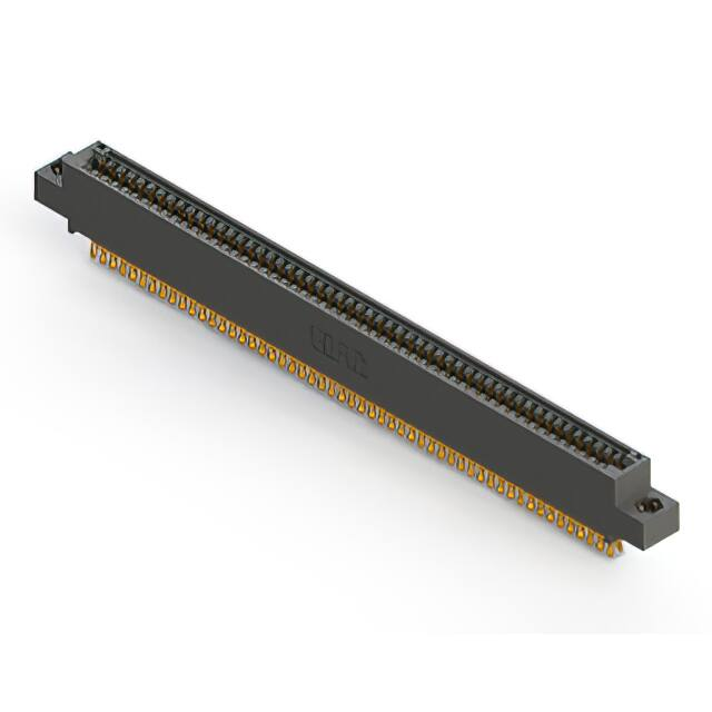

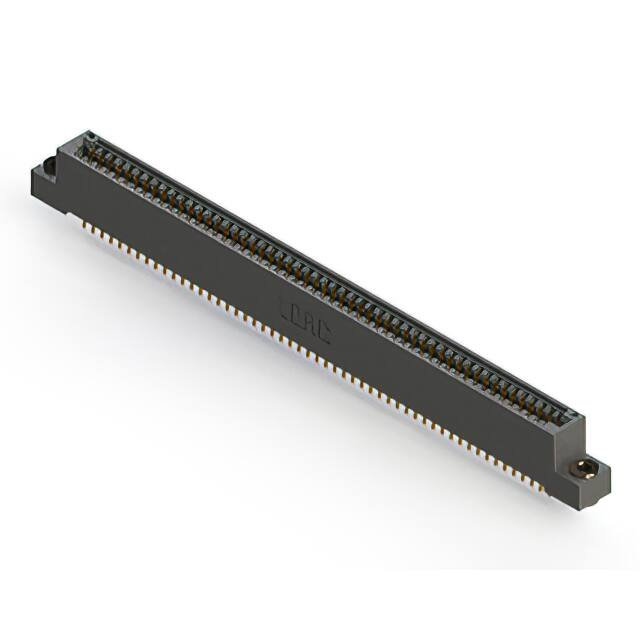

845/895 SERIES High Temp Card Edge Connectors 0.100” (2.54mm) Pitch Features: • • • • • • • • • • 0.100” (2.54mm) contact spacing x 0.200” (5.08mm) row spacing Accepts 0.062” (1.57mm) nominal thickness P.C. board High profile insulator body, 0.600” (15.24mm) Contact termination options include P.C. tail, wire wrap, wire hole, 90 degree bends and extender board bends Single or dual row configurations Large variety of mounting options, flush or offset lugs Accepts between contact and in-contact polarizing keys Pre-assembled card guides are available Automatic wire wrap positioning holes RoHS Compliant & UL Certified Specifications: Insulator Material (845: Diallyl Phthalate) (895: Polyphenylene sulfide) , UL 94V-0 Contact Material Copper Alloy Contact Plating Gold Plating on mating area and Tin Plating on tails with Nickel underplating all over Current Rating 3 amps Contact Resistance 10 milliohms maximum Dielectric Withstanding Voltage 1200 V AC rms at sea level between adjacent contacts Insulation Resistance 5000 megaohms minimum Operating Temperature -40°C to +125°C Insertion Force 16 oz (4.45 N) maximum per contact pair when tested with .070” (1.78mm) thick gauge Withdrawal Force 1 oz (0.28 N) minimum per contact pair when tested with .054” (1.37mm) thick gauge Example Part Number: 845-050-520-202 Series Total Number of Contacts Contact Code Contact Rows and Insulator Style Mounting Options Series: Insulator Color: Contact Code: Tail Description: Tail Size: Tail Length "G": 845 Green 500 Wire Hole .050 x .025 (1.27 x 0.64) .260 (6.60) 895 Black 520 P.C. Tail .030 x .018 (0.76 x 0.46) .175 (4.45) Total Number of Contacts: Contact Rows: 521 P.C. Tail .025 Square (0.64 Square) .150 (3.81) 005, 006, . . . . 072 Single Row 523 P.C. Tail .025 Square (0.64 Square) .390 (9.91) 010, 012, . . . . 144 Dual Row 524 P.C. Tail .018 Square (0.46 Square) .175 (4.45) Contact Rows: Description: Insulator Style: 525 P.C. Tail .018 Square (0.46 Square) .150 (3.81) 1 Single Row Flush Mounting Lugs 540 Wire Wrap .025 Square (0.64 Square) .560 (14.22) 2 Dual Row Flush Mounting Lugs 541 Wire Wrap .025 Square (0.64 Square) .750 (19.05) 4 Single Row .110 (2.79) Offset Lugs 542 Wire Wrap .025 Square (0.64 Square) .645 (16.38) 5 Dual Row .110 (2.79) Offset Lugs 544 Wire Wrap .050 x .025 (1.27 x 0.64) .750 (19.05) 6 Single Row .170 (4.32) Offset Lugs 555 EXTENDER BOARD BEND (CODE 500 CONTACTS) 8 Dual Row .170 (4.32) Offset Lugs 556 EXTENDER BOARD BEND (CODE 520 CONTACTS) Mounting Options: Description: 558 90 DEGREE BEND (CODE 541 CONTACTS) 01 No Mounting Lug 559 90 DEGREE BEND (CODE 541 CONTACTS) 02 Ø.128” (Ø3.25mm) Mounting Holes 560 EXTENDER BOARD BEND (CODE 523 CONTACTS) 03 Ø.116” (Ø2.95mm) I.D. Floating Eyelets 04 Ø.156” (Ø3.96mm) Mounting Holes 07 M3-0.5 Metric Threaded Inserts 08 #4-40 Unified Threaded Inserts 12 Ø.128” (Ø3.25mm) Side Mounting Holes www.edac.net Ordering Code Notes: 1) All connector sizes up to 72 contacts single row / 144 contacts dual row are available upon request. 2) For details of the extender board and 90 degree bends refer to next pages. 3) For lug-less connectors, code 01 mounting, specify contact row code 1 or 2. 4) For details of the mounting options refer to page 3 & page 4. customerservice@edac.net 845/895 SERIES High Temp Card Edge Connectors 0.100” (2.54mm) Pitch SECTIONS THROUGH CONTACT POSITION DUAL ROW SINGLE ROW 0.025±0.005 (NOSE GAP) "A" AUTOMATIC WIRE WRAP POSITIONING HOLE AND SLOT "B" .330 (8.38) CARD SLOT "C" .600 (15.24) .160 (4.06) POINT OF CONTACT .370 (9.40) EVEN NUMBERED SIDE OF CONNECTOR (2,4,6,8...) 0.200(5.08) CARD SLOT ACCEPTS .054 (1.37) TO .070 (1.78) THICK P.C. BOARD .128 (3.25) DIA THROUGH HOLES B "D" .250 (6.35) .250 (6.35) .170 (4.32) OR .110 (2.79) OFFSET LUGS G 0.125(3.18) B FLUSH MTG. LUG FOR RIGHT ANGLE MOUNTING WITH FLUSH OR OFFSET LUGS .100 (2.54) .030 (0.76) X .080 (2.03) WIRE HOLE .125 (3.18) "E" SEE SHEET 3 "F" FOR CONTACT CODES, DESCRIPTION AND TAIL SIZES, SEE SHEET 1 FOR 90°, EXTENDER BOARD BENDS CONTACTS, SEE SHEET 3 .200 (5.08) .136 (3.45) DIA REF .400 (10.16) .042 (1.07) .080 (2.03) CUT OUT FOR IN-CONTACT POLARIZING KEY. CUT OUT FOR BETWEEN CONTACT POLARIZING KEY. +.000 D MINUS .012 (0.30) -.015 (0.38) RECOMMENDED DAUGHTER BOARD NUMBER NUMBEROF OFCONTACTS COTACTS "A" .200 PANEL MOUNT (5.08) CUT OUT .350 (8.89) .100 (2.54) .140 (3.56) PANEL MOUNT E .042 (1.07) +.004 (0.10)/-.000 FOR ALL P.C. TAILS EXCEPT CODE 524 .031 (0.79) +.004 (0.10)/-.000 FOR CODE 524 P.C. TAIL .008 (0.20) DIA CONNECTOR MOUNTING PATTERN "B" B "C" "D" "E" Single Double Inch mm Inch mm Inch mm Inch mm Inch mm 5 10 1.335 1.300 33.91 33.02 1.075 1.022 27.31 25.96 0.760 0.746 19.30 18.95 0.600 15.24 0.400 10.16 10 20 1.835 1.800 46.61 45.72 1.575 1.522 40.01 38.66 1.260 1.246 32.00 31.65 1.100 27.94 0.900 22.86 13 15 26 30 2.135 2.100 54.23 53.34 1.875 1.822 47.63 46.28 1.560 1.546 39.62 39.27 1.400 35.56 1.200 30.48 15 13 30 26 2.335 2.300 59.31 58.42 2.075 2.022 52.71 51.36 1.760 1.746 44.70 44.35 1.600 40.64 1.400 35.56 18 36 2.635 2.600 66.93 66.04 2.375 2.322 60.33 58.98 2.060 2.046 52.32 51.97 1.900 48.26 1.700 43.18 22 44 3.035 3.000 77.09 76.20 2.775 2.722 70.49 69.14 2.460 2.446 62.48 62.13 2.300 58.42 2.100 53.34 31 25 62 50 3.335 3.300 84.71 83.82 3.075 3.022 78.11 76.76 2.760 2.746 70.10 69.75 2.600 66.04 2.400 60.96 30 60 3.835 3.800 97.41 96.52 3.575 3.522 90.81 89.46 3.260 3.246 82.80 82.45 3.100 78.74 2.900 73.66 35 31 70 62 3.935 3.900 99.95 99.06 3.675 3.622 93.35 92.00 3.360 3.346 85.34 84.99 3.200 81.28 3.000 76.20 36 35 72 70 4.435 4.300 112.65 109.22 4.175 4.022 106.05 102.16 3.860 3.746 98.04 95.15 3.700 3.600 93.98 91.44 3.500 3.400 88.90 86.36 43 36 86 72 5.135 4.400 130.43 111.76 4.875 4.122 123.83 104.70 4.560 3.846 115.82 97.69 4.400 3.700 111.76 93.98 4.200 3.500 106.68 88.90 50 43 100 86 5.835 5.100 148.21 129.54 5.575 4.822 141.61 122.48 5.260 4.546 133.60 115.47 5.100 4.400 129.54 111.76 4.900 4.200 124.46 106.68 60 50 120 100 6.835 5.800 173.61 147.32 6.575 5.522 167.01 140.26 6.260 5.246 159.00 133.25 6.100 5.100 154.94 129.54 5.900 4.900 149.86 124.46 72 58 144 116 8.035 6.600 204.09 167.64 7.775 6.322 197.49 160.58 7.460 6.046 189.48 153.57 7.300 5.900 185.42 149.86 7.100 5.700 180.34 144.78 www.edac.net customerservice@edac.net 845/895 SERIES High Temp Card Edge Connectors 0.100” (2.54mm) Pitch .250 (6.35) DIA A DIA THROUGH HOLES .010 (0.25) RADIAL FLOAT 0.328(8.33) CONNECTOR DIMENSION CONNECTOR C DIMENSION MOUNTING OPTION CODE x01 (NO MOUNTING LUGS) CONNECTOR B DIMENSION MOUNTING OPTION CODES x02 AND xO4 (THROUGH MOUNTING HOLES) CODE x07 M3-0.5 METRIC CODE x08 #4-40 UNC THREADED INSERTS .128 (3.25) DIA THROUGH HOLES B .005 (0.51) VERTICAL FLOAT .116 (2.95) I.D. FLOATING EYELETS MOUNTING OPTION CODE x03 (FLOATING EYLETS) CODE X02 AND X04- THROUGH MTG. HOLES "A" DIA. CODE X02 CODE X04 0.128(3.25) 0.156(3.96) CODE X07 AND X08- THREADED INSERTS 0.125(3.18) CONNECTOR DIMENSION B MOUNTING OPTION CODE x12 (SIDE MOUNTING HOLES) WITH INSERTS: CODES X17 & X18, SEE TABLE www.edac.net CODE X07 CONNECTOR B DIMENSION MOUNTING OPTION CODES x07 & xO8 (THREADED INSERTS) INSERT M3-0.5(METRIC) CODE X08 #4-40 UNC SIDE MOUNTING HOLES WITH INSERTS CODE X17 INSERT M3-0.5(METRIC) CODE X18 #4-40 UNC customerservice@edac.net 845/895 SERIES High Temp Card Edge Connectors 0.100” (2.54mm) Pitch NUMBERED SIDE, EVEN NUMBERED SIDE OR ROW "A" SIDE OF CONNECTOR (DEPENDING ON THE SERIES) NUMBERED SIDE, EVEN NUMBERED SIDE OR ROW "A" SIDE OF CONNECTOR (DEPENDING ON THE SERIES) .060 (1.52) .060 (1.52) .200 (5.08) A .150 (3.81) A THIS CONTACT ROW IS STANDARD FOR SINGLE ROW BEND B B CONTACT CODE 559 CONTACT CODE 558 .120 (3.05) THIS CONTACT ROW IS STANDARD FOR SINGLE ROW BEND .165 (4.19) .095 (2.41) A A .045 (1.14) TO .060 (1.52) BETWEEN TAILS .045 (1.14) TO .060 (1.52) BETWEEN TAILS .125 (3.18) TO .185 (4.70) OUTSIDE TAILS .125 (3.18) TO .210 (5.33) OUTSIDE TAILS CONTACT CODE 555 BEND USES WIRE HOLE CONTACTS CONTACT CODE 556 IN-CONTACT POLARIZING KEY MTG. OPTION A 555 0.245(6.22) 556 0.170(4.32) 558 0.235(5.97) 0.635(16.13) 559 0.285(7.24) 0.635(16.13) 560 0.375(9.53) www.edac.net B P/N 345-240-328 .045 (1.14) TO .060 (1.52) BETWEEN TAILS .125 (3.18) TO .210 (5.33) OUTSIDE TAILS CONTACT CODE 560 BETWEEN CONTACT POLARIZING KEY P/N 345-240-318 customerservice@edac.net

参数特性: - 绝缘体材料:845系列为邻苯二甲酸二丁酯,895系列为聚苯硫醚,UL 94V-0 - 接触材料:铜合金 - 接触镀层:接触区域金镀层,尾部锡镀层,整体镍底层 - 电流额定值:3安培 - 接触电阻:最大10毫欧姆 - 介电耐压:在相邻接触之间1200V交流有效值 - 绝缘电阻:最小5000兆欧姆 - 工作温度:-40°C至+125°C - 插入力:每个接触对最大16盎司(4.45牛顿) - 拔出力:每个接触对最小1盎司(0.28牛顿)
功能详解:连接器具有多种安装选项,包括齐平或偏移的支架,并接受接触和接触之间的极化键。
应用信息:RoHS合规且UL认证。
封装信息:提供了预装的卡导轨和自动线绕定位孔。
