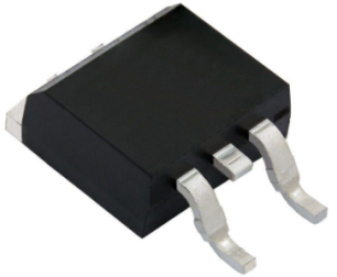

    MOS管 N-Channel VDS=650V VGS=±30V ID=12A RDS(ON)=650mΩ@10V TO263
VBL165R12 数据手册
VBM165R12 / VBMB165R12/ VBL165R12 www.VBsemi.com N-Channel 650V (D-S) Power MOSFET FEATURES PRODUCT SUMMARY 670 VDS (V) at TJ max. RDS(on) max. at 25 °C (Ω) VGS = 10 V • • • • • 0.67 41 5 Qg max. (nC) Qgs (nC) 22 Single Qgd (nC) Configuration Low figure-of-merit (FOM) Ron x Qg Low input capacitance (Ciss) Reduced switching and conduction losses Ultra low gate charge (Qg) Avalanche energy rated (UIS) APPLICATIONS Server and telecom power supplies Switch mode power supplies (SMPS) Power factor correction power supplies (PFC) Lighting - High-intensity discharge (HID) - Fluorescent ballast lighting • Industrial • • • • TO-220AB TO-220 FULLPAK D D2PAK (TO-263) G G D S G D S G D S S Top View N-Channel MOSFET Top View ABSOLUTE MAXIMUM RATINGS (TC = 25 °C, unless otherwise noted) PARAMETER SYMBOL LIMIT Drain-Source Voltage VDS 650 Gate-Source Voltage VGS ± 30 12 Continuous Drain Current (TJ = 150 °C) VGS at 10 V TC = 25 °C ID UNIT V 9.4 45 A IDM EAS 3.5 9 W/°C Single Pulse Avalanche Energy b Maximum Power Dissipation PD 156/34 W TJ, Tstg -55 to +150 15 °C TC = 100 °C Pulsed Drain Current a Linear Derating Factor Operating Junction and Storage Temperature Range Drain-Source Voltage Slope TJ = 125 °C Reverse Diode dV/dt d Soldering Recommendations (Peak Temperature) c for 10 s Notes a. Repetitive rating; pulse width limited by maximum junction temperature. b. VDD = 50 V, starting TJ = 25 °C, L = 28.2 mH, Rg = 25 Ω, IAS = 4.5 A. c. 1.6 mm from case. d. ISD ≤ ID, dI/dt = 100 A/μs, starting TJ = 25 °C. 1 Downloaded From Oneyac.com dV/dt mJ 4.1 V/ns 300 °C VBM165R12 / VBMB165R12/ VBL165R12 www.VBsemi.com THERMAL RESISTANCE RATINGS SYMBOL TYP. MAX. Maximum Junction-to-Ambient PARAMETER RthJA - 60 Maximum Junction-to-Case (Drain) RthJC - 0.8 UNIT °C/W SPECIFICATIONS (TJ = 25 °C, unless otherwise noted) PARAMETER SYMBOL TEST CONDITIONS MIN. TYP. MAX. UNIT Static Drain-Source Breakdown Voltage VDS Temperature Coefficient Gate-Source Threshold Voltage (N) VDS VGS = 0 V, ID = 250 μA 650 - - V ΔVDS/TJ Reference to 25 °C, ID = 1 mA - 0.75 - V/°C VGS(th) VDS = VGS, ID = 250 μA 3 - 5 V VGS = ± 20 V - - ± 100 nA VGS = ± 30 V - - ±1 μA VDS = 650 V, VGS = 0 V - - 1 VDS = 520 V, VGS = 0 V, TJ = 125 °C - - 10 - 0.65 - Ω - S Gate-Source Leakage IGSS Zero Gate Voltage Drain Current IDSS Drain-Source On-State Resistance RDS(on) VGS = 10 V ID = 8 A gfs VDS = 30 V, ID = 8 A - 16 Input Capacitance Ciss 800 - Coss - 70 - Reverse Transfer Capacitance Crss VGS = 0 V, VDS = 100 V, f = 1 MHz - Output Capacitance - 8 - Effective Output Capacitance, Energy Related a Co(er) - 63 - Effective Output Capacitance, Time Related b Co(tr) - 213 - Forward Transconductance μA Dynamic pF VDS = 0 V to 520 V, VGS = 0 V - 48 - - 11 - - 21 - - 13 25 - 11 35 81 90 - 25 40 - 3.5 - - 15 Total Gate Charge Qg Gate-Source Charge Qgs Gate-Drain Charge Qgd Turn-On Delay Time td(on) tr VDD = 520 V, ID = 8 A, VGS = 10 V, Rg = 9.1 Ω - f = 1 MHz, open drain - Rise Time Turn-Off Delay Time td(off) Fall Time tf Gate Input Resistance Rg VGS = 10 V ID = 8 A, VDS = 520 V nC ns Ω Drain-Source Body Diode Characteristics Continuous Source-Drain Diode Current MOSFET symbol showing the integral reverse p - n junction diode IS Pulsed Diode Forward Current ISM Diode Forward Voltage VSD Reverse Recovery Time trr Reverse Recovery Charge Qrr Reverse Recovery Current IRRM D A G TJ = 25 °C, IS = 8 A, VGS = 0 V TJ = 25 °C, IF = IS = 8 A, dI/dt = 100 A/μs, VR = 400 V S - - 40 - - 1.5 V - 345 - ns - 4.5 - μC - 35 - A Notes a. Coss(er) is a fixed capacitance that gives the same energy as Coss while VDS is rising from 0 % to 80 % VDSS. b. Coss(tr) is a fixed capacitance that gives the same charging time as Coss while VDS is rising from 0 % to 80 % VDSS. 2 Downloaded From Oneyac.com VBM165R12 / VBMB165R12/ VBL165R12 www.VBsemi.com TYPICAL CHARACTERISTICS (25 °C, unless otherwise noted) 3 TOP 15 V 14 V 13 V 12 V 11 V 10 V 9V 8V 7V 6V BOTTOM 5 V 40 30 ID = 8 A TJ = 25 °C RDS(on), Drain-to-Source On Resistance (Normalized) ID, Drain-to-Source Current (A) 50 20 10 2.5 2 1.5 1 VGS = 10 V 0.5 0 - 60 - 40 - 20 0 0 5 0 15 20 20 40 60 80 100 120 140 160 TJ, Junction Temperature (°C) Fig. 1 - Typical Output Characteristics Fig. 4 - Normalized On-Resistance vs. Temperature 10 000 15 V 14 V 13 V 12 V 11 V 10 V 9V 8V 7V BOTTOM 6 V 20 30 VDS, Drain-to-Source Voltage (V) TOP 25 25 TJ = 150 °C Ciss Capacitance (pF) ID, Drain-to-Source Current (A) 30 10 15 10 1000 VGS = 0 V, f = 1 MHz Ciss = Cgs + Cgd, Cds Shorted Crss = Cgd Coss = Cds + Cgd Coss 100 ġ Crss 10 ġ 5 5V 1 0 0 5 10 15 20 25 30 0 VDS, Drain-to-Source Voltage (V) 200 400 300 500 600 VDS, Drain-to-Source Voltage (V) Fig. 5 - Typical Capacitance vs. Drain-to-Source Voltage Fig. 2 - Typical Output Characteristics 50 24 VGS, Gate-to-Source Voltage (V) ID, Drain-to-Source Current (A) 100 40 30 20 TJ = 25 °C 10 TJ = 150 °C VDS = 30.8 V VDS = 520 V VDS = 325 V VDS = 130 V 20 16 12 8 4 0 0 0 5 10 15 20 25 0 20 40 60 80 100 VGS, Gate-to-Source Voltage (V) Qg, Total Gate Charge (nC) Fig. 3 - Typical Transfer Characteristics Fig. 6 - Typical Gate Charge vs. Gate-to-Source Voltage 3 Downloaded From Oneyac.com VBM165R12 / VBMB165R12/ VBL165R12 www.VBsemi.com 20 ISD, Reverse Drain Current (A) 100 ID, Drain Current (A) TJ = 150 °C TJ = 25 °C 10 1 15 10 5 VGS = 0 V 0 0.1 0.2 0.4 0.6 0.8 1 1.2 1.4 25 1.6 VSD, Source-Drain Voltage (V) 75 100 125 150 TJ, Case Temperature (°C) Fig. 7 - Typical Source-Drain Diode Forward Voltage Fig. 9 - Maximum Drain Current vs. Case Temperature 800 1000 Operation in this Area Limited by RDS(on) 775 IDM = Limited 10 100 μs Limited by RDS(on)* 1 1 ms 0.1 TC = 25 °C TJ = 150 °C Single Pulse BVDSS Limited 10 ms VDS, Drain-to-Source Breakdown Voltage (V) 100 750 725 700 675 650 625 0.01 600 - 60 - 40 - 20 0 1 10 100 1000 VDS - Drain -to-Source Voltage (V) * VGS > minimum V GS at which R DS(on) is specified 20 40 60 80 100 120 140 160 TJ, Junction Temperature (°C) Fig. 8 - Maximum Safe Operating Area Normalized Effective Transient Thermal Impedance ID, Drain Current (A) 50 Fig. 10 - Temperature vs. Drain-to-Source Voltage 1 Duty Cycle = 0.5 0.2 0.1 0.1 0.05 0.02 Single Pulse 0.01 0.0001 0.001 0.01 0.1 1 Pulse Time (s) Fig. 11 - Normalized Thermal Transient Impedance, Junction-to-Case 4 Downloaded From Oneyac.com VBM165R12 / VBMB165R12/ VBL165R12 www.VBsemi.com RD VDS QG 10 V VGS D.U.T. RG QGS + - VDD QGD VG 10 V Pulse width ≤ 1 µs Duty factor ≤ 0.1 % Charge Fig. 12 - Switching Time Test Circuit Fig. 16 - Basic Gate Charge Waveform Current regulator Same type as D.U.T. VDS 90 % 50 kΩ 12 V 0.2 µF 0.3 µF + 10 % VGS D.U.T. td(on) td(off) tf tr - VDS VGS 3 mA Fig. 13 - Switching Time Waveforms IG ID Current sampling resistors L Vary tp to obtain required IAS Fig. 17 - Gate Charge Test Circuit VDS D.U.T RG + - IAS V DD 10 V 0.01 Ω tp Fig. 14 - Unclamped Inductive Test Circuit VDS tp VDD VDS IAS Fig. 15 - Unclamped Inductive Waveforms 5 Downloaded From Oneyac.com VBM165R12 / VBMB165R12/ VBL165R12 www.VBsemi.com Peak Diode Recovery dV/dt Test Circuit + D.U.T. Circuit layout considerations • Low stray inductance • Ground plane • Low leakage inductance current transformer + - - Rg • • • • + dV/dt controlled by Rg Driver same type as D.U.T. ISD controlled by duty factor “D” D.U.T. - device under test + - VDD Driver gate drive Period P.W. D= P.W. Period VGS = 10 Va D.U.T. lSD waveform Reverse recovery current Body diode forward current dI/dt D.U.T. VDS waveform Diode recovery dV/dt Re-applied voltage Inductor current VDD Body diode forward drop Ripple ≤ 5 % ISD Note a. VGS = 5 V for logic level devices Fig. 18 - For N-Channel 6 Downloaded From Oneyac.com VBM165R12 / VBMB165R12/ VBL165R12 www.VBsemi.com TO-220AB MILLIMETERS A E F D H(1) Q ØP 3 2 L(1) 1 M* L b(1) INCHES DIM. MIN. MAX. MIN. A 4.25 4.65 0.167 MAX. 0.183 b 0.69 1.01 0.027 0.040 b(1) 1.20 1.73 0.047 0.068 c 0.36 0.61 0.014 0.024 D 14.85 15.49 0.585 0.610 E 10.04 10.51 0.395 0.414 e 2.41 2.67 0.095 0.105 e(1) 4.88 5.28 0.192 0.208 F 1.14 1.40 0.045 0.055 H(1) 6.09 6.48 0.240 0.255 J(1) 2.41 2.92 0.095 0.115 L 13.35 14.02 0.526 0.552 L(1) 3.32 3.82 0.131 0.150 ØP 3.54 3.94 0.139 0.155 Q 2.60 3.00 0.102 0.118 ECN: X12-0208-Rev. N, 08-Oct-12 DWG: 5471 Notes * M = 1.32 mm to 1.62 mm (dimension including protrusion) Heatsink hole for HVM C b e J(1) e(1) 1 Downloaded From Oneyac.com VBM165R12 / VBMB165R12/ VBL165R12 www.VBsemi.com TO-220 FULLPAK (HIGH VOLTAGE) A E A1 ØP n d1 d3 D u L1 V L b3 A2 b2 c b e INCHES MILLIMETERS DIM. A A1 A2 b b2 b3 c D d1 d3 E e L L1 n ØP u v ECN: X09-0126-Rev. B, 26-Oct-09 DWG: 5972 MIN. 4.570 2.570 2.510 0.622 1.229 1.229 0.440 8.650 15.88 12.300 10.360 MAX. 4.830 2.830 2.850 0.890 1.400 1.400 0.629 9.800 16.120 12.920 10.630 MIN. 0.180 0.101 0.099 0.024 0.048 0.048 0.017 0.341 0.622 0.484 0.408 13.730 3.500 6.150 3.450 2.500 0.500 0.520 0.122 0.238 0.120 0.094 0.016 2.54 BSC 13.200 3.100 6.050 3.050 2.400 0.400 MAX. 0.190 0.111 0.112 0.035 0.055 0.055 0.025 0.386 0.635 0.509 0.419 0.100 BSC 0.541 0.138 0.242 0.136 0.098 0.020 Notes 1. To be used only for process drawing. 2. These dimensions apply to all TO-220, FULLPAK leadframe versions 3 leads. 3. All critical dimensions should C meet Cpk > 1.33. 4. All dimensions include burrs and plating thickness. 5. No chipping or package damage. 2 Downloaded From Oneyac.com VBM165R12 / VBMB165R12/ VBL165R12 www.VBsemi.com TO-263AB (HIGH VOLTAGE) A (Datum A) 3 A 4 4 L1 B A E c2 H Gauge plane 4 0° to 8° 5 D B Detail A Seating plane H 1 2 C 3 C L L3 L2 B A1 L4 Detail “A” Rotated 90° CW scale 8:1 B A 2 x b2 c 2xb E 0.010 M A M B ± 0.004 M B 2xe Plating 5 b1, b3 Base metal c1 (c) D1 4 5 (b, b2) Lead tip MILLIMETERS DIM. MIN. 4 E1 Section B - B and C - C Scale: none View A - A MILLIMETERS INCHES MAX. MIN. MAX. DIM. MIN. INCHES MAX. MIN. MAX. A 4.06 4.83 0.160 0.190 D1 6.86 - 0.270 - A1 0.00 0.25 0.000 0.010 E 9.65 10.67 0.380 0.420 6.22 - 0.245 - b 0.51 0.99 0.020 0.039 E1 b1 0.51 0.89 0.020 0.035 e b2 1.14 1.78 0.045 0.070 H 14.61 15.88 0.575 0.625 b3 1.14 1.73 0.045 0.068 L 1.78 2.79 0.070 0.110 2.54 BSC 0.100 BSC c 0.38 0.74 0.015 0.029 L1 - 1.65 - 0.066 c1 0.38 0.58 0.015 0.023 L2 - 1.78 - 0.070 c2 1.14 1.65 0.045 0.065 L3 D 8.38 9.65 0.330 0.380 L4 0.25 BSC 4.78 5.28 0.010 BSC 0.188 0.208 ECN: S-82110-Rev. A, 15-Sep-08 DWG: 5970 Notes 1. Dimensioning and tolerancing per ASME Y14.5M-1994. 2. Dimensions are shown in millimeters (inches). 3. Dimension D and E do not include mold flash. Mold flash shall not exceed 0.127 mm (0.005") per side. These dimensions are measured at the outmost extremes of the plastic body at datum A. 4. Thermal PAD contour optional within dimension E, L1, D1 and E1. 5. Dimension b1 and c1 apply to base metal only. 6. Datum A and B to be determined at datum plane H. 7. Outline conforms to JEDEC outline to TO-263AB. 9 Downloaded From Oneyac.com VBM165R12 / VBMB165R12/ VBL165R12 www.VBsemi.com Disclaimer All products due to improve reliability, function or design or for other reasons, product specifications and data are subject to change without notice. Taiwan VBsemi Electronics Co., Ltd., branches, agents, employees, and all persons acting on its or their representatives (collectively, the "Taiwan VBsemi"), assumes no responsibility for any errors, inaccuracies or incomplete data contained in the table or any other any disclosure of any information related to the product.(www.VBsemi.com) Taiwan VBsemi makes no guarantee, representation or warranty on the product for any particular purpose of any goods or continuous production. To the maximum extent permitted by applicable law on Taiwan VBsemi relinquished: (1) any application and all liability arising out of or use of any products; (2) any and all liability, including but not limited to special, consequential damages or incidental ; (3) any and all implied warranties, including a particular purpose, non-infringement and merchantability guarantee. Statement on certain types of applications are based on knowledge of the product is often used in a typical application of the general product VBsemi Taiwan demand that the Taiwan VBsemi of. Statement on whether the product is suitable for a particular application is non-binding. It is the customer's responsibility to verify specific product features in the products described in the specification is appropriate for use in a particular application. Parameter data sheets and technical specifications can be provided may vary depending on the application and performance over time. All operating parameters, including typical parameters must be made by customer's technical experts validated for each customer application. Product specifications do not expand or modify Taiwan VBsemi purchasing terms and conditions, including but not limited to warranty herein. Unless expressly stated in writing, Taiwan VBsemi products are not intended for use in medical, life saving, or life sustaining applications or any other application. Wherein VBsemi product failure could lead to personal injury or death, use or sale of products used in Taiwan VBsemi such applications using client did not express their own risk. Contact your authorized Taiwan VBsemi people who are related to product design applications and other terms and conditions in writing. The information provided in this document and the company's products without a license, express or implied, by estoppel or otherwise, to any intellectual property rights granted to the VBsemi act or document. Product names and trademarks referred to herein are trademarks of their respective representatives will be all. Material Category Policy Taiwan VBsemi Electronics Co., Ltd., hereby certify that all of the products are determined to be RoHS compliant and meets the definition of restrictions under Directive of the European Parliament 2011/65 / EU, 2011 Nian. 6. 8 Ri Yue restrict the use of certain hazardous substances in electrical and electronic equipment (EEE) - modification, unless otherwise specified as inconsistent.(www.VBsemi.com) Please note that some documents may still refer to Taiwan VBsemi RoHS Directive 2002/95 / EC. We confirm that all products identified as consistent with the Directive 2002/95 / EC European Directive 2011/65 /. Taiwan VBsemi Electronics Co., Ltd. hereby certify that all of its products comply identified as halogen-free halogen-free standards required by the JEDEC JS709A. Please note that some Taiwanese VBsemi documents still refer to the definition of IEC 61249-2-21, and we are sure that all products conform to confirm compliance with IEC 61249-2-21 standard level JS709A. Downloaded From Oneyac.com 单击下面可查看定价,库存,交付和生命周期等信息 >>VBsemi(台湾微碧) Downloaded From Oneyac.com
