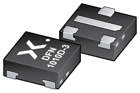

    通用三极管 45V 100mA NPN DFN1010D-3 200~450
BC847BQAZ 数据手册
BC847XQA series 45 V, 100 mA NPN general-purpose transistors Rev. 1 — 26 August 2015 Product data sheet 1. Product profile 1.1 General description NPN general-purpose transistors in a leadless ultra small DFN1010D-3 (SOT1215) Surface-Mounted Device (SMD) plastic package with visible and solderable side pads. Table 1. Product overview Type number BC847AQA BC847BQA Package PNP complement Nexperia JEITA JEDEC DFN1010D-3 (SOT1215) - - BC857AQA BC857BQA BC847CQA BC857CQA 1.2 Features and benefits      General-purpose transistors Three current gain selections Low package height of 0.37 mm Suitable for Automatic Optical Inspection (AOI) of solder joint AEC-Q101 qualified 1.3 Applications  General-purpose switching and amplification  Mobile applications 1.4 Quick reference data Table 2. Quick reference data Tamb = 25 C unless otherwise specified. Symbol Parameter Conditions Min Typ Max Unit VCEO collector-emitter voltage open base - - 45 V IC collector current - - 100 mA hFE DC current gain BC847AQA 110 - 220 BC847BQA 200 - 450 BC847CQA 420 - 800 VCE = 5 V; IC = 2 mA BC847XQA series Nexperia 45 V, 100 mA NPN general-purpose transistors 2. Pinning information Table 3. Pinning Pin Symbol Description 1 B base 2 E emitter 3 C collector 4 C collector Simplified outline Graphic symbol C 1 B 4 3 E sym123 2 Transparent top view 3. Ordering information Table 4. Ordering information Type number BC847AQA BC847BQA BC847CQA BC847XQA_SER Product data sheet Package Name Description Version DFN1010D-3 plastic thermal enhanced ultra thin small outline package; no leads; 3 terminals; body: 1.1  1.0  0.37 mm SOT1215 All information provided in this document is subject to legal disclaimers. Rev. 1 — 26 August 2015 © Nexperia B.V. 2017. All rights reserved 2 of 15 BC847XQA series Nexperia 45 V, 100 mA NPN general-purpose transistors 4. Marking Table 5. Marking codes Type number Marking code BC847AQA 00 10 01 BC847BQA 00 10 11 BC847CQA 00 11 01 4.1 Binary marking code description READING DIRECTION MARKING CODE (EXAMPLE) YEAR DATE CODE VENDOR CODE PIN 1 INDICATION MARK MARK-FREE AREA READING EXAMPLE: 11 01 10 aaa-008041 Fig 1. BC847XQA_SER Product data sheet SOT1215 binary marking code description All information provided in this document is subject to legal disclaimers. Rev. 1 — 26 August 2015 © Nexperia B.V. 2017. All rights reserved 3 of 15 BC847XQA series Nexperia 45 V, 100 mA NPN general-purpose transistors 5. Limiting values Table 6. Limiting values In accordance with the Absolute Maximum Rating System (IEC 60134). Symbol Parameter Conditions Min Max Unit VCBO collector-base voltage open emitter - 50 V VCEO collector-emitter voltage open base - 45 V VEBO emitter-base voltage open collector - 6 V IC collector current - 100 mA ICM peak collector current single pulse; tp  1 ms - 200 mA IBM peak base current single pulse; tp  1 ms - 100 mA Ptot total power dissipation Tamb  25 C [1] - 280 mW [2] - 440 mW Tj junction temperature - +150 C Tamb ambient temperature 55 +150 C Tstg storage temperature 65 +150 C [1] Device mounted on an FR4 Printed-Circuit Board (PCB), single-sided copper, tin-plated and standard footprint. [2] Device mounted on an FR4 PCB, 4-layer copper; tin-plated and standard footprint. aaa-017637 500 Ptot (mW) (1) 400 300 (2) 200 100 0 -75 -25 25 75 125 175 Tj (°C) (1) FR4 PCB, 4-layer copper, standard footprint (2) FR4 PCB, standard footprint Fig 2. BC847XQA_SER Product data sheet Power derating curves All information provided in this document is subject to legal disclaimers. Rev. 1 — 26 August 2015 © Nexperia B.V. 2017. All rights reserved 4 of 15 BC847XQA series Nexperia 45 V, 100 mA NPN general-purpose transistors 6. Thermal characteristics Table 7. Thermal characteristics Symbol Parameter Conditions thermal resistance from junction to ambient Rth(j-a) in free air Min Typ [1] [2] [1] Device mounted on an FR4 PCB, single-sided copper, tin-plated and standard footprint. [2] Device mounted on an FR4 PCB, 4-layer copper; tin-plated and standard footprint. - - Unit 446 K/W 284 K/W aaa-017638 103 Zth(j-a) (K/W) Max duty cycle = 1 0.75 0.50 102 0.33 0.20 0.10 0.05 10 0.02 0.01 0 1 10-5 10-4 10-3 10-2 10-1 1 10 102 103 tp (s) FR4 PCB, single-sided copper, tin-plated and standard footprint Fig 3. Transient thermal impedance from junction to ambient as a function of pulse duration; typical values aaa-017639 103 Zth(j-a) (K/W) duty cycle = 1 0.75 102 0.50 0.33 0.20 0.10 0.05 10 0.02 0 0.01 1 10-5 10-4 10-3 10-2 10-1 1 10 102 103 tp (s) FR4 PCB, 4-layer copper, tin-plated and standard footprint. Fig 4. Transient thermal impedance from junction to ambient as a function of pulse duration; typical values BC847XQA_SER Product data sheet All information provided in this document is subject to legal disclaimers. Rev. 1 — 26 August 2015 © Nexperia B.V. 2017. All rights reserved 5 of 15 BC847XQA series Nexperia 45 V, 100 mA NPN general-purpose transistors 7. Characteristics Table 8. Characteristics Tamb = 25 C unless otherwise specified. Symbol Parameter Conditions Min Typ Max Unit ICBO collector-base cut-off current VCB = 30 V; IE = 0 A - - 15 nA VCB = 30 V; IE = 0 A; Tj = 150 C - - 5 A IEBO emitter-base cut-off current VEB = 5 V; IC = 0 A - - 100 nA hFE DC current gain VCE = 5 V; IC = 2 mA BC847AQA 110 - 220 BC847BQA 200 - 450 BC847CQA 420 - 800 - 90 200 mV - 200 400 mV - 700 - mV VCEsat VBEsat VBE Product data sheet IC = 10 mA; IB = 0.5 mA base-emitter saturation voltage IC = 10 mA; IB = 0.5 mA - 900 - mV base-emitter voltage IC = 2 mA; VCE = 5 V 580 660 700 mV IC = 10 mA; VCE = 5 V - - 770 mV IC = 100 mA; IB = 5 mA IC = 100 mA; IB = 5 mA [1] [1] fT transition frequency VCE = 5 V; IC = 10 mA; f = 100 MHz 100 - - MHz Cc collector capacitance VCB = 10 V; IE = ie = 0 A; f = 1 MHz - - 1.5 pF Ce emitter capacitance VEB = 0.5 V; IC = ic = 0 A; f = 1 MHz - 11 - pF NF noise figure IC = 200 A; VCE = 5 V; RS = 2 k; f = 1 kHz; B = 200 Hz - 2 10 dB [1] BC847XQA_SER collector-emitter saturation voltage Pulse test: tp  300 s;  = 0.02. All information provided in this document is subject to legal disclaimers. Rev. 1 — 26 August 2015 © Nexperia B.V. 2017. All rights reserved 6 of 15 BC847XQA series Nexperia 45 V, 100 mA NPN general-purpose transistors mgt723 400 hFE mgt724 1200 VBE (mV) 1000 (1) 300 (1) 800 (2) (2) 200 600 (3) 400 (3) 100 200 0 10−1 1 10 102 0 10−1 103 1 10 102 I C (mA) VCE = 5 V VCE = 5 V (1) Tamb = 150 C (1) Tamb = 55 C (2) Tamb = 25 C (2) Tamb = 25 C (3) Tamb = 55 C (3) Tamb = 150 C Fig 5. BC847AQA: DC current gain as a function of collector current; typical values mgt725 103 103 I C (mA) VCEsat (mV) Fig 6. BC847AQA: Base-emitter voltage as a function of collector current; typical values mgt726 1200 VBEsat (mV) 1000 (1) 800 (2) 102 600 (1) (3) (2) 400 (3) 200 10 10−1 1 10 102 0 10−1 103 1 10 102 IC/IB = 20 IC/IB = 10 (1) Tamb = 150 C (1) Tamb = 55 C (2) Tamb = 25 C (2) Tamb = 25 C (3) Tamb = 55 C (3) Tamb = 150 C Fig 7. BC847AQA: Collector-emitter saturation voltage as a function of collector current; typical values BC847XQA_SER Product data sheet 103 I C (mA) I C (mA) Fig 8. BC847AQA: Base-emitter saturation voltage as a function of collector current; typical values All information provided in this document is subject to legal disclaimers. Rev. 1 — 26 August 2015 © Nexperia B.V. 2017. All rights reserved 7 of 15 BC847XQA series Nexperia 45 V, 100 mA NPN general-purpose transistors mgt727 600 mgt728 1200 VBE (mV) 1000 hFE 500 (1) 400 800 (1) (2) 300 600 (2) 200 (3) 400 (3) 100 0 10-1 1 10 200 102 103 0 10−2 10−1 1 102 103 I C (mA) 10 I C (mA) VCE = 5 V VCE = 5 V (1) Tamb = 150 C (1) Tamb = 55 C (2) Tamb = 25 C (2) Tamb = 25 C (3) Tamb = 55 C Fig 9. (3) Tamb = 150 C BC847BQA: DC current gain as a function of collector current; typical values Fig 10. BC847BQA: Base-emitter voltage as a function of collector current; typical values mgt729 104 mgt730 1200 VBEsat (mV) 1000 VCEsat (mV) (1) 103 800 (2) 600 (3) 102 400 (1) (3) (2) 10 10−1 1 200 10 102 103 I C (mA) 0 10−1 1 IC/IB = 20 IC/IB = 10 (1) Tamb = 55 C (2) Tamb = 25 C (2) Tamb = 25 C (3) Tamb = 55 C (3) Tamb = 150 C Fig 11. BC847BQA: Collector-emitter saturation voltage as a function of collector current; typical values Product data sheet 102 103 I C (mA) (1) Tamb = 150 C BC847XQA_SER 10 Fig 12. BC847BQA: Base-emitter saturation voltage as a function of collector current; typical values All information provided in this document is subject to legal disclaimers. Rev. 1 — 26 August 2015 © Nexperia B.V. 2017. All rights reserved 8 of 15 BC847XQA series Nexperia 45 V, 100 mA NPN general-purpose transistors mgt731 1200 VBE (mV) 1000 hFE 1000 mgt732 1200 (1) (1) 800 800 (2) (2) 600 400 600 (3) 400 (3) 200 200 0 10−1 1 10 102 103 0 10−2 10−1 1 102 103 I C (mA) 10 I C (mA) VCE = 5 V VCE = 5 V (1) Tamb = 150 C (1) Tamb = 55 C (2) Tamb = 25 C (2) Tamb = 25 C (3) Tamb = 55 C (3) Tamb = 150 C Fig 13. BC847CQA: DC current gain as a function of collector current; typical values mgt733 104 VCEsat (mV) Fig 14. BC847CQA: Base-emitter voltage as a function of collector current; typical values mgt734 1200 VBEsat (mV) 1000 (1) 103 800 (2) 600 (3) 102 400 (1) 200 (3) (2) 10 10−1 1 10 102 103 0 10−1 1 10 102 I C (mA) IC/IB = 20 IC/IB = 10 (1) Tamb = 150 C (1) Tamb = 55 C (2) Tamb = 25 C (2) Tamb = 25 C (3) Tamb = 55 C (3) Tamb = 150 C Fig 15. BC847CQA: Collector-emitter saturation voltage as a function of collector current; typical values BC847XQA_SER Product data sheet 103 I C (mA) Fig 16. BC847CQA: Base-emitter saturation voltage as a function of collector current; typical values All information provided in this document is subject to legal disclaimers. Rev. 1 — 26 August 2015 © Nexperia B.V. 2017. All rights reserved 9 of 15 BC847XQA series Nexperia 45 V, 100 mA NPN general-purpose transistors 8. Test information 8.1 Quality information This product has been qualified in accordance with the Automotive Electronics Council (AEC) standard Q101 - Stress test qualification for discrete semiconductors, and is suitable for use in automotive applications. 9. Package outline 0.87 0.95 0.75 1 0.95 1.05 2 0.34 0.40 Dimensions in mm 0.17 0.25 0.16 0.24 0.1 3 0.04 max 0.22 0.30 0.245 0.325 0.195 0.275 1.05 1.15 13-03-05 Fig 17. Package outline DFN1010D-3 (SOT1215) BC847XQA_SER Product data sheet All information provided in this document is subject to legal disclaimers. Rev. 1 — 26 August 2015 © Nexperia B.V. 2017. All rights reserved 10 of 15 BC847XQA series Nexperia 45 V, 100 mA NPN general-purpose transistors 10. Soldering Footprint information for reflow soldering of DFN1010D-3 package SOT1215 1.2 0.45 (2x) 0.3 1.1 0.35 (2x) 0.4 0.25 (2x) 0.75 0.3 0.5 1.5 1.4 0.4 0.5 0.4 0.3 0.5 1.3 0.4 0.3 0.4 0.5 1.3 solder land solder land plus solder paste occupied area solder resist Dimensions in mm Issue date 12-11-23 13-03-06 sot1215_fr Fig 18. Reflow soldering footprint DFN1010D-3 (SOT1215) BC847XQA_SER Product data sheet All information provided in this document is subject to legal disclaimers. Rev. 1 — 26 August 2015 © Nexperia B.V. 2017. All rights reserved 11 of 15 BC847XQA series Nexperia 45 V, 100 mA NPN general-purpose transistors 11. Revision history Table 9. Revision history Document ID Release date Data sheet status Change notice Supersedes BC847XQA_SER v.1 20150826 Product data sheet - BC847XQA_SER Product data sheet All information provided in this document is subject to legal disclaimers. Rev. 1 — 26 August 2015 - © Nexperia B.V. 2017. All rights reserved 12 of 15 BC847XQA series Nexperia 45 V, 100 mA NPN general-purpose transistors 12. Legal information 12.1 Data sheet status Document status[1][2] Product status[3] Definition Objective [short] data sheet Development This document contains data from the objective specification for product development. Preliminary [short] data sheet Qualification This document contains data from the preliminary specification. Product [short] data sheet Production This document contains the product specification. [1] Please consult the most recently issued document before initiating or completing a design. [2] The term ‘short data sheet’ is explained in section “Definitions”. [3] The product status of device(s) described in this document may have changed since this document was published and may differ in case of multiple devices. The latest product status information is available on the Internet at URL http://www.nexperia.com. 12.2 Definitions Draft — The document is a draft version only. The content is still under internal review and subject to formal approval, which may result in modifications or additions. Nexperia does not give any representations or warranties as to the accuracy or completeness of information included herein and shall have no liability for the consequences of use of such information. Short data sheet — A short data sheet is an extract from a full data sheet with the same product type number(s) and title. A short data sheet is intended for quick reference only and should not be relied upon to contain detailed and full information. For detailed and full information see the relevant full data sheet, which is available on request via the local Nexperia sales office. In case of any inconsistency or conflict with the short data sheet, the full data sheet shall prevail. Product specification — The information and data provided in a Product data sheet shall define the specification of the product as agreed between Nexperia and its customer, unless Nexperia and customer have explicitly agreed otherwise in writing. In no event however, shall an agreement be valid in which the Nexperia product is deemed to offer functions and qualities beyond those described in the Product data sheet. 12.3 Disclaimers Limited warranty and liability — Information in this document is believed to be accurate and reliable. However, Nexperia does not give any representations or warranties, expressed or implied, as to the accuracy or completeness of such information and shall have no liability for the consequences of use of such information. Nexperia takes no responsibility for the content in this document if provided by an information source outside of Nexperia. In no event shall Nexperia be liable for any indirect, incidental, punitive, special or consequential damages (including - without limitation - lost profits, lost savings, business interruption, costs related to the removal or replacement of any products or rework charges) whether or not such damages are based on tort (including negligence), warranty, breach of contract or any other legal theory. Notwithstanding any damages that customer might incur for any reason whatsoever, Nexperia’s aggregate and cumulative liability towards customer for the products described herein shall be limited in accordance with the Terms and conditions of commercial sale of Nexperia. Right to make changes — Nexperia reserves the right to make changes to information published in this document, including without limitation specifications and product descriptions, at any time and without notice. This document supersedes and replaces all information supplied prior to the publication hereof. BC847XQA_SER Product data sheet Suitability for use in automotive applications — This Nexperia product has been qualified for use in automotive applications. Unless otherwise agreed in writing, the product is not designed, authorized or warranted to be suitable for use in life support, life-critical or safety-critical systems or equipment, nor in applications where failure or malfunction of a Nexperia product can reasonably be expected to result in personal injury, death or severe property or environmental damage. Nexperia and its suppliers accept no liability for inclusion and/or use of Nexperia products in such equipment or applications and therefore such inclusion and/or use is at the customer's own risk. Applications — Applications that are described herein for any of these products are for illustrative purposes only. Nexperia makes no representation or warranty that such applications will be suitable for the specified use without further testing or modification. Customers are responsible for the design and operation of their applications and products using Nexperia products, and Nexperia accepts no liability for any assistance with applications or customer product design. It is customer’s sole responsibility to determine whether the Nexperia product is suitable and fit for the customer’s applications and products planned, as well as for the planned application and use of customer’s third party customer(s). Customers should provide appropriate design and operating safeguards to minimize the risks associated with their applications and products. Nexperia does not accept any liability related to any default, damage, costs or problem which is based on any weakness or default in the customer’s applications or products, or the application or use by customer’s third party customer(s). Customer is responsible for doing all necessary testing for the customer’s applications and products using Nexperia products in order to avoid a default of the applications and the products or of the application or use by customer’s third party customer(s). Nexperia does not accept any liability in this respect. Limiting values — Stress above one or more limiting values (as defined in the Absolute Maximum Ratings System of IEC 60134) will cause permanent damage to the device. Limiting values are stress ratings only and (proper) operation of the device at these or any other conditions above those given in the Recommended operating conditions section (if present) or the Characteristics sections of this document is not warranted. Constant or repeated exposure to limiting values will permanently and irreversibly affect the quality and reliability of the device. Terms and conditions of commercial sale — Nexperia products are sold subject to the general terms and conditions of commercial sale, as published at http://www.nexperia.com/profile/terms, unless otherwise agreed in a valid written individual agreement. In case an individual agreement is concluded only the terms and conditions of the respective agreement shall apply. Nexperia hereby expressly objects to applying the customer’s general terms and conditions with regard to the purchase of Nexperia products by customer. All information provided in this document is subject to legal disclaimers. Rev. 1 — 26 August 2015 © Nexperia B.V. 2017. All rights reserved 13 of 15 BC847XQA series Nexperia 45 V, 100 mA NPN general-purpose transistors No offer to sell or license — Nothing in this document may be interpreted or construed as an offer to sell products that is open for acceptance or the grant, conveyance or implication of any license under any copyrights, patents or other industrial or intellectual property rights. Translations — A non-English (translated) version of a document is for reference only. The English version shall prevail in case of any discrepancy between the translated and English versions. Export control — This document as well as the item(s) described herein may be subject to export control regulations. Export might require a prior authorization from competent authorities. 12.4 Trademarks Quick reference data — The Quick reference data is an extract of the product data given in the Limiting values and Characteristics sections of this document, and as such is not complete, exhaustive or legally binding. Notice: All referenced brands, product names, service names and trademarks are the property of their respective owners. 13. Contact information For more information, please visit: http://www.nexperia.com For sales office addresses, please send an email to: salesaddresses@nexperia.com BC847XQA_SER Product data sheet All information provided in this document is subject to legal disclaimers. Rev. 1 — 26 August 2015 © Nexperia B.V. 2017. All rights reserved 14 of 15 Nexperia BC847XQA series 45 V, 100 mA NPN general-purpose transistors 14. Contents 1 1.1 1.2 1.3 1.4 2 3 4 4.1 5 6 7 8 8.1 9 10 11 12 12.1 12.2 12.3 12.4 13 14 © Product profile . . . . . . . . . . . . . . . . . . . . . . . . . . 1 General description . . . . . . . . . . . . . . . . . . . . . 1 Features and benefits . . . . . . . . . . . . . . . . . . . . 1 Applications . . . . . . . . . . . . . . . . . . . . . . . . . . . 1 Quick reference data . . . . . . . . . . . . . . . . . . . . 1 Pinning information . . . . . . . . . . . . . . . . . . . . . . 2 Ordering information . . . . . . . . . . . . . . . . . . . . . 3 Marking . . . . . . . . . . . . . . . . . . . . . . . . . . . . . . . . 3 Binary marking code description. . . . . . . . . . . . 3 Limiting values. . . . . . . . . . . . . . . . . . . . . . . . . . 4 Thermal characteristics . . . . . . . . . . . . . . . . . . 5 Characteristics . . . . . . . . . . . . . . . . . . . . . . . . . . 6 Test information . . . . . . . . . . . . . . . . . . . . . . . . 10 Quality information . . . . . . . . . . . . . . . . . . . . . 10 Package outline . . . . . . . . . . . . . . . . . . . . . . . . 10 Soldering . . . . . . . . . . . . . . . . . . . . . . . . . . . . . 10 Revision history . . . . . . . . . . . . . . . . . . . . . . . . 11 Legal information. . . . . . . . . . . . . . . . . . . . . . . 12 Data sheet status . . . . . . . . . . . . . . . . . . . . . . 12 Definitions . . . . . . . . . . . . . . . . . . . . . . . . . . . . 12 Disclaimers . . . . . . . . . . . . . . . . . . . . . . . . . . . 12 Trademarks. . . . . . . . . . . . . . . . . . . . . . . . . . . 13 Contact information. . . . . . . . . . . . . . . . . . . . . 13 Contents . . . . . . . . . . . . . . . . . . . . . . . . . . . . . . 14 Nexperia B.V. 2017. All rights reserved For more information, please visit: http://www.nexperia.com For sales office addresses, please send an email to: salesaddresses@nexperia.com Date of release: 26 August 2015
