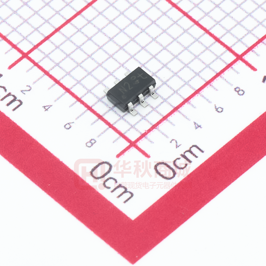

    通用三极管 Dual PNP Ic=500mA Vceo=45V hfe=160~400 P=600mW SOT457-6
BC807DS,115 数据手册
BC807DS PNP/PNP general purpose double transistors 3 May 2019 Product data sheet 1. General description PNP/PNP general-purpose double transistors in an SOT457 (SC-74) plastic package. NPN/NPN complement: BC817DS NPN/PNP complement: BC817DPN 2. Features and benefits • • • Reduces component count Reduces pick and place costs AEC-Q101 qualified 3. Applications • General purpose switching and amplification 4. Quick reference data Table 1. Quick reference data Symbol Parameter Conditions Min Typ Max Unit open base - - -45 V - - -500 mA - - -1 A Per transistor VCEO collector-emitter voltage IC collector current ICM peak collector current single pulse; tp ≤ 1 ms 5. Pinning information Table 2. Pinning information Pin Symbol Description 1 E1 emitter TR1 2 B1 base TR1 3 C2 collector TR2 4 E2 emitter TR2 5 B2 base TR2 6 C1 collector TR1 Simplified outline 6 1 5 2 Graphic symbol 4 3 SC-74; TSOP6 (SOT457) C1 B2 C2 TR2 C1 TR1 E1 E2 B2 C2 sym018 BC807DS Nexperia PNP/PNP general purpose double transistors 6. Ordering information Table 3. Ordering information Type number Package Name BC807DS Description Version SC-74; TSOP6 plastic, surface-mounted package (SC-74; TSOP6); 6 leads SOT457 7. Marking Table 4. Marking codes Type number Marking code BC807DS N2 8. Limiting values Table 5. Limiting values In accordance with the Absolute Maximum Rating System (IEC 60134). Symbol Parameter Conditions Min Max Unit VCBO collector-base voltage open emitter - -50 V VCEO collector-emitter voltage open base - -45 V VEBO emitter-base voltage open collector - -5 V IC collector current - -500 mA ICM peak collector current - -1 A IBM peak base current - -200 mA Ptot total power dissipation - 370 mW Tj junction temperature - 150 °C Tamb ambient temperature -65 150 °C Tstg storage temperature -65 150 °C - 600 mW Per transistor single pulse; tp ≤ 1 ms Tamb ≤ 25 °C [1] Per device Ptot [1] total power dissipation Tamb ≤ 25 °C [1] 2 Device mounted on an FR4 Printed-Circuit Board (PCB); single-sided copper; tin plated; mounting pad for collector 1 cm . 9. Thermal characteristics Table 6. Thermal characteristics Symbol Parameter Conditions Min Typ Max Unit - - 208 K/W Per device Rth(j-a) [1] thermal resistance from in free air junction to ambient [1] 2 Device mounted on an FR4 PCB; single-sided copper; tin-plated; mounting pad for collector 1 cm . BC807DS Product data sheet All information provided in this document is subject to legal disclaimers. 3 May 2019 © Nexperia B.V. 2019. All rights reserved 2/8 BC807DS Nexperia PNP/PNP general purpose double transistors 10. Characteristics Table 7. Characteristics Tamb = 25 °C unless otherwise specified. Symbol Parameter Conditions Min Typ Max Unit ICBO collector-base cut-off current VCB = -20 V; IE = 0 A - - -100 nA VCB = -20 V; IE = 0 A; Tj = 150 °C - - -5 µA IEBO emitter-base cut-off current VEB = -5 V; IC = 0 A - - -100 nA hFE DC current gain VCE = -1 V; IC = -100 mA [1] 160 - 400 VCE = -1 V; IC = -500 mA [1] 40 - - Per transistor VCEsat collector-emitter saturation voltage IC = -500 mA; IB = -50 mA [1] - - -700 mV VBE base-emitter voltage VCE = -1 V; IC = -500 mA [1] [2] - - -1.2 V Cc collector capacitance VCB = -10 V; IE = 0 A; ie = 0 A; f = 1 MHz - 9 - pF fT transition frequency VCE = -5 V; IC = -10 mA; f = 100 MHz 80 - - MHz [1] [2] Pulsed test: tp ≤ 300 μs; δ ≤ 0.02 VBE decreases by approximately -2 mV/k with increasing temperature. mhc324 600 hFE 500 (1) MHC325 -1000 IC (mA) -6.3 -5.6 -4.9 IB (mA) = -7 -800 -4.2 -3.5 400 -600 300 -2.8 (2) -2.1 -400 200 -1.4 (3) -200 100 0 - 10- 1 -1 - 10 - 102 IC (mA) 0 -2 -4 -6 -8 -10 VCE (V) Tamb = 25 °C VCE = -1 V (1) Tamb = 150 °C (2) Tamb = 25 °C (3) Tamb = −55 °C Fig. 1. 0 - 103 -0.7 Fig. 2. Collector current as a function of collectoremitter voltage; typical values DC current gain as a function of collector current; typical values BC807DS Product data sheet All information provided in this document is subject to legal disclaimers. 3 May 2019 © Nexperia B.V. 2019. All rights reserved 3/8 BC807DS Nexperia PNP/PNP general purpose double transistors mhc326 - 103 mhc327 - 1200 VBE (mV) VCEsat (mV) - 1000 - 102 (2) - 600 (3) - 10 (1) - 800 (1) (2) - 400 -1 - 10- 1 -1 - 102 - 10 IC (mA) - 200 - 10- 1 - 103 -1 - 10 - 102 IC (mA) - 103 VCE = -1 V (1) Tamb = −55 °C (2) Tamb = 25 °C (3) Tamb = 150 °C IC/IB = 10 (1) Tamb = 150°C (2) Tamb = 25 °C (3) Tamb = -55 °C Fig. 3. (3) Fig. 4. Collector-emitter saturation voltage as a function of collector current; typical values Base-emitter voltage as a function of collector current; typical values 11. Test information Quality information This product has been qualified in accordance with the Automotive Electronics Council (AEC) standard Q101 - Stress test qualification for discrete semiconductors, and is suitable for use in automotive applications. 12. Package outline 3.1 2.7 6 3.0 2.5 1.7 1.3 1.1 0.9 5 4 2 3 0.6 0.2 pin 1 index 1 0.95 1.9 0.40 0.25 Dimensions in mm Fig. 5. 0.26 0.10 18-03-11 Package outline SC-74; TSOP6 (SOT457) BC807DS Product data sheet All information provided in this document is subject to legal disclaimers. 3 May 2019 © Nexperia B.V. 2019. All rights reserved 4/8 BC807DS Nexperia PNP/PNP general purpose double transistors 13. Soldering 3.45 1.95 0.45 0.55 (6×) (6×) 0.95 solder lands solder resist 3.3 2.825 0.95 solder paste occupied area 0.7 (6×) Dimensions in mm 0.8 (6×) 2.4 Fig. 6. sot457_fr Reflow soldering footprint for SC-74; TSOP6 (SOT457) 5.3 1.5 (4×) 1.475 0.45 (2×) 5.05 1.475 solder lands solder resist occupied area Dimensions in mm preferred transport direction during soldering 1.45 (6×) 2.85 Fig. 7. sot457_fw Wave soldering footprint for SC-74; TSOP6 (SOT457) BC807DS Product data sheet All information provided in this document is subject to legal disclaimers. 3 May 2019 © Nexperia B.V. 2019. All rights reserved 5/8 BC807DS Nexperia PNP/PNP general purpose double transistors 14. Revision history Table 8. Revision history Data sheet ID Release date Data sheet status Change notice Supersedes BC807DS v.3 20190503 Product data sheet - BC807DS v.2 Modifications: • • The format of this data sheet has been redesigned to comply with the identity guidelines of Nexperia. Legal texts have been adapted to the new company name where appropriate. BC807DS v.2 20021122 Product data sheet - BC807DS v.1 BC807DS v.1 20020809 Product data sheet - - BC807DS Product data sheet All information provided in this document is subject to legal disclaimers. 3 May 2019 © Nexperia B.V. 2019. All rights reserved 6/8 BC807DS Nexperia PNP/PNP general purpose double transistors equipment, nor in applications where failure or malfunction of an Nexperia product can reasonably be expected to result in personal injury, death or severe property or environmental damage. Nexperia and its suppliers accept no liability for inclusion and/or use of Nexperia products in such equipment or applications and therefore such inclusion and/or use is at the customer's own risk. 15. Legal information Data sheet status Document status [1][2] Product status [3] Definition Quick reference data — The Quick reference data is an extract of the product data given in the Limiting values and Characteristics sections of this document, and as such is not complete, exhaustive or legally binding. Objective [short] data sheet Development This document contains data from the objective specification for product development. Preliminary [short] data sheet Qualification This document contains data from the preliminary specification. Applications — Applications that are described herein for any of these products are for illustrative purposes only. Nexperia makes no representation or warranty that such applications will be suitable for the specified use without further testing or modification. Product [short] data sheet Production This document contains the product specification. [1] [2] [3] Please consult the most recently issued document before initiating or completing a design. The term 'short data sheet' is explained in section "Definitions". The product status of device(s) described in this document may have changed since this document was published and may differ in case of multiple devices. The latest product status information is available on the internet at https://www.nexperia.com. Definitions Draft — The document is a draft version only. The content is still under internal review and subject to formal approval, which may result in modifications or additions. Nexperia does not give any representations or warranties as to the accuracy or completeness of information included herein and shall have no liability for the consequences of use of such information. Short data sheet — A short data sheet is an extract from a full data sheet with the same product type number(s) and title. A short data sheet is intended for quick reference only and should not be relied upon to contain detailed and full information. For detailed and full information see the relevant full data sheet, which is available on request via the local Nexperia sales office. In case of any inconsistency or conflict with the short data sheet, the full data sheet shall prevail. Product specification — The information and data provided in a Product data sheet shall define the specification of the product as agreed between Nexperia and its customer, unless Nexperia and customer have explicitly agreed otherwise in writing. In no event however, shall an agreement be valid in which the Nexperia product is deemed to offer functions and qualities beyond those described in the Product data sheet. Disclaimers Limited warranty and liability — Information in this document is believed to be accurate and reliable. However, Nexperia does not give any representations or warranties, expressed or implied, as to the accuracy or completeness of such information and shall have no liability for the consequences of use of such information. Nexperia takes no responsibility for the content in this document if provided by an information source outside of Nexperia. In no event shall Nexperia be liable for any indirect, incidental, punitive, special or consequential damages (including - without limitation - lost profits, lost savings, business interruption, costs related to the removal or replacement of any products or rework charges) whether or not such damages are based on tort (including negligence), warranty, breach of contract or any other legal theory. Customers are responsible for the design and operation of their applications and products using Nexperia products, and Nexperia accepts no liability for any assistance with applications or customer product design. It is customer’s sole responsibility to determine whether the Nexperia product is suitable and fit for the customer’s applications and products planned, as well as for the planned application and use of customer’s third party customer(s). Customers should provide appropriate design and operating safeguards to minimize the risks associated with their applications and products. Nexperia does not accept any liability related to any default, damage, costs or problem which is based on any weakness or default in the customer’s applications or products, or the application or use by customer’s third party customer(s). Customer is responsible for doing all necessary testing for the customer’s applications and products using Nexperia products in order to avoid a default of the applications and the products or of the application or use by customer’s third party customer(s). Nexperia does not accept any liability in this respect. Limiting values — Stress above one or more limiting values (as defined in the Absolute Maximum Ratings System of IEC 60134) will cause permanent damage to the device. Limiting values are stress ratings only and (proper) operation of the device at these or any other conditions above those given in the Recommended operating conditions section (if present) or the Characteristics sections of this document is not warranted. Constant or repeated exposure to limiting values will permanently and irreversibly affect the quality and reliability of the device. Terms and conditions of commercial sale — Nexperia products are sold subject to the general terms and conditions of commercial sale, as published at http://www.nexperia.com/profile/terms, unless otherwise agreed in a valid written individual agreement. In case an individual agreement is concluded only the terms and conditions of the respective agreement shall apply. Nexperia hereby expressly objects to applying the customer’s general terms and conditions with regard to the purchase of Nexperia products by customer. No offer to sell or license — Nothing in this document may be interpreted or construed as an offer to sell products that is open for acceptance or the grant, conveyance or implication of any license under any copyrights, patents or other industrial or intellectual property rights. Export control — This document as well as the item(s) described herein may be subject to export control regulations. Export might require a prior authorization from competent authorities. Translations — A non-English (translated) version of a document is for reference only. The English version shall prevail in case of any discrepancy between the translated and English versions. Trademarks Notice: All referenced brands, product names, service names and trademarks are the property of their respective owners. Notwithstanding any damages that customer might incur for any reason whatsoever, Nexperia’s aggregate and cumulative liability towards customer for the products described herein shall be limited in accordance with the Terms and conditions of commercial sale of Nexperia. Right to make changes — Nexperia reserves the right to make changes to information published in this document, including without limitation specifications and product descriptions, at any time and without notice. This document supersedes and replaces all information supplied prior to the publication hereof. Suitability for use in automotive applications — This Nexperia product has been qualified for use in automotive applications. Unless otherwise agreed in writing, the product is not designed, authorized or warranted to be suitable for use in life support, life-critical or safety-critical systems or BC807DS Product data sheet All information provided in this document is subject to legal disclaimers. 3 May 2019 © Nexperia B.V. 2019. All rights reserved 7/8 BC807DS Nexperia PNP/PNP general purpose double transistors Contents 1. General description...................................................... 1 2. Features and benefits.................................................. 1 3. Applications.................................................................. 1 4. Quick reference data....................................................1 5. Pinning information......................................................1 6. Ordering information....................................................2 7. Marking.......................................................................... 2 8. Limiting values............................................................. 2 9. Thermal characteristics............................................... 2 10. Characteristics............................................................ 3 11. Test information.......................................................... 4 12. Package outline.......................................................... 4 13. Soldering..................................................................... 5 14. Revision history..........................................................6 15. Legal information........................................................7 © Nexperia B.V. 2019. All rights reserved For more information, please visit: http://www.nexperia.com For sales office addresses, please send an email to: salesaddresses@nexperia.com Date of release: 3 May 2019 BC807DS Product data sheet All information provided in this document is subject to legal disclaimers. 3 May 2019 © Nexperia B.V. 2019. All rights reserved 8/8
