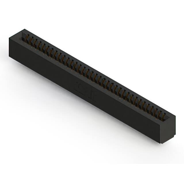

Mounting Option 07-M3-0.5 Metric Threaded Inserts Contact Detail 524-P.C. Tail .025x.013(0.64x0.33) - Tail LG.=.100(2.54) .100 [2.54] Contact Spacing x .140 [3.56] Row Spacing ISSUE NUMBER THIS IS A C.A.D. GENERATED DRAWING DO NOT MAKE MANUAL REVISIONS TO MASTER. ORIGINAL 1 2.175 55.25 2.000 50.80 Card Slot Accpets .054 (1.37) To .070 (1.78) Thick P.C. Board 0.330 8.38 0.295 7.49 Card Slot 0.125 3.18 Point of Contact A 0.437 11.10 SECTION A-A A See Accompanying Pages for: • Contact Bend Details • Mounting Options • Features and Specifications 341/391 Series Card Edge Connector Part Number: 391-038-524-207 EDAC INC TORONTO, ONTARIO CANADA YOUR CONNECTION TO QUALITY & SERVICE THESE DRAWINGS AND SPECIFICATIONS ARE THE PROPERTY OF EDAC INC.,AND SHALL NOT BE REPRODUCED,OR COPIED OR USED AS THE BASIS FOR THE MANUFACTURE OR SALE OF APPARATUS WITHOUT WRITTEN PERMISSION. ACAD REFERENCE NO. J.LEE DRAWN: CHECKED: SCALE: NTS DRAWING NUMBER 341 Assembly 341 ENG MASTER DATE: SEPT. 03/09 DATE: SHEET 1 OF 3 ISSUE 1 ISSUE NUMBER THIS IS A C.A.D. GENERATED DRAWING DO NOT MAKE MANUAL REVISIONS TO MASTER. ORIGINAL 1 Bend Detail 0.120 3.05 0.095 2.41 0.165 4.19 0.190 4.82 .205 [5.21] 0.343 8.71 .125 [3.18] to .210 [5.33] Outside Tails .125 [3.18] to .185 [4.70] Outside Tails .045 [1.14] to .060 [1.52] Between Tails .045 [1.14] to .060 [1.52] Between Tails 555 Contact Code .125 [3.18] to .210 [5.33] Outside Tails .045 [1.14] to .060 [1.52] Between Tails 556 Contact Code 560 Contact Code Mounting Options .010 [0.25] Radial Float 0.116 2.95 I.D. Floating Eyelets .128 [3.25] Dia Through Holes Code x01 Code x02 0.250 6.35 Dia. Code x03 .156 [3.96] Dia Through Holes Code x04 M3-0.5 Metric Threaded Insert Code x07 #4-40 UNC Threaded Insert Code x08 0.328 8.33 0.005 0.13 Vertical Float 341/391 Series Card Edge Connector Bend Detail and Mounting Options EDAC INC TORONTO, ONTARIO CANADA YOUR CONNECTION TO QUALITY & SERVICE THESE DRAWINGS AND SPECIFICATIONS ARE THE PROPERTY OF EDAC INC.,AND SHALL NOT BE REPRODUCED,OR COPIED OR USED AS THE BASIS FOR THE MANUFACTURE OR SALE OF APPARATUS WITHOUT WRITTEN PERMISSION. ACAD REFERENCE NO. J.LEE DRAWN: CHECKED: SCALE: NTS DRAWING NUMBER 341 Assembly 341 ENG MASTER DATE: SEPT. 03/09 DATE: SHEET 2 OF 3 ISSUE 1 ISSUE NUMBER THIS IS A C.A.D. GENERATED DRAWING DO NOT MAKE MANUAL REVISIONS TO MASTER. ORIGINAL 1 Features xUL Recognized x.100 (2.54) Contact Spacing x .140 (3.56) Row Spacing xAccepts .062 (1.57) Nominal Thickness P.C. Board xLow Profile Insulator Body .437 (12.01) xContact Termination Options include P.C. Tail, Wire Hole, and Extender Board Bends xSingle or Dual Row Configurations xVariety of Mounting Options xAccepts Between Contact and In-Contact Polarizing Keys Specifications xInsulator Material: Thermoplastic Polyester, UL 94V-0 xContact Material: Copper, Nickel, Tin Alloy CA-725 xContact Plating: Gold on the Mating Area, Tin on the Contact Tails, Nickel Underplate xCurrent Rating: 3 Amperes Continuous xContact Resistance: 10 Milliohms Maximum xDielectric Withstanding Voltage: 1200 V AC rms at Sea Level Between Adjacent Contacts xInsulation Resistance: 5000 Megohms Minimum xOperating Temperature: -65 to +105 Degrees C xInsertion Force: 16 oz (4.45 N) Maximum per Contact Pair when Tested with a .070 (1.78) Thick Gauge xWithdrawal Force: 1 oz (0.28 N) Minimum per Contact Pair when Tested with a .054 (1.37) Thick Gauge 341/391 Series Card Edge Connector Features and Specifications EDAC INC TORONTO, ONTARIO CANADA YOUR CONNECTION TO QUALITY & SERVICE THESE DRAWINGS AND SPECIFICATIONS ARE THE PROPERTY OF EDAC INC.,AND SHALL NOT BE REPRODUCED,OR COPIED OR USED AS THE BASIS FOR THE MANUFACTURE OR SALE OF APPARATUS WITHOUT WRITTEN PERMISSION. ACAD REFERENCE NO. J.LEE DRAWN: CHECKED: SCALE: NTS DRAWING NUMBER 341 Assembly 341 ENG MASTER DATE: SEPT. 03/09 DATE: SHEET 3 OF 3 ISSUE 1 Mouser Electronics Authorized Distributor Click to View Pricing, Inventory, Delivery & Lifecycle Information: EDAC: 391-038-524-207
391-070-556-201
1. 物料型号:391-038-524-207 2. 器件简介:文档描述了一种卡边缘连接器,具有多种安装选项和特点。 3. 引脚分配:文档提供了详细的引脚分配和间距,例如接触点间距为2.54mm,行间距为3.56mm。 4. 参数特性:包括绝缘材料、接触材料、镀层、电流额定值、接触电阻、介电强度、绝缘电阻、操作温度范围、插入力和拔出力等。 5. 功能详解:文档提供了连接器的功能特点,如接受0.062英寸(1.57mm)厚度的PCB板,低轮廓绝缘体,多种接触终止选项,单排或双排配置,以及多种安装选项。 6. 应用信息:文档提到了Mouser Electronics作为授权分销商,并提供了查看定价、库存、交货和生命周期信息的链接。 7. 封装信息:文档中包含了封装的详细图纸和规格,但没有提供封装类型的具体描述。
