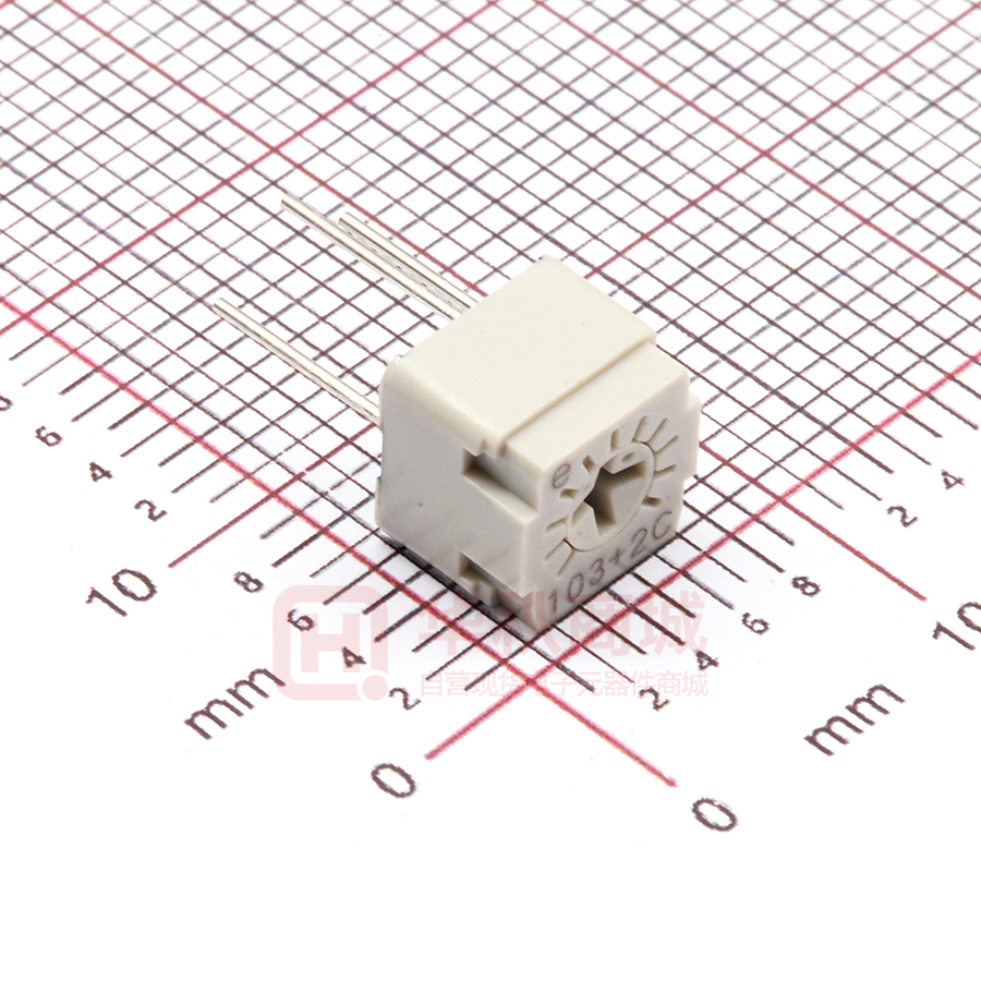

    精密微调电阻 POTENTIONMETER_7X7MM_TM 10KΩ ±10% 1/2W ±100ppm/℃
FT-63EP 10K ohm(103) 10 数据手册
SINGLE TURN CERMET TRIMMERS RoHS compliant FT-63 INTERNAL STRUCTURE ② ① ③ ④ ⑤ ⑨ ⑧ ⑥ ⑦ Part name ■ FEATURES ● RoHS compliant ● Resistance tolerance ± 10 % ● “O” ring sealed (Washable: Refer to 698) ● Suitable for automatic insertion and automatic adjust­ment ● Increase in the level of characteristics in the high-     frequency field (In house comparison) ● Resin material is UL Recognized 94V-0    ① Housing ② Rotor ③ Wiper ④ “O” ring ⑤ Resistive element ⑥ Terminal pin ⑦ Adhesive ⑧ Base element ⑨ Electrode Material Polybutyleneterephthalate Nickel silver Silicone rubber RuO2 cermet Copper, Tin-plated Epoxy Ceramic Ag-Pd cermet ■ PART NUMBER DESIGNATION FT-63 E T V 5kΩ (502) Series name Resistance code Terminal pin Resistance value E:Sn (Lead-free) Product shape Form of packaging T:Taping (Ammo pack type) Blank:Bulk in plastic bag P:Top adjustment V:Top adjustment ※ Please refer to the LIST OF PART NUMBERS when placing orders. S:Side adjustment X:Side adjustment H:Side adjustment N:Side adjustment FT-63 CERMET TRIMMERS ■ LIST OF PART NUMBERS Adjustment position Top adjustment Side adjustment Form of packaging 〈Nominal resistance values〉 → 10 Ω Taping (Ammo pack type) Plastic bag FT-63ETP FT-63EP FT-63ETV FT-63EV FT-63ETS FT-63ES FT-63EX FT-63ETH FT-63EH FT-63EN Fig. 1 → 20 Ω 50 Ω 100 Ω 200 Ω 300 Ω 500 Ω 1 kΩ 2 kΩ 3 kΩ 5 kΩ 10 kΩ 20 kΩ 30 kΩ 50 kΩ 100 kΩ 200 kΩ 300 kΩ 500 kΩ 1 MΩ 2 MΩ ※ The above part numbers are all available with the respective com­bi­na­tion of (Fig. 1). ※ Verify the above part numbers when placing orders. ※ Taping specification is not sold separately and must be purchased in tap­ing unit. The products indicated by → mark are manufactured upon receipt of order basis. :Not manufactured ■ ELECTRICAL CHARACTERISTICS Nominal resistance range Resistance tolerance ■ MECHANICAL CHARACTERISTICS 10 Ω ~ 2 MΩ Mechanical angle 260 ° (1 turn) ± 10 % Operating torque 20 mN·m {204 gf·cm} maximum Power ratings 0.5 W (70 °C) 0 W (125 °C) Stop strength 50 mN·m {510 gf·cm} minimum Resistance law Linear law Rotational life 100 cycles [ΔR/R ≦ ± (2 Ω +3 %)] Terminal strength 10 N {1.02 kgf} minimum (Tensile strength) Power ratings Thrust to rotor 10 N {1.02 kgf} minimum 220 ° (1 turn) Solderability Maximum input voltage DC200 V or power rating, whichever is smaller Maximum wiper current Effective electrical angle End resistance 1 % or 2 Ω , whichever is greater C.R.V. 2 % or 3 Ω , whichever is greater Operating temp. range Temp. coefficient Insulation resistance Dielectric strength Net weight −55 ~ 125 °C 10 Ω ~ 20 Ω : ± 150 10-6/°C maximum 50 Ω ~ 2 MΩ : ± 100 10-6/°C maximum 1000 MΩ minimum (DC500 V) AC900 V, 60 s Approx. 0.52 g (FT-63EP, EV) Approx. 0.66 g (FT-63ES, EH, EX, EN) 245 ± 3 °C, 2 ~ 3 s { }:Reference only FT-63 CERMET TRIMMERS ■ ENVIRONMENTAL CHARACTERISTICS Test item Test conditions Specifications − 65 ~ 125 °C (0.5 h), 5 cycles −10 ~ 65 °C (80 ~ 98 %), 10 cycles, 240 h 981 m/s2, 6 ms 6 directions for 3 times each [ΔR/R ≦ 1 %] [S.S. ≦ 1 %] Vibration (Amplitude) 1.52 mm or (Acceleration) 196 m/s2, 10 ~ 2000 Hz, 3 directions, 12 times each [ΔR/R ≦ 1 %] [S.S. ≦ 1 %] Load life 70 °C, 0.5 W 1000 h Low temp. operation −55 °C, 2 h High temp. exposure 125 °C, 250 h [ΔR/R ≦ 3 %] [S.S. ≦ 1 %] [ΔR/R ≦ 2 %] [S.S. ≦ 2 %] [ΔR/R ≦ 3 %] [S.S. ≦ 2 %] Immersion seal 85 °C, 60 s Thermal shock Humidity Shock Soldering heat Flow 260 ± 3 °C, 5 ~ 6 s, two times maximum Manual soldering 380 ± 10 °C, 3 ~ 4 s [ΔR/R ≦ 2 %] No leaks (No continuous bubbles) [ΔR/R ≦ 1 %] ΔR/R:Change in total resistance S.S. :Setting stability ■ MAXIMUM INPUT RATINGS Nominal resistance values ( Ω ) Resistance code Maximum input Maximum wiper voltage (V) current (mA) → 10 → 20 50 100 200 300 500 100 200 500 101 201 301 501 2.24 3.16 5.00 7.07 10.0 12.2 15.8 223 158 100 70.7 50.0 40.8 31.6 1 k 2 k 3 k 5 k 10 k 20 k 30 k 50 k 102 202 302 502 103 203 303 503 22.4 31.6 38.7 50.0 70.7 100 122 158 22.4 15.8 12.9 10.0 7.07 5.00 4.08 3.16 100 k 200 k 300 k 500 k 1 M 2 M 104 204 304 504 105 205 200 200 200 200 200 200 2.00 1.00 0.66 0.40 0.20 0.10 The products indicated by → mark are manufactured upon receipt of order basis. FT-63 CERMET TRIMMERS ■ OUTLINE DIMENSIONS Unless otherwise specified, tolerance: ± 0.3 (Unit: mm) ● FT-63EP Top adjustment ① ③ CW rotation 260°Nom. ② Lead-free Identification mark 3 –φ0.45 ② 7 2.5 0.7 W × 3L × 1.6 D ③ 7 5.8 ① 2.5 72 2.5 Resistance code & Production date code ● FT-63ES Side adjustment Lead-free Identification mark 260°Nom. 0.7 W × 3L × 1.6 D +0.4 7 –0.2 Adjustment Resistance code & Production date code ① ③ 2.5 4.6 8.2 ② 3.5 7 +0.4 0 2.5 7.5±2 2.5 3 –φ0.45 ● FT-63EX Side adjustment 7 +0.4 0 Resistance code & Production date code 7 +0.4 –0.2 Adjustment 2.5 8.2 3.5 ② 4.6 260°Nom. 0.7 W × 3L × 1.6 D ③ 10±2 Lead-free Identification mark 3 –φ0.45 2.5 2.5 ① FT-63 CERMET TRIMMERS ■ OUTLINE DIMENSIONS Unless otherwise specified, tolerance: ± 0.3 (Unit: mm) ● FT-63EV Top adjustment ① ③ CW rotation 260° Nom. Lead-free Identification mark ① ② 7 0.7 W × 3L × 1.6 D ② ③ 3 –φ0.45 13.5 ± 2 7 Resistance code & Production date code 2.5 16 ± 2 5.8 2.5 ● FT-63EH Side adjustment 0.7 W × 3L × 1.6 D 7 +0.4 –0.2 Resistance code & Production date code 260°Nom. Adjustment ② ③ 2.5 9.5 ± 2 7±2 4.6 8.2 ① 3.5 Lead-free Identification mark 7 +0.4 0 2.5 3 –φ0.45 ● FT-63EN Side adjustment 0.7 W × 3L × 1.6 D +0.4 7 –0.2 Adjustment 3.5 ② 2.5 8.2 260°Nom. Resistance code & Production date code 4.6 Lead-free Identification mark +0.4 0 ① 7.5 ± 2 7 2.5 2.5 ③ 3 –φ0.45 ★ Terminals 1 & 3 position in N type is different from X type. FT-63 CERMET TRIMMERS FT-6TP ■ OUTLINE DIMENSIONS Unless otherwise specified, tolerance: ± 0.3 (Unit: mm) ① ③ CW rotation ② ● FT-63ETP Top adjustment 0.7W × 3L × 1.6D 260°Nom. Resistance code & Production date code 12.71 ∆ 2 max. 7 12.7±1 ∆ 2 max. ∆ 7 2.5 0.9 3 12.7±0.3 0.5 max. 3 min. 18±0.5 +0.7 9 –0.5 16±1 6±0.5 0.9 3 0.45±0.02 ● FT-63ETS Side adjustment 0.9 1 8.2 2.5 18±0.5 +0.7 2.5 2.5 3 Φ 40.2 6.35±0.5 12.7±0.3 0.45±0.02 ∆ 2 max. 4.6 6±0.5 3.5 9 –0.5 0.5 max. 3 min. 16±1 27.2±1 8.2 3 Φ 40.2 0.45±0.02 0.7W × 3L × 1.6D 18±0.5 2.5 6.35±0.5 7 260°Nom. ∆ 2 max. Resistance code & Production date code 3.5 9 +0.7 –0.5 0.5 max. 60.5 19±0.75 3 min. Resistance code & Production date code Lead-free Identification mark ∆ 2 max. +0.4 0 3±0.5 ∆ 2 max. 0.7W × 3L × 1.6D 19±0.75 0 7 +0.4 260°Nom. 7 +0.4 –0.2 12.7±1 7 +0.4 –0.2 4.6 Lead-free Identification mark 12.7±0.3 2 max. Φ 4±0.2 12.7±0.3 0.45±0.02 12.7±1 2.5 ∆ 2 max. 2.5 2.5 6.35±0.5 ● FT-63ETH Side adjustment 27.2±1 2.5 1 Φ 4±0.2 6.35±0.5 1 19±0.75 24.8±1 9 +0.7 –0.5 2.5 1 18±0.5 0.5 max. 6±0.5 3 min. 19±0.75 24.8±1 5.8 7 Resistance code & Production date code Lead-free Identification mark 7 5.8 Lead-free Identification mark 0.7W × 3L × 1.6D 260°Nom. 30.5 ● FT-63ETV Top adjustment 0.9 FT-63 CERMET TRIMMERS CT-6 梱包仕様 ■PACKAGING SPECIFICATIONS ● Taping version is packaged in 1000 pcs. per reel. Orders will be accepted for units of 1000 pcs., i.e., 1000, 2000, 3000 pcs., etc. ● Tape & reel version contains 1000 pcs. in one box. ● Unit of bulk pack in a plastic bag is 100 pcs. per pack. ● Boxing of bulk in a plastic bag is performed with 1000 pcs. per box. Direction of feed 45 #1 terminal 1 3 Direction of feed 33 0 0 33 #3 terminal Ammo pack type Ammo Pack ● Package size: 330 mm × 330 mm × 45 mm ● The leader and end of the tape have an empty part of minimum 300 mm respectively. ● There are two tape outlets on the package for different terminal alignment directions, for which details refer to the sketch above. (e.g.) When the tape is fed from the right outlet marked 3, #3 terminal comes out first. ● Gross weight of the boxing version ETV : Approx. 850 g ETH : Approx. 940 g ETP : Approx. 820 g ETS : Approx. 940 g

物料型号:FT-63ETV、FT-63EV、FT-63ES、FT-63EX、FT-63EP、FT-63EH、FT-63EN、FT-63ETH、FT-63ETS
器件简介:这是一系列单圈精密陶瓷微调器,符合RoHS标准,具有多种调整方式和封装形式。
引脚分配:文档中未明确列出引脚分配,但提供了端子强度和端子引脚的相关信息。
参数特性: - 电阻公差:±10% - 额定电阻范围:10~2MΩ - 功率等级:0.5W(70°C)/0W(125°C) - 最大输入电压:DC200V或功率等级中较小者 - 最大刮刷电流:等于功率等级 - 有效电气角度:220°(1圈) - 端电阻:1%或2Ω,取较大者 - 温度系数:10~20Ω:最大150ppm/°C,50~2MΩ:最大100ppm/°C - 绝缘电阻:最小1000MΩ(DC500V) - 耐压:AC900V,60秒
功能详解: - 适合自动插入和自动调整 - 在高频领域提高了特性水平(与内部比较) - 树脂材料为UL认可的94V-0
应用信息:文档中未明确提供应用信息,但根据其特性,这些微调器可能用于精密调整电路参数。
封装信息: - 封装形式包括胶带包装和散装塑料袋 - 胶带包装每卷1000个,散装塑料袋每包100个,每箱1000个
