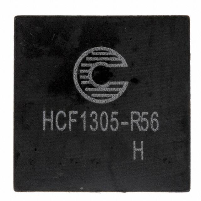

    SMD,12.5x12.5mm
    固定电感器 Nonstandard 560nH ±20% 32A 1mΩ
HCF1305-R56-R 数据手册
Technical Data 4133 Effective July 2017 Supersedes March 2007 HCF1305 High frequency, high current power inductors Applications • • • • • • Next generation processors High current DC-DC converters VRM, multi-phase buck regulators PC Workstations, Routers, Servers Telecom soft switches Base stations Environmental data • Product features • • • • • • • 12.5 mm x 12.5 mm x 5.0 mm surface mount package Ferrite core material Inductors designed for higher speed switch mode applications requiring low voltage and high current Design utilizes ferrite core with high DC bias resistance and low core loss Inductance range from 0.47 µH to 4.7 µH Current range from 36.0 A to 10.4 A Frequency range 100 kHz to 1 MHz • • Storage temperature range (component): -40 °C to +125 °C Operating temperature range: -40 °C to +125 °C (ambient plus self-temperature rise) Solder reflow temperature: J-STD-020 (latest revision) compliant Pb HF FREE HALOGEN  Technical Data 4133 Effective July 2017 Product specifications Part Number Rated Inductance (µH) 0.47 0.56 1.00 1.20 1.80 2.20 3.00 3.30 4.00 4.70 HCF1305-R47-R HCF1305-R56-R HCF1305-1R0-R HCF1305-1R2-R HCF1305-1R8-R HCF1305-2R2-R HCF1305-3R0-R HCF1305-3R3-R HCF1305-4R0-R HCF1305-4R7-R OCL (1) µH ± 20% Irms (2) Amperes Isat (3) Amperes Isat2 (4) Amperes 0.47 0.56 1.00 1.20 1.80 2.20 3.00 3.30 4.00 4.70 32.0 32.0 22.0 22.0 16.3 16.3 13.2 13.2 10.9 10.9 36.0 30.0 24.0 20.0 18.0 15.0 14.4 12.5 12.0 10.4 30.0 22.5 20.0 15.0 15.0 11.2 12.0 9.0 10.0 7.5 1) OCL: Open Circuit Inductance test parameters: 100 kHz, 0.1 Vrms, 0.0 Adc. OCL@-40 °C can be lower than OCL@+20 °C by 15% max. 2) Irms: DC current for an approximate DT of 40 °C without core loss. Derating is necessary for AC currents. PCB layout, trace thickness and width, air-flow, and proximity of other heat generating components will affect the temperature rise. It is recommended that the temperature of the part not exceed +125 °C under worst case operating conditions verified in the end application. 3) Isat1: Amperes Peak for approximately 30% rolloff (@+25 °C) 4) Isat2: Amperes Peak for approximately 30% rolloff (@+125 °C) DCR mΩ@20°C (Typical) 0.83 0.83 1.58 1.58 2.58 2.58 4.08 4.08 6.0 6.0 DCR mΩ@20°C (Maximum) 1.00 1.00 1.90 1.90 3.10 3.10 4.90 4.90 7.2 7.2 K-factor (5) 21 21 14 14 10 10 8.3 8.3 6.9 6.9 5) K-factor: Used to determine B p-p for core loss (see graph). B p-p = K*L*∆I B p-p:(mT), K: (K factor from table), L: (Inductance in µH), ∆I (Peak to peak ripple current in Amps). Part number definition: HCF1305-XXX-R HCF1305 = Product code and size XXX = Inductance value in uH. R = Decimal point. If no R is present, third character = #of zeros -R suffix indicates RoHS compliant Dimensions- mm TOP V IEW BOTTOM VI EW A DIMENSION TABLE RECOMMENDED PCBLAYOU T A: 12.5max G: 4.00 Ref. B: 12.5max H: 5.40 Ref. C: 5.0max I: 3.00 Ref. D: 2.00 ref J: 4.00 Ref. E: 2.40 +/- 0.10 K: 4.00 Ref. F: 6.90 +/- 0.30 L: 3.4 Ref. C 2 B D 3 1 K J wwllyy=Date code, R=Revision Level I Do not route traces or vias underneath the inductor Packaging information - mm 1.5 dia +0.1/-0.0 4.0 1.5 dia min 2.0 A 1.75 11.5 HCF 1305-X X X wwlly y-R B0 24.0 +/-0.3 K0 A0 A 16.00 SECTION A-A A0= 12.60 mm B0= 12.60 mm K0= 5.50 mm www.eaton.com/electronics 2 H G I E 2 SCHEMAT IC L 1 HCF1305-XXX wwllyy R FRONT VIEW F User direction of feed Parts packaged on a 13" Diameter reel. 600 parts per reel. HCF1305 High frequency, high current power inductor Technical Data 4133 Effective July 2017 Temperature rise vs total loss Temperature Rise (ºC) 100 80 60 40 20 0 0 0.4 0.8 1.2 1.6 2 Total Pow er Loss (W) Core loss vs Bp-p 10 1 MHz 500 kHz 1 300 kHz 200 kHz Core Loss (W) 100 kHz 0.1 0.01 0.001 0.0001 1 10 100 1000 Bp-p (m T) Inductance characteristics Normalized Rolloff Curves at 25 Deg. C Normali 100.0% 90.0% 90.0% 80.0% % of OCL % of OC L 80.0% 70.0% 60.0% R47, 1R0, 1R8, 3R0 and 4R0 R56, 1R2 and 2R2 3R3 and 4R7 70.0% 60.0% 50.0% R47, 1R0, 1R8 , 3R0 and 4R0 R56, 1R2 and 2R2 3R3 and 4R7 40.0% 50.0% 40.0% 0.0% Curves at 125 Deg. C 100.0% 30.0% 0.0% 20.0% 40.0% 60.0% 80.0% % of I SAT1 100.0% 120.0% 140.0% 20.0% 40.0% 60.0% 80.0% % of I SAT2 100.0% 120.0% 140.0% www.eaton.com/electronics 3 HCF1305 High frequency, high current power inductor Technical Data 4133 Effective July 2017 Solder Reflow Profile TP TC -5°C Temperature TL 25°C Preheat A T smax Table 1 - Standard SnPb Solder (Tc) tP Max. Ramp Up Rate = 3°C/s Max. Ramp Down Rate = 6°C/s t Volume mm3 220°C 220°C Table 2 - Lead (Pb) Free Solder (T c) Tsmin Package Thickness 2.5mm ts Time 25°C to Peak Volume mm3 2000 260°C 245°C 245°C Time Reference JDEC J-STD-020 Profile Feature Preheat and Soak • Temperature min. (Tsmin) • Temperature max. (Tsmax) • Time (Tsmin to Tsmax) (ts) Average ramp up rate Tsmax to Tp Liquidous temperature (TL) Time at liquidous (tL) Peak package body temperature (TP)* Time (tp)** within 5 °C of the specified classification temperature (Tc) Average ramp-down rate (Tp to Tsmax) Time 25°C to Peak Temperature Standard SnPb Solder 100°C Lead (Pb) Free Solder 150°C 150°C 200°C 60-120 Seconds 60-120 Seconds 3°C/ Second Max. 3°C/ Second Max. 183°C 60-150 Seconds 217°C 60-150 Seconds Table 1 Table 2 20 Seconds** 30 Seconds** 6°C/ Second Max. 6°C/ Second Max. 6 Minutes Max. 8 Minutes Max. * Tolerance for peak profile temperature (Tp) is defined as a supplier minimum and a user maximum. ** Tolerance for time at peak profile temperature (tp) is defined as a supplier minimum and a user maximum. Life Support Policy: Eaton does not authorize the use of any of its products for use in life support devices or systems without the express written approval of an officer of the Company. Life support systems are devices which support or sustain life, and whose failure to perform, when properly used in accordance with instructions for use provided in the labeling, can be reasonably expected to result in significant injury to the user. Eaton reserves the right, without notice, to change design or construction of any products and to discontinue or limit distribution of any products. Eaton also reserves the right to change or update, without notice, any technical information contained in this bulletin. Eaton Electronics Division 1000 Eaton Boulevard Cleveland, OH 44122 United States www.eaton.com/electronics © 2017 Eaton All Rights Reserved Printed in USA Publication No. 4133 July 2017 Eaton is a registered trademark. All other trademarks are property of their respective owners.
