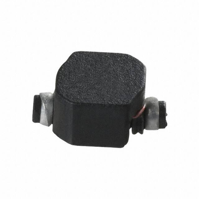

    固定电感器 Nonstandard 68µH ±20% 450mA 1.1Ω
UP0.4C-680 数据手册
Technical Data 4107 Effective January 2016 Supersedes March 2007 UP0.4C Unshielded drum core power inductors Applications • Handheld/portable devices • Computers and peripherals • Gaming machines/consoles • DC-DC converters • Power supplies • General purpose filtering Environmental Data Product description • Protective case over core and winding • Frequency range 1 kHz to 2 MHz • Inductance range from 1.2 µH to 100 µH • Current range from 0.35 A to 3.33 A • 6.6 mm x 4.45 mm footprint surface mount package in a 2.92 mm height • Ferrite core material • Lead free and RoHS compliant • Storage temperature range (component): -40 °C to +125 °C • Operating temperature range: -40 °C to +125 °C (ambient plus self-temperature rise) • Solder reflow temperature: J-STD-020D compliant Pb UP0.4C Unshielded drum core power inductors  Technical Data 4107 Effective January 2016 Product Specifications Part Number4 Ordering Code5 OCL1 (μH) ± 20% Irms2 (A) Isat3 (A) DCR (Ω) maximum @ 20 °C UP0.4C-1R0-R UP0-4C-1R0-R 1.16 2.88 3.33 0.030 UP0.4C-1R5-R UP0-4C-1R5-R 1.49 2.58 2.94 0.034 UP0.4C-2R2-R UP0-4C-2R2-R 2.27 2.15 2.38 0.050 UP0.4C-3R3-R UP0-4C-3R3-R 3.22 1.89 2.00 0.060 UP0.4C-4R7-R UP0-4C-4R7-R 4.95 1.55 1.61 0.088 UP0.4C-6R8-R UP0-4C-6R8-R 7.06 1.30 1.35 0.128 UP0.4C-100-R UP0-4C-100-R 9.53 1.16 1.16 0.156 UP0.4C-150-R UP0-4C-150-R 14.5 0.95 0.94 0.250 UP0.4C-220-R UP0-4C-220-R 21.8 0.76 0.77 0.360 UP0.4C-270-R UP0-4C-270-R 27.5 0.69 0.68 0.480 UP0.4C-330-R UP0-4C-330-R 32.2 0.64 0.63 0.560 UP0.4C-390-R UP0-4C-390-R 39.0 0.59 0.57 0.650 UP0.4C-470-R UP0-4C-470-R 46.5 0.53 0.53 0.820 UP0.4C-680-R UP0-4C-680-R 68.2 0.45 0.43 1.10 UP0.4C-101-R UP0-4C-101-R 102.5 0.37 0.35 1.58 1. Open Circuit Inductance (OCL) Test Parameters: 100 kHz, 0.250 Vrms, 0.0 Adc 2. Irms: DC current for an approximate temperature rise of 40 °C without core loss. Derating is necessary for AC currents. PCB layout, trace thickness and width, air-flow, and proximity of other heat generating components will affect the temperature rise. It is recommended that the temperature of the part not exceed 125 °C under worst case operating conditions verified in the end application. 3. Peak current for approximately 30% roll-off @ 20 °C 4 Part Number Definition: UP0.4C-xxx-R UP0.4C= Product code and size xxx= Inductance value in μH, R= decimal point, if no R is present then last character equals number of zeros -R suffix = RoHS compliant 5. Use ordering code when ordering parts. 1 yww xxx Dimensions (mm) 2 2.40 4.45 max max 2.92 max 1.00 ref (2x) 6.60 max 4.45 ref RECOMMENDED PCB LAYOUT 4.06 1.4 (2x) 2.9 (2x) Part marking: yww= date code, xxx=inductance value in uH, R=decimal point, if no R is present then last character equals number of zeros. Supplied in tape and reel packaging 2,500 parts per reel Do not route traces or vias underneath the inductor % of Initial Inductance Inductance characteristics 100% 80% 60% 40% 20% 0% 0% 20% 40% 60% 80% 100% 120% 140% 160% % of Isat 2 www.eaton.com/elx SCHEMATIC 1 2 UP0.4C Unshielded drum core power inductors Technical Data 4107 Effective January 2016  Solder reflow profile TP TC -5°C tP Max. Ramp Up Rate = 3°C/s Max. Ramp Down Rate = 6°C/s Temperature TL Preheat A T smax t Table 1 - Standard SnPb Solder (Tc) Package Thickness Volume mm3
