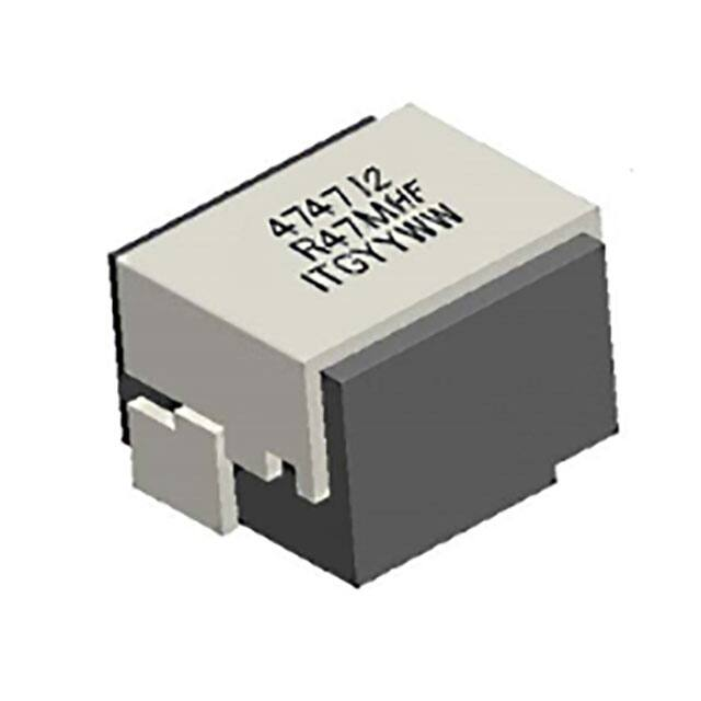

    固定电感器 Nonstandard 560nH ±20% 43A 0.69mΩ
SLM474712A-R56MHF 数据手册
SLM474712 Series 1. Features: · · · · · · · · · Ferrite based SMD Inductor with lower core loss. Inductance Range:390.0nH to 1200.0nH. Custom values are welcomed. High current output chokes, upto 81.0 Amp with approx. 20% roll off. Low Profile 11.80mm Max. height . Foot Print 12.0 x 11.90 mm Max. Ideal for Buck Converter, VRM & High Density Board Design. Operating frequency up to 1 MHz application. Operating Temperature Range -55°C to + 130°C , RoHs & HF compliance . T & R Qtys: 250 pcs , 13'' Reel ; 2. Electrical Characteristic of SLM474712 Series: OCL 1 L @ Isat1 2 DCR 3 Isat1 4 Isat2 4 Isat3 4 Irms 5 (nH) (nH) (mΩ) (A) (A) (A) (A) ± 20% Min. ± 7.0% @25℃ @75℃ @100℃ @25℃ SLM474712A-R39MHF 390.00 280.80 0.69 81.00 74.00 70.00 43.00 SLM474712A-R47MHF 470.00 338.40 0.69 67.00 62.00 58.00 43.00 SLM474712A-R56MHF 560.00 403.20 0.69 54.00 48.00 45.00 43.00 SLM474712A-R68MHF 680.00 489.60 0.69 45.00 42.00 39.00 43.00 SLM474712A-R82MHF 820.00 590.40 0.69 37.00 35.00 32.00 43.00 SLM474712A-1R0MHF 1000.00 720.00 0.69 30.00 26.50 24.50 43.00 SLM474712A-1R2MHF 1200.00 864.00 0.69 23.00 21.00 20.00 43.00 Part Number 3. Mechanical Dimension(Unit:mm): A B C D E D Marking F B G F (Max.) (Max.) (Max.) (Max.) (Nom.) ± 0.20 ± 0.30 C 11.90 10.30 11.80 12.00 6.75 5.00 A 2.50 a E Side View b Glue G Bottom View 5.90 2x5.50 2x3.25 Suggested Pad Layout Note: 1>.Open Circuit Inductance (OCL) test condition:100KHz,0.1Vrms,0Adc ,at 25℃. 2>.L @ Isat and L @ Irms Test condition:100KHz,0.1Vrms ; (Ta=25℃). 3>.The nominal DCR is measured from point "a" to point"b",as shown above on the mechanical drawing. 4>.Isat1,Isat2 & Isat3 : DC current that will cause inductance to drops approximately by 20% ; 5>. Irms: DC current for an approximate temperature rise of 40℃ without core loss,.Derating is necessary for AC currents. PCB pad layout,trace thickness and width,air-flow and proximity of other heat generating components will affect the temperature rise. It is recommended the part temperature not exceed 130°C under worst case operating conditions verified in the end application. US 1 914 347 2474 ●Taiwan 886 972 022 388 ●Shenzhen 86 755 8418 6263 ●Shanghai 86 21 5424 5141 ●HK 852 9688 9767 Sales@inter-technical.com www.inter-technical.com , Rev.B, July.24, 2014 SLM474712 Series 4. Inductance Characteristics (Inductance vs. Current): SLM474712x-R39MHF 450.0 400.0 350.0 25Ԩ L (nH) 300.0 250.0 75Ԩ 200.0 150.0 100Ԩ 100.0 50.0 0.0 0.0 10.0 20.0 30.0 40.0 50.0 60.0 68.0 70.0 72.0 74.0 76.0 78.0 80.0 82.0 84.0 86.0 88.0 90.0 92.0 94.0 Direct Current (A) SLM474712x-R47MHF 526.5 468.0 409.5 25Ԩ L (nH) 351.0 292.5 75Ԩ 234.0 175.5 100Ԩ 117.0 58.5 0.0 L (nH) 0.0 10.0 20.0 30.0 40.0 50.0 52.0 54.0 56.0 58.0 60.0 62.0 64.0 66.0 68.0 70.0 72.0 74.0 76.0 78.0 80.0 82.0 Direct Current (A) SLM474712x-R56MHF 634.5 564.0 493.5 423.0 352.5 282.0 211.5 141.0 70.5 0.0 25Ԩ 75Ԩ 100Ԩ L (nH) 0.0 10.0 20.0 30.0 40.0 42.0 44.0 46.0 48.0 50.0 52.0 54.0 56.0 58.0 60.0 62.0 64.0 66.0 68.0 Direct Current (A) SLM474712x-R68MHF 755.0 679.5 604.0 528.5 453.0 377.5 302.0 226.5 151.0 75.5 0.0 25Ԩ 75Ԩ 100Ԩ 0.0 10.0 20.0 30.0 35.0 40.0 41.0 42.0 43.0 44.0 45.0 46.0 47.0 48.0 49.0 50.0 52.0 54.0 56.0 Direct Current (A) US 1 914 347 2474 ●Taiwan 886 972 022 388 ●Shenzhen 86 755 8418 6263 ●Shanghai 86 21 5424 5141 ●HK 852 9688 9767 Sales@inter-technical.com www.inter-technical.com , Rev.B, July.24, 2014 SLM474712 Series L (nH) Inductance vs. Current SLM474712x-R82MHF 890.5 822.0 753.5 685.0 616.5 548.0 479.5 411.0 342.5 274.0 205.5 137.0 68.5 0.0 25Ԩ 75Ԩ 100Ԩ 0.0 10.0 20.0 30.0 31.0 32.0 33.0 34.0 35.0 36.0 37.0 38.0 39.0 40.0 41.0 42.0 43.0 44.0 46.0 48.0 Direct Current (A) SLM474712x-1R0MHF 1080.0 990.0 900.0 810.0 25Ԩ L (nH) 720.0 630.0 75Ԩ 540.0 450.0 360.0 100Ԩ 270.0 180.0 90.0 0.0 0.0 5.0 10.0 15.0 20.0 22.0 24.0 26.0 28.0 30.0 31.0 32.0 33.0 34.0 35.0 36.0 37.0 38.0 40.0 Direct Current (A) 1320.0 SLM474712x-1R2MHF 1200.0 1080.0 960.0 25Ԩ L (nH) 840.0 720.0 75Ԩ 600.0 480.0 100Ԩ 360.0 240.0 120.0 0.0 0.0 5.0 8.0 10.0 12.0 15.0 18.0 20.0 20.5 21.0 21.5 22.0 22.5 23.0 24.0 25.0 26.0 27.0 28.0 29.0 30.0 31.0 Direct Current (A) US 1 914 347 2474 ●Taiwan 886 972 022 388 ●Shenzhen 86 755 8418 6263 ●Shanghai 86 21 5424 5141 ●HK 852 9688 9767 Sales@inter-technical.com www.inter-technical.com , Rev.B, July.24, 2014
