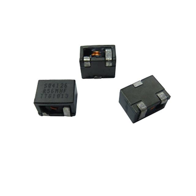

SQ4126 Series RoHS COMPLIANT HF COMPLIANT 1. Features: · Ferrite based SMD Inductor with lower core loss. · Inductance Range:0.42uH to 10.00uH,Custom values are welcomed. · High current output chokes, upto 45.0 Amp with approx. 20% roll off. · Low Profile 6.65mm Max. height . · Foot Print 8.10 x 10.30 mm Max. · Ideal for VRM, POL, Notebook regulators,Graphics cards and battery power systems · Operating frequency up to 1 MHz application. · Operating Temperature Range -55°C to + 130°C , RoHs & HF compliance . · T & R Qtys: 700 pcs , 13'' Reel ; 2. Electrical Characteristic of SQ4126 Series: Inductance DCR DCR Isat1 Isat2 Irms (uH) (mΩ) (mΩ) (A) (A) (A) ±20% Typical Max. @25℃ @125℃ @25℃ 0.42 0.56 0.68 1.00 1.50 2.20 3.30 4.70 5.60 6.80 10.00 1.200 1.200 1.200 2.200 3.900 6.350 7.500 8.600 8.600 8.600 8.600 1.390 1.390 1.390 2.800 4.399 6.731 7.950 9.169 9.169 9.169 9.169 45.00 36.00 29.00 26.00 22.00 18.00 14.50 12.00 9.40 7.80 5.30 36.00 28.00 23.00 21.00 17.00 14.00 11.00 8.90 7.50 6.10 4.20 26.00 26.00 26.00 16.00 13.00 11.00 10.00 9.40 9.40 9.40 9.40 Part Number SQ4126-R42MHF SQ4126-R56MHF SQ4126-R68MHF SQ4126-1R0MHF SQ4126-1R5MHF SQ4126-2R2MHF SQ4126-3R3MHF SQ4126-4R7MHF SQ4126-5R6MHF SQ4126-6R8MHF SQ4126-100MHF D G 3. Mechanical Dimension(Unit:mm): A B C D E F G H I J A F b J E Max. Max. Max. Nom. Nom. Ref. Nom. Nom. Nom. Max. 8.10 10.30 6.65 6.00 4.20 1.80 2.30 1.30 2.40 8.20 Marking I a H 8.6 2x3.0 C B Note: 3.6 3.6 2.9 2.0 Suggested Pad Layout 1>.Open Circuit Inductance (OCL) test condition:100KHz,0.1Vrms,0Adc ,at 25 ℃. 2>.Full Load Inductance (FLL) Test condition:100KHz,0.1Vrms ,Isat ;(Ta=25 ℃). 3>.Isat1,Isat2: DC current that will cause inductance to drops approximately by 20% ; 4>. Irms: DC current for an approximate temperature rise of 40℃ without core loss,.Derating is necessary for AC currents. PCB pad layout,trace thickness and width,air-flow and proximity of other heat generating components will affect the temperature rise. It is recommended the part temperature not exceed 130°C under worst case operating conditions verified in the end application. 5>.The nominal DCR is measured from point "a" to point"b",as shown above on the mechanical drawing. 4. Inductance Characteristics (Inductance vs. Current): US 1 914 347 2474 ●Taiwan 886 972 022 388 ●Shenzhen 86 755 8418 6263 ●Shanghai 86 21 5424 5141 ●HK 852 9688 9767 Sales@inter-technical.com www.inter-technical.com , Rev.B, Jun.06, 2013 SQ4126 Series RoHS COMPLIANT HF Inductance vs. Current COMPLIANT SQ4126-R42MHF 0.510 0.425 25Ԩ L (uH) 0.340 0.255 0.170 0.085 125Ԩ 0.000 0.0 5.0 10.0 15.0 20.0 25.0 27.0 30.0 33.0 36.0 39.0 42.0 45.0 46.0 48.0 51.0 Direct Current (A) SQ4126-R56MHF 0.700 0.560 25Ԩ L (uH) 0.420 0.280 125Ԩ 0.140 0.000 0.0 5.0 10.0 15.0 18.0 21.0 24.0 27.0 28.0 Direct Current (A) 30.0 33.0 36.0 39.0 42.0 SQ4126-R68MHF 0.765 0.680 0.595 0.510 0.425 0.340 0.255 0.170 0.085 0.000 L (uH) 25Ԩ 125Ԩ 0.0 2.0 4.0 6.0 8.0 10.0 12.0 14.0 16.0 18.0 20.0 22.0 23.0 24.0 26.0 28.0 30.0 32.0 34.0 Direct Current (A) SQ4126-1R0MHF 1.200 1.050 0.900 0.750 0.600 0.450 0.300 0.150 0.000 L (uH) 25Ԩ 125Ԩ 0.0 3.0 6.0 9.0 12.0 15.0 18.0 21.0 23.0 24.0 25.0 26.0 27.0 29.0 30.0 Direct Current (A) SQ4126-1R5MHF 1.750 1.500 1.250 25Ԩ L (uH) 1.000 0.750 0.500 125Ԩ 0.250 0.000 0.0 4.0 8.0 10.0 12.0 14.0 16.0 18.0 Direct Current (A) 20.0 22.0 24.0 26.0 28.0 US 1 914 347 2474 ●Taiwan 886 972 022 388 ●Shenzhen 86 755 8418 6263 ●Shanghai 86 21 5424 5141 ●HK 852 9688 9767 Sales@inter-technical.com www.inter-technical.com , Rev.B, Jun.06, 2013 SQ4126 Series RoHS COMPLIANT HF Inductance vs. Current COMPLIANT SQ4126-2R2MHF 2.700 2.250 1.800 L (uH) 25Ԩ 1.350 0.900 125Ԩ 0.450 0.000 0.0 2.0 4.0 6.0 8.0 10.0 12.0 14.0 Direct Current (A) 16.0 18.0 19.0 20.0 22.0 SQ4126-3R3MHF 3.960 3.300 2.640 L (uH) 25Ԩ 1.980 1.320 125Ԩ 0.660 0.000 0.0 2.0 4.0 5.0 6.0 7.0 8.0 9.0 10.0 11.0 Direct Current (A) 12.0 13.5 14.5 15.0 16.5 18.0 SQ4126-4R7MHF 5.200 4.680 4.160 3.640 25Ԩ L (uH) 3.120 2.600 2.080 125Ԩ 1.560 1.040 0.520 0.000 0.0 2.0 4.0 5.0 6.0 7.0 8.0 9.0 Direct Current (A) 9.4 10.0 11.0 12.0 13.0 SQ4126-6R8MHF 7.650 6.800 5.950 5.100 4.250 3.400 2.550 1.700 0.850 0.000 L (uH) 25Ԩ 125Ԩ 0.0 1.0 2.0 3.0 4.0 5.0 Direct Current (A) 6.0 7.0 8.0 9.0 US 1 914 347 2474 ●Taiwan 886 972 022 388 ●Shenzhen 86 755 8418 6263 ●Shanghai 86 21 5424 5141 ●HK 852 9688 9767 Sales@inter-technical.com www.inter-technical.com , Rev.B, Jun.06, 2013 SQ4126 Series RoHS COMPLIANT HF Inductance vs. Current COMPLIANT 11.550 SQ4126-100MHF 9.900 L (uH) 8.250 25Ԩ 6.600 4.950 125Ԩ 3.300 1.650 0.000 0.0 1.0 1.5 2.0 2.5 2.8 3.0 3.3 3.6 3.9 4.3 4.5 4.8 5.1 5.4 5.8 6.0 6.3 6.6 6.9 7.3 Direct Current (A) 5. Core Loss: Condition Temp. mT KW/m3 US 1 914 347 2474 ●Taiwan 886 972 022 388 ●Shenzhen 86 755 8418 6263 ●Shanghai 86 21 5424 5141 ●HK 852 9688 9767 Sales@inter-technical.com www.inter-technical.com , Rev.B, Jun.06, 2013
