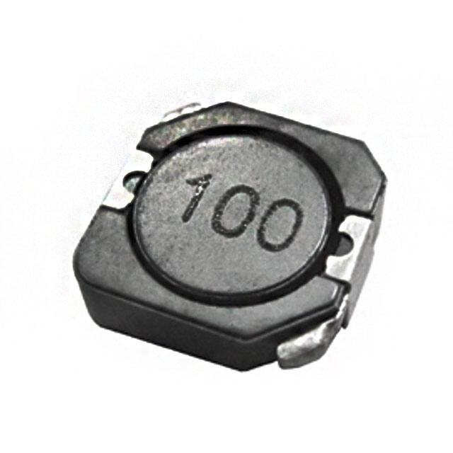

    固定电感器 Nonstandard 680µH ±20% 270mA 1.77Ω 2.1MHz
APSA00070748681M00 数据手册
Automotive Power Inductor APSA Series AEC-Q200 RoHS Compliant Halogen Free REACH Compliant ■ Part Numbering A Grade PSA Series Name 00 Control Code 131358 100 Dimensions Code (mm) 060630 6.3x6.3x3.0 070748 7.3x7.3x4.8 070758 7.3x7.3x5.8 131358 12.5x12.5x5.8 Inductance (uH) 6R0 6.0 100 10 101 100 M 00 Tolerance Internal Code M T ±20% ±30% Automotive Power Inductor APSA Series AEC-Q200 APSA00060630 Type ■ Dimensions ■ Recommended Land Pattern unit:mm unit:mm ■ Electrical Characteristics Part No. APSA000606306R8□00 APSA00060630100□00 APSA00060630150□00 APSA00060630220□00 APSA00060630330□00 APSA00060630470□00 APSA00060630680□00 APSA00060630101□00 APSA00060630151□00 APSA00060630221□00 Inductance Test Freq. SRF RDC (uH ) (MHz)Min (mΩ)Max. 6.8 10 15 22 33 47 68 100 150 220 100 kHz,1 V 100 kHz,1 V 100 kHz,1 V 100 kHz,1 V 100 kHz,1 V 100 kHz,1 V 100 kHz,1 V 100 kHz,1 V 100 kHz,1 V 100 kHz,1 V 35 20 15 10 7 5 4 4 4 3.2 42 63.8 89.4 124 177 252 348 516 780 1170 Isat (A) Irms (A) Tolerance (±%) Marking 1.50 1.30 1.00 0.77 0.69 0.59 0.50 0.42 0.34 0.26 2.20 1.80 1.40 1.30 1.10 0.92 0.78 0.64 0.50 0.38 20 20 20 20 20 20 20 20 20 20 6R8 100 150 220 330 470 680 101 151 221 Note: When ordering, please specify tolerance code. Tolerance: M=±20% / T=±30% 1. Operating temperature range -40℃~125℃(Including self - temperature rise) 2. Isat for Inductance drop 30% from its value without current. 3. Irms for a 25℃ temprature rise from 25℃ ambient. 4. Measure Equipment: L: WK6500B+WK6565 RDC: Chroma 16502 Isat: WK3260B+WK3265B Automotive Power Inductor APSA Series AEC-Q200 APSA00060630 Type ■ Characteristics Graph Inductance vs. Frequency Charateristics 500 221 450 400 350 L(uH) 300 101 250 200 150 680 100 220 50 6R8 0 0.001 0.01 0.1 1 10 100 Frequecny(MHz) Inductance vs. DC Current 240 220 200 221 180 160 L(uH) 140 120 100 101 80 60 680 40 220 20 6R8 0 0 0.2 0.4 0.6 0.8 1 1.2 DC Current(A) 1.4 1.6 1.8 2 2.2 Automotive Power Inductor APSA Series AEC-Q200 APSA00070748 Type ■ Dimensions ■ Recommended Land Pattern unit:mm unit:mm ■ Electrical Characteristics Part No. APSA000707483R3□00 APSA000707484R7□00 APSA000707486R8□00 APSA00070748100□00 APSA00070748150□00 APSA00070748220□00 APSA00070748330□00 APSA00070748470□00 APSA00070748680□00 APSA00070748101□00 APSA00070748151□00 APSA00070748221□00 APSA00070748331□00 APSA00070748471□00 APSA00070748681□00 APSA00070748102□00 Inductance Test Freq. SRF RDC (uH ) (MHz)Min (mΩ)Max. 3.3 4.7 6.8 10 15 22 33 47 68 100 150 220 330 470 680 1000 100 kHz,1 V 100 kHz,1 V 100 kHz,1 V 100 kHz,1 V 100 kHz,1 V 100 kHz,1 V 100 kHz,1 V 100 kHz,1 V 100 kHz,1 V 100 kHz,1 V 100 kHz,1 V 100 kHz,1 V 100 kHz,1 V 100 kHz,1 V 100 kHz,1 V 100 kHz,1 V 90 65 24 17 14 11 10 8.0 7.0 6.0 4.0 3.5 3.0 2.5 2.1 1.1 24 36 40 43.2 62.4 73.2 115 150 210 300 408 624 880 1260 1770 2730 Isat (A) Irms (A) Tolerance (±%) Marking 2.50 2.00 1.70 1.30 1.10 0.90 0.82 0.75 0.60 0.50 0.40 0.33 0.25 0.22 0.20 0.14 2.30 2.10 1.74 1.78 1.53 1.34 1.09 0.92 0.77 0.65 0.55 0.45 0.37 0.31 0.27 0.25 20 20 20 20 20 20 20 20 20 20 20 20 20 20 20 20 3R3 4R7 6R8 100 150 220 330 470 680 101 151 221 331 471 681 102 Note: When ordering, please specify tolerance code. Tolerance: M=±20% / T=±30% 1. Operating temperature range -40℃~125℃(Including self - temperature rise) 2. Isat for Inductance drop 10% from its value without current. 3. Irms for a 20℃ temprature rise from 25℃ ambient. 4. Measure Equipment: L: WK6500B+WK6565 RDC: Chroma 16502 Isat: WK3260B+WK3265B Automotive Power Inductor APSA Series AEC-Q200 APSA00070748 Type ■ Characteristics Graph Inductance vs. Frequency Charateristics 1200 1000 471 L(uH) 800 221 600 400 101 200 470 100 0 0 0 0 1 10 100 Frequecny(MHz) Inductance vs. DC Current 500 400 471 L(uH) 300 200 221 100 101 470 100 0 0 0.5 1 1.5 DC Current(A) 2 2.5 3 Automotive Power Inductor APSA Series AEC-Q200 APSA00070758 Type ■ Dimensions ■ Recommended Land Pattern unit:mm unit:mm ■ Electrical Characteristics Part No. APSA000707581R5□00 APSA000707582R2□00 APSA000707583R3□00 APSA000707584R7□00 APSA000707586R8□00 APSA00070758100□00 APSA00070758150□00 APSA00070758220□00 Inductance Test Freq. SRF RDC (uH ) (MHz)Min (mΩ)Max. 1.5 2.2 3.3 4.7 6.8 10 15 22 100 kHz,1 V 100 kHz,1 V 100 kHz,1 V 100 kHz,1 V 100 kHz,1 V 100 kHz,1 V 100 kHz,1 V 100 kHz,1 V 75 55 48 38 35 22 14 8 20 23 31 36 44 46 60.9 77 Isat (A) Irms (A) Tolerance (±%) Marking 6.2 5.3 4.3 3.6 3.0 2.6 2.1 1.7 4.0 3.5 3.3 3.1 2.8 2.5 2.2 2.0 30 30 30 30 30 20 20 20 1R5 2R2 3R3 4R7 6R8 100 150 220 Note: When ordering, please specify tolerance code. Tolerance: M=±20% / T=±30% 1. Operating temperature range -40℃~125℃(Including self - temperature rise) 2. Isat for Inductance drop 10% from its value without current. 3. Irms for a 30℃ temprature rise from 25℃ ambient. 4. Measure Equipment: L: WK6500B+WK6565 RDC: Chroma 16502 Isat: WK3260B+WK3265B Automotive Power Inductor APSA Series AEC-Q200 APSA00070758 Type ■ Characteristics Graph Inductance vs. Frequency Charateristics 50 45 220 40 35 L(uH) 30 25 100 20 15 6R8 10 4R7 2R2 5 0 0 0 0 1 10 100 Frequecny(MHz) Inductance vs. DC Current 30 25 20 L(uH) 220 15 10 100 6R8 5 4R7 2R2 0 0 1 2 3 4 5 6 DC Current(A) 7 8 9 10 Automotive Power Inductor APSA Series AEC-Q200 APSA00131358 Type ■ Dimensions ■ Recommended Land Pattern unit:mm unit:mm ■ Electrical Characteristics Part No. APSA001313586R0□00 APSA00131358100□00 APSA00131358150□00 APSA00131358220□00 APSA00131358330□00 APSA00131358470□00 APSA00131358680□00 APSA00131358101□00 APSA00131358151□00 APSA00131358221□00 APSA00131358331□00 APSA00131358471□00 APSA00131358681□00 APSA00131358102□00 APSA00131358152□00 Inductance Test Freq. SRF RDC (uH ) (MHz)Min (mΩ)Max. 6.0 10 15 22 33 47 68 100 150 220 330 470 680 1000 1500 1 kHz,1 V 1 kHz,1 V 1 kHz,1 V 1 kHz,1 V 1 kHz,1 V 1 kHz,1 V 1 kHz,1 V 1 kHz,1 V 1 kHz,1 V 1 kHz,1 V 1 kHz,1 V 1 kHz,1 V 1 kHz,1 V 1 kHz,1 V 1 kHz,1 V 26 17 15 11 10 8 7 5.5 4.5 3.0 3.0 2.5 2.0 1.7 1.4 19.7 25.8 31.0 40.6 49.8 74.2 99.8 140 228 324 492 624 912 1344 2076 Isat (A) Irms (A) Tolerance (±%) Marking 3.6 3.4 2.8 2.3 1.9 1.6 1.3 1.1 0.88 0.72 0.59 0.49 0.43 0.34 0.29 4.9 4.3 3.9 3.4 3.1 2.5 2.2 1.8 1.4 1.2 1.0 0.88 0.73 0.60 0.48 30 20 20 20 20 20 20 20 20 20 20 20 20 20 20 6R0 100 150 220 330 470 680 101 151 221 331 471 681 102 152 Note: When ordering, please specify tolerance code. Tolerance: M=±20% / T=±30% 1. Operating temperature range -40℃~125℃(Including self - temperature rise) 2. Isat for Inductance drop 10% from its value without current. 3. Irms for a 30℃ temprature rise from 25℃ ambient. 4. Measure Equipment: L: WK6500B+WK6565 RDC: Chroma 16502 Isat: WK3260B+WK3265B Automotive Power Inductor APSA Series AEC-Q200 APSA00131358 Type ■ Characteristics Graph Inductance vs. Frequency Charateristics 2000 102 1800 1600 471 1400 L(uH) 1200 1000 800 600 400 221 470 200 100 0 0.001 0.01 0.1 1 10 100 Frequecny(MHz) Inductance vs. DC Current 1200 1100 1000 900 102 800 L(uH) 700 600 500 471 400 300 200 221 100 470 100 0 0 0.5 1 1.5 2 2.5 3 3.5 4 4.5 DC Current(A) 5 5.5 6 6.5 7 7.5 8 Automotive Power Inductor APSA Series AEC-Q200 ■ Packaging Tape Dimensions Reel Dimensions Dimensions in mm Tape Dimensions Reel Dimensions Quantity TYPE A0 B0 K0 D E W P P0 P2 A B C D PCS / REEL APSA00060630 6.3 6.55 3.3 1.55 1.75 16 12 4 2 330 100 13 16.0 1000 APSA00070748 7.6 7.6 5.2 1.55 1.75 16 12 4 2 330 100 13 16.0 1000 APSA00070758 7.8 7.8 6.0 1.55 1.75 16 12 4 2 330 100 13 16.0 900 APSA00131358 12.6 12.6 6.7 1.55 1.75 24 16 4 2 330 100 13 24.2 600
