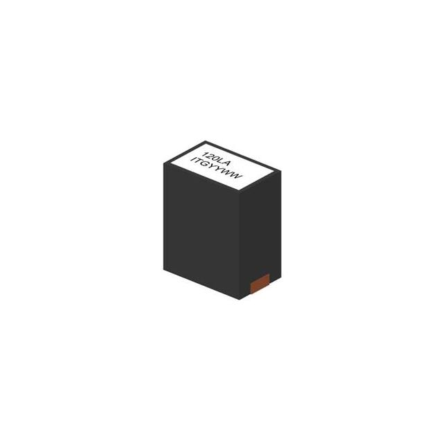

    固定电感器 Nonstandard 70nH ±15% 78A 0.125mΩ
L101247A-70L 数据手册
L101247A Series 1. Features of L101247A Series : • • • • • • • • • Ferrite based SMD inductor with lower core loss. Inductance Range: 70.0nH to 330.0nH, Custom values are welcomed. High current output chokes, up to 180.0 Amp with approx. 20% roll off. Low Profile 12.00 mm Max. height . Foot Print 10.00 x 6.40 mm . Perfect for high density designs with limited board space. Operating frequency up to 5.0 MHz application. Operating Temperature Range -55°C to + 130°C , RoHs & HF compliance . T & R Qtys: 300 pcs , 13'' Reel ; 2. Electrical Characteristic of L101247A Series: ITG Part Number L101247A-70L L101247A-80L L101247A-100L L101247A-110L L101247A-120L L101247A-135L L101247A-150L L101247A-220L L101247A-250L L101247A-300L L101247A-330L OCL 1 (nH) ± 15% 70.00 80.00 100.00 110.00 120.00 135.00 150.00 220.00 250.00 300.00 330.00 L @ Isat1 2 (nH) Min. 49.00 56.00 70.00 77.00 84.00 94.00 105.00 154.00 175.00 210.00 231.00 DCR 3 (mΩ) ± 10% 0.125 0.125 0.125 0.125 0.125 0.125 0.125 0.125 0.125 0.125 0.125 Isat1 4 (A) @25℃ 180.00 155.00 129.00 125.00 107.00 95.00 84.00 68.00 50.00 44.00 36.00 Isat2 4 (A) @75℃ 175.00 143.00 115.00 110.00 97.00 86.00 76.00 62.00 46.00 42.00 33.00 Isat3 4 (A) @100℃ 170.00 137.00 110.00 105.00 92.00 81.00 71.00 56.00 44.00 37.00 30.00 Irms 5 (A) @25℃ 78.00 78.00 78.00 78.00 78.00 78.00 78.00 78.00 78.00 78.00 78.00 3. Mechanical Dimension(Unit : mm): A B C E F G Max. Max. Max. ± 0.30 ± 0.20 ± 0.20 10.00 6.40 12.00 5.00 2.50 2.40 A xxxLx ITGYYWW B 11.00 3.9 3.0x2 Suggested Pad Layout C Part Marking: xxLx: xxx is inductance value in nH, L = tolerance. x is special code ITGYYWW: ITG logo and YYWW is date code. Coplanarity:4mil a b E F G Notes: 1. Open Circuit Inductance (OCL) test condition:500KHz,0.25Vrms,0Adc ,at 25 ℃. 2. L @ Isat and L @ Irms Test condition:500KHz,0.25Vrms (Ta=25 ℃). 3. The nominal DCR is measured from point "a" and "a'" to point "b" and “ b", as shown above on the mechanical drawing (Ta=25℃). 4. Isat1,Isat2 & Isat3: DC current that will cause inductance to drop approximately by 20%. 5. Irms: DC current for an approximate temperature rise of 40℃ without core loss , Derating is necessary for AC currents. PCB pad layout , trace thickness and width , air-flow and proximity of other heat generating components will affect the temperature rise. It is recommended the part temperature not exceed 130 ℃ under worst case operating conditions verified in the end application. ● ● New York 1 914 347 2474 ● Taipei 886 2 2698 8669 ● Kaohsiung 886 7 350 2275 Tokyo 81 568 85 2830 ● Shenzhen 86 755 8418 6263 ● Shanghai 86 21 5424 5141 ● Hong Kong 852 9688 9767 ● sales@ITG-Electronics.com ● www. ITG-Electronics.com Revision A.3: August 24, 2020 *Due to continuous product improvement, all specifications are subject to change without prior notice. Kindly contact an ITG field application engineer or a sales representative prior to purchase. L101247A Series 4. Inductance Characteristics of L101247A Series (Inductance vs Current): L101247A-70L 105.0 L (nH) 25℃ 70.0 75℃ 35.0 100℃ 0.0 0.0 20.0 40.0 60.0 80.0 100.0 120.0 140.0 Direct Current (A) 160.0 180.0 200.0 220.0 L101247A-80L 120.0 L (nH) 25℃ 80.0 75℃ 40.0 100℃ 0.0 0.0 20.0 40.0 60.0 80.0 100.0 Direct Current (A) 120.0 140.0 160.0 180.0 L101247A-100L 150.0 25℃ L (nH) 100.0 75℃ 50.0 100℃ 0.0 0.0 10.0 20.0 30.0 40.0 50.0 60.0 70.0 80.0 Direct Current (A) 90.0 100.0 110.0 120.0 130.0 140.0 L101247A-110L 165.0 25℃ L (nH) 110.0 75℃ 55.0 100℃ 0.0 0.0 ● 10.0 20.0 30.0 40.0 50.0 60.0 70.0 80.0 Direct Current (A) 90.0 100.0 110.0 120.0 130.0 140.0 ● New York 1 914 347 2474 ● Taipei 886 2 2698 8669 ● Kaohsiung 886 7 350 2275 Tokyo 81 568 85 2830 ● Shenzhen 86 755 8418 6263 ● Shanghai 86 21 5424 5141 ● Hong Kong 852 9688 9767 ● sales@ITG-Electronics.com ● www. ITG-Electronics.com Revision A.3: August 24, 2020 *Due to continuous product improvement, all specifications are subject to change without prior notice. Kindly contact an ITG field application engineer or a sales representative prior to purchase. L101247A Series L101247A-120L 180.0 25℃ L (nH) 120.0 75℃ 60.0 100℃ 0.0 0.0 10.0 20.0 30.0 40.0 50.0 60.0 70.0 80.0 Direct Current (A) 90.0 100.0 110.0 120.0 130.0 L101247A-135L 180.0 25℃ L (nH) 135.0 90.0 75℃ 45.0 100℃ 0.0 0.0 10.0 20.0 30.0 40.0 50.0 60.0 Direct Current (A) 70.0 80.0 90.0 100.0 110.0 L101247A-150L 200.0 25℃ L (nH) 150.0 100.0 75℃ 50.0 100℃ 0.0 0.0 5.0 10.0 15.0 20.0 25.0 30.0 35.0 40.0 45.0 50.0 55.0 60.0 65.0 70.0 75.0 80.0 85.0 90.0 Direct Current (A) L101247A-220L 330.0 25℃ L (nH) 220.0 75℃ 110.0 100℃ 0.0 0.0 ● 5.0 10.0 15.0 20.0 25.0 30.0 35.0 40.0 45.0 50.0 55.0 60.0 65.0 70.0 75.0 80.0 Direct Current (A) ● New York 1 914 347 2474 ● Taipei 886 2 2698 8669 ● Kaohsiung 886 7 350 2275 Tokyo 81 568 85 2830 ● Shenzhen 86 755 8418 6263 ● Shanghai 86 21 5424 5141 ● Hong Kong 852 9688 9767 ● sales@ITG-Electronics.com ● www. ITG-Electronics.com Revision A.3: August 24, 2020 *Due to continuous product improvement, all specifications are subject to change without prior notice. Kindly contact an ITG field application engineer or a sales representative prior to purchase. L101247A Series L101247A-250L 300.0 250.0 25℃ L (nH) 200.0 150.0 75℃ 100.0 100℃ 50.0 0.0 0.0 5.0 10.0 15.0 20.0 25.0 30.0 35.0 Direct Current (A) 40.0 45.0 50.0 55.0 60.0 L101247A-300L 400.0 25℃ L (nH) 300.0 200.0 75℃ 100.0 100℃ 0.0 0 5 10 15 20 25 30 Direct Current (A) 35 40 45 50 55 L101247A-330L 440.0 25℃ L (nH) 330.0 220.0 75℃ 110.0 100℃ 0.0 0.0 ● 5.0 10.0 15.0 20.0 25.0 Direct Current (A) 30.0 35.0 40.0 ● New York 1 914 347 2474 ● Taipei 886 2 2698 8669 ● Kaohsiung 886 7 350 2275 Tokyo 81 568 85 2830 ● Shenzhen 86 755 8418 6263 ● Shanghai 86 21 5424 5141 ● Hong Kong 852 9688 9767 ● sales@ITG-Electronics.com ● www. ITG-Electronics.com Revision A.3: August 24, 2020 *Due to continuous product improvement, all specifications are subject to change without prior notice. Kindly contact an ITG field application engineer or a sales representative prior to purchase.
