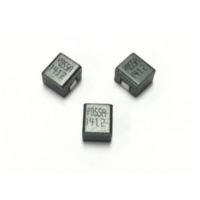

    固定电感器 Nonstandard 55nH ±15% 34A 0.2mΩ
SL2218A-R055LHF 数据手册
SL2218 Series 1. Features of SL2218 Series: • • • • • • • • • Ferrite based SMD inductor with lower core loss. Inductance range: 55.0 nH to 100.0 nH , custom values are welcomed. High current output chokes , up to 63.0 Amp with approx. 20% roll off. Low Profile 4.60 mm max height . 5.50 x 5.70 mm Foot Print. Ideal for Buck Converter, VRM & High Density Board Design. Operating frequency of up to 5.0MHz. Operating temperature range of -55°C to + 130°C, RoHS & HF compliant. T & R Qty’s: 1000pcs, 13'' Reel. 2. Electrical Characteristics of SL2218 Series: OCL 1 L @ Isat1 2 DCR 3 Isat1 4 Isat2 4 Isat3 4 Irms 5 (nH) (nH) (mΩ) (A) (A) (A) (A) ± 15% Min. ± 10.0% @25℃ @75℃ @100℃ @25℃ SL2218A-R055LHF 55.00 39.60 0.20 63.00 56.00 46.00 34.00 SL2218A-R10LHF 100.00 72.00 0.20 33.00 30.00 26.00 34.00 Part Number 3. Mechanical Dimension of SL2218 Series: A B C D E F G (Max.) (Max.) (Max.) (Max.) (Nom.) ± 0.20 ± 0.20 5.70 5.35 4.60 5.50 2.30 2.00 1.50 Notes: 1. Open Circuit Inductance (OCL) test condition: 100KHz, 0.1Vrms, 0A DC at 25Ԩ. 2. L @ Isat and L @ Irms Test condition: 100KHz, 0.1Vrm (Ta=25Ԩ). 3. The nominal DCR is measured from point “a” to point “b” as shown above in the mechanical drawing (Ta=25Ԩ). 4. Isat1 , Isat2 & Isat3 : DC current that will cause inductance to drop approximately by 20%. 5. Irms: DC current for an approximate temperature rise of 40Ԩ without core loss. 6. Derating is necessary for AC currents. PCB pad layout , trace thickness and width , air-flow and proximity of other heat generating components will affect the temperature rise. 7. It is recommended the part temperature not exceed 130°C under worst case operating conditions as verified in the end application. ● ● New York 1 914 347 2474 ● Taipei 886 2 2698 8669 ● Kaohsiung 886 7 350 2275 Japan 81 568 85 2830 ● Shenzhen 86 755 8418 6263 ● Shanghai 86 21 5424 5141 ● Hong Kong 852 9688 9767 ● sales@ITG-Electronics.com ● www.ITG-Electronics.com Revision A.1: April 3, 2018 *Due to continuous product improvement, all specifications are subject to change without prior notice. Kindly contact an ITG field application engineer or a sales representative prior to purchase. SL2218 Series L (nH) 4. Inductance Characteristics of SL2218 Series (Inductance vs Current): SL2218A-R055LHF 64.80 57.60 50.40 43.20 36.00 28.80 21.60 14.40 7.20 0.00 25Ԩ 75Ԩ 100Ԩ 0.0 20.0 40.0 42.0 45.0 47.0 50.0 55.0 57.0 60.0 63.0 66.0 70.0 72.0 73.0 75.0 77.0 Direct Current (A) SL2218A-R10LHF 150.0 25Ԩ L (nH) 100.0 75Ԩ 50.0 100Ԩ 0.0 0.0 ● 5.0 10.0 15.0 20.0 25.0 30.0 Direct Current (A) 35.0 40.0 45.0 ● New York 1 914 347 2474 ● Taipei 886 2 2698 8669 ● Kaohsiung 886 7 350 2275 Japan 81 568 85 2830 ● Shenzhen 86 755 8418 6263 ● Shanghai 86 21 5424 5141 ● Hong Kong 852 9688 9767 ● sales@ITG-Electronics.com ● www.ITG-Electronics.com Revision A.1: April 3, 2018 *Due to continuous product improvement, all specifications are subject to change without prior notice. Kindly contact an ITG field application engineer or a sales representative prior to purchase.
