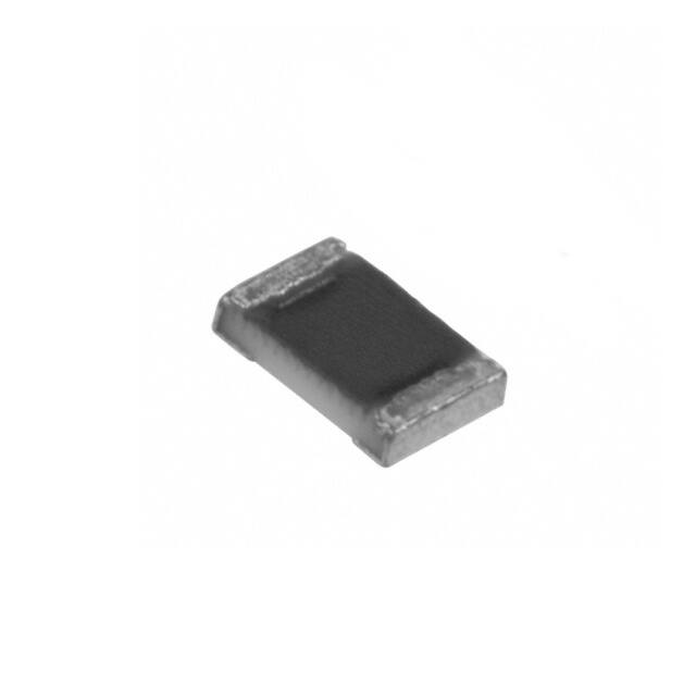

    贴片电阻 2512 30mΩ ±1% 3W ±50ppm/℃
CSM2512FT30L0 数据手册
CSM Series Stackpole Electronics, Inc. Molded Metal Plate Sensing Resistor Resistive Product Solutions Features: • • • • • • • • High power metal alloy current sense resistor Molded package for superior heat dissipation Typical inductance < 5nH Ideal for power supplies and motor drives Package size 2512 is qualified to AEC-Q200 100% RoHS compliant and lead free without exemption Halogen free REACH compliant Electrical Specifications Type / Code Power Rating (W) Maximum Working Voltage (V) CSM0603 0.33 CSM2512 3 P = Rated Power (W) R = Resistance Value (Ω) Maximum Current (A) TCR (ppm/ºC) (P*R) 1/2 5.6 ± 70 Ohmic Range (Ω) and Tolerance 1%, 5% 0.01 (P*R) 1/2 54.8 ± 50 0.001 - 0.1 Mechanical Specifications Type / Code CSM0603 CSM2512 (0.001 Ω - 0.004 Ω) CSM2512 (> 0.004 Ω - 0.1 Ω) L 0.063 1.60 0.252 6.40 0.252 6.40 ± ± ± ± ± ± W 0.004 0.10 0.008 0.20 0.008 0.20 0.031 0.80 0.126 3.20 0.126 3.20 ± ± ± ± ± ± C 0.004 0.10 0.008 0.20 0.008 0.20 0.008 0.20 0.079 2.00 0.035 0.90 ± ± ± ± ± ± H 0.004 0.10 0.008 0.20 0.008 0.20 0.012 0.30 0.028 0.70 0.028 0.70 ± ± ± ± ± ± d 0.004 0.10 0.008 0.20 0.008 0.20 0.012 0.30 0.079 2.00 0.035 0.90 ± ± ± ± ± ± Unit 0.004 0.10 0.008 0.20 0.008 0.20 inches mm inches mm inches mm Performance Characteristics Test Item Temperature Coefficient of Resistance Test Specification CSM2512 ± 50 ppm/ºC CSM0603 ± 100 ppm/ºC Load Life ± 1% Short Time Overload ± 0.5% Moisture No Load ± 0.5% Temperature Cycling < ± 0.5% Resistance to Soldering Heat ± 0.5% At least 95% of surface area of electrode must be covered with new solder Solderability Rev Date: 10/22/2020 This specification may be changed at any time without prior notice. Please confirm technical specifications before you order and/or use. 1 Test Condition +25ºC ~ +125ºC 1000 hours at rated power, 70ºC, 1.5 hours ON, 0.5 hours OFF 5 X rated power for 5 seconds (for 0.04 - 0.1 Ω > rated power x 2.5 for 5 seconds) 85ºC, 85% R.H., 1000 hours 1000 cycles (-55°C to 125°C) Measurement at 24 hours after test conclusion JESD22 Method JA-104 260 ± 5ºC for 20 ± 1 seconds 245 ± 5ºC for 2 ± 0.5 seconds www.seielect.com marketing@seielect.com CSM Series Stackpole Electronics, Inc. Molded Metal Plate Sensing Resistor Resistive Product Solutions Performance Characteristics (cont.) Test Item Test Specification Test Condition High Temperature Exposure ± 0.5% 170ºC for 1000 hours Low Temperature Storage ± 0.5% -55ºC for 1000 hours Substrate Bending ± 1% Bending width 2 mm Insulation Resistance > 100MΩ 100VDC for 1 minute Storage Conditions: Temperature 5°C ~ 35°C; R.H. 40% ~ 75% Operating temperature range for CSM0603 is -55°C to +155°C and for CSM2512 is -55°C to +170°C Power Derating Curve: CSM0603 -55ºC 100 70°C Rated Power (%) 80 60 40 20 0 -60 155°C 0 20 40 60 80 100 120 Ambient Temperature (ºC) 140 160 180 CSM2512 100 -55ºC 70°C Rated Power (%) 80 60 40 20 0 -60 170°C 0 20 Rev Date: 10/22/2020 This specification may be changed at any time without prior notice. Please confirm technical specifications before you order and/or use. 40 60 80 100 120 Ambient Temperature (ºC) 2 140 160 180 www.seielect.com marketing@seielect.com CSM Series Stackpole Electronics, Inc. Molded Metal Plate Sensing Resistor Resistive Product Solutions Terminal Temperature: CSM2512 100 -55 ºC 120°C Rated Power (%) 80 60 40 20 0 -60 175°C 0 20 40 60 80 100 120 Terminal Temperature (ºC) 140 160 180 Recommended Pad Layout Type / Code CSM0603 CSM2512 (≤ 0.004 Ω) CSM2512 (> 0.004 Ω) a b L Unit 0.039 1.00 0.157 4.00 0.157 4.00 0.028 0.70 0.122 3.10 0.083 2.10 0.035 0.90 0.051 1.30 0.161 4.10 inches mm inches mm inches mm Recommended Solder Profile This information is intended as a reference for solder profiles for Stackpole resistive components. These profiles should be compatible with most soldering processes. These are only recommendations. Actual numbers will depend on board density, geometry, packages used, etc., especially those cells labeled with “*”. 100% Matte Tin / RoHS Compliant Terminations Soldering iron recommended temperatures: 330°C to 350°C with minimum duration. Maximum number of reflow cycles: 3. Rev Date: 10/22/2020 This specification may be changed at any time without prior notice. Please confirm technical specifications before you order and/or use. 3 www.seielect.com marketing@seielect.com CSM Series Stackpole Electronics, Inc. Molded Metal Plate Sensing Resistor Resistive Product Solutions Wave Soldering Description Maximum Recommended Minimum Preheat Time 80 seconds 70 seconds Temperature Diff. 140°C 120°C Solder Temp. 260°C 250°C Dwell Time at Max. 10 seconds 5 seconds Ramp DN (°C/sec) N/A N/A Temperature Diff. = Defference between final preheat stage and soldering stage. 60 seconds 100°C 240°C * N/A Convection IR Reflow Description Maximum Recommended Minimum Ramp Up (°C/sec) Dwell Time > 217°C Solder Temp. Dwell Time at Max. Ramp DN (°C/sec) 3°C/sec 150 seconds 260°C 30 seconds 6°C/sec 2°C/sec 90 seconds 245°C 15 seconds 3°C/sec * 60 seconds * 10 seconds * Recommended Lead Free Resistor Reflow Profile Taping Specifications – CSM0603 Type / Code CSM0603 A B W F E Unit 0.075 ± 0.008 1.90 ± 0.20 0.045 ± 0.006 1.15 ± 0.15 0.315 ± 0.008 8.00 ± 0.20 0.138 ± 0.002 3.50 ± 0.05 0.069 ± 0.004 1.75 ± 0.10 inches mm P1 P0 ØD T Unit 0.157 ± 0.004 4.00 ± 0.10 0.157 ± 0.004 4.00 ± 0.10 0.059 +0.004 / -0 1.5 +0.10 / -0 0.031 max. 0.8 max. inches mm Rev Date: 10/22/2020 This specification may be changed at any time without prior notice. Please confirm technical specifications before you order and/or use. 4 www.seielect.com marketing@seielect.com CSM Series Stackpole Electronics, Inc. Molded Metal Plate Sensing Resistor Resistive Product Solutions Taping Specifications – CSM2512 Type / Code A B W F E Unit CSM2512 0.142 ± 0.008 3.60 ± 0.20 P1 0.272 ± 0.008 6.90 ± 0.20 P2 0.472 ± 0.008 12.00 ± 0.20 P0 0.217 ± 0.002 5.50 ± 0.05 D0 0.069 ± 0.004 1.75 ± 0.10 t inches mm Unit 0.157 ± 0.004 4.00 ± 0.10 0.079 ± 0.002 2.00 ± 0.05 0.157 ± 0.002 4.00 ± 0.05 0.059 +0.004 / -0 1.5 +0.10 / -0 0.047 ± 0.006 1.20 ± 0.15 inches mm Packaging Specifications Type / Code CSM0603 CSM2512 A 7.087 180.00 7.087 180.00 ± ± ± ± B 0.059 1.50 0.059 1.50 2.362 60.00 2.362 60.00 ± ± ± ± C 0.039 1.00 0.039 1.00 0.512 13.00 0.512 13.00 ± ± ± ± D 0.008 0.20 0.008 0.20 0.354 9.00 0.606 15.40 + + + + Unit 0.039 1.00 0.079 2.00 inches mm inches mm RoHS Compliance Stackpole Electronics has joined the worldwide effort to reduce the amount of lead in electronic components and to meet the various regulatory requirements now prevalent, such as the European Union’s directive regarding “Restrictions on Hazardous Substances” (RoHS 3). As part of this ongoing program, we periodically update this document with the status regarding the availability of our compliant components. All our standard part numbers are compliant to EU Directive 2011/65/EU of the European Parliament as amended by Directive (EU) 2015/863/EU as regards the list of restricted substances. RoHS Compliance Status Standard Product Series CSM Description Package / Termination Type Standard Series RoHS Compliant Lead-Free Termination Composition Lead-Free Mfg. Effective Date (Std Product Series) Lead-Free Effective Date Code (YY/WW) Molded Metal Plate Sensing Resistor SMD YES 100% Matte Sn over Ni Always Always Rev Date: 10/22/2020 This specification may be changed at any time without prior notice. Please confirm technical specifications before you order and/or use. 5 www.seielect.com marketing@seielect.com CSM Series Stackpole Electronics, Inc. Molded Metal Plate Sensing Resistor Resistive Product Solutions “Conflict Metals” Commitment We at Stackpole Electronics, Inc. are joined with our industry in opposing the use of metals mined in the “conflict region” of the eastern Democratic Republic of the Congo (DRC) in our products. Recognizing that the supply chain for metals used in the electronics industry is very complex, we work closely with our own suppliers to verify to the extent possible that the materials and products we supply do not contain metals sourced from this conflict region. As such, we are in compliance with the requirements of Dodd-Frank Act regarding Conflict Minerals. Compliance to “REACH” We certify that all passive components supplied by Stackpole Electronics, Inc. are SVHC (Substances of Very High Concern) free and compliant with the requirements of EU Directive 1907/2006/EC, “The Registration, Evaluation, Authorization and Restriction of Chemicals”, otherwise referred to as REACH. Contact us for complete list of REACH Substance Candidate List. Environmental Policy It is the policy of Stackpole Electronics, Inc. (SEI) to protect the environment in all localities in which we operate. We continually strive to improve our effect on the environment. We observe all applicable laws and regulations regarding the protection of our environment and all requests related to the environment to which we have agreed. We are committed to the prevention of all forms of pollution. How to Order 1 2 3 4 5 6 7 8 9 10 11 12 13 C S M 2 5 1 2 F T 1 0 L 0 Product Series Size Description Code W Molded Metal Plate 0603 0.33 CSM Sensing Resistor 2512 3 Code Tolerance Code Tol F 1% J 5% Rev Date: 10/22/2020 This specification may be changed at any time without prior notice. Please confirm technical specifications before you order and/or use. Packaging Code Description Size Paper Tape 0603 T Emboss 2512 6 Quantity 5000 4000 Resistance Value Four characters with the multiplier used as the decimal holder. "L" used as multiplier of 10-3 for any value under 0.1 ohm 0.001 = 1L00 0.01 = 10L0 0.1 ohm = R100 www.seielect.com marketing@seielect.com
