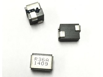

SLM40327A-R47MHF
SLM40327A-R47MHF
    ITG
    SMD,10x7mm
    固定电感器 Nonstandard 475nH ±20% 30A 0.85mΩ
SLM40327A-R47MHF 数据手册
SLM40327 Series 1. Features: · Ferrite based SMD inductor with lower core loss. · Inductance range: 180.0 nH to 1,390.0 nH , custom values are welcomed. · High current output chokes, upto 85.0 Amp with approx. 20% roll off. · Low profile 8.00 mm Max. height. · 10.00 x 7.00 mm Foot Print. · Ideal for Buck Converter, VRM & High Density Board Design. · Operating frequency up to 1.0 MHz. · Operating Temperature Range -55°C to + 130°C. RoHs & HF compliant. · T & R Qtys: 450 pcs ,13'' Reel. 2. Electrical Characteristic of SLM40327 Series: OCL 1 (nH) L @ Isat1 2 (nH) DCR 3 (mΩ) Isat1 4 (A) Isat2 4 (A) Isat3 4 (A) Irms 5 (A) ± 20% Min. ± 5.0% @25℃ @100℃ @100℃ @25℃ SLM40327A-R18KHF 180.00 129.60 0.85 85.00 79.00 75.00 30.00 SLM40327A-R22MHF 220.00 158.40 0.85 70.00 63.00 59.00 30.00 SLM40327A-R28MHF 280.00 201.60 0.85 57.00 52.00 48.00 30.00 SLM40327A-R36KHF 360.00 259.20 0.85 43.00 39.00 36.00 30.00 SLM40327A-R39MHF 405.00 291.60 0.85 38.00 36.00 32.00 30.00 SLM40327A-R47MHF 475.00 342.00 0.85 32.00 30.00 27.00 30.00 SLM40327A-R53MHF 530.00 381.60 0.85 28.00 26.00 24.00 30.00 SLM40327A-R72MHF 728.00 524.16 0.85 20.00 18.00 17.00 30.00 SLM40327A-R82MHF 835.00 601.20 0.85 16.00 14.50 14.00 30.00 SLM40327A-1R0MHF 950.00 684.00 0.85 14.00 13.00 12.50 30.00 SLM40327A-1R4MHF 1390.00 1000.80 0.85 8.00 7.50 7.00 30.00 ITG Part Number D B Marking 3. Mechanical Dimension(Unit:mm): A B C D E F G (Max.) (Max.) (Max.) (Max.) (Nom.) ± 0.20 ± 0.30 7.00 8.70 8.00 10.00 4.75 2.50 2.50 F C a A E b Glue G Bottom View Side View 4.20 2x3.00 Notes: 2x3.15 Suggested Pad Layout 1> Open Circuit Inductance (OCL) test condition: 100KHz, 0.1Vrms, 0Adc at 25℃. 2> L @ Isat and L @ Irms test condition: 100KHz, 0.1Vrms (Ta=25Ԩ). 3> The nominal DCR is measured from point" a " to point" b ", as shown above on the mechanical drawing (Ta=25℃). 4> Isat1,Isat2 & Isat3 : DC current that will cause inductance to drop approximately by 20%. 5> Irms: DC current for an approximate temperature rise of 40℃ without core loss. Derating is necessary for AC currents. PCB pad layout,trace thickness and width,air-flow and proximity of other heat generating components will affect the temperature rise. It is recommended the part temperature not exceed 130°C under worst case operating conditions as verified in the end application. US 1 914 347 2474 ●Taiwan 886 972 022 388 ●Shenzhen 86 755 8418 6263 ●Shanghai 86 21 5424 5141 ●HK 852 9688 9767 Sales@inter-technical.com www.inter-technical.com Rev. C, Aug. 28, 2014 SLM40327 Series 4. Inductance Characteristics (Inductance vs. Current): SLM40327A-R18KHF 208.0 182.0 25Ԩ L (nH) 156.0 130.0 75Ԩ 104.0 78.0 52.0 100Ԩ 26.0 0.0 L (nH) 0.0 20.0 40.0 60.0 70.0 76.0 78.0 79.0 80.0 Direct Current (A) 81.0 82.0 84.0 86.0 88.0 90.0 SLM40327A-R22MHF 245.0 220.5 196.0 171.5 147.0 122.5 98.0 73.5 49.0 24.5 0.0 25Ԩ 75Ԩ 100Ԩ L (nH) 0.0 10.0 20.0 30.0 40.0 50.0 59.0 60.0 62.0 64.0 66.0 68.0 70.0 72.0 74.0 76.0 78.0 80.0 82.0 84.0 Direct Current (A) SLM40327A-R28MHF 313.5 285.0 256.5 228.0 199.5 171.0 142.5 114.0 85.5 57.0 28.5 0.0 25Ԩ 75Ԩ 100Ԩ 0.0 10.0 20.0 30.0 40.0 45.0 48.0 50.0 52.0 54.0 56.0 Direct Current (A) 58.0 60.0 62.0 63.0 64.0 66.0 68.0 L (nH) SLM40327A-R36KHF 390.0 357.5 325.0 292.5 260.0 227.5 195.0 162.5 130.0 97.5 65.0 32.5 0.0 25Ԩ 75Ԩ 100Ԩ 0.0 10.0 20.0 30.0 35.0 38.0 40.0 42.0 Direct Current (A) 44.0 46.0 48.0 50.0 52.0 54.0 US 1 914 347 2474 ●Taiwan 886 972 022 388 ●Shenzhen 86 755 8418 6263 ●Shanghai 86 21 5424 5141 ●HK 852 9688 9767 Sales@inter-technical.com www.inter-technical.com Rev. C, Aug. 28, 2014 SLM40327 Series L (nH) Inductance vs. Current SLM40327A-R39MHF 440.0 400.0 360.0 320.0 280.0 240.0 200.0 160.0 120.0 80.0 40.0 0.0 25Ԩ 75Ԩ 100Ԩ L (nH) 0.0 SLM40327A-R47MHF 522.5 475.0 427.5 380.0 332.5 285.0 237.5 190.0 142.5 95.0 47.5 0.0 25Ԩ 75Ԩ 100Ԩ L (nH) 0.0 5.0 10.0 15.0 20.0 25.0 29.0 30.0 31.0 32.0 33.0 34.0 35.0 36.0 37.0 38.0 39.0 40.0 41.0 42.0 Direct Current (A) SLM40327A-R53MHF 589.5 524.0 458.5 393.0 327.5 262.0 196.5 131.0 65.5 0.0 25Ԩ 75Ԩ 100Ԩ 0.0 L (nH) 5.0 10.0 15.0 20.0 25.0 30.0 35.0 36.0 37.0 38.0 39.0 40.0 41.0 42.0 43.0 44.0 45.0 46.0 47.0 48.0 Direct Current (A) 5.0 10.0 12.0 15.0 20.0 25.0 26.0 27.0 28.0 29.0 30.0 31.0 32.0 33.0 34.0 35.0 36.0 37.0 Direct Current (A) SLM40327A-R72MHF 797.5 725.0 652.5 580.0 507.5 435.0 362.5 290.0 217.5 145.0 72.5 0.0 25Ԩ 75Ԩ 100Ԩ 0.0 5.0 8.0 10.0 12.0 14.0 15.0 16.0 17.0 18.0 19.0 20.0 21.0 22.0 23.0 24.0 25.0 26.0 27.0 28.0 Direct Current (A) US 1 914 347 2474 ●Taiwan 886 972 022 388 ●Shenzhen 86 755 8418 6263 ●Shanghai 86 21 5424 5141 ●HK 852 9688 9767 Sales@inter-technical.com www.inter-technical.com Rev. C, Aug. 28, 2014 SLM40327 Series L (nH) Inductance vs. Current SLM40327A-R82MHF 925.0 832.5 740.0 647.5 555.0 462.5 370.0 277.5 185.0 92.5 0.0 25Ԩ 75Ԩ 100Ԩ 0.0 2.0 4.0 6.0 8.0 10.0 11.0 12.0 13.0 14.0 15.0 16.0 17.0 18.0 19.0 20.0 21.0 22.0 23.0 24.0 25.0 Direct Current (A) SLM40327A-1R0MHF 1000.0 900.0 800.0 700.0 600.0 500.0 400.0 300.0 200.0 100.0 0.0 L (nH) 25Ԩ 75Ԩ 100Ԩ 0.0 2.0 4.0 6.0 7.0 8.0 9.0 10.0 11.0 12.0 13.0 14.0 15.0 Direct Current (A) 16.0 17.0 18.0 19.0 20.0 SLM40327A-1R4MHF 1525.0 1372.5 1220.0 1067.5 915.0 762.5 610.0 457.5 305.0 152.5 0.0 L (nH) 25Ԩ 75Ԩ 100Ԩ 0.0 1.0 2.0 3.0 4.0 5.0 6.0 7.0 Direct Current (A) 8.0 9.0 10.0 11.0 12.0 14.0 US 1 914 347 2474 ●Taiwan 886 972 022 388 ●Shenzhen 86 755 8418 6263 ●Shanghai 86 21 5424 5141 ●HK 852 9688 9767 Sales@inter-technical.com www.inter-technical.com Rev. C, Aug. 28, 2014
