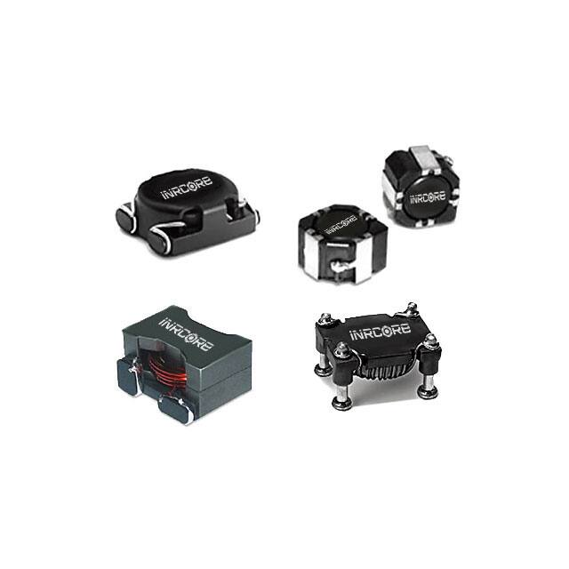

    固定电感器 Nonstandard 472µH ±10% 560mA 1.52Ω
PL8509 数据手册
SMT POWER INDUCTORS Toroid Series Ruggedized Ruggedized header with SLED rails for secure board mounting Current Rating: up to 3.8ADC Inductance Range: 9.4µH to 439µH Moisture Sensitivity Level: 1 Part 9 Number Inductance @ Irated (µH) SLED 25 PL8500 PL8501 PL8502 PL8503 PL8504 PL8505 PL8506 PL8507 PL8508 PL8509 9.4 13.3 23 50 75 90 137 200 305 439 Electrical Spe cifications @ 25°C — Operating Temperature - 40 °C to +130 °C 100 Gauss DCR (mΩ) Inductance ET Irated @ 0ADC ET100 (A ) (V-µsec) TYP MAX (µH ±10%) (V-µsec) 3.80 3.20 2.40 1.60 1.30 1.20 1.00 0.82 0.66 0.56 27 40 65 121 181 246 387 585 845 1322 NOTES: 1. The reference inductance at rated DC current is a typical value. 2. Temperature rise is 50°C in typical buck or boost circuits at 250kHz and with the reference ET applied to the inductor. 3. Total loss in the inductor is 380mW for 50°C temperature rise above ambient. 4. To estimate temperature rise in a given application, determine copper and core losses, divide by 380 and multiply by 50. 5. For the copper loss, calculate IDC2 X RN. 6. For core loss, using frequency (f) and operating flux density (B), calculate 6.11 x 10-18 x B2.7 x f2.04. Mechanical 1 www.inrcore.com 32 46 74 135 220 285 425 673 972 1520 15.2 18.8 24.3 37.0 44.3 49.2 59.4 71.3 85.8 99.6 10.4 14.6 25 56 83 100 152 220 331 472 2.65 3.13 4.10 6.15 7.47 8.19 10.12 12.17 14.94 17.83 1 Amp DC H1 (Orsted) 11.95 14.12 18.46 27.69 33.67 36.93 45.61 54.85 67.34 80.37 7. For flux density (B), calculate ET (V-µsec) for the application, divide by ET100 from the table, and multiply by 100. 8. Limit the DC bias (H) to 46 orsteds. Calculate H by multiplying H1 from the table by IDC of the application. 9. Optional Tape & Reel packaging can be ordered by adding a "T" suffix to the part number (i.e. PL8500 becomes PL8500T). Electrical Schematic M113.E (07/20) SMT POWER INDUCTORS Toroid Series Ruggedized For More Information Global Sales Representatives and Lo cations: http://www.inrcore.com iNRCORE,LLC 311 Sinclair Road Bristol, PA 19007-6812 U.S.A Tel: + 1.215.781.6400 Fax: +1.215.7816430 Performance warranty of products offered on this data sheet is limited to the parameters specified. Data is subject to change without notice. Other brand and product names mentioned herein may be trademarks or registered trademarks of their respective owners. © Copyright, 2020. iNRCORE, LLC. All rights reserved. 2 www.inrcore.com M113.E (07/20)
PL8509
物料型号为INRCORE系列,器件简介为SMT功率电感器,具有加固的引脚和SLED导轨,用于安全地固定在电路板上。
