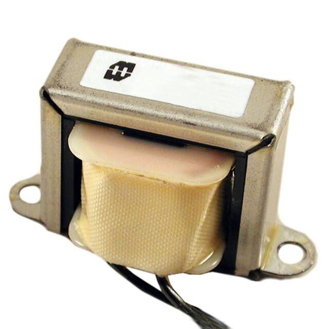

    固定电感器 Nonstandard 9H ±15% 40mA 700Ω
154G 数据手册
Chokes D.C. Filter (153-159 Series) OPEN BRACKET D.C. FILTER CHOKES • Economical "open bracket" - channel mount. • Tolerance of 15% on both inductance & resistance. • Inductances measured at rated D.C. current. • Minimum 5" long leads. • Units will exhibit less inductance at slightly higher currents or more at lower currents. • Perfect for high voltage power supply filtering. Part No. Inductance Henrys 153E 153H 153L 153M 154E 154G 154H 154M 155C 155G 155H 155J 156C 156G 156L 156M 156R 157G 157J 157L 157M 157Q 157R 158L 158M 158Q 158S 158T 159M 159P 159Q 159S 159T 159V 159Y 154B 155B 156B 157D 159ZA 159ZC 159ZE 159ZG 159ZJ 159ZL 7 2.2 0.9 0.6 20 9 4 2 60 7 5 15 150 9 5 3 1.5 30 10 14 8 3.5 2 15 10 5 1.5 1 15 10 7 4 2.5 1.5 0.6 3mH 6mH 1.5mH 1mH 300mH 60mH 28mH 15mH 10mH 2.5mH D.C. Current (ma.) 25 50 75 100 20 40 50 100 8 40 50 30 8 40 75 100 200 40 65 75 100 150 200 75 100 150 250 300 100 125 150 225 300 500 750 1.5A 2A 5A 10A 1A 2A 3A 4A 5A 10A Resistance (Ohms) 770 305 125 86 1666 700 300 175 2750 340 270 1026 3700 300 135 86 56 595 205 429 259 98 57 411 262 105 60 40 256 155 100 65 43 27 11 0.14 0.3 0.07 0.038 6.0 0.7 0.43 0.25 0.16 0.044 Max. Oper. Volts (D.C.) 300 300 300 300 300 300 300 300 400 400 400 400 400 400 400 400 400 400 400 400 400 400 400 400 400 400 400 400 500 500 500 500 500 500 500 300 400 400 400 500 500 500 500 500 500 Wt. Lbs. Dim. Ref. .10 .10 .10 .10 .25 .25 .25 .25 .30 .30 .30 .30 .50 .50 .50 .50 .50 1.0 1.0 1.0 1.0 1.0 1.0 1.25 1.25 1.25 1.50 1.50 2.25 2.25 2.25 2.25 2.25 2.25 2.25 .25 .30 .50 1.0 2.50 2.50 2.75 2.75 2.75 2.75 C1H C1H C1H C1H C2H C2H C2H C2H C4H C4H C4H C4H C6H C6H C6H C6H C6H C9H C9H C9H C9H C9H C9H C10H C10H C10H C10H C10H C14H C14H C14H C14H C14H C14H C14H C2H C4H C6H C9H C14H C14H C14H C14H C14H C14H Dimension Table A B C D C1H C2H C4H C6H C9H C10H C14H 1.63 2.06 2.38 2.81 3.25 3.25 4.03 0.88 1.25 1.38 1.50 1.75 2.00 2.25 0.81 1.19 1.38 1.69 2.00 2.00 2.63 1.38 1.75 2.00 2.38 2.81 2.81 3.56 CANADA © Mtg. Hole 0.125 0.187 0.187 0.187 0.187 0.187 0.187 EUROPE Guelph, Ontario (519) 822-2960 St. Laurent, Quebec (514) 343-9010 www.hammondmfg.com Cheektowaga, NY (716) 630-7030 46 USA Dimensions (Inches) Mtg. Style Basingstoke, UK 01256 812812 AUSTRALIA Queenstown, Australia 61-8-8240-2244

物料型号:文档列出了多个型号的直流滤波器电感器,例如153E、153H、153L等,每个型号都有其特定的电感值、直流电流容量、电阻、最大操作电压、重量和尺寸参考。
器件简介:这些电感器是经济实惠的“开放式支架”设计,适用于直流电源滤波。它们的电感值在额定直流电流下测量,并且具有15%的公差。电感值会随着电流的增加而减少,或在电流较低时增加。
引脚分配:文档中没有明确提到引脚分配,但提到了最小5英寸长的引线。
参数特性:每个型号的电感器都有其特定的参数,如电感值、直流电流容量、电阻和最大操作电压。
功能详解:电感器适用于高电压电源滤波,能够在不同的电流下调整其电感值,以适应不同的电源需求。
应用信息:虽然文档没有详细说明具体的应用场景,但通常直流滤波器电感器用于电源电路中,以减少噪声和干扰。
封装信息:文档提供了不同型号电感器的封装尺寸和安装孔的详细信息,如C1H、C2H、C4H等,每个封装都有其特定的尺寸和安装孔直径。
