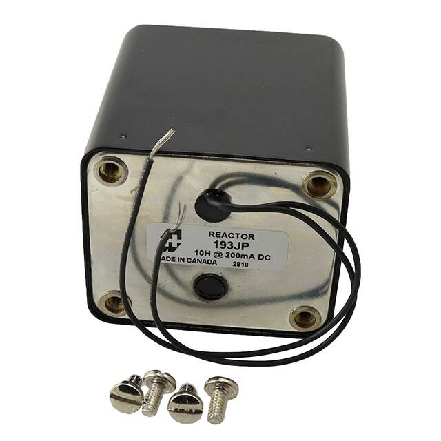

    固定电感器 Nonstandard 10H ±15% 200mA 79Ω
193JP 数据手册
Enclosed & Potted D.C. Filter (193 Series) Chokes B A DA TE 19 xH en 3P rys , Mad e in xxx Ca mA na da C Potted Enclosed ENCLOSED & POTTED D.C. FILTER CHOKES • Enclosed, 4-hole chassis mount chokes (some models also available epoxy potted in a black powder paint - drawn steel cabinet - see chart). Potted models mount with 1/4" - 20 hardware (included). • Tolerance of 15% on both inductance & resistance. Inductances measured at rated D.C. current. • Minimum 8" long leads. • Units will exhibit less inductance at slightly higher currents or more at lower currents. • Perfect for high voltage power supply filtering, case matches power transformers & tube audio output transformers. Part No. Style Inductance Current Resistance (Henrys) (D.C. ma.) (Ohms) 193B 193C 193CP 193D 193G 193GP 193H 193J 193JP 193K 193L 193LP 193M 193MP 193N 193NP 193P 193Q 193R 193S 193T 193U 193V Enclosed Enclosed Potted Enclosed Enclosed Potted Enclosed Enclosed Potted Enclosed Enclosed Potted Enclosed Potted Enclosed Potted Enclosed Enclosed Enclosed Enclosed Enclosed Enclosed Enclosed 12 20 20 8 10 10 5 10 10 2.6 5 5 10 10 3 3 5 10 0.3 1 0.05 0.2 0.15 100 100 100 150 150 150 200 200 200 300 300 300 300 300 500 500 500 500 1000 1000 2000 2000 3000 155 181 184 75 102 103 65 82 79 21 57 55 63 63 35 36 26 53 3.50 5.75 0.7 1.7 1.0 Max. Wt. Dim. Operating Lbs. Ref. (Volts D.C.) 600 2.5 X6 600 3.25 X8 800 5.0 P1 600 3.25 X8 800 4.25 X17 800 6.0 P1 600 2.5 X6 800 5.5 X11 800 7.5 P1 800 3.25 X8 800 5.5 X11 800 7.5 P1 800 10.5 X14 800 10.5 P1 600 5.0 X11 800 7.0 P1 800 10.75 X14 1000 21.0 X16 1000 4.5 X10 1000 8.0 X13 300 2.5 X6 300 6.0 X12 300 9.0 X14 EUROPE Basingstoke, UK 01256 812812 AUSTRALIA Queenstown, Australia 61-8-8240-2244 Dimension Table Mtg. Style P1 X6 X8 X10 X11 X12 X13 X14 X16 X17 A 3.31 2.50 2.50 3.13 3.13 3.13 3.75 3.75 3.75 3.13 Dimensions (Inches) B C D E 3.88 4.25 2.75 3.06 2.00 1.69 3.25 3.06 2.00 2.19 3.50 3.81 2.50 2.19 3.75 3.81 2.50 2.44 4.25 3.81 2.50 2.94 4.00 4.56 3.00 2.81 4.50 4.56 3.00 3.31 5.50 4.56 3.00 4.31 3.25 3.81 2.50 1.94 G-Mtg. Slot .203 X .38 .203 X .38 .203 X .38 .203 X .38 .203 X .38 .203 X .38 .203 X .38 .203 X .38 .203 X .38 CANADA www.hammondmfg.com Guelph, Ontario (519) 822-2960 St. Laurent, Quebec (514) 343-9010 47 Cheektowaga, NY (716) 630-7030 USA ©

器件简介:这些是用于直流电源滤波的电感器,有封装和罐装两种类型,适用于高电压电源滤波,与电源变压器和电子管音频输出变压器的外壳相匹配。
引脚分配:封装型号为4孔安装,罐装型号使用1/4"-20的硬件安装。
参数特性: - 容差:电感和电阻的容差均为15%。 - 电感测量:在额定直流电流下测量。 - 引脚长度:最小8英寸。 - 电感变化:在稍高的电流下电感会降低,在较低的电流下会增加。
功能详解:这些电感器适用于高电压电源滤波,可以减少电源噪声和干扰。
应用信息:适用于电源滤波,特别是与电源变压器和电子管音频输出变压器配合使用。
封装信息:提供了不同安装尺寸的详细尺寸表,包括安装孔的尺寸和电感器的物理尺寸。
