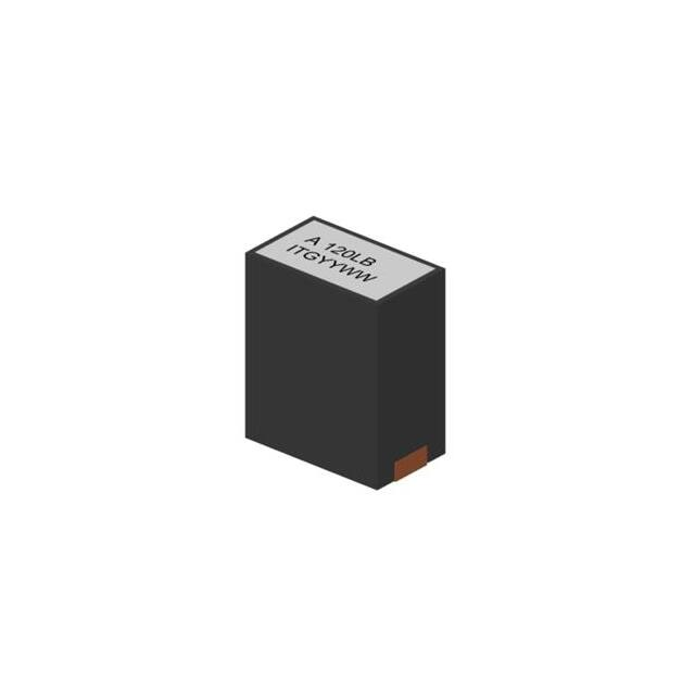

    固定电感器 Nonstandard 90nH ±15% 77A 0.125mΩ
SLA40476B-90L 数据手册
SLA40476B Series 1. Features of SLA40476B Series : • • • • • • • • • Ferrite based SMD inductor with lower core loss. Inductance Range: 70.0nH to 580.0nH, Custom values are welcomed. High current output chokes, up to 170.0 Amp with approx. 20% roll off. Low Profile 12.00 mm Max. height . Foot Print 10.00 x 6.00 mm . Perfect for high density designs with limited board space. Operating frequency up to 5.0 MHz application. Operating Temperature Range -55°C to + 130°C , RoHs & HF compliance . T & R Qtys: 300 pcs , 13'' Reel ; 2. Electrical Characteristic of SLA40476B Series: ITG Part Number OCL 1 (nH) ± 15% L @ Isat1 2 (nH) Min. DCR 3 (mΩ) ± 10% Isat1 4 (A) @25℃ Isat2 4 (A) @75℃ Isat3 4 (A) @100℃ Irms 5 (A) @25℃ SLA40476B-70L 70.00 49.00 0.125 170.00 155.00 145.00 77.00 SLA40476B-80L 80.00 56.00 0.125 150.00 135.00 130.00 77.00 SLA40476B-90L 90.00 63.00 0.125 130.00 120.00 110.00 77.00 SLA40476B-100L 100.00 70.00 0.125 125.00 110.00 105.00 77.00 SLA40476B-120L 120.00 84.00 0.125 105.00 93.00 88.00 77.00 SLA40476B-150L 150.00 105.00 0.125 83.00 75.00 70.00 77.00 SLA40476B-220L 220.00 154.00 0.125 60.00 54.00 50.00 77.00 SLA40476B-300L 300.00 210.00 0.125 41.00 38.00 35.00 77.00 SLA40476B-330L 330.00 231.00 0.125 40.00 35.00 32.00 77.00 SLA40476B-470L 470.00 329.00 0.125 27.00 24.00 22.00 77.00 SLA40476B-580L 580.00 406.00 0.125 18.00 17.00 15.00 77.00 3. Mechanical Dimension(Unit : mm): 11.00 A A Max. B Max. C Max. E ± 0.30 F ± 0.20 3.9 G A 120LB ITGYYWW ± 0.20 3.0x2 B Suggested Pad Layout 10.00 6.00 12.00 5.00 2.40 2.40 10.50 3.9 C 3.3x2 Coplanarity:0.1mm Max. a Notes: b E F Optional Pad Layout G 1. Open Circuit Inductance (OCL) test condition:500KHz,0.25Vrms,0Adc ,at 25 ℃. 2. L @ Isat and L @ Irms Test condition:500KHz,0.25Vrms (Ta=25 ℃). 3. The nominal DCR is measured from point "a" to point "b", as shown above on the mechanical drawing (Ta=25℃). 4. Isat1,Isat2 & Isat3 : DC current that will cause inductance to drop approximately by 20%. 5. Irms: DC current for an approximate temperature rise of 40℃ without core loss , Derating is necessary for AC currents. PCB pad layout , trace thickness and width , air-flow and proximity of other heat generating components will affect the temperature rise. It is recommended the part temperature not exceed 130 ℃ under worst case operating conditions verified in the end application. ● ● New York 1 914 347 2474 ● Taipei 886 2 2698 8669 ● Kaohsiung 886 7 350 2275 Japan 81 568 85 2830 ● Shenzhen 86 755 8418 6263 ● Shanghai 86 21 5424 5141 ● Hong Kong 852 9688 9767 ● sales@ITG-Electronics.com ● www. ITG-Electronics.com Revision A.5: August 21, 2020 *Due to continuous product improvement, all specifications are subject to change without prior notice. Kindly contact an ITG field application engineer or a sales representative prior to purchase. SLA40476B Series 4. Inductance Characteristics (Inductance vs. Current): SLA40476B-70L 105.0 L (nH) 25℃ 70.0 75℃ 35.0 100℃ 0.0 0.0 20.0 40.0 60.0 80.0 100.0 120.0 Direct Current (A) 140.0 160.0 180.0 200.0 SLA40476B-80L 100.0 L (nH) 80.0 25℃ 60.0 75℃ 40.0 100℃ 20.0 0.0 0.0 10.0 20.0 30.0 40.0 50.0 60.0 70.0 80.0 90.0 100.0110.0120.0130.0140.0150.0160.0170.0180.0 Direct Current (A) SLA40476B-90L L (nH) 120.0 90.0 25℃ 60.0 75℃ 30.0 100℃ 0.0 0.0 10.0 20.0 30.0 40.0 50.0 60.0 70.0 80.0 90.0 100.0 110.0 120.0 130.0 140.0 150.0 160.0 Direct Current (A) SLA40476B-100L 120.0 L (nH) 100.0 25℃ 80.0 60.0 75℃ 40.0 100℃ 20.0 0.0 0.0 ● 10.0 20.0 30.0 40.0 50.0 60.0 70.0 80.0 Direct Current (A) 90.0 100.0 110.0 120.0 130.0 140.0 ● New York 1 914 347 2474 ● Taipei 886 2 2698 8669 ● Kaohsiung 886 7 350 2275 Japan 81 568 85 2830 ● Shenzhen 86 755 8418 6263 ● Shanghai 86 21 5424 5141 ● Hong Kong 852 9688 9767 ● sales@ITG-Electronics.com ● www. ITG-Electronics.com Revision A.5: August 21, 2020 *Due to continuous product improvement, all specifications are subject to change without prior notice. Kindly contact an ITG field application engineer or a sales representative prior to purchase. SLA40476B Series SLA40476B-120L 150.0 L (nH) 120.0 25℃ 90.0 75℃ 60.0 100℃ 30.0 0.0 0.0 10.0 20.0 30.0 40.0 50.0 60.0 70.0 Direct Current (A) 80.0 90.0 100.0 110.0 120.0 SLA40476B-150L 180.0 L (nH) 150.0 25℃ 120.0 75℃ 90.0 60.0 100℃ 30.0 0.0 0.0 10.0 20.0 30.0 40.0 50.0 Direct Current (A) 60.0 70.0 80.0 90.0 SLA40476B-220L 330.0 L (nH) 25℃ 220.0 75℃ 110.0 100℃ 0.0 0.0 10.0 20.0 30.0 60.0 70.0 80.0 90.0 SLA40476B-300L 400.0 L (nH) 40.0 50.0 Direct Current (A) 300.0 25℃ 200.0 75℃ 100.0 100℃ 0.0 0.0 ● 5.0 10.0 15.0 20.0 25.0 Direct Current (A) 30.0 35.0 40.0 45.0 ● New York 1 914 347 2474 ● Taipei 886 2 2698 8669 ● Kaohsiung 886 7 350 2275 Japan 81 568 85 2830 ● Shenzhen 86 755 8418 6263 ● Shanghai 86 21 5424 5141 ● Hong Kong 852 9688 9767 ● sales@ITG-Electronics.com ● www. ITG-Electronics.com Revision A.5: August 21, 2020 *Due to continuous product improvement, all specifications are subject to change without prior notice. Kindly contact an ITG field application engineer or a sales representative prior to purchase. SLA40476B Series SLA40476B-330L L (nH) 440.0 330.0 25℃ 220.0 75℃ 110.0 100℃ 0.0 0.0 5.0 10.0 15.0 20.0 25.0 Direct Current (A) 30.0 35.0 40.0 45.0 SLA40476B-470L 540.0 L (nH) 450.0 25℃ 360.0 270.0 75℃ 180.0 100℃ 90.0 0.0 0.0 5.0 10.0 15.0 Direct Current (A) 20.0 25.0 30.0 SLA40476B-580L 725.0 L (nH) 580.0 25℃ 435.0 75℃ 290.0 100℃ 145.0 0.0 0.0 ● 2.0 4.0 6.0 8.0 10.0 12.0 Direct Current (A) 14.0 16.0 18.0 20.0 22.0 ● New York 1 914 347 2474 ● Taipei 886 2 2698 8669 ● Kaohsiung 886 7 350 2275 Japan 81 568 85 2830 ● Shenzhen 86 755 8418 6263 ● Shanghai 86 21 5424 5141 ● Hong Kong 852 9688 9767 ● sales@ITG-Electronics.com ● www. ITG-Electronics.com Revision A.5: August 21, 2020 *Due to continuous product improvement, all specifications are subject to change without prior notice. Kindly contact an ITG field application engineer or a sales representative prior to purchase.
