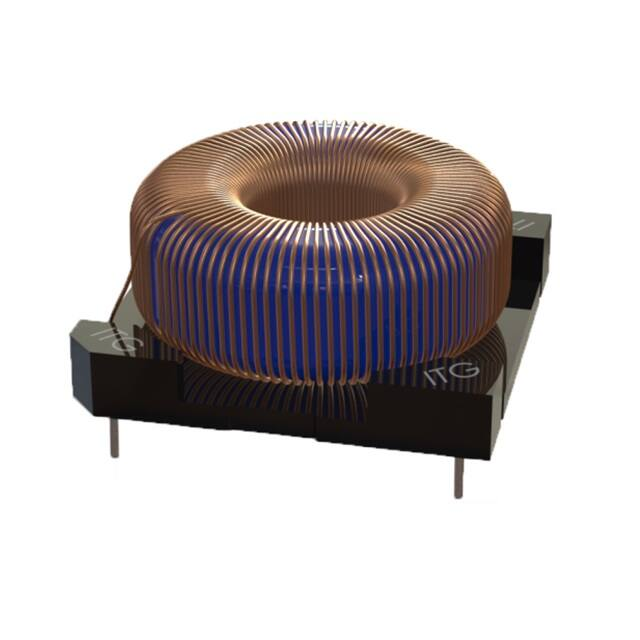

    固定电感器 Radial, Horizontal 7mH ±10% 1.9A 1.1Ω
L301308-702K 数据手册
L301307 Series 1. Features of L301307 Series : • • • • • • • • • Sendust core is used to realize lower core loss. No thermal aging concerns. Low leakage magnetic flux. Elimination for impulse (EMI) noise. Ideally used as Power Factor Correction choke. Also can be used as boost inductor in power supplies. Inductance Range: 1.8mH to 7.0 mH , custom values are welcomed. Foot Print 43.9×43.9mm max. , 28.0mm max. Height. Operating Temperature Range: -55°C to + 130°C; RoHs & HF compliance. 2. Electrical Characteristics of L301307 Series: OCL(PIN1-3) 1 DCR Isat 2 L@Isat Irms 3 L@Irms Dim. D (mH) (mΩ) (A) (mH) (A) (mH) (mm) ± 10% Max. @25℃ @25℃ @25℃ @25℃ @25℃ Max. L301307-182K 1.80 125.00 1.50 1.218 4.00 0.484 28.00 L301307-222K 2.20 165.00 1.30 1.502 3.50 0.601 27.00 L301307-332K 3.30 240.00 1.10 2.223 3.00 0.869 26.00 L301307-452K 4.50 350.00 0.92 2.962 2.40 1.246 25.00 L301307-542K 5.40 480.00 0.90 3.476 2.10 1.558 25.00 L301307-702K 7.00 650.00 0.70 4.796 1.80 2.081 25.00 ITG Part Number 3. Mechanical Dimension of L301307 Series (Unit:mm): A B C D E1 E2 F ±0.4 ±0.4 ±1.0 ±0.4 ±0.4 ±0.1 43.50 43.50 5.00 Max. See table above 30.00 30.00 Φ1.20 A 4 3 Glue B 1 2 Top View D C F 1 2 Front View 43.9 4 1.6* ¦Õ 6.95 Marking 1 2 4 3 E1 4 3 1 2 43.9 30.0 6.95 E2 Bottom View 6.95 30.0 6.95 Suggested PCB Layout Notes: 1. Open Circuit Inductance (OCL) and L@Irms and L@Isat are measured at 10KHz,0.25V@ 25ºC. 2. Isat: DC current that causes inductance to drop by approximately 35% from OCL (Ta=25℃). 3. Irms: DC current that causes an approximate temperature rise (△T) of 40℃ (Ta=25ºC). ● ● New York 1 914 347 2474 ● Taipei 886 2 2698 8669 ● Kaohsiung 886 7 350 2275 Japan 81 568 85 2830 ● Shenzhen 86 755 8418 6263 ● Shanghai 86 21 5424 5141 ● Hong Kong 852 9688 9767 ● sales@ITG-Electronics.com ● www.ITG-Electronics.com Revision A.0: June 13, 2019 *Due to continuous product improvement, all specifications are subject to change without prior notice. Kindly contact an ITG field application engineer or a sales representative prior to purchase. L301307 Series 4. Inductance vs. Current vs. Temperature Rise Characteristics of L301307 Series : L301307-222K 100 1.44 80 1.76 80 1.08 60 1.32 60 0.72 40 0.88 40 0.36 20 0.44 20 0 0.00 0.00 0.0 0.5 1.0 1.5 2.0 2.5 3.0 3.5 4.0 4.5 DC Bias (A) L301307-452K 4.50 100 2.64 80 3.60 80 1.98 60 2.70 60 1.32 40 1.80 40 0.66 20 0.90 20 0 0.00 0.00 △T(℃) 100 L(mH) 3.30 △T(℃) 0 0.0 0.4 0.8 1.2 1.6 2.0 2.4 2.8 3.2 3.6 4.0 0.0 0.3 0.6 0.9 1.2 1.5 1.8 2.1 2.4 2.7 3.0 DC Bias (A) DC Bias (A) L301307-702K L301307-542K 7.00 100 4.32 80 5.60 80 3.24 60 4.20 60 2.16 40 2.80 40 1.08 20 1.40 20 0 0.00 0.00 0.0 0.3 0.6 0.9 1.2 1.5 1.8 2.1 2.4 2.7 DC Bias (A) L(mH) 100 △T(℃) 5.40 △T(℃) L(mH) L301307-332K L(mH) 0 0.0 0.5 1.0 1.5 2.0 2.5 3.0 3.5 4.0 4.5 DC Bias (A) ● △T(℃) 2.20 L(mH) 100 △T(℃) L(mH) L301307-182K 1.80 0 0.0 0.3 0.6 0.9 1.2 1.5 1.8 2.1 2.4 DC Bias (A) ● New York 1 914 347 2474 ● Taipei 886 2 2698 8669 ● Kaohsiung 886 7 350 2275 Japan 81 568 85 2830 ● Shenzhen 86 755 8418 6263 ● Shanghai 86 21 5424 5141 ● Hong Kong 852 9688 9767 ● sales@ITG-Electronics.com ● www.ITG-Electronics.com Revision A.0: June 13, 2019 *Due to continuous product improvement, all specifications are subject to change without prior notice. Kindly contact an ITG field application engineer or a sales representative prior to purchase.
