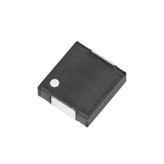

    固定电感器 Nonstandard 6.8µH ±20% 2A 120mΩ
MPIA4040R3-6R8-R 数据手册
Technical Data 10230 Effective August 2014 MPIA4040 Automotive Grade High Current, High Frequency, Miniature Power Inductors Applications: • Body electronics - Central body control module - Vehicle access control system - Headlamps, tail lamps and interior lighting - Door control l e i t v i t n c u e r f f o E 6 , 1 d 0 t e 2 n . u , e d n i 5 e t m t 1 n e e r l o c e p c a l b e s i p e D tem is d r p ory ded e S t n n e e inv omm V1 c e 0 R IA4 MP Pb HF • Advanced driver assistance systems - 77GHz radar systems - Automatic parking control - Collision avoidance system - Basic and smart surround, and rear and front view camera - Adaptive Cruise Control (ACC) - Car black box system Product description: • AEC-Q200 Grade 3 qualified • Handles high transient inrush current spikes • Magnetically shielded • Frequency range 20kHz to 10MHz • Inductance range from 0.09µH to 22µH • Current range from 1.1A to 32.0A • 4.7 x 4.31 footprint surface mount package in 1.2, 1.5, 1.85 or 2.0mm heights • Rugged construction • Halogen free, lead free, RoHS compliant • Infotainment and cluster electronics - Active noise cancellation (ANC) - Audio subsystem: head unit and trunk amp - Digital instrument cluster - In-vehicle infotainment (IVI) and navigation - Port power/USB hub for front and rear passengers • Chassis and safety electronics - Airbag control unit Environmental data: • Storage temperature range (component): -55°C to +125°C • Operating temperature range: -55°C to +125°C (ambient plus self temperature rise) • Solder reflow temperature: J-STD-020D compliant HALOGEN FREE Technical Data 10230 MPIA4040 Automotive Grade High Current, High Frequency Miniature Power Inductors Effective August 2014 Product specifications OCL1 ± 20% (µH) Part Marking Designator Irms2 (Amps) MPIA4040R1-R10-R 0.09 A 8.00 MPIA4040R1-R15-R 0.15 B MPIA4040R1-R22-R 0.23 MPIA4040R1-R33-R Isat3 @ 25°C (Amps) DCR (mΩ) ± 20% @ 20°C K-factor4 32.0† 8.50 1401 7.00 26.0† 11.0 989 C 5.50 21.0 18.0 814 0.33 D 4.40 17.0 28.0 659 MPIA4040R1-R47-R 0.47 E 5.20 11.5 20.0 1295 MPIA4040R1-R68-R 0.68 F 3.30 9.00 51.0 461 MPIA4040R1-1R0-R 1.0 G 3.70 7.70 40.0 990 MPIA4040R1-1R5-R 1.5 H 3.00 6.50 60.0 732 MPIA4040R1-2R2-R 2.2 I 2.60 5.90 80.0 623 MPIA4040R1-3R3-R 3.3 J 2.20 5.10 115 481 Part Number 5 R1 -- 1.2mm Height l e i t v i t n c u e r f f o E 6 , 1 d 0 t e 2 n . u , e d n i 5 e t m t 1 n e e r l o c e p c a l b e s i p e D tem is d r p ory ded e S t n n e e inv omm V1 c e 0 R IA4 MP MPIA4040R1-4R7-R 4.7 K 1.80 3.80 180 411 MPIA4040R1-6R8-R†† 6.8 L 1.50 3.20 250 344 MPIA4040R1-100-R†† 10.0 M 1.20 2.80 370 276 R2 -- 1.5mm Height MPIA4040R2-R47-R 0.47 A 6.40 12.2 13.0 1403 MPIA4040R2-1R0-R 1.0 B 4.60 8.90 25.0 935 MPIA4040R2-1R5-R 1.5 C 3.80 7.60 37.0 701 MPIA4040R2-2R2-R 2.2 D 3.20 5.70 58.0 647 MPIA4040R2-3R3-R 3.3 E 2.60 5.40 76.0 495 MPIA4040R2-4R7-R 4.7 F 2.20 4.30 105 421 MPIA4040R2-6R8-R 6.8 G 1.80 3.40 158 351 MPIA4040R2-100-R 10.0 H 1.50 3.10 240 271 †† 1 Open Circuit Inductance (OCL) Test Parameters: 100kHz, 0.10Vrms, 0.0Adc 2 Irms: DC current for an approximate temperature rise of 40°C without core loss. De-rating is necessary for AC currents. Temperature rise is dependent upon several factors, including the PCB pad layout, trace thickness and width, air-flow and proximity to other heat generating components. It is recommended the part temperature not exceed 125°C under worst case operating conditions and therefore, the temperature rise should be verified in the end use application. Irms testing was performed on a 19.05mm long x 6.35mm wide x 0.070mm thick copper trace in still air. 3 Isat: Peak current for approximately 30% rolloff at +25°C. 2 www.eaton.com/elx 4 K-factor: Used to determine Bp-p for core loss (see graph). Bp-p = K * L * DI. Bp-p : (Gauss), K: (K-factor from table), L: (inductance in µH), DI (peak-to-peak ripple current in amps). 5 Part Number Definition: MPIA4040RX-XXX-R • MPIA4040X = product code and size • XXX = inductance value in all, “R” = decimal point - If no “R” is present, then third digit equals the number of zeros • “-R” suffix = RoHS compliant † Transient pulse not to exceed 1 millisecond. †† Maximum operating frequency less than 10MHz, consult factory for application specific values. Technical Data 10230 MPIA4040 Automotive Grade High Current, High Frequency Miniature Power Inductors Effective August 2014 OCL1 ± 20% (µH) Part Marking Designator Isat3 @ 25°C (Amps) DCR (mΩ) ± 20% @ 20°C K-factor4 MPIA4040R3-R22-R 0.22 A 8.00 20.0 5.8 1870 MPIA4040R3-R47-R 0.47 B 5.80 17.0 10.3 1530 MPIA4040R3-1R2-R 1.2 C 4.00 9.40 32.0 732 MPIA4040R3-1R5-R 1.5 D 3.80 8.20 36.0 673 MPIA4040R3-2R2-R 2.2 E 3.40 7.90 48.0 543 MPIA4040R3-3R3-R 3.3 F 3.00 6.60 60.0 432 MPIA4040R3-4R7-R 4.7 G 2.30 4.80 92.0 374 MPIA4040R3-6R8-R 6.8 H 2.00 4.50 120 306 MPIA4040R3-100-R 10.0 I 1.50 3.80 213 251 MPIA4040R3-150-R 15.0 J 1.30 3.00 285 213 MPIA4040R3-220-R 22.0 K 1.10 2.20 408 174 Part Number 5 Irms2 (Amps) R3 -- 1.85mm Height l e i t v i t n c u e r f f o E 6 , 1 d 0 t e 2 n . u , e d n i 5 e t m t 1 n e e r l o c e p c a l b e s i p e D tem is d r p ory ded e S t n n e e inv omm V1 c e 0 R IA4 MP †† R4 -- 2.0mm Height MPIA4040R4-R22-R 0.22 A 10.1 15.0 5.3 2405 MPIA4040R4-R33-R 0.33 B 9.50 12.8 6.0 1870 MPIA4040R4-R47-R 0.45 C 8.10 11.5 8.2 1530 MPIA4040R4-1R0-R 1.0 D 5.70 8.20 17.0 990 MPIA4040R4-1R5-R 1.5 E 4.90 6.90 23.0 802 MPIA4040R4-2R2-R 2.2 F 3.90 5.70 35.0 673 MPIA4040R4-3R3-R 3.3 G 3.30 4.50 49.0 510 MPIA4040R4-4R7-R 4.7 H 2.90 3.90 67.0 455 †† MPIA4040R4-6R8-R 6.8 I 2.40 3.20 91.0 374 †† MPIA4040R4-100-R 10.0 J 1.90 2.60 148 306 MPIA4040R4-220-R†† 22.0 K 1.30 1.80 316 203 †† †† 1 Open Circuit Inductance (OCL) Test Parameters: 100kHz, 0.10Vrms, 0.0Adc 2 Irms: DC current for an approximate temperature rise of 40°C without core loss. De-rating is necessary for AC currents. Temperature rise is dependent upon several factors, including the PCB pad layout, trace thickness and width, air-flow and proximity to other heat generating components. It is recommended the part temperature not exceed 125°C under worst case operating conditions and therefore, the temperature rise should be verified in the end use application. Irms testing was performed on a 19.05mm long x 6.35mm wide x 0.070mm thick copper trace in still air. 3 Isat: Peak current for approximately 30% rolloff at +25°C. 4 K-factor: Used to determine Bp-p for core loss (see graph). Bp-p = K * L * DI. Bp-p : (Gauss), K: (K-factor from table), L: (inductance in µH), DI (peak-to-peak ripple current in amps). 5 Part Number Definition: MPIA4040RX-XXX-R • MPIA4040X = product code and size • XXX = inductance value in all, “R” = decimal point - If no “R” is present, then third digit equals the number of zeros • “-R” suffix = RoHS compliant † Transient pulse not to exceed 1 millisecond. †† Maximum operating frequency less than 10MHz, consult factory for application specific values. 3 MPIA4040 Automotive Grade High Current, High Frequency Miniature Power Inductors Technical Data 10230 Effective August 2014 Dimensions - mm L xabcd Part Marking: L xabcd L = Automotive product MPIA4040R1-xxx-R MPIA4040R2-xxx-R MPIA4040R3-xxx-R MPIA4040R4-xxx-R l e i t v i t n c u e r f f o E 6 , 1 d 0 t e 2 n . u , e d n i 5 e t m t 1 n e e r l o c e p c a l b e s i p e D tem is d r p ory ded e S t n n e e inv omm V1 c e 0 R IA4 MP Do not route traces or vias underneath the inductor Packaging information - mm 1.75 1.5 dia 1.5 dia. 1 5.5 4.0 A 2.0 12.0 ±0.30 L xabcd . 4.8 2 Supplied in tape and reel packaging: • MPIA4040R1 = 5500 • MPIA4040R2 = 4500 parts per 13” diameter reel • MPIA4040R3 = 3500 parts per 13” diameter reel • MPIA4040R4 = 3000 parts per 13” diameter reel MPIA4040R1=1.30 MPIA4040R2=1.60 MPIA4040R3=1.95 MPIA4040R4=2.1 A 8.0 parts per 13” diameter reel SECTION A-A 4.45 User Direction of feed Temperature rise vs. total loss 70 Temperature Rise (°C) 60 R2 R3 R1, R4 50 40 30 20 10 0 4 0 www.eaton.com/elx 0 .1 0 .2 0 .3 0 .4 0 .5 Total Loss (W) 0 .6 0 .7 0 .8 0 .9 MPIA4040 Automotive Grade High Current, High Frequency Miniature Power Inductors Technical Data 10230 Effective August 2014 Core loss 1.2mm Height R1 1.5mm Height R2 l e i t v i t n c u e r f f o E 6 , 1 d 0 t e 2 n . u , e d n i 5 e t m t 1 n e e r l o c e p c a l b e s i p e D tem is d r p ory ded e S t n n e e inv omm V1 c e 0 R IA4 MP 1.85mm Height R3 2.0mm Height R4 5 Technical Data 10230MPIA4040R1-R10-R Effective 110 August 2014 MPIA4040R1-R15-R MPIA4040 Automotive Grade High Current, High Frequency Miniature Power Inductors MPIA4040R1-R15-R 110 100 100 MPIA4040R1-R10-R % of OCL MPIA4040R1-R10-R 4 8 12 16 20 24 28 32 36 IDC (Amps) 50 70 % of OCL % of OCL % of OCL % of OCL % of OCL 90 I 1.2mm Height R1 inductance characteristics — % of OCL vs. 110 DC 90 110 80 100 70 90 110 60 80 100 50 70 90 40 600 80 40 60 0 4 8 12 50 16 20 24 28 32 80 100 70 90 110 60 80 100 50 70 90 40 600 80 MPIA4040R1-R15-R 4 8 12 0 4 8 20 24 28 8 12 16 20 24 28 32 36 0 4 8 12 16 20 24 28 IDC (Amps) MPIA4040R1-R33-R l e i t v i t n c u e r f f o E 6 , 1 d 0 t e 2 n . u , e d n i 5 e t m t 1 n e e r l o c e p c a l b e s i p e D tem is d r p ory ded e S t n n e e inv omm V1 c e 0 R IA4 MP 100 100 MPIA4040R1-R33-R 90 110 80 100 70 90 110 60 80 100 50 70 90 40 600 80 % of OCL MPIA4040R1-R22-R MPIA4040R1-R22-R 4 50 70 8 12 16 20 24 IDC (Amps) 40 60 0 4 8 % of OCL % of OCL % of OCL 16 110 110 % of OCL % of OCL 28 40 4 MPIA4040R1-R22-R 90 110 80 100 70 90 110 60 80 100 50 70 90 40 600 80 MPIA4040R1-R33-R 2 4 6 8 16 20 12 14 16 18 20 IDC (Amps) 40 60 12 10 50 70 0 2 4 6 8 0 2 4 6 8 24 10 12 14 16 18 20 12 14 16 18 20 50 50 IDC (Amps) 40 0 4 8 IDC (Amps) 40 12 16 20 24 120 10 IDC (Amps) MPIA4040R1-R68-R IDC (Amps) MPIA4040R1-R47-R 105 100 100 80 120 % of OCL MPIA4040R1-R47-R MPIA4040R1-R47-R 60 100 120 4080 100 2060 80 040 0 2 60 20 40 0 4 6 8 10 12 14 IDC (Amps) 0 2 4 6 8 % of OCL % of OCL % OCL 24 IDC (Amps) IDC (Amps) % OCL 12 50 IDC (Amps) 0 % OCL 20 40 60 36 40 MPIA4040R1-R68-R 95 105 90 100 85 95 105 80 90 100 75 85 95 70 800 90 MPIA4040R1-R68-R 2 4 6 12 8 10 12 75 85 IDC (Amps) 70 80 10 14 20 0 2 4 0 2 4 6 8 10 12 8 10 12 75 0 0 2 4 6 IDC (Amps) 8 IDC (Amps) 6 16 IDC (Amps) 50 70 www.eaton.com/elx 70 10 12 14 IDC (Amps) 6 IDC (Amps) Technical Data 10230 MPIA4040 Automotive Grade High Current, High Frequency Miniature Power Inductors Effective August 2014 1.2mm Height R1 inductance characteristics — % of OCL vs. IDC MPIA4040R1 -1R0-R MPIA4040R1 -1R5-R 120 120 100 80 % OCL % OCL 100 60 40 80 60 40 20 20 0 0 2 4 6 8 10 0 12 0 2 4 6 IDC(Amps) 8 10 IDC(Amps) l e i t v i t n c u e r f f o E 6 , 1 d 0 t e 2 n . u , e d n i 5 e t m t 1 n e e r l o c e p c a l b e s i p e D tem is d r p ory ded e S t n n e e inv omm V1 c e 0 R IA4 MP MPIA4040R1 -3R3-R MPIA4040R1 -2R2-R 120 100 % OCL 100 % OCL 120 80 60 80 60 40 40 20 20 0 0 0 1 2 3 4 5 6 7 8 0 1 2 3 4 IDC(Amps) MPIA4040R1-4R7-R 120 6 7 8 MPIA4040R1 -6R8-R 120 100 100 80 % OCL % OCL 5 IDC(Amps) 60 40 80 60 40 20 20 0 0 0 0.5 1 1.5 2 2.5 3 3.5 4 4.5 IDC(Amps) 0 0.5 1 1.5 2 2.5 3 3.5 4 4.5 IDC(Amps) MPIA4040R1 -100-R 120 % OCL 100 80 60 40 20 0 0 0.5 1 1.5 2 IDC(Amps) 2.5 3 3.5 7 Technical Data 10230 MPIA4040 Automotive Grade High Current, High Frequency Miniature Power Inductors Effective August 2014 1.5mm Height R2 inductance characteristics — % of OCL vs. IDC M P IA4 0 4 0 R 2-1R0-R 120 100 100 % O CL % OCL M P IA4 0 4 0 R 2-R47-R 120 80 60 40 80 60 40 20 20 0 0 2 4 6 8 10 12 14 0 16 0 I D C (A m p s ) 2 4 6 8 10 12 I D C (A m ps) l e i t v i t n c u e r f f o E 6 , 1 d 0 t e 2 n . u , e d n i 5 e t m t 1 n e e r l o c e p c a l b e s i p e D tem is d r p ory ded e S t n n e e inv omm V1 c e 0 R IA4 MP M P IA4 0 4 0 R 2-1R5-R 120 100 100 % O CL % O CL M P IA4 0 4 0 R 2-2R2-R 120 80 60 80 60 40 40 20 20 0 0 0 1 2 3 4 5 6 7 8 0 9 1 2 3 5 6 7 8 M P IA4 0 4 0 R 2-4R7-R M P IA4 0 4 0 R 2-3R3-R 120 120 100 % O CL 100 % O CL 4 I D C (A m ps) I D C (A m ps) 80 60 80 60 40 40 20 20 0 0 0 0 1 2 3 4 5 6 7 0 .5 1 1 .5 2 8 4 4 .5 5 5 .5 120 100 100 80 80 % OCL % OCL 3 .5 MPIA4040R2-100-R MPIA4040R2-6R8-R 60 60 40 40 20 20 0 0 0.5 1 1.5 2 2.5 IDC(Amps) 8 3 I D C (A m ps) I D C (A m ps) 120 2 .5 www.eaton.com/elx 3 3.5 4 4.5 0 0 0.5 1 1.5 2 2.5 IDC(Amps) 3 3.5 4 Technical Data 10230 MPIA4040 Automotive Grade High Current, High Frequency Miniature Power Inductors Effective August 2014 1.85mm Height R3 inductance characteristics — % of OCL vs. IDC MPIA4040R3 -R47-R MPIA4040R3 -R22-R 100% 90% 90% 80% 80% % of OCL 110% % of OCL 110% 100% 70% 60% 70% 60% 50% 50% 40% 40% 30% 30% 20% 0.0 2.0 4.0 6.0 8.0 10.0 12.0 14.0 16.0 18.0 20.0 22.0 20% 24.0 0.0 2.0 4.0 6.0 16.0 18.0 20.0 MPIA4040R3 -1R5-R 90.0% 90.0% 80.0% % of OCL 80.0% % of OCL 14.0 100.0% 100.0% 70.0% 60.0% 70.0% 60.0% 50.0% 50.0% 40.0% 40.0% 30.0% 30.0% 20.0% 0.0 1.0 2.0 3.0 4.0 5.0 6.0 7.0 8.0 9.0 10.0 11.0 0.0 1.0 2.0 3.0 4.0 5.0 6.0 7.0 8.0 9.0 10.0 11.0 Idc (Amps) Idc (Amps) MPIA4040R3 -2R2-R MPIA4040R3 -3R3-R 110% 110.0% 100% 100.0% 90% 90.0% 80% % of OCL 80.0% % of OCL 12.0 110.0% 110.0% 70.0% 60.0% 70% 60% 50% 50.0% 40% 40.0% 30% 30.0% 20.0% 10.0 Idc (Amps) MPIA4040R3 -1R2-R 20.0% 8.0 l e i t v i t n c u e r f f o E 6 , 1 d 0 t e 2 n . u , e d n i 5 e t m t 1 n e e r l o c e p c a l b e s i p e D tem is d r p ory ded e S t n n e e inv omm V1 c e 0 R IA4 MP Idc (Amps) 20% 0.0 1.0 2.0 3.0 4.0 5.0 6.0 7.0 8.0 9.0 10.0 0.0 1.0 2.0 3.0 4.0 5.0 6.0 7.0 8.0 Idc (Amps) Idc (Amps) 9 Technical Data 10230 MPIA4040 Automotive Grade High Current, High Frequency Miniature Power Inductors Effective August 2014 1.85mm Height R3 inductance characteristics — % of OCL vs. IDC MPIA4040R3 -6R8-R 110.0% 110.0% 100.0% 100.0% 90.0% 90.0% 80.0% 80.0% % of OCL % of OCL MPIA4040R3 - 4R7- R 70.0% 60.0% 70.0% 60.0% 50.0% 50.0% 40.0% 40.0% 30.0% 30.0% 20.0% l e i t v i t n c u e r f f o E 6 , 1 d 0 t e 2 n . u , e d n i 5 e t m t 1 n e e r l o c e p c a l b e s i p e D tem is d r p ory ded e S t n n e e inv omm V1 c e 0 R IA4 MP 20.0% 0.0 1.0 2.0 3.0 4.0 5.0 6.0 7.0 0.0 0.5 1.0 1.5 2.0 2.5 MPIA4040R3 -100-R 110.0% 5.0 5.5 6.0 MPIA4040R3 -150-R 80.0% 70.0% % of OCL % of OCL 4.5 90.0% 80.0% 60.0% 50.0% 70.0% 60.0% 50.0% 40.0% 40.0% 30.0% 30.0% 0.0 0.5 1.0 1.5 2.0 2.5 3.0 3.5 4.0 4.5 5.0 Idc (Amps) 100.0% 90.0% 80.0% 70.0% 60.0% 50.0% 40.0% 30.0% 20.0% 0.0 0.5 1.0 1.5 2.0 Idc (Amps) www.eaton.com/elx 20.0% 0.0 0.5 1.0 1.5 2.0 Idc (Amps) MPIA4040R3 -220-R 110.0% % of OCL 4.0 100.0% 90.0% 10 3.5 110.0% 100.0% 20.0% 3.0 Idc (Amps) Idc (Amps) 2.5 3.0 3.5 2.5 3.0 3.5 4.0 MPIA4040 Automotive Grade High Current, High Frequency Miniature Power Inductors Technical Data 10230 Effective August 2014 2.0mm Height R4 inductance characteristics — % of OCL vs. IDC M P IA4 0 4 0 R 4-R33-R 120 100 100 % O CL % OCL M P IA4 0 4 0 R 4-R22-R 120 80 60 80 60 40 40 20 20 0 0 0 2 4 6 8 10 12 14 16 0 18 2 4 6 8 14 l e i t v i t n c u e r f f o E 6 , 1 d 0 t e 2 n . u , e d n i 5 e t m t 1 n e e r l o c e p c a l b e s i p e D tem is d r p ory ded e S t n n e e inv omm V1 c e 0 R IA4 MP 120 100 % O CL 100 % O CL 12 M P IA4 0 4 0 R 4-1R0-R M P IA4 0 4 0 R 4-R47-R 120 80 60 80 60 40 40 20 20 0 0 0 2 4 6 8 10 12 0 14 2 4 6 8 10 12 I D C (A m ps) I D C (A m ps) M P IA4 0 4 0 R 4-2R2-R M P IA4 0 4 0 R 4-1R5-R 120 120 100 % O CL 100 % O CL 10 I D C (A m ps) I D C (A m p s ) 80 60 80 60 40 40 20 20 0 0 0 0 1 2 3 4 5 6 7 1 2 3 8 4 5 6 7 I D C (A m ps) I D C (A m ps) M P IA4 0 4 0 R 4-4R7-R M P IA4 0 4 0 R 4-3R3-R 120 120 100 % O CL % O CL 100 80 60 80 60 40 40 20 20 0 0 0 1 2 3 I D C (A m ps) 4 5 6 0 1 2 3 4 5 6 I D C (A m ps) 11 Technical Data 10230 MPIA4040 Automotive Grade High Current, High Frequency Miniature Power Inductors Effective August 2014 2.0mm Height R4 inductance characteristics — % of OCL vs. IDC M P IA4 0 4 0 R 4-100-R 120 100 100 % O CL % O CL M P IA4 0 4 0 R 4-6R8-R 120 80 60 40 20 20 0 0 0 .5 1 1 .5 2 2 .5 3 3 .5 4 4 .5 100 80 60 40 20 0 0 0 .5 1 1 .5 2 2 .5 3 l e i t v i t n c u e r f f o E 6 , 1 d 0 t e 2 n . u , e d n i 5 e t m t 1 n e e r l o c e p c a l b e s i p e D tem is d r p ory ded e S t n n e e inv omm V1 c e 0 R IA4 MP M P IA4 0 4 0 R 4-220-R 120 0 I D C (A m ps) I D C (A m ps) % O CL 60 40 0 0 .2 0 .4 0 .6 0 .8 1 1 .2 1 .4 I D C (A m ps) 12 80 www.eaton.com/elx 1 .6 1 .8 2 2 .2 3 .5 MPIA4040 Automotive Grade High Current, High Frequency Miniature Power Inductors Technical Data 10230 Effective August 2014 Solder reflow profile TP TC -5°C Package Thickness Temperature TL 25°C Preheat A T smax Table 1 - Standard SnPb Solder (T c) tP Max. Ramp Up Rate = 3°C/s Max. Ramp Down Rate = 6°C/s t Volume mm3 220°C 220°C Table 2 - Lead (Pb) Free Solder (T c) Tsmin Package Thickness 2.5mm ts Volume mm3 2000 260°C 245°C 245°C Time Reference JDEC J-STD-020D Profile Feature Preheat and Soak Standard SnPb Solder 100°C • Temperature min. (Tsmin) • Temperature max. (Tsmax) • Time (Tsmin to Tsmax) (ts) Average ramp up rate Tsmax to Tp Liquidous temperature (TL) Time at liquidous (tL) Peak package body temperature (TP)* Time (tp)** within 5 °C of the specified classification temperature (Tc) Average ramp-down rate (Tp to Tsmax) Time 25°C to Peak Temperature Lead (Pb) Free Solder 150°C 150°C 200°C 60-120 Seconds 60-120 Seconds 3°C/ Second Max. 3°C/ Second Max. 183°C 60-150 Seconds 217°C 60-150 Seconds Table 1 Table 2 20 Seconds** 30 Seconds** 6°C/ Second Max. 6°C/ Second Max. 6 Minutes Max. 8 Minutes Max. * Tolerance for peak profile temperature (Tp) is defined as a supplier minimum and a user maximum. ** Tolerance for time at peak profile temperature (tp) is defined as a supplier minimum and a user maximum. Life Support Policy: Eaton does not authorize the use of any of its products for use in life support devices or systems without the express written approval of an officer of the Company. Life support systems are devices which support or sustain life, and whose failure to perform, when properly used in accordance with instructions for use provided in the labeling, can be reasonably expected to result in significant injury to the user. Eaton reserves the right, without notice, to change design or construction of any products and to discontinue or limit distribution of any products. Eaton also reserves the right to change or update, without notice, any technical information contained in this bulletin. Eaton Electronics Division 1000 Eaton Boulevard Cleveland, OH 44122 United States www.eaton.com/elx © 2014 Eaton All Rights Reserved Publication No. 10230 — BU-SB14178 August 2014 Eaton is a registered trademark. All other trademarks are property of their respective owners.
