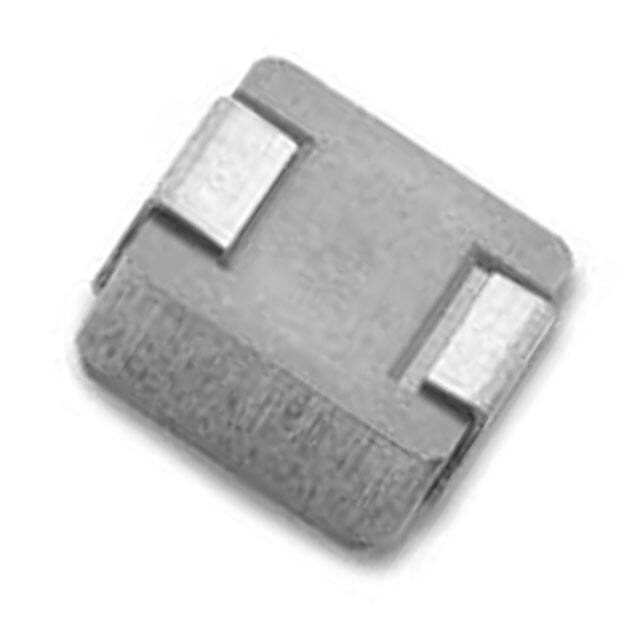

    SMD,13.2x12.9mm
    固定电感器 Nonstandard 470nH ±20% 41A 1.2mΩ
MMD-12FD-R47M-V1-RU 数据手册
■ Application Laptop, desktop and server applications High current power supplies Battery powered devices PMIC ■ Features RoHS compliant & halogen free Low resistance and high current rating Magnetic core made by high performance magnetic metal powder ■ Product Identification ① ② ③ ④ ⑤ MMD - 12FD - 2R2 M - V1 ① Product Code ② Dimensions ③ Inductance: 2R2 = 2.2μH ④ Tolerance: M = ±20% ⑤ Series Type: V1 Type Note: Please refer to the “Product Dimension” for detail dimensions. MAG.LAYERS MMD-12FD-SERIES-V1 ■ Electrical Performance Rdc (mΩ) Inductance ±20%@0A (μH) Max. Heat rating current (Idc)1 DC amps (A) Saturation current (Isat)2 DC amps (A) Typ. MMD-12FD-R15M-V1 0.15 0.53 0.6 55.0 118 MMD-12FD-R22M-V1 0.22 0.63 0.7 53.0 112 MMD-12FD-R33M-V1 0.33 0.83 0.9 46.0 65.0 MMD-12FD-R47M-V1 0.47 1.0 1.2 41.0 63.0 MMD-12FD-R56M-V1 0.56 1.2 1.4 37.0 62.0 MMD-12FD-R68M-V1 0.68 1.4 1.6 35.0 60.0 MMD-12FD-R82M-V1 0.82 1.6 1.9 33.0 50.0 MMD-12FD-1R0M-V1 1.0 1.7 2.0 32.0 49.0 MMD-12FD-1R5M-V1 1.5 2.5 3.0 27.0 45.0 MMD-12FD-1R8M-V1 1.8 2.8 3.2 24.0 41.0 MMD-12FD-2R2M-V1 2.2 3.5 4.2 22.0 40.0 MMD-12FD-3R3M-V1 3.3 5.7 6.8 18.0 35.0 MMD-12FD-4R7M-V1 4.7 9.3 11.2 13.5 30.0 MMD-12FD-6R8M-V1 6.8 13.1 14.0 11.5 16.5 MMD-12FD-8R2M-V1 8.2 14.5 15.5 10.5 16.0 MMD-12FD-100M-V1 10.0 16.4 17.2 10.0 15.5 Part number MAG.LAYERS MMD-12FD-SERIES-V1 Test frequency: 100 KHz, 0.25V. Test instruments: Inductance/saturation current: Keysight 4285A or equivalent. Rdc: ADEX AX1152D or equivalent. Notes: 1. The heat rating current (Idc) will cause temperature rise approximate 40oC. 2. The saturation current (Isat) will cause initial inductance drop approximate 20%. 3. All test data is referenced at 25oC ambient. 4. Operating temperature range -55oC to +125oC. 5. The part temperature (ambient + temp rise) should not exceed 125oC under the worst condition. 6. The temperature of component is affected by application conditions, e.g. circuit design, copper thickness of PCB and cooling conditions, the actual component temperature should be tested in the end application. MAG.LAYERS MMD-12FD-SERIES-V1 ■ Electtrical Characte eristics MMD-12FD-R15M-V V1 MMD D-12FD-R2 22M-V1 MMD-12FD-R33M-V V1 MMD D-12FD-R4 47M-V1 MMD-12FD-R56M-V V1 MMD D-12FD-R6 68M-V1 MMD-12FD-R82M-V V1 MMD D-12FD-1R R0M-V1 MA AG.LAYE ERS MMD D-12FD-SE ERIES-V1 MMD-12FD-1R5M-V V1 MMD D-12FD-1R R8M-V1 MMD-12FD-2R2M-V V1 MMD D-12FD-3R R3M-V1 MMD-12FD-4R7M-V V1 MMD D-12FD-6R R8M-V1 MMD-12FD-8R2M-V V1 MMD D-12FD-100M-V1 MA AG.LAYE ERS MMD D-12FD-SE ERIES-V1 ■ Product Dimension Dimension Part number MMD-12FD-SERIES-V1 A B C D E 13.2 ± 0.5 12.9 Max 6.4 Max 3.5 ± 0.5 2.3 ± 0.3 Unit: mm MAG.LAYERS MMD-12FD-SERIES-V1 ■ Recommended PCB Layout A B C Type 12FD A 4.95 B 7.87 C 13.76 Unit: mm Safety precaution 1. Do not make any through holes and copper pattern in the dotted line area. Except a copper pattern to the electrode. 2. Don’t design/mount any components in contact with this product. This power choke coil itself does not have any protective function in abnormal condition such as overload, short circuit, open conditions and etc, it shall be confirmed as the end product that there is no risk of smoking, fire, dielectric withstand voltage, insulation resistance and etc. in abnormal conditions to provide protective devices and/or protection circuit in the end product. MAG.LAYERS MMD-12FD-SERIES-V1 ■ Pack kaging Pee el-off force 165° TO 180° TOP COVER TA APE BASE TAPE T The peel off force of o cover ta ape is 10 to o 70 gramss in the arro ow directio on. Dimensions s F A B C D Type e A B C D E F 330mm m 330 ±2 100 ±1 20 ±0.5 13 ±1.0 24.2 2 +2 2.0/-0 29.2 ± ±2 E Unit: mm TYPE MMD SIZ ZE 12F FD A B W P1 K 13 3.4±0.1 14.1±0.1 24.0±0.3 16.0± ±0.1 6.8 8±0.1 P0 P2 D E T 4.0±0.1 2.0±0.1 1.5±0.1 1 1.75± ±0.1 0.4 4±0.05 Unit: mm MA AG.LAYE ERS MMD D-12FD-SE ERIES-V1 Taping quantity Series 12FD PCS/Reel 250 Carton box 342mm 40mm Middle packaging: 2 reels/box LABEL 40mm 70m m 336mm 40mm External packaging: 5 boxes/carton 415mm LABEL 40mm 380mm mm 380 MAG.LAYERS MMD-12FD-SERIES-V1
