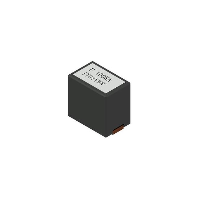

    固定电感器 Nonstandard 220nH ±10% 66A 0.17mΩ
AF13A-220K 数据手册
AF13A Series 1. Features of AF13A Series: • • • • • • • • • Ferrite based SMD inductor with lower core loss. Inductance range: 65.0 nH to 300.0 nH, custom values are welcomed. High current output chokes , up to 165.0 Amp with approx. 20% roll off. Low Profile 9.00 mm Max. height . 9.60 x 6.40 mm Foot Print. Ideal for Buck Converter, VRM & High Density Board Design. Operating frequency of up to 5.0MHz. Operating temperature range of -55°C to + 130°C. RoHS & HF compliant. T & R Qty’s: 500pcs, 13'' Reel. 2. Electrical Characteristics of AF13A Series: L @ Isat1 2 OCL 1 (nH) (nH) ± 10% or 15% Min. 65.00 46.80 ITG Part Number AF13A-65L DCR 3 (mΩ) ± 5% 0.17 Isat1 4 (A) @25℃ 165.00 Isat2 4 (A) @75℃ 155.00 Isat3 4 (A) @100℃ 145.00 Isat4 4 (A) @125℃ 135.00 Irms 5 (A) @25℃ 66.00 AF13A-75K 75.00 54.00 0.17 140.00 130.00 120.00 110.00 66.00 AF13A-90K 90.00 64.80 0.17 134.00 120.00 114.00 107.00 66.00 AF13A-100K 100.00 72.00 0.17 124.00 112.00 102.00 94.00 66.00 AF13A-120K 120.00 86.40 0.17 94.00 84.00 80.00 75.00 66.00 AF13A-150K 150.00 108.00 0.17 75.00 70.00 65.00 61.00 66.00 AF13A-170K 170.00 122.40 0.17 65.00 60.00 56.00 53.00 66.00 AF13A-180K 180.00 129.60 0.17 60.00 54.00 52.00 48.00 66.00 AF13A-210K 210.00 151.20 0.17 48.00 45.00 43.00 39.00 66.00 AF13A-220K 220.00 158.40 0.17 44.00 42.00 39.00 37.00 66.00 AF13A-280K 280.00 201.60 0.17 35.00 31.00 30.00 28.00 66.00 AF13A-300K 300.00 216.00 0.17 33.00 30.00 29.00 27.00 66.00 3. Mechanical Dimension of AF13A Series: A B C D E F Max. Max. Max. ± 0.35 Nom. ± 0.20 F xxx xx ITGYYWW 9.9 3.5 B 9.60 6.40 9.00 2.60 4.00 2.60 C Suggested Pad Layout A E a' b' a b F Notes: 3.1 Part Marking: F xxx xx: F is part code, xxx is inductance value in nH, x = tolerance, x is special code. ITGYYWW: ITG logo and YYWW is date code. D 1. Open Circuit Inductance (OCL) test condition: 500KHz,0.25Vrms,0Adc at 25℃. 2. L @ Isat and L @ Irms Test condition: 500KHz,0.25Vrms (Ta=25℃). 3. The nominal DCR is measured from point "a" and "a'" to point "b " and "b'", as shown above on the mechanical drawing(Ta=25℃). 4. Isat1 , Isat2 , Isat3 & Isat4 : DC current that will cause inductance to drop approximately by 20%. 5. Irms: DC current for an approximate temperature rise of 40℃ without core loss. Derating is necessary for AC currents. PCB pad layout , trace thickness and width , air-flow and proximity of other heat generating components will affect the temperature rise. 6. It is recommended the part temperature not exceed 130°C under worst case operating conditions as verified in the end application. ● ● New York 1 914 347 2474 ● Taipei 886 2 2698 8669 ● Kaohsiung 886 7 350 2275 Japan 81 568 85 2830 ● Shenzhen 86 755 8418 6263 ● Shanghai 86 21 5424 5141 ● Hong Kong 852 9688 9767 ● sales@ITG-Electronics.com ● www.ITG-Electronics.com Revision A.2: November 18, 2019 *Due to continuous product improvement, all specifications are subject to change without prior notice. Kindly contact an ITG field application engineer or a sales representative prior to purchase. AF13A Series 4. Inductance Characteristics of AF13A Series (Inductance vs Current): AF13A-65L 130.0 L (nH) 25℃ 75℃ 65.0 100℃ 125℃ 0.0 0.0 20.0 40.0 60.0 80.0 100.0 Direct Current (A) 120.0 140.0 160.0 180.0 AF13A-75K 150.0 L (nH) 25℃ 75℃ 75.0 100℃ 125℃ 0.0 0.0 20.0 40.0 60.0 80.0 100.0 Direct Current (A) 120.0 140.0 160.0 180.0 AF13A-90K 105.0 90.0 25℃ L (nH) 75.0 60.0 75℃ 45.0 100℃ 30.0 125℃ 15.0 0.0 0.0 10.0 20.0 30.0 40.0 50.0 60.0 70.0 80.0 90.0 Direct Current (A) 100.0 110.0 120.0 130.0 140.0 AF13A-100K 120.0 100.0 25℃ L (nH) 80.0 75℃ 60.0 100℃ 40.0 125℃ 20.0 0.0 0.0 ● 10.0 20.0 30.0 40.0 50.0 60.0 70.0 80.0 90.0 Direct Current (A) 100.0 110.0 120.0 130.0 140.0 ● New York 1 914 347 2474 ● Taipei 886 2 2698 8669 ● Kaohsiung 886 7 350 2275 Japan 81 568 85 2830 ● Shenzhen 86 755 8418 6263 ● Shanghai 86 21 5424 5141 ● Hong Kong 852 9688 9767 ● sales@ITG-Electronics.com ● www.ITG-Electronics.com Revision A.2: November 18, 2019 *Due to continuous product improvement, all specifications are subject to change without prior notice. Kindly contact an ITG field application engineer or a sales representative prior to purchase. AF13A Series AF13A-120K 150.0 L (nH) 120.0 25℃ 90.0 75℃ 60.0 100℃ 30.0 125℃ 0.0 0.0 5.0 10.0 15.0 20.0 25.0 30.0 35.0 40.0 45.0 50.0 55.0 60.0 65.0 70.0 75.0 80.0 85.0 90.0 95.0 Direct Current (A) AF13A-150K 180.0 150.0 25℃ L (nH) 120.0 75℃ 90.0 100℃ 60.0 125℃ 30.0 0.0 L (nH) 0.0 5.0 10.0 15.0 20.0 25.0 30.0 35.0 40.0 45.0 50.0 55.0 60.0 65.0 70.0 75.0 80.0 Direct Current (A) AF13A-170K 200.0 175.0 150.0 125.0 100.0 75.0 50.0 25.0 0.0 25℃ 75℃ 100℃ 125℃ 0.0 5.0 10.0 15.0 20.0 25.0 30.0 35.0 40.0 45.0 Direct Current (A) 50.0 55.0 60.0 65.0 70.0 AF13A-180K 240.0 25℃ L (nH) 180.0 75℃ 120.0 100℃ 60.0 125℃ 0.0 0.0 ● 5.0 10.0 15.0 20.0 25.0 30.0 35.0 40.0 45.0 Direct Current (A) 50.0 55.0 60.0 65.0 70.0 ● New York 1 914 347 2474 ● Taipei 886 2 2698 8669 ● Kaohsiung 886 7 350 2275 Japan 81 568 85 2830 ● Shenzhen 86 755 8418 6263 ● Shanghai 86 21 5424 5141 ● Hong Kong 852 9688 9767 ● sales@ITG-Electronics.com ● www.ITG-Electronics.com Revision A.2: November 18, 2019 *Due to continuous product improvement, all specifications are subject to change without prior notice. Kindly contact an ITG field application engineer or a sales representative prior to purchase. L (nH) AF13A Series AF13A-210K 240.0 210.0 180.0 150.0 120.0 90.0 60.0 30.0 0.0 25℃ 75℃ 100℃ 125℃ L (nH) 0.0 5.0 10.0 15.0 20.0 25.0 30.0 35.0 Direct Current (A) 45.0 50.0 55.0 60.0 AF13A-220K 252.0 220.5 189.0 157.5 126.0 94.5 63.0 31.5 0.0 25℃ 75℃ 100℃ 125℃ 0.0 5.0 10.0 15.0 20.0 25.0 30.0 35.0 Direct Current (A) 40.0 45.0 50.0 55.0 AF13A-280K 350.0 L (nH) 40.0 280.0 25℃ 210.0 75℃ 140.0 100℃ 70.0 125℃ 0.0 0.0 350.0 5.0 10.0 15.0 20.0 25.0 30.0 Direct Current (A) 35.0 40.0 45.0 50.0 AF13A-300K 300.0 25℃ L (nH) 250.0 200.0 75℃ 150.0 100℃ 100.0 125℃ 50.0 0.0 0.0 2.0 4.0 6.0 8.0 10.0 12.0 14.0 16.0 18.0 20.0 22.0 24.0 26.0 28.0 30.0 32.0 34.0 36.0 38.0 40.0 Direct Current (A) ● ● New York 1 914 347 2474 ● Taipei 886 2 2698 8669 ● Kaohsiung 886 7 350 2275 Japan 81 568 85 2830 ● Shenzhen 86 755 8418 6263 ● Shanghai 86 21 5424 5141 ● Hong Kong 852 9688 9767 ● sales@ITG-Electronics.com ● www.ITG-Electronics.com Revision A.2: November 18, 2019 *Due to continuous product improvement, all specifications are subject to change without prior notice. Kindly contact an ITG field application engineer or a sales representative prior to purchase.
