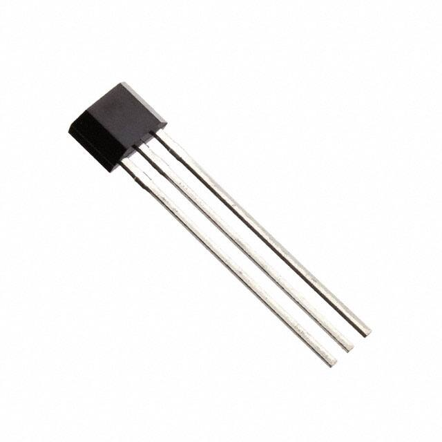

    TSH282是一款单极霍尔效应传感器IC。它采用了先进的斩波稳定技术,可提供精确且稳定的磁开关点。其设计、规格和性能已针对固态开关应用进行了优化
TSH282CT B0G 数据手册
TSH282 Sensitivity Unipolar Hall Effect Switch TO-92S Pin Definition: 1. VCC 2. GND 3. Output SOT-23 Pin Definition: 1. VCC 2. Output 3. GND Description TSH282 is an unipolar Hall effect sensor IC. It incorporates advanced chopper stabilization technology to provide accurate and stable magnetic switch points. The design, specifications and performance have been optimized for applications of solid state switches. The output transistor will be switched on (BOP) in the presence of a sufficiently strong South pole magnetic field facing the marked side of the package. Similarly, the output will be switched off (BRP) in the presence of a weaker South field and remain off with “0” field. Features ● ● ● ● ● ● CMOS Hall IC Technology Solid-State Reliability Chopper stabilized amplifier stage Unipolar, output switches with absolute value of South pole from magnet Operation down to 3.0V High Sensitivity for direct reed switch replacement applications Ordering Information Part No. TSH282CT B0G TSH282CX RFG Package Packing TO-92S SOT-23 1Kpcs / Bulk Bag 3Kpcs / 7” Reel Note: “G” denote for Halogen Free Product Application ● ● ● ● ● Solid state switch Limit switch, Current limit Interrupter Current sensing Magnet proximity sensor for reed switch replacement Absolute Maximum Rating (Ta = 25oC unless otherwise noted) Characteristics Limit Value Unit Supply voltage Output Voltage Reverse voltage Magnetic flux density Output current Operating Temperature Range VCC VOUT VCC/OUT 27 27 -0.3 Unlimited 50 V V V Gauss mA o C IOUT TOPR -40 to +85 o -55 to +150 Storage temperature range TSTG C o 150 Maximum Junction Temp TJ C 206 TO-92S o Thermal Resistance - Junction to Ambient θJA C/W 543 SOT-23 148 TO-92S o Thermal Resistance - Junction to Case θJC C/W 410 SOT-23 606 TO-92S Package Power Dissipation PD mW 230 SOT-23 Note: Exceeding the absolute maximum ratings may cause permanent damage. Exposure to absolute maximumrated conditions for extended periods may affect device reliability. 1/8 Version: B13 TSH282 Sensitivity Unipolar Hall Effect Switch Block Diagram Note: Static sensitive device; please observe ESD precautions. Reverse VDD protection is not included. For reverse voltage protection, a 100Ω resistor in series with VDD is recommended. Typical Application Circuit D1:1N4148 or 100Ω C1:1000pF C2:15pF R1:10KΩ Electrical Specifications (DC Operating Parameters:TA=+25oC,VCC=12V) Parameters Test Conditions Min Typ Max Units 3.0 -- 24 V Supply Voltage Operating Supply Current BBOP -- -- 500 mV Output Leakage Current IOFF BBop[(100)~(45)] Low Open(Pull-up Voltage) Null or weak magnetic field -Brp ~ +Brp Open(Pull-up Voltage) Open(Pull-up Voltage) North pole B< -Bop(-25~-70) Open(Pull-up Voltage) Low SOT-23 (North Pole) TO-92S (South Pole) OUT=Low (VDSon) OUT=Low (VDSon) 3/8 Version: B13 TSH282 Sensitivity Unipolar Hall Effect Switch Characteristic Performance Figure 1. Supply Voltage vs. Flux Density Figure 2. Temperature vs. Flux Density Figure 3. Supply Current vs. Temperature Figure 4. Supply Current vs. Supply Voltage Figure 5. Output Saturation Voltage vs. Supply Voltage Figure 6. Output Saturation Voltage vs. Temperature 4/8 Version: B13 TSH282 Sensitivity Unipolar Hall Effect Switch Characteristic Performance Figure 7. Output Leakage Current vs. Supply Voltage Figure 8. Power Dissipation vs. Temperature 5/8 Version: B13 TSH282 Sensitivity Unipolar Hall Effect Switch TO-92S Mechanical Drawing Unit: Millimeters Marking Diagram 282 Y WW = Device Code = Year Code (3=2013, 4=2014….) = Week Code (01~52) 6/8 Version: B13 TSH282 Sensitivity Unipolar Hall Effect Switch SOT-23 Mechanical Drawing Unit: Millimeters Marking Diagram 282 WW = Device Code = Week Code Table week code week code week code week code 1 OA 14 ON 27 PA 40 PN 2 OB 15 OO 28 PB 41 PO 3 OC 16 OP 29 PC 42 PP 4 OD 17 OQ 30 PD 43 PQ 7/8 5 OE 18 OR 31 PE 44 PR 6 OF 19 OS 32 PF 45 PS 7 OG 20 OT 33 PG 46 PT 8 OH 21 OU 34 PH 47 PU 9 OI 22 OV 35 PI 48 PV 10 OJ 23 OW 36 PJ 49 PW 11 OK 24 OX 37 PK 50 PX 12 OL 25 OY 38 PL 51 PY 13 OM 26 OZ 39 PM 52 PZ Version: B13 TSH282 Sensitivity Unipolar Hall Effect Switch Notice Specifications of the products displayed herein are subject to change without notice. TSC or anyone on its behalf, assumes no responsibility or liability for any errors or inaccuracies. Information contained herein is intended to provide a product description only. No license, express or implied, to any intellectual property rights is granted by this document. Except as provided in TSC’s terms and conditions of sale for such products, TSC assumes no liability whatsoever, and disclaims any express or implied warranty, relating to sale and/or use of TSC products including liability or warranties relating to fitness for a particular purpose, merchantability, or infringement of any patent, copyright, or other intellectual property right. The products shown herein are not designed for use in medical, life-saving, or life-sustaining applications. Customers using or selling these products for use in such applications do so at their own risk and agree to fully indemnify TSC for any damages resulting from such improper use or sale. 8/8 Version: B13
