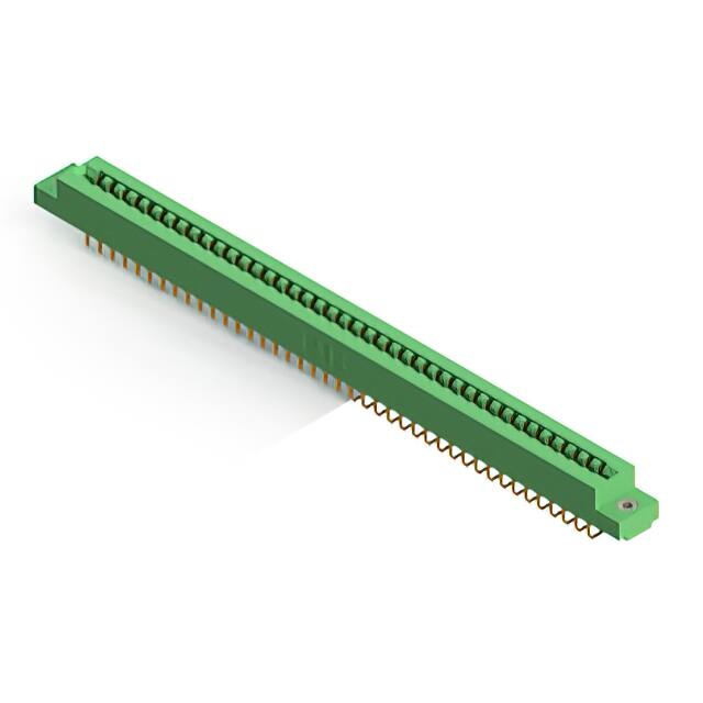

    弯插,P=3.96mm
    307 SERIES (.156" (3.96MM) CONTA
307-082-558-207 数据手册
Contact Detail Wire Hole .087x.013(2.21x0.33) - Tail LG .282(7.16) .156 [3.96] Contact Spacing x .200 [5.08] Row Spacing Mounting Option No Mounting Lugs ISSUE NUMBER THIS IS A C.A.D. GENERATED DRAWING DO NOT MAKE MANUAL REVISIONS TO MASTER. ORIGINAL 1 0.343 8.71 4.366 110.90 4.220 107.19 0.156 3.96 SECTION A-A 0.473 12.01 A A See Accompanying Pages for: • Contact Bend Details • Mounting Options .095 [2.41] Point of Contact (FROM BTM OF SLOT) Card Slot Accepts .054 [1.37] to .070 [1.78] Thick P.C. Board 307 / 357 Card Edge Connector Part Number: 307-052-500-201 EDAC INC TORONTO, ONTARIO CANADA YOUR CONNECTION TO QUALITY & SERVICE THESE DRAWINGS AND SPECIFICATIONS ARE THE PROPERTY OF EDAC INC.,AND SHALL NOT BE REPRODUCED,OR COPIED OR USED AS THE BASIS FOR THE MANUFACTURE OR SALE OF APPARATUS WITHOUT WRITTEN PERMISSION. ACAD REFERENCE NO. J.LEE DRAWN: CHECKED: SCALE: NTS DRAWING NUMBER 307 Assembly 307 ENG MASTER DATE: AUG. 11/09 DATE: SHEET 1 OF 3 ISSUE 1 Single Row Contacts - Read One Side of Daughter Board ISSUE NUMBER THIS IS A C.A.D. GENERATED DRAWING DO NOT MAKE MANUAL REVISIONS TO MASTER. 0.240 6.10 ORIGINAL 1 0.240 6.10 0.260 6.60 558 Contact Code 559 Contact Code 0.060 1.52 Single Row Contacts - Read Both Sides of Daughter Board 0.110 2.79 0.150 3.81 0.392 9.96 0.045 1.14 0.045 1.14 553 Contact Code 554 Contact Code 557 Contact Code Dual Row Contacts - Read Both Sides of Daughter Board 0.240 [6.10] Up to 27/54 Pin 0.162 [4.11] 28/56 and Over 0.290 [7.37] Up to 27/54 Pin .212 [5.38] 28/56 and Over 0.240 [6.10] Up to 27/54 Pin 0.162 [4.11] 28/56 and Over 0.120 3.05 0.095 2.41 0.265 6.73 555 Contact Code .125 [3.18] to .210 [5.33] Outside Tails .045 [1.14] to .060 [1.52] Between Tails 0.165 4.19 0.195 4.95 556 Contact Code .125 [3.18] to .185 [4.70] Outside Tails .045 [1.14] to .060 [1.52] Between Tails 0.343 8.71 0.200 5.08 0.060 1.52 558 Contact Code .125 [3.18] to .210 [5.33] Outside Tails .045 [1.14] to .060 [1.52] Between Tails 0.150 3.81 0.060 1.52 559 Contact Code 560 Contact Code 307/ 357 Series Card Edge Connector Contact Bend Detail EDAC INC TORONTO, ONTARIO CANADA YOUR CONNECTION TO QUALITY & SERVICE THESE DRAWINGS AND SPECIFICATIONS ARE THE PROPERTY OF EDAC INC.,AND SHALL NOT BE REPRODUCED,OR COPIED OR USED AS THE BASIS FOR THE MANUFACTURE OR SALE OF APPARATUS WITHOUT WRITTEN PERMISSION. ACAD REFERENCE NO. J.LEE DRAWN: CHECKED: SCALE: NTS DRAWING NUMBER 307 Assembly 307 ENG MASTER DATE: AUG. 11/09 DATE: SHEET 2 OF 3 ISSUE 1 0.125 3.18 Code x01 Code x12 ISSUE NUMBER THIS IS A C.A.D. GENERATED DRAWING DO NOT MAKE MANUAL REVISIONS TO MASTER. ORIGINAL 1 .128 [3.25] Dia Through Holes .128 [3.25] Dia Through Holes 0.468 11.89 0.344 8.74 0.125 3.18 0.060 1.52 Code x02 0.116 2.95 I.D. Floating Eyelets 0.090 2.29 0.250 6.35 Dia. 2.500 63.50 2.750 69.85 0.328 8.33 Code x03 0.005 0.13 .010 [0.25] Radial Float 1.550 39.37 0.250 6.35 0.250 6.35 .156 [3.96] Dia Through Holes 0.250 6.35 Code x04 M3-0.5 Metric Threaded Insert 0.242 6.15 0.423 10.74 Code x58 Code x07 #4-40 UNC Threaded Insert Code x68 307 / 357 Card Edge Connector Mounting Options EDAC INC Code x08 TORONTO, ONTARIO CANADA YOUR CONNECTION TO QUALITY & SERVICE THESE DRAWINGS AND SPECIFICATIONS ARE THE PROPERTY OF EDAC INC.,AND SHALL NOT BE REPRODUCED,OR COPIED OR USED AS THE BASIS FOR THE MANUFACTURE OR SALE OF APPARATUS WITHOUT WRITTEN PERMISSION. Code x78 ACAD REFERENCE NO. J.LEE DRAWN: CHECKED: SCALE: NTS DRAWING NUMBER 307 Assembly 307 ENG MASTER DATE: AUG. 11/09 DATE: SHEET 3 OF 3 ISSUE 1 Mouser Electronics Authorized Distributor Click to View Pricing, Inventory, Delivery & Lifecycle Information: EDAC: 307-052-500-201

The PDF document contains detailed information about a card edge connector with the part number 307-052-500-201. Here are the key points extracted:
- Material Model: 307-052-500-201 - Contact Detail: Wire hole with dimensions .087x.013 (2.21x0.33), tail LG with a length of .282 (7.16) - Mounting Options: No mounting lugs, contact spacing of .156 (3.96), and row spacing of .200 (5.08) - Pin Allocation: The document mentions single and dual row contacts with various codes such as 558, 559, 557, 553, 554, 555, 556, and 560. - Parameter Characteristics: Through holes with diameters of .128 (3.25), threaded inserts with M3-0.5 metric and #4-40 UNC, and floating eyelets with an inner diameter of 0.116. - Functional Details: The card slot accepts a PC board thickness ranging from .054 (1.37) to .070 (1.78). - Application Information: The document is a CAD-generated drawing and is the property of EDAC INC. It should not be reproduced or used without written permission. - Packaging Information: The document mentions Mouser Electronics as an authorized distributor for EDAC products.
For more detailed information, you can refer to the accompanying pages mentioned in the document.
