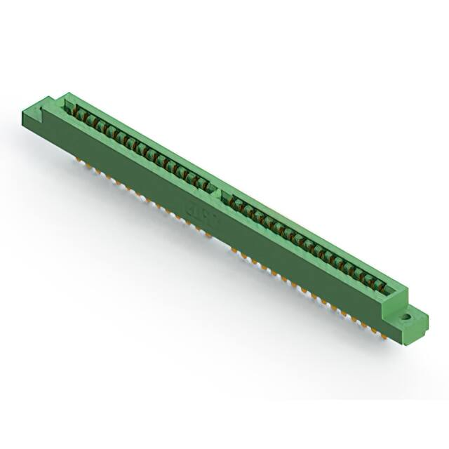

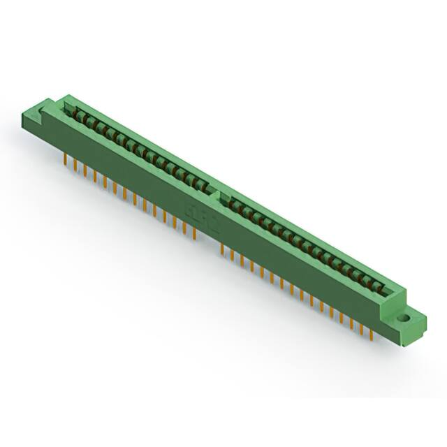

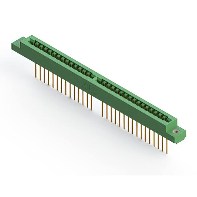

310 SERIES Card Edge Connector 0.156” (3.96mm) Pitch Features: • • • • • • • • 0.156” (3.96mm) contact spacing x 0.200” (5.08mm) row spacing Accepts 0.062” (1.57mm) nominal thickness P.C. board Low profile insulator body, 0.460” (11.68mm) with card slot barrier Contact termination options include P.C. tail, wire hole, wire wrap, and extender board bends Single or dual row configurations Variety of mounting options Accepts between contact and in-contact polarizing keys RoHS Compliant Specifications: Insulator Material UL 94V-0 Thermoplastic Polyester Contact Material Copper Alloy Contact Plating Gold Plating on mating area and Tin Plating on tails with Nickel underplating all over Current Rating 5 amps Contact Resistance 10 milliohms maximum Dielectric Withstanding Voltage 1800 V AC rms at sea level between adjacent contacts Insulation Resistance 5000 megaohms minimum Operating Temperature -40°C to +105°C Insertion Force 16 oz (4.45 N) maximum per contact pair when tested with .070” (1.78mm) thick gauge Withdrawal Force 1 oz (0.28 N) minimum per contact pair when tested with .054” (1.37mm) thick gauge Example Part Number: 310-060-520-202 Contact Code: Tail Description: Tail Size: Tail Length “G”: Single Row Contacts - Read One Side of Daughter Board Series Total Number of Contacts 505 Wire Hole .087 x . 013 (2.21 x 0.33) .282 (7.16) Contact Code 525 P.C. Tail .046 x .013 (1.17 x 0.33) .213 (5.41) 527 P.C. Tail .046 x .013 (1.17 x 0.33) .358 (9.09) Contact Rows Mounting Options 531 P.C. Tail .023 x .013 (0.58 x 0.33) .213 (5.41) Series: 545 Wire Wrap .046 x .013 (1.17 x 0.33) .708 (17.98) 310 547 Wire Wrap .046 x .013 (1.17 x 0.33) .520 (13.21) Total Number of Contacts: Contact Rows: 030 Single Row 501 Wire Hole .089 x .014 (2.29 x 0.36) .213 (5.41) 060 Dual Row 521 P.C. Tail .046 x .014 (1.17 x 0.36) .213 (5.41) Contact Rows: Description: 541 Wire Wrap .046 x .014 (1.17 x 0.36) .495 (12.57) 1 Single Row 2 Dual Row Mounting Options: Description: 01 No Mounting Lug 02 Ø.128” (Ø3.25mm) Mounting Holes 03 Ø.116” (Ø2.95mm) I.D. Floating Eyelets 04 Ø.156” (Ø3.96mm) Mounting Holes 07 M3-0.5 Metric Threaded Inserts 08 #4-40 Unified Threaded Inserts Single Row Contacts - Read Both Sides of Daughter Board Dual Row Contacts - Read Both Sides of Daughter Board 500 Wire Hole .087 x .013 (2.21 x 0.33) .282 (7.16) 520 P.C. Tail .046 x .013 (1.17 x 0.33) .213 (5.41) 522 P.C. Tail .046 x .013 (1.17 x 0.33) .358 (9.09) 524 P.C. Tail .023 x .013 (0.58 x 0.33) .213 (5.41) 540 Wire Wrap .046 x .013 (1.17 x 0.33) .708 (17.98) 542 Wire Wrap .046 x .013 (1.17 x 0.33) .520 (13.21) 555 .062 EXTENDER BOARD BEND (CODE 500 CONTACTS) 556 .062 EXTENDER BOARD BEND (CODE 520 CONTACTS) 560 .062 EXTENDER BOARD BEND (CODE 522 CONTACTS) Ordering Code Notes: For details of the mounting options refer to next page. www.edac.net customerservice@edac.net 310 SERIES Card Edge Connector 0.156” (3.96mm) Pitch SINGLE ROW READ ONE SIDE OF DAUGHTER BOARD DUAL ROW SINGLE ROW READ BOTH SIDES OF DAUGHTER BOARD .300 (7.62) CARD SLOT .200 (5.08) .300 (7.62) CARD SLOT .095 (2.41) POINT OF CONTACT NUMBER 1 TO 30 ROW .175 (4.45) POINT OF CONTACT 5.953 (151.21) 5.630 (143.00) 5.312 (134.92) CARD SLOT ACCEPTS .054 (1.37) TO .070 (1.78) THICK P.C. BOARD 5.119 (130.02) 2.353 (59.77) 2.665 (67.69) 31 32 33 34 35 36 37 38 39 40 41 42 43 44 45 46 47 48 49 50 51 52 53 54 55 56 57 58 59 60 .432 (10.97) 1 2 3 4 5 6 7 8 9 10 11 12 13 14 15 16 17 18 19 20 21 22 23 24 25 26 27 28 29 30 .460 (11.68) .250 (6.35) G .160 (4.06) REF .048 (1.22) X .125 (3.18) WIRE HOLE 2.028 (51.51) www.edac.net .421 .156 (3.96) 2.340 (59.44) .165 (4.19) BOTH ENDS customerservice@edac.net

物料型号:310-060-520-202
器件简介:310系列卡边连接器,0.156英寸(3.96mm)间距,具有EDAC特性。
引脚分配:单排或双排配置,接受0.062英寸(1.57mm)名义厚度的PCB板。
参数特性:包括绝缘材料、接触材料、接触镀层、电流额定值、接触电阻、介电强度、绝缘电阻、工作温度、插入力和拔出力。
功能详解:低轮廓绝缘体,0.460英寸(11.68mm)带卡槽障碍,接触终止选项包括PCB尾、线孔、线绕和扩展板弯曲。
应用信息:符合RoHS标准,提供多种安装选项和极化键。
封装信息:提供了详细的安装代码说明和订购代码注意事项。
