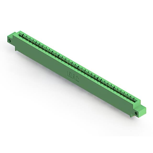

833 SERIES High Temp Card Edge Connectors 0.156” (3.96mm) Pitch Features: • • • • • • • • • 0.156” (3.96mm) contact spacing x 0.200” (5.08mm) row spacing Accepts 0.062” (1.57mm) nominal thickness P.C. board High profile insulator body, 0.600” (15.24mm) Card slot depth of 0.388” (9.86mm) Contact termination options include P.C. tail, wire hole, wire wrap, 90 degree and extender board bends Single or dual row configurations Large variety of mounting options, flush or offset lugs Accepts between contact and in-contact polarizing keys RoHS Compliant Specifications: Insulator Material Diallyl Phthalate, UL 94V-0, Green Color Contact Material Copper Alloy Contact Plating Gold Plating on mating area and Tin Plating on tails with Nickel underplating all over Current Rating 3 amps Contact Resistance 10 milliohms maximum Dielectric Withstanding Voltage 1800 V AC rms at sea level between adjacent contacts Insulation Resistance 5000 megaohms minimum Operating Temperature -40°C to +125°C Insertion Force 16 oz (4.45 N) maximum per contact pair when tested with .070” (1.78mm) thick gauge Withdrawal Force 1 oz (0.28 N) minimum per contact pair when tested with .054” (1.37mm) thick gauge Example Part Number: 833-044-520-204 Series Total Number of Contacts Contact Code Contact Rows and Insulator Style Mounting Options Series: Mounting Options: Description: 833 01 No Mounting Lug Total Number of Contacts: Contact Rows: 02 Ø.128” (Ø3.25mm) Mounting Holes 006, 007, . . . . 043 Single Row 03 Ø.116” (Ø2.95mm) I.D. Floating Eyelets 012, 014, . . . . 086 Dual Row 04 Ø.156” (Ø3.96mm) Mounting Holes Contact Code: Description: Tail Size: Tail Length "G": 07 M3-0.5 Metric Threaded Inserts 500 Wire Hole .050 x .025 (1.27 x 0.64) .260 (6.60) 08 #4-40 Unified Threaded Inserts 520 P.C. Tail .030 x .018 (0.76 x 0.46) .175 (4.45) 12 Ø.128” (Ø3.25mm) Side Mounting Holes 521 P.C. Tail .025 Square (0.64 Square) .150 (3.81) 523 P.C. Tail .025 Square (0.64 Square) .390 (9.91) 524 P.C. Tail .018 Square (0.46 Square) .175 (4.45) 540 Wire Wrap .025 Square (0.64 Square) .560 (14.22) 541 Wire Wrap .025 Square (0.64 Square) .750 (19.05) 542 Wire Wrap .025 Square (0.64 Square) .645 (16.38) 544 Wire Wrap .050 x .025 (1.27 x 0.64) .750 (19.05) 555 EXTENDER BOARD BEND (Code 500 Contacts) 556 EXTENDER BOARD BEND (Code 520 Contacts) 558 90 DEGREE BEND (Code 541 Contacts) 559 90 DEGREE BEND (Code 541 Contacts) 560 EXTENDER BOARD BEND Contact Rows: Insulator Style: Description: 1 Flush Mounting Lugs Single Row 2 Flush Mounting Lugs Dual Row 6 .170 (4.32) Offset Lugs Single Row 8 .170 (4.32) Offset Lugs Dual Row www.edac.net Ordering Code Notes: 1) All connector sizes up to 43 contacts single row / 86 contacts dual row are available upon request. 2) For details of the extender board and 90 degree bends refer to next pages. 3) For lugless connectors, code 01 mounting, specify contact row code 1 or 2. 4) For details of the mounting options refer to next pages. (Code 523 Contacts) customerservice@edac.net 833 SERIES High Temp Card Edge Connectors 0.156” (3.96mm) Pitch NUMBER OF CONTACTS "A" "B" "C" "D" "E" Single Double Inch mm Inch mm Inch mm Inch mm Inch mm 6 12 1.784 45.31 1.534 38.96 1.261 32.03 1.100 27.94 0.780 19.81 10 20 2.408 61.16 2.158 54.81 1.885 47.88 1.724 43.79 1.404 35.66 15 30 3.148 79.96 2.898 73.61 2.625 66.68 2.464 62.59 2.144 54.46 18 36 3.656 92.86 3.406 86.51 3.133 79.58 2.972 75.49 2.652 67.36 22 44 4.280 108.71 4.030 102.36 3.757 95.43 3.596 91.34 3.276 83.21 28 56 5.216 132.49 4.966 126.14 4.693 119.20 4.532 115.11 4.212 106.98 36 72 6.464 164.19 6.214 157.84 5.941 150.90 5.780 146.81 5.460 138.68 37 74 6.620 168.15 6.370 161.80 6.097 154.86 5.936 150.77 5.616 142.65 43 86 7.556 191.92 7.306 185.57 7.033 178.64 6.872 174.55 6.552 166.42 www.edac.net customerservice@edac.net 833 SERIES High Temp Card Edge Connectors 0.156” (3.96mm) Pitch 0.12 [2.95] I.D. Floating Eyelets 0.25 [6.35] Dia. .144 (3.66) Dia. Through Hole Code x01 Code x02 0.010 [0.25] Radial Float Code x03 .156 (3.96) Dia. Through Hole M5-0.5 Metric Insert #4-40 UNC Threaded Insert Code x04 Code x07 Code x08 www.edac.net 0.01 [0.13] Vertical Float 0.33 [8.33] customerservice@edac.net

参数特性: - 绝缘体材料:邻苯二甲酸二烯丙酯,UL 94V-0,绿色 - 接触材料:铜合金 - 接触镀层:接触区域的金镀层和尾部的锡镀层,整体镍底层 - 电流额定值:3安培 - 接触电阻:最大10毫欧姆 - 介电强度:在相邻接触之间1800V AC rms - 绝缘电阻:最小5000兆欧姆 - 工作温度:-40°C至+125°C - 插入力:每对接触最大16盎司(4.45牛顿) - 拔出力:每对接触最小1盎司(0.28牛顿)
功能详解:该连接器提供多种接触终止选项,包括PCB尾部、线孔、线绕、90度和扩展板弯曲。同时提供多种安装选项,包括齐平或偏移的安装耳。
应用信息:文档中没有提供具体的应用信息,但根据其高温度和电气特性,可能适用于需要在极端温度下运行的电子设备。
封装信息:高轮廓绝缘体体,0.600英寸(15.24mm),卡槽深度0.388英寸(9.86mm)。提供多种安装选项,包括无安装耳、安装孔、浮动眼圈等。
