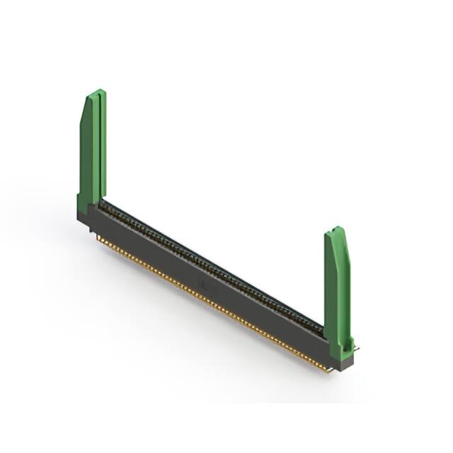

2x ISSUE NUMBER THIS IS A C.A.D. GENERATED DRAWING DO NOT MAKE MANUAL REVISIONS TO MASTER. ORIGINAL .600 15.24 .250 6.35 .100 2.54 A .150 3.81 6.300 160.02 6.460 164.08 6.775 172.09 A SECTION A-A 7.035 178.69 345/395 SERIES CARD EDGE CONNECTOR PART NUMBER: 395-124-559-578 • • • 1 .156 3.96 .330 8.38 CARD SLOT .160 4.06 POINT OF CONTACT CARD SLOT ACCEPTS .054" [1.37] TO .070"[1.78] THICK PCB Contact Dimensions: 559-90 Degree Bend (Code 541 Contacts) See Sheet 2 for Contact Code 555, 556, 558, 559, 560 Dimensions INSULATOR MATERIAL: THERMOPLASTIC PBT BLACK, UL 94V-0 CONTACT MATERIAL; COPPER TIN ALLOY CONTACT PLATING: GOLD ON THE MATING AREA, TIN PLATING ON THE CONTACT TAILS, NICKEL UNDERPLATE EDAC INC TORONTO, ONTARIO CANADA YOUR CONNECTION TO QUALITY & SERVICE THESE DRAWINGS AND SPECIFICATIONS ARE THE PROPERTY OF EDAC INC.,AND SHALL NOT BE REPRODUCED,OR COPIED OR USED AS THE BASIS FOR THE MANUFACTURE OR SALE OF APPARATUS WITHOUT WRITTEN PERMISSION. ACAD REFERENCE NO. 345-ENG-MASTER DRAWN: R.STA.MONICA DATE:MAY.16/2017 CHECKED: DATE: SCALE: 1:1 DRAWING NUMBER 345-ENG-MASTER SHEET 1 OF 2 ISSUE 1 Contact Description: 559-90 Degree Bend (Code 541 Contacts) .107 2.72 ORIGINAL .157 4 .125(3.18) to .210(5.33) Outside Tails .125(3.18) to .210(5.33) Outside Tails .045(1.14) to .060(1.52) Between Tails .045(1.14) to .060(1.52) Between Tails Contact Code 555 Contact Code 556 .060 .152 3.86 .060 .150 .200 .285 7.24 .635 16.13 1 .082 2.08 .232 5.89 .235 5.97 ISSUE NUMBER THIS IS A C.A.D. GENERATED DRAWING DO NOT MAKE MANUAL REVISIONS TO MASTER. .362 9.19 .125(3.18) to .210(5.33) Outside Tails .635 16.13 .045(1.14) to .060(1.52) Between Tails Contact Code 558 • • • INSULATOR MATERIAL: THERMOPLASTIC POLYESTER, UL 94V-0 DAP MATERIAL AVAILABLE UPON REQUEST CONTACT MATERIAL; COPPER ALLOY CONTACT PLATING: GOLD ON THE MATING AREA, TIN PLATING ON THE CONTACT TAILS, NICKEL UNDERPLATE Contact Code 559 Contact Code 560 345/395 SERIES CARD EDGE CONNECTOR CONTACT CODE 555,556,558,559,560 DIMENSIONS EDAC INC TORONTO, ONTARIO CANADA YOUR CONNECTION TO QUALITY & SERVICE THESE DRAWINGS AND SPECIFICATIONS ARE THE PROPERTY OF EDAC INC.,AND SHALL NOT BE REPRODUCED,OR COPIED OR USED AS THE BASIS FOR THE MANUFACTURE OR SALE OF APPARATUS WITHOUT WRITTEN PERMISSION. ACAD REFERENCE NO. DRAWN: R.STA.MONICA DATE: CHECKED: SCALE: 345-ENG-MASTER DATE:MAY.16/2017 1:1 DRAWING NUMBER 345-ENG-MASTER SHEET 2 OF 2 ISSUE 1

1. 物料型号:文档中提到的物料型号为“345/395 SERIES CARD EDGE CONNECTOR”,具体型号为“PART NUMBER: 395-124-559-578”。
2. 器件简介:文档描述了一种卡边缘连接器,具体为“345/395系列卡边缘连接器”,具有不同接触代码的接触点,例如555、556、558、559和560。
3. 引脚分配:文档中提供了接触点的详细尺寸和分配,例如559-90度弯曲(Code 541 Contacts)的接触点尺寸。
4. 参数特性:文档列出了绝缘材料为“热塑性PBT黑色,UL 94V-0”,接触材料为“铜锡合金”,接触镀层为“接触区域的金层,接触尾部的锡层,镍底层”。
5. 功能详解:文档中没有提供具体的功能详解,但根据接触点的描述和尺寸,可以推断这些连接器用于PCB板的边缘连接,允许不同厚度的PCB板插入。
6. 应用信息:文档中没有直接提供应用信息,但根据连接器的规格和特性,它们可能用于需要卡边缘连接的电子设备中,例如计算机硬件、通信设备等。
7. 封装信息:文档中提供了连接器的封装尺寸和规格,例如卡槽接受的PCB厚度范围为“.054“ [1.37] TO .070“[1.78]”。
