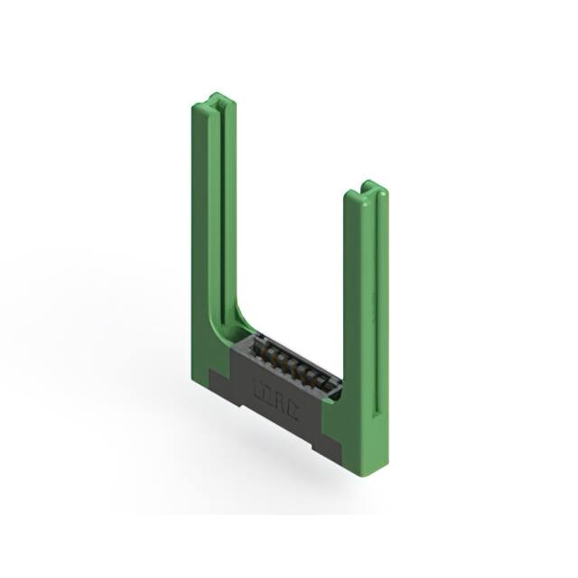

    插件,P=3.18mm
    3.18MM P数:7
396-007-521-158 数据手册
ISSUE NUMBER .600 15.24 1 .125 3.18 .330 8.38 Slot Depth .160 4.06 Point of Contact 1.000 25.4 1.160 29.46 ORIGINAL .350 8.89 .370 9.4 THIS IS A C.A.D. GENERATED DRAWING DO NOT MAKE MANUAL REVISIONS TO MASTER. .150 3.81 A SECTION A-A 1.685 42.8 A • • • INSULATOR MATERIAL: THERMOPLASTIC POLYESTER, UL 94V-0 CONTACT MATERIAL; COPPER, NICKEL, TIN ALLOY CA-725 CONTACT PLATING: GOLD ON THE MATING AREA, TIN-LEAD ON THE CONTACT TAILS, NICKEL UNDERPLATE 346/396 SERIES CARD EDGE CONNECTOR PART NUMBER: 396-007-521-158 EDAC INC TORONTO, ONTARIO CANADA YOUR CONNECTION TO QUALITY & SERVICE THESE DRAWINGS AND SPECIFICATIONS ARE THE PROPERTY OF EDAC INC.,AND SHALL NOT BE REPRODUCED,OR COPIED OR USED AS THE BASIS FOR THE MANUFACTURE OR SALE OF APPARATUS WITHOUT WRITTEN PERMISSION. ACAD REFERENCE NO. DRAWN: J.LEE DATE: CHECKED: SCALE: 346-ENG-MASTER DATE: APR. 22/09 1:1 DRAWING NUMBER 346-ENG-MASTER SHEET 1 OF 2 ISSUE 1 Contact Description: 555-Extender Board Bend (Code 500 Contacts) .125(3.18) to .210(5.33) Outside Tails .125(3.18) to .210(5.33) Outside Tails .045(1.14) to .060(1.52) Between Tails .125(3.18) to .210(5.33) Outside Tails Contact Code 555 Contact Code 556 .060 1.52 .060 1.52 .260 6.6 .660 16.76 .660 16.76 INSULATOR MATERIAL: THERMOPLASTIC POLYESTER, UL 94V-0 CONTACT MATERIAL; COPPER, NICKEL, TIN ALLOY CA-725 CONTACT PLATING: GOLD ON THE MATING AREA, TIN-LEAD ON THE CONTACT TAILS, NICKEL UNDERPLATE .165 4.19 .150 3.81 .200 5.08 .210 5.33 1 .170 4.33 .245 6.22 • • • ORIGINAL .095 2.41 .120 3.05 Contact Code 558 ISSUE NUMBER THIS IS A C.A.D. GENERATED DRAWING DO NOT MAKE MANUAL REVISIONS TO MASTER. .375 9.54 .125(3.18) to .210(5.33) Outside Tails .125(3.18) to .210(5.33) Outside Tails Contact Code 559 Contact Code 560 346/396 SERIES CARD EDGE CONNECTOR CONTACT CODE 555,556,558,559,560 DIMENSIONS EDAC INC TORONTO, ONTARIO CANADA YOUR CONNECTION TO QUALITY & SERVICE THESE DRAWINGS AND SPECIFICATIONS ARE THE PROPERTY OF EDAC INC.,AND SHALL NOT BE REPRODUCED,OR COPIED OR USED AS THE BASIS FOR THE MANUFACTURE OR SALE OF APPARATUS WITHOUT WRITTEN PERMISSION. ACAD REFERENCE NO. DRAWN: J.LEE DATE: CHECKED: SCALE: 346-ENG-MASTER DATE: APR. 22/09 1:1 DRAWING NUMBER 346-ENG-MASTER SHEET 2 OF 2 ISSUE 1
