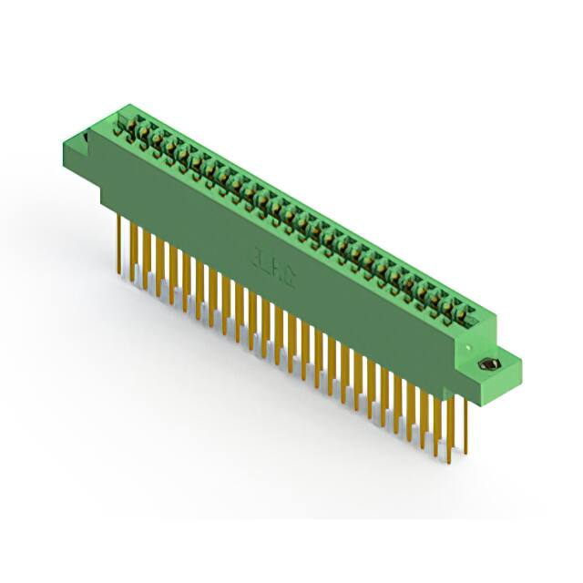

317 SERIES Card Edge Connector 0.156” (3.96mm) Pitch Features: • • • • • • • • • 0.156” (3.96mm) contact spacing x 0.200” (5.08mm) row spacing Accepts 0.062” (1.57mm) nominal thickness P.C. board High profile insulator body, 0.720” (18.29mm) Contact termination 0.045” (1.14mm) square wire wrap Single or dual row configurations Large variety of mounting options Accepts between contact and in-contact polarizing keys Pre-assembled card guides are available RoHS Compliant Specifications: Insulator Material UL 94V-0 Diallyl Phthalate, Green Color Contact Material Copper Alloy Contact Plating Gold Plating with Nickel underplating all over Current Rating 5 amps Contact Resistance 10 milliohms maximum Dielectric Withstanding Voltage 1800 V AC rms at sea level between adjacent contacts Insulation Resistance 5000 megaohms minimum Operating Temperature -65°C to +125°C Insertion Force 16 oz (4.45 N) maximum per contact pair when tested with .070” (1.78mm) thick gauge Withdrawal Force 1 oz (0.28 N) minimum per contact pair when tested with .054” (1.37mm) thick gauge Mounting Options: Description: 01 No Mounting Lug 02 Ø.144" (Ø3.66mm) Mounting Holes 03 Ø.116" (Ø2.95mm) I.D. Floating Eyelets 04 Ø.156" (Ø3.96mm) Mounting Holes 07 M3-0.5 Metric Threaded Inserts Contact Rows 08 #4-40 Unified Threaded Inserts Mounting Options 78 Example Part Number: 317-072-542-808 Series Total Number of Contacts Contact Code In-Line Card Guides Series: 317 Total Number of Contacts: Contact Rows: 006, 007, . . . . 043 Single Row 012, 014, . . . . 086 IN-CONTACT POLARIZING KEY P/N 321-240-328 Dual Row Contact Code: Tail Description: 542 Wire Hole 541 Wire Wrap Tail Size: IN-CONTACT POLARIZING KEY P/N 334-240-318 Tail Length “G”: Single Row Contacts - Read One Side of Daughter Board .045 Square (1.14 Square) .750(19.05) Single Row Contacts - Read Both Sides of Daughter Board .045 Square (1.14 Square) .750(19.05) Dual Row Contacts - Read Both Sides of Daughter Board 540 Wire Wrap .045 Square (1.14 Square) .750(19.05) 542 Wire Wrap .045 Square (1.14 Square) .750(19.05) 543 Wire Wrap .045 Square (1.14 Square) .900(22.86) Contact Rows: Description: 6 Single Row 8 Dual Row www.edac.net Ordering Code Notes: 1) All connector sizes up to 43 contacts single row / 86 contacts dual row are available upon request. 2) For details of the mounting options refer to next pages. customerservice@edac.net 317 SERIES Card Edge Connector 0.156” (3.96mm) Pitch A DUAL ROW CONTACTS CODES 540 & 543 B CODE 542 C .370 (9.40) CARD SLOT D .240 (6.10) POINT OF CONTACT .500 (12.70) .240 (6.10) POINT OF CONTACT CARD SLOT ACCEPTS .054 (1.37) TO .070 (1.78) THICK P.C. BOARD .250 (6.35) .720 (18.29) SINGLE ROW CONTACTS CODE 541 G .163 (4.14) .445 (11.30) CODE 542 .100 (2.54) .156 (3.96) ROW A SIDE OF CONNECTOR BACK UP SPRINGS LOCATED IN POSITIONS B2, B5, B8, B11, ... B41 ROW A SIDE OF CONNECTOR 14 15 13 12 10 11 8 9 7 5 6 3 4 1 A .200 (5.08) 2 EDAC B E ( .156 (3.96) DIA HOLES REF +.000 D MINUS .012 (0.30) ) -.015 (0.38) .530 (13.46) .390 (9.91) .140 (3.56) .125 (3.18) .055 (1.40) CUT OUT FOR IN-CONTACT CUT OUT FOR BETWEEN CONTACT POLARIZING KEY POLARIZING KEY B RECOMMENDED DAUGHTER BOARD CONNECTOR MOUNTING PATTERN PANEL MOUNT CUT OUT NUMBER OF CONTACTS "A" "B" "C" "D" "E" Single Double Inch mm Inch mm Inch mm Inch mm Inch mm 6 12 1.830 46.48 1.539 39.09 1.220 30.99 1.100 27.94 0.780 19.81 10 20 2.454 62.33 2.163 54.94 1.844 46.84 1.724 43.79 1.404 35.66 15 30 3.234 82.14 2.943 74.75 2.624 66.65 2.504 63.60 2.184 55.47 18 36 3.702 94.03 3.411 86.64 3.092 78.54 2.972 75.49 2.652 67.36 22 44 4.326 109.88 4.035 102.49 3.716 94.39 3.596 91.34 3.276 83.21 25 50 4.794 121.77 4.503 114.38 4.184 106.27 4.064 103.23 3.744 95.10 28 56 5.262 133.65 4.971 126.26 4.652 118.16 4.532 115.11 4.212 106.98 30 60 5.574 141.58 5.283 134.19 4.964 126.09 4.844 123.04 4.524 114.91 36 72 6.510 165.35 6.219 157.96 5.900 149.86 5.780 146.81 5.460 138.68 43 86 7.602 193.09 7.311 185.70 6.992 177.60 6.872 174.55 6.552 166.42 www.edac.net customerservice@edac.net 317 SERIES Card Edge Connector 0.156” (3.96mm) Pitch 0.12 [2.95] I.D. Floating Eyelets 0.25 [6.35] Dia. .144 (3.66) Dia. Through Hole Code x01 Code x02 0.010 [0.25] Radial Float Code x03 0.01 [0.13] Vertical Float 0.33 [8.33] 0.11 [2.79] .156 (3.96) Dia. Through Hole M5-0.5 Metric Insert #4-40 UNC Threaded Insert 1.71 [43.48] 0.25 [6.35] Code x04 www.edac.net Code x07 Code x08 Code x78 customerservice@edac.net
317-082-540-801
物料型号:317系列 器件简介:0.156英寸(3.96mm)间距的卡边连接器,具有EDAC卡边缘设计,接受0.062英寸(1.57mm)厚度的PCB板,有高轮廓绝缘体,多种安装选项,符合RoHS标准。 引脚分配:提供单排和双排配置,接触代码包括542(线孔)、541(线绕)、540(线绕)、543(线绕)。 参数特性:绝缘材料为UL 94V-0邻苯二甲酸二烯丙酯,接触材料为铜合金,接触镀金,电流额定值为5安培,接触电阻最大为10毫欧,介电强度为1800V AC rms,绝缘电阻最小为5000兆欧,工作温度范围为-65°C至+125°C。 功能详解:连接器接受厚度在0.054英寸(1.37mm)至0.070英寸(1.78mm)之间的PCB板,具有极化键以确保正确插入。 应用信息:适用于需要高密度连接的应用。 封装信息:提供多种安装选项,包括无安装凸耳、安装孔、浮动眼圈、内联卡导等。
