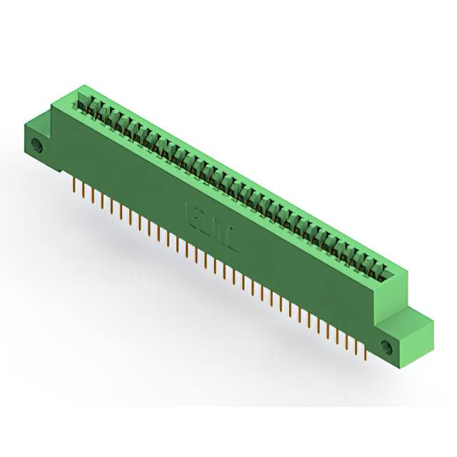

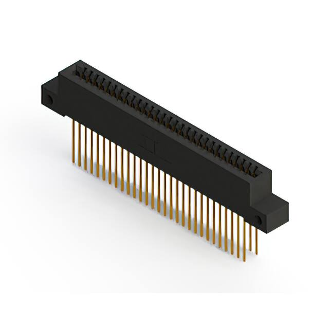

842/892 SERIES High Temp Card Edge Connectors 0.100” (2.54mm) Pitch Features: • • • • • • • • 0.100” (2.54mm) contact spacing x 0.200” (5.08mm) row spacing Accepts 0.062” (1.57mm) nominal thickness P.C. board High profile insulator body, 0.590” (14.99mm) Contact termination options include P.C. tail, wire wrap, 90 degree bends and extender board bends Single or dual row configurations Variety of mounting options, flush or offset lugs Accepts in-contact polarizing keys RoHS Compliant & UL Certified Specifications: Insulator Material (842: Diallyl Phthalate) (892: Polyphenylene sulfide) , UL 94V-0 Contact Material Copper Alloy Contact Plating Gold Plating on mating area and Tin Plating on tails with Nickel underplating all over Current Rating 3 amps Contact Resistance 10 milliohms maximum Dielectric Withstanding Voltage 1200 V AC rms at sea level between adjacent contacts Insulation Resistance 5000 megaohms minimum Operating Temperature -40°C to +125°C Insertion Force 16 oz (4.45 N) maximum per contact pair when tested with .070” (1.78mm) thick gauge Withdrawal Force 1 oz (0.28 N) minimum per contact pair when tested with .054” (1.37mm) thick gauge Example Part Number: 842-100-541-202 Series Total Number of Contacts Contact Code Contact Rows Mounting Options Series: Insulator Color: Contact Code: Tail Description: Tail Size: Tail Length "G": 842 Green 500 Wire Hole .050 x .025 (1.27 x 0.64) .270 (6.86) 892 Black 520 P.C. Tail .030 x .018 (0.76 x 0.46) .185 (4.70) Total Number of Contacts: Contact Rows: 521 P.C. Tail .025 Square (0.64 Square) .160 (4.06) 005, 006, . . . . 058 Single Row 523 P.C. Tail .025 Square (0.64 Square) .400 (10.16) 010, 012, . . . . 116 Dual Row 524 P.C. Tail .018 Square (0.46 Square) .185 (4.70) Contact Rows: Description: 540 Wire Wrap .025 Square (0.64 Square) .570 (14.48) 1 Single Row 541 Wire Wrap .025 Square (0.64 Square) .760 (19.30) 2 Dual Row 542 Wire Wrap .025 Square (0.64 Square) .655 (16.64) Mounting Options: Description: 544 Wire Wrap .050 x .025 (1.27 x 0.64) .760 (19.30) 01 No Mounting Lug 555 EXTENDER BOARD BEND (CODE 500 CONTACTS) 02 Ø.128” (Ø3.25mm) Mounting Holes 556 EXTENDER BOARD BEND (CODE 520 CONTACTS) 03 Ø.116” (Ø2.95mm) I.D. Floating Eyelets 558 90 DEGREE BEND (CODE 541 CONTACTS) 04 Ø.156” (Ø3.96mm) Mounting Holes 559 90 DEGREE BEND CODE 541 CONTACTS) 07 M3-0.5 Metric Threaded Inserts 560 EXTENDER BOARD BEND CODE 523 CONTACTS) 08 #4-40 Unified Threaded Inserts 12 Ø.128” (Ø3.25mm) Side Mounting Holes IN-CONTACT POLARIZING KEY P/N 345-240-328 Ordering Code Notes: 1) All connector sizes up to 58 contacts single row / 116 contacts dual row are available upon request. 2) For details of the extender board and 90 degree bends refer to next pages. 3) For details of the mounting options refer to page 3. www.edac.net customerservice@edac.net 842/892 SERIES High Temp Card Edge Connectors 0.100” (2.54mm) Pitch SECTION THROUGH CONTACT POSITION A B SINGLE ROW DUAL ROW C .410 (10.41) CARD SLOT .370 (9.40) .240 (6.10) POINT OF CONTACT CARD SLOT ACCEPTS .054 (1.37) TO .070 (1.78) THICK P.C. BOARD LETTER"A"SIDE OF CONNECTOR SPECIFICATIONS D .590 (14.99) G .135 (3.43) .270 (6.86) .128 (3.25) DIA CONNECTOR B THROUGH HOLES DIMENSION FOR RIGHT ANGLE MTG. .030 X .080 (0.76 X 2.03) WIRE HOLE .100 (2.54) E .200 (5.08) RECOMMENDED DAUGHTER BOARD .400 (10.16) .200 PANEL MOUNT CUT OUT (5.08) .125 (3.18) PANEL MOUNT .430 (10.92) .100 (2.54) .136 (3.45) DIA REF E .080 (2.03) B CUT OUT FOR IN-CONTACT POLARIZING KEY. .042 (1.07) +.004 (0.10)/-.000 FOR ALL P.C. TAILS EXCEPT CODE 524 .031 (0.79) +.004 (0.10)/-.000 FOR CODE 524 P.C. TAIL .008 (0.20) DIA +.000 D MINUS .012 (0.30) -.015 (0.38) CONNECTOR MOUNTING PATTERN NUMBER OF CONTACTS "A" "B" "C" "D" "E" Single Double Inch mm Inch mm Inch mm Inch mm Inch mm 5 10 1.300 33.02 1.022 25.96 0.746 18.95 0.600 15.24 0.400 10.16 10 20 1.800 45.72 1.522 38.66 1.246 31.65 1.100 27.94 0.900 22.86 15 30 2.100 53.34 1.822 46.28 1.546 39.27 1.400 35.56 1.200 30.48 13 26 2.300 58.42 2.022 51.36 1.746 44.35 1.600 40.64 1.400 35.56 18 36 2.600 66.04 2.322 58.98 2.046 51.97 1.900 48.26 1.700 43.18 22 44 3.000 76.20 2.722 69.14 2.446 62.13 2.300 58.42 2.100 53.34 25 50 3.300 83.82 3.022 76.76 2.746 69.75 2.600 66.04 2.400 60.96 30 60 3.800 96.52 3.522 89.46 3.246 82.45 3.100 78.74 2.900 73.66 31 62 3.900 99.06 3.622 92.00 3.346 84.99 3.200 81.28 3.000 76.20 35 70 4.300 109.22 4.022 102.16 3.746 95.15 3.600 91.44 3.400 86.36 36 72 4.400 111.76 4.122 104.70 3.846 97.69 3.700 93.98 3.500 88.90 43 86 5.100 129.54 4.822 122.48 4.546 115.47 4.400 111.76 4.200 106.68 50 100 5.800 147.32 5.522 140.26 5.246 133.25 5.100 129.54 4.900 124.46 58 116 6.600 167.64 6.322 160.58 6.046 153.57 5.900 149.86 5.700 144.78 www.edac.net customerservice@edac.net 842/892 SERIES High Temp Card Edge Connectors 0.100” (2.54mm) Pitch .250 (6.35) DIA .010 (0.25) RADIAL FLOAT .348(8.84) NO MOUNTING LUGS CONNECTOR DIMENSION C B CONNECTOR DIMENSION MOUNTING OPTION CODES x02 and xO4 MOUNTING OPTION CODE x01 .005 (0.51) VERTICAL FLOAT .116 (2.95) I.D. FLOATING EYELETS DIA THROUGH HOLES A CONNECTOR DIMENSION B MOUNTING OPTION CODE x03 CODE X02 AND X04- THROUGH MTG. HOLES CODE X02 "A" DIA. .135 (3.43) 0.128(3.25)X 0.146(3.71) SLOT CODE X04 0.156(3.96) CODE X07 AND X08- THREADED INSERTS .128 (3.25) DIA THROUGH HOLES CONNECTOR B DIMENSION CONNECTOR B DIMENSION MOUNTING OPTION CODES x07 & xO8 FOR RIGHT ANGLE MTG. CODE X12 .165 (4.19) CODE x07 M3-0.5 METRIC CODE x08 #4-40 UNC THREADED INSERTS CODE X07 INSERT #4-40 UNC CODE X17 INSERT M3-0.5(METRIC) CODE X18 #4-40 UNC NUMBERED SIDE, EVEN NUMBERED SIDE OR ROW "A" SIDE OF CONNECTOR (DEPENDING UPON SERIES) .060 (1.52) A .200 (5.08) .045 (1.14) TO .060 (1.52) BETWEEN TAILS .125 (3.18) TO .210 (5.33) OUTSIDE TAILS .045 (1.14) TO .060 (1.52) BETWEEN TAILS .125 (3.18) TO .210 (5.33) OUTSIDE TAILS CONTACT CODE 560 CODE X08 SIDE MOUNTING HOLES WITH INSERTS .120 (3.05) A M3-0.5(METRIC) CONTACT CODE 555 BEND USES WIRE HOLE CONTACTS A B THIS CONTACT ROW IS STANDARD FOR SINGLE ROW BEND CONTACT CODE 558 NUMBERED SIDE, EVEN NUMBERED SIDE OR ROW "A" SIDE OF CONNECTOR (DEPENDING UPON SERIES) .095 (2.41) .060 (1.52) A .150 (3.81) .045 (1.14) TO .060 (1.52) BETWEEN TAILS .125 (3.18) TO .185 (4.70) OUTSIDE TAILS CONTACT CODE 556 www.edac.net A B THIS CONTACT ROW IS STANDARD FOR SINGLE ROW BEND CONTACT CODE 559 customerservice@edac.net
